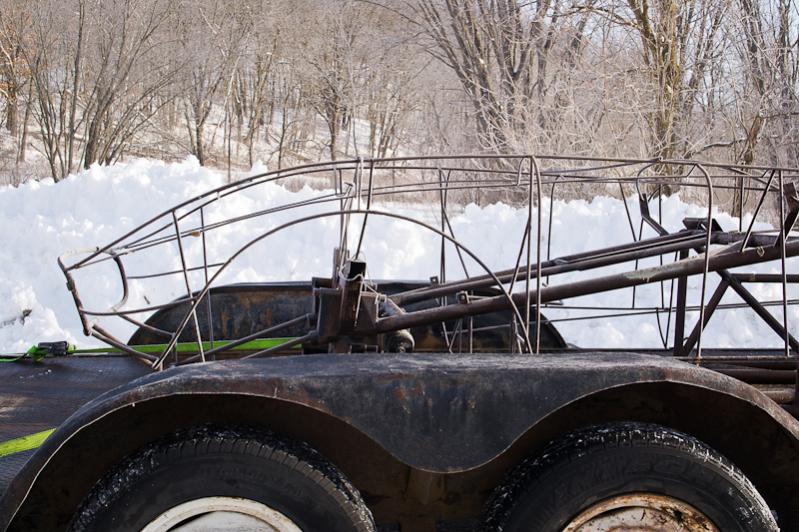

    Last week we received an original John Tojeiro racing frame (with wire buck attached) that we have been commissioned to finish. (http://en.wikipedia.org/wiki/John_Tojeiro)
    This frame and buck was built by Toj himself, and from what I understand it's model name is is intended to be "Tojeiro California."
    Our goal is to have this entire car finished by the end of the year -- ambitious for sure. I'll post pictures of the progress as I'm able.

    Judging from what's visible in the pics the frame appears to be an evolution or derivation of 'Cobra technology' - big straight round tubes with suspension towers up front and a cage for the DeDion out back.

    AC bought Tojeiro frames for their Ace. Later, Shelby would make his Cobra on this platform.
    I don't know anything about the history of this frame, but (via hearsay) I believe our client knew John Tojeiro and got the frame from him.
    The wire buck looks very similar to the Ferrari California Spyder. We have built many of those bodies, so this shouldn't be too challenging.
    Our client has sent us a race-built Chevrolet 292 for this build (300hp supposedly). It will be wearing 3 Weber side-drafts. We will be using a Jaguar rear differential with inboard disk brakes.

    Curious choice. I'd think Jag 3.4 or 3.8, early Cad, early Chevy smallblock, maybe even Olds 303, might have been more typical.

    The DOHC Jag straight 6 was common in Tojeiro frames. Buick V8s also made there way in. I've heard that our client was also thinking about an early Corvette V8 that had some racing history. We'll see what happens in the end -- projects usually "take shape" throughout the process.

    Are the frame tubes and ''superleggera'' gas or electric welded on this frame? Some of the italian builds of this era were still gas welded into the 60s.Will it be skinned in 3003?

    That's a good question about the alloy -- I'll check into that and get you an answer.
    I heard my coworker say (after looking at the welds) that he thought it was done with an arc welder. The wire buck is brazed to the frame.
