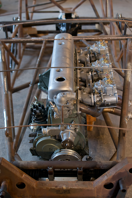

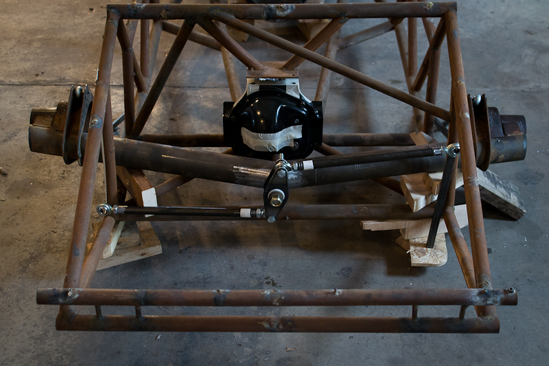

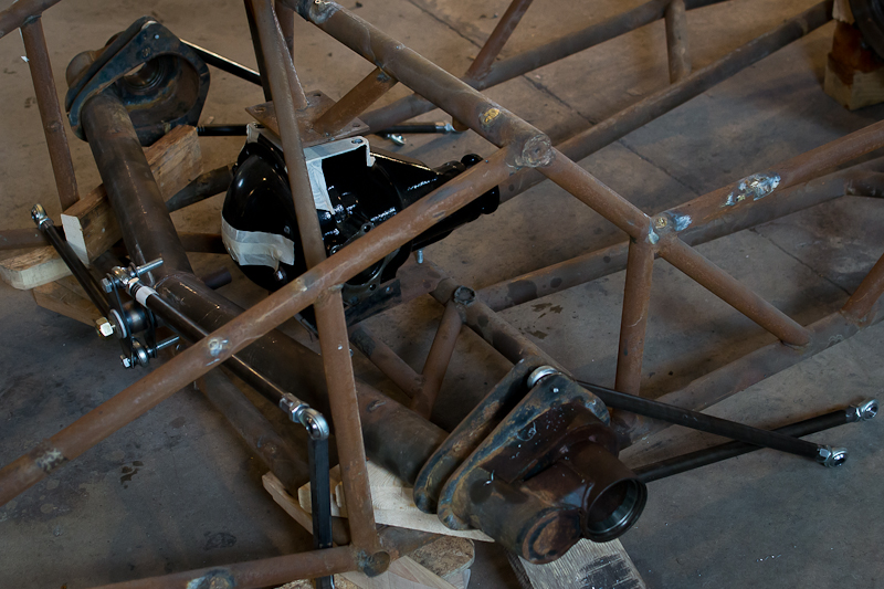

    We mocked up the engine and rear axle today. The engine is in an approximate location in relationship to the frame. We are struggling to make the big Chevy 292 fit in there with room for a driver's foot box.
    The links for the De Dion tube have been fabricated using Teflon Heim joints.
    kidcampbell71 likes this.

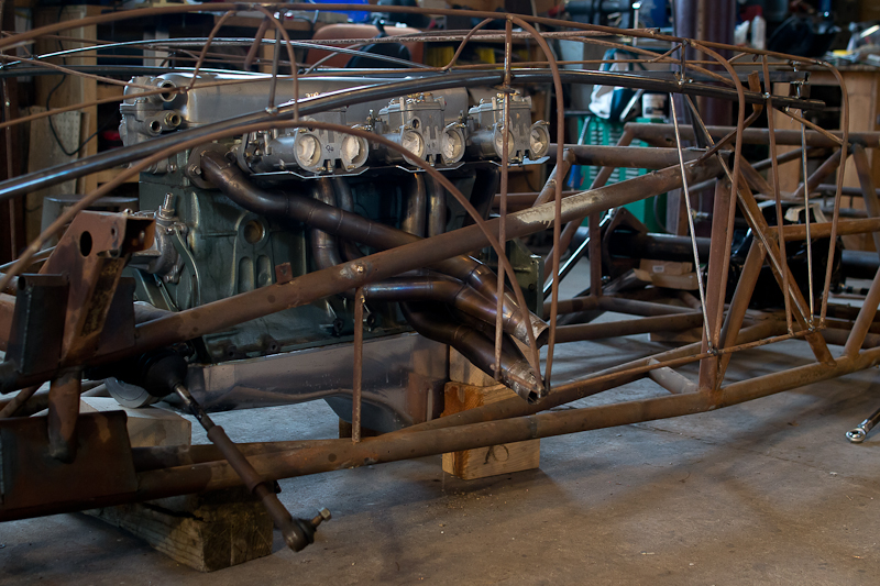

    Some more pictures of the mock-up.

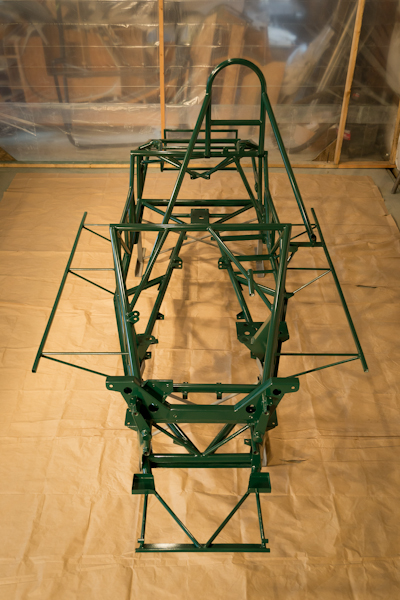

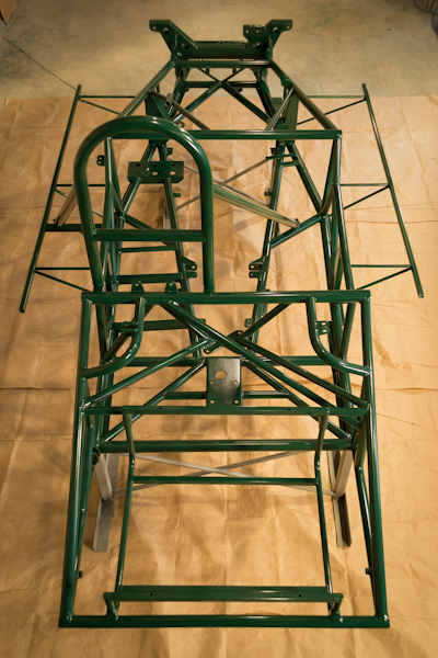

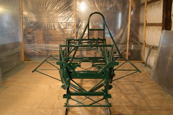

    After months of mocking up and fitting every component we finished up the frame and painted it. It is painted British Racing Green (a tribute to its Jag D-type heritage).
    ***embly has started and is moving quickly. In a few weeks I should have pictures of the completed drive train and running gear installed with it sitting on its own tires!

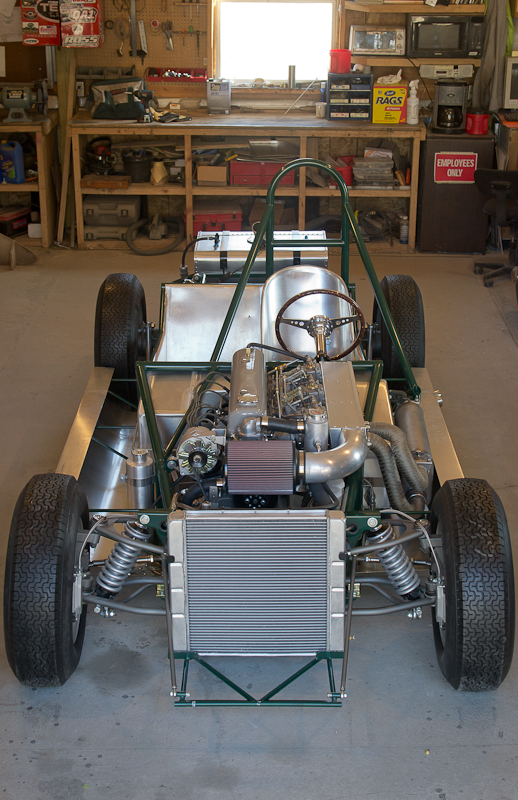

    Untame

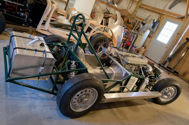

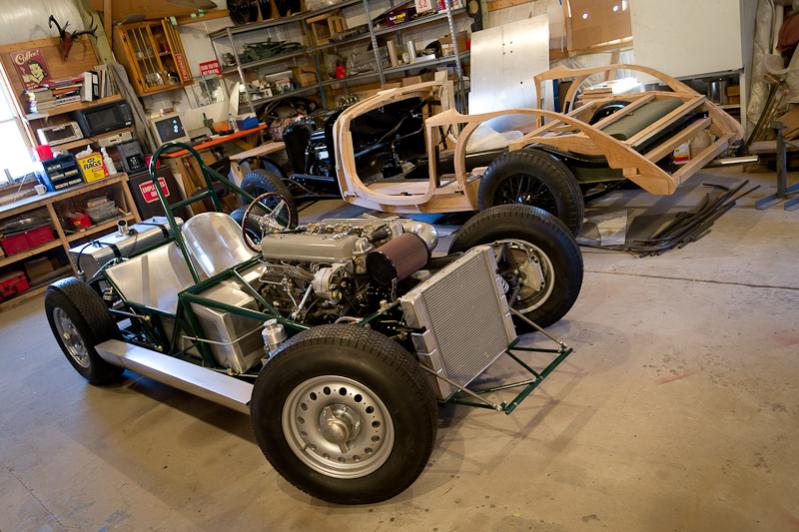

    I should update the thread to say that all of our build components have been selected and prepared. Gear box is a Muncie M22 (replica by Auto Gear) wide gear ratio, tied in with a Centerforce DFX clutch that is controlled by a Tilton hydraulic throw-out. Combined with the 2.88 rear end and 27.4" tires he should be at 3,000 rpms in first gear at 25mph (slowest corner) and have legs out to 155 mph in fourth.
    When you factor in that the car will come in just under a ton and the engine dynos at 300hp/330tq it should be a very compe***ive set up.
    Altogether the drive-shaft is only 5.75" long! Because the transmission sits so far back toward the driver Jared made a custom shifter that sits on top of the gearbox body. He split reverse off to its own lever, and it will double as a parking brake. The shift pattern is "H" with the stick centering between 3 and 4.
    For the suspension we have QA1 adjustable coil-overs. The differential is a Salisbury LSD set with a 120 pound breakaway. Front brakes are aluminum 4-piston Jag XKE upgrades. Spindles are attached via ball joints to the control arms. All of the suspension linkages have teflon heim-joint ends for adjustment.
    I'll try to get some photos of all of this installed in the next couple weeks. It's a nice package, and I expect him to win some races if he can keep it pointing in the right direction.

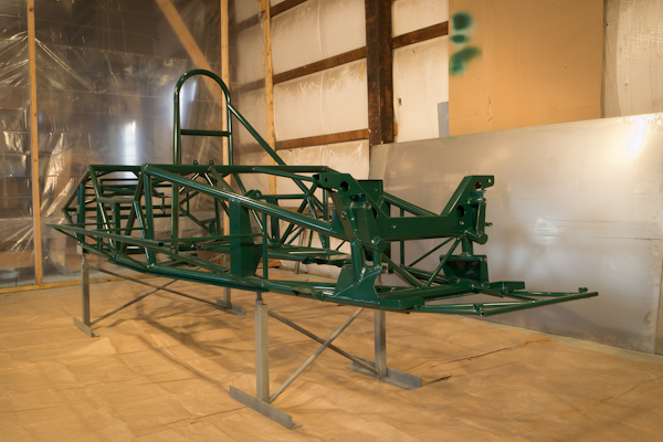

    Here are some pictures of the completed ch***is. The various skin parts are made and now will be ***embled on hinged front and rear clip frames.
