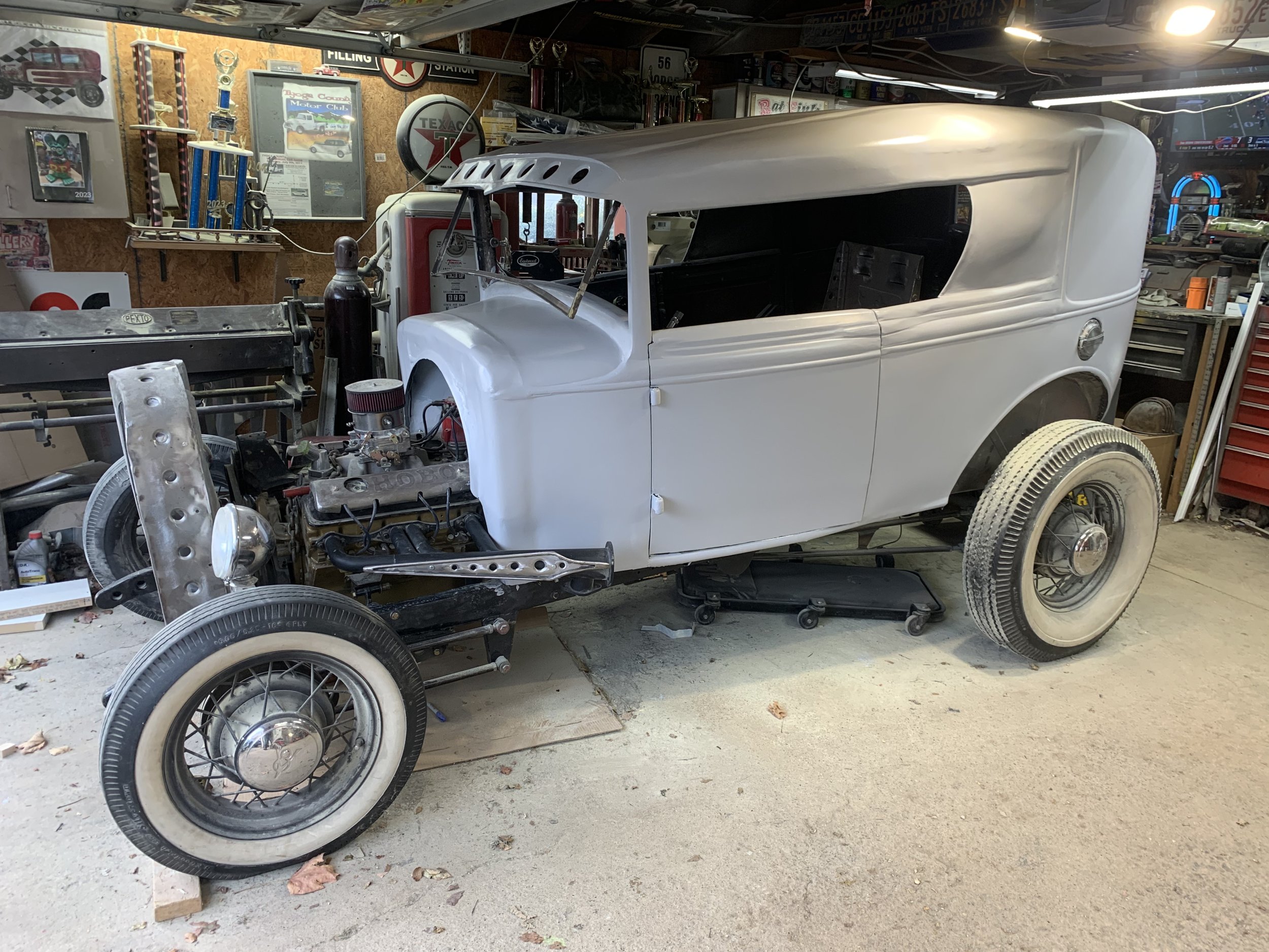

    Hey I am building a 31 Model A Hot Rod. I am using a 250 hp sbc 350 with a 700R4 transmission. I have a set of original wire wheels that I love the look of my question are there any issues with these wheels as far as functional for street. I am going with the bias ply tube tires as well. Thank you for any input. 4191CC45-EC47-44FA-AF6A-F1A5725E3B64.jpeg

    The mounting surface of the wheel will eventually crack if you don’t use the spacers.

    Just ordered the spacers! Thank you both for your advice!

    Thank you all for your input. I’m gonna run’em! I have ordered the support spacers they should be here on Wednesday. Onto finishing this build!
