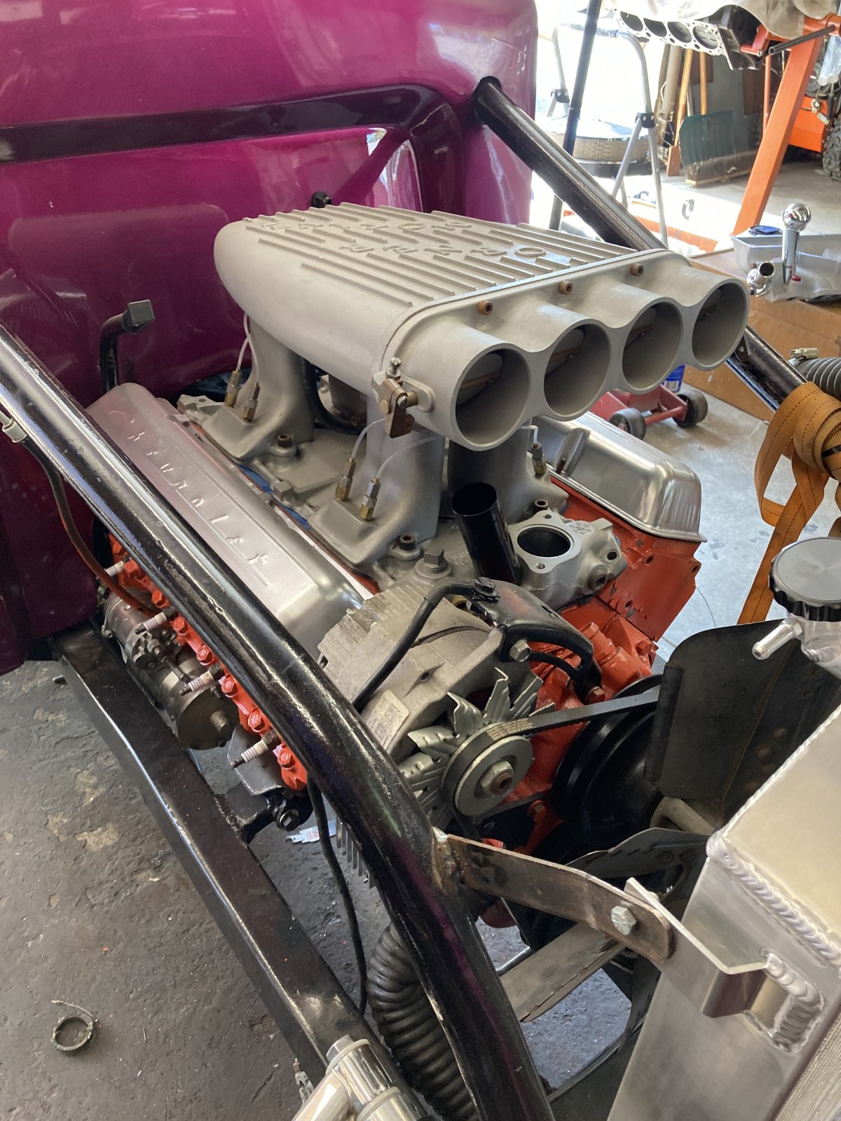

    C1A3D22C-31E0-45B5-B902-B6C643AB7222.jpeg Looking for information and owner manuals or any technical do***entation for the Orner Motive sbc fuel injection units, I have been looking for other owners and anyone else that know how these FI systems are plumbed and tuned.
    I have looked through the jamb quite extensively, just can’t find exactly what I am looking for.
    I guess they are fairly rare, I have not heard of very many.

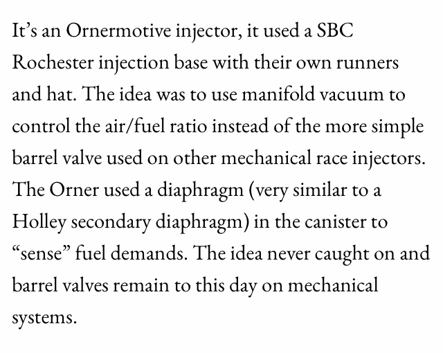

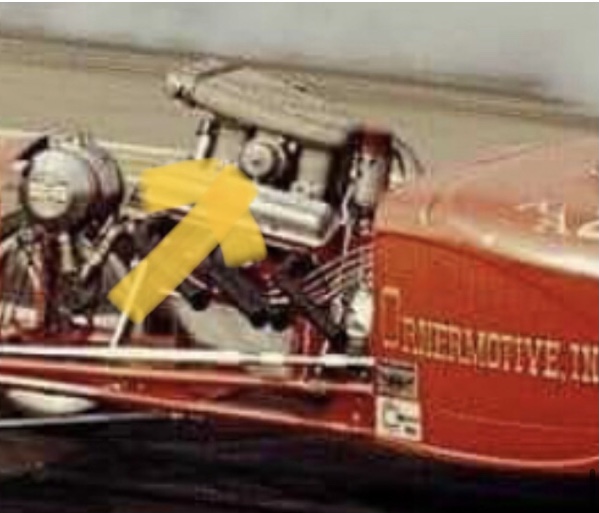

    F102F12E-C33E-4ADF-AC1B-D63B61573EA0.jpeg 0554A5D1-7AA3-4766-A244-3042A5C0296A.jpeg
    The above is from an earlier post I made, the thread was a general one, mainly photos of different injectors. IIRC the Orner brothers called it the injector with a brain.

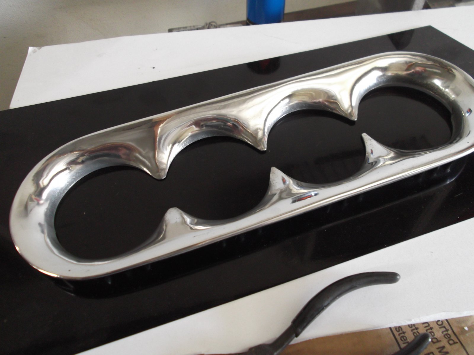

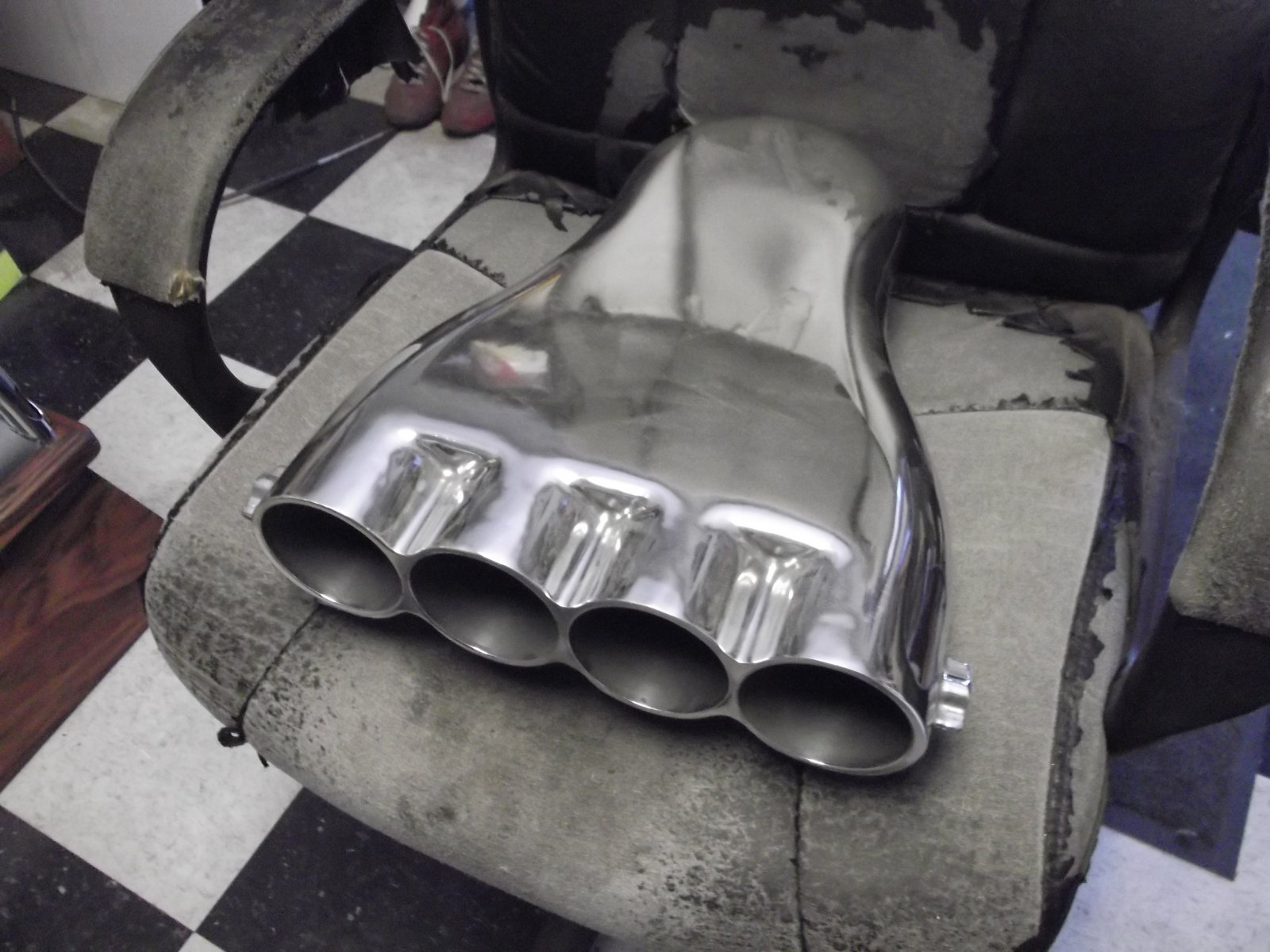

    I did the injector scoop mods for John. wanted to save the front lip to hang on the wall upload_2022-10-5_8-44-17.jpeg upload_2022-10-5_8-44-52.jpeg

    Plumb it like a Hilborn or Enderle and save yourself a huge headache, The injector is cool enough

    I was going to suggest consulting with Gene Adams or Kinsler about converting it to regular barrel valve operation and conventional nozzles and plumbing. It won’t be stock as Orner intended but it should work ok.

    @Fordors Your right in looking at the picture i and @dreracecar posted it's not a Orner motive scoop.:oops:
