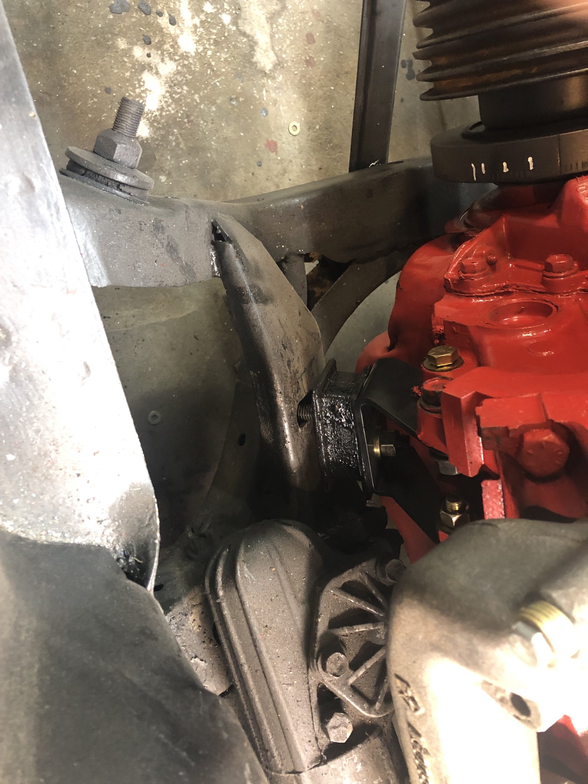

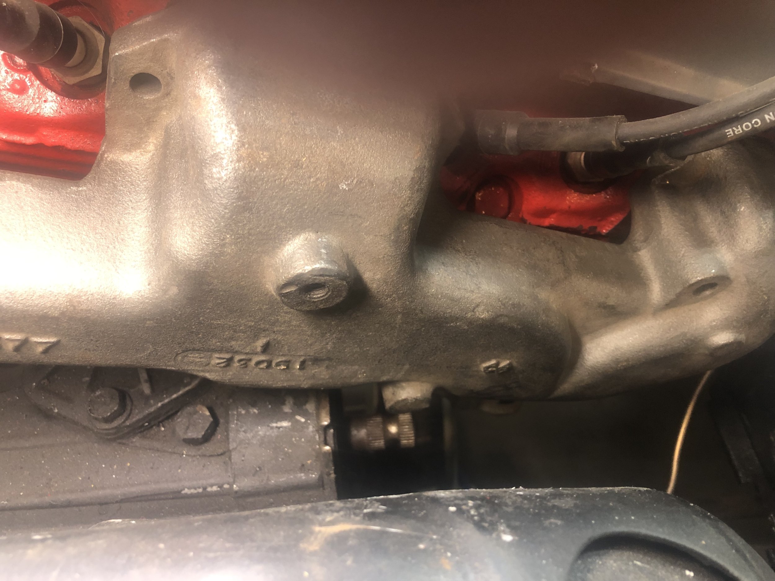

    Thanks Gene I have Dakota RT exhaust manifold, at present it doesn’t fit if you look at photos 1 and 2 it hits the column tube and the coupler. The tube I figure I could remove the shift lever and cut 3 or so inches off reinstall the bearing and seal. I will not grind on the coupling however I might be able to grind enough off the manifold for clearance. I’m not against mini starters but don’t want to spend money if not needed.
    The manifold that came with the engine absolutely won’t fit it dumps right at the steering box.
    I’ve been told and have read that the single exhaust works very well indeed. My sources tell me a min of 2-1/2” and up to 3” will handle any HP I ever intend to make.
    Gene have you ever shortened a steering column tube? Can I simply cut 3” off remove the shift lever and reinstall the bearing and seal? I’m going to install a floor shifter so don’t need the column shifter. I wouldn’t even mind the column shifter although it would an absolute nightmare to make work.

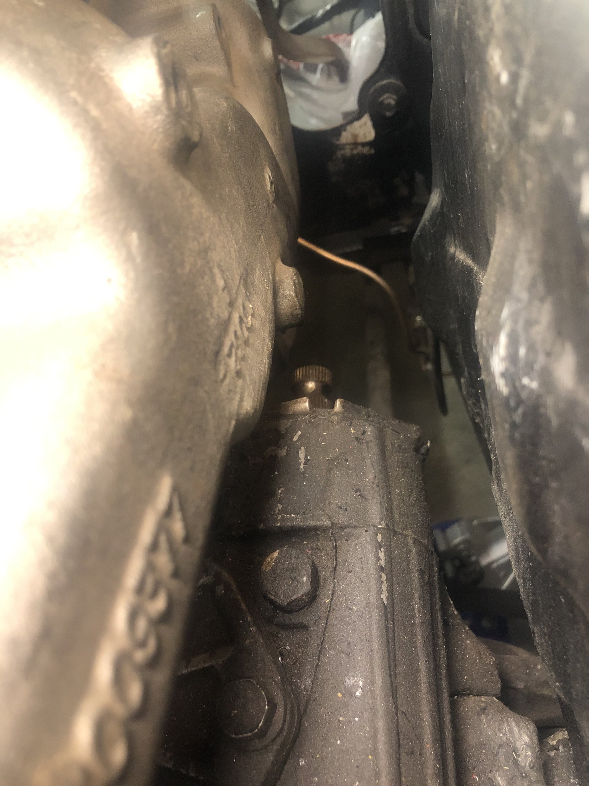

    The engine mount is about 3/4” up on drivers side. If I cut the column tube back at the yellow mark that will clear. If I replace the coupling (marked X) with a u joint that has a OD of 1.225 I think it will clear. The coupling is 2” at the widest point and 1.375 at the narrowest point. I can’t move the steering column at the dash without cutting up the dash which I don’t want to do.I could maybe move the column 1/4” at the floor. I will remove the steering shaft and column set the engine all the way down and take Some measurements . I know where the shaft sits so I’ll know if using a u joint will give me the needed clearance. thank you for the help.

    The fourth picture, if you did a floor shift, you could cut the outer housing at, or even above the floor pan and move the bottom bearing up to that point. You will probably have to cut the steering column above the shift lever on the shaft. With the steering shaft in the column cut, you can install a weld on, or pinned U joint (with column end being round 3/4", or whatever your shaft measures) onto the shaft at the bottom of the freshly cut column. Point the steering shaft towards the left side inner fender (you will probably need to buy a short piece of Double "D" (DD) steering shaft and another U joint), you can buy U joints with one or both ends DD, and something different on the other end of the U joint). A steering shaft bearing mount for the extra shaft might be a needed item to stabilize the short shaft. Then you should be able to connect the end of the DD shaft to another U joint, to replace the piece on the steering box. That piece is held in place by a hollow pin, drive it out, pry the coupler off the steering box, get a spline count and diameter for the short shaft out of the steering box. The U joint for that place will have one side to match the size and spline count of the steering box shaft, and the other side of the U joint will have the DD end on it. You will likely be able to move the steering shaft out of the way to clear the manifold, the limiting factors will be the angles the U joints can operate within. With 3 joints, a shaft bearing mount, and a 12" length of DD shaft, it is not a cheep modification, but less then a set of headers.
    You can cut up a 3/4" round wood dowel from a lumber company to see how much clearance you can get before you cut anything up.
    You may be able to improve the U joint angles if you can shim two of the 3 bolts holding the steering box in place with a washer or two between the box and the K member. An 1/8" change at the K member makes a pretty big difference 8" away from where the steering column connects.
    It does look pretty tight at the dash piece. Modifying the bracket to lower the column might gain you a bit of angle change, but that would also lower the steering wheel in the car. If I remember correctly, the steering wheel sits pretty low to begin with.
    I think you should be able to gain what you need with the bottom end of the column.

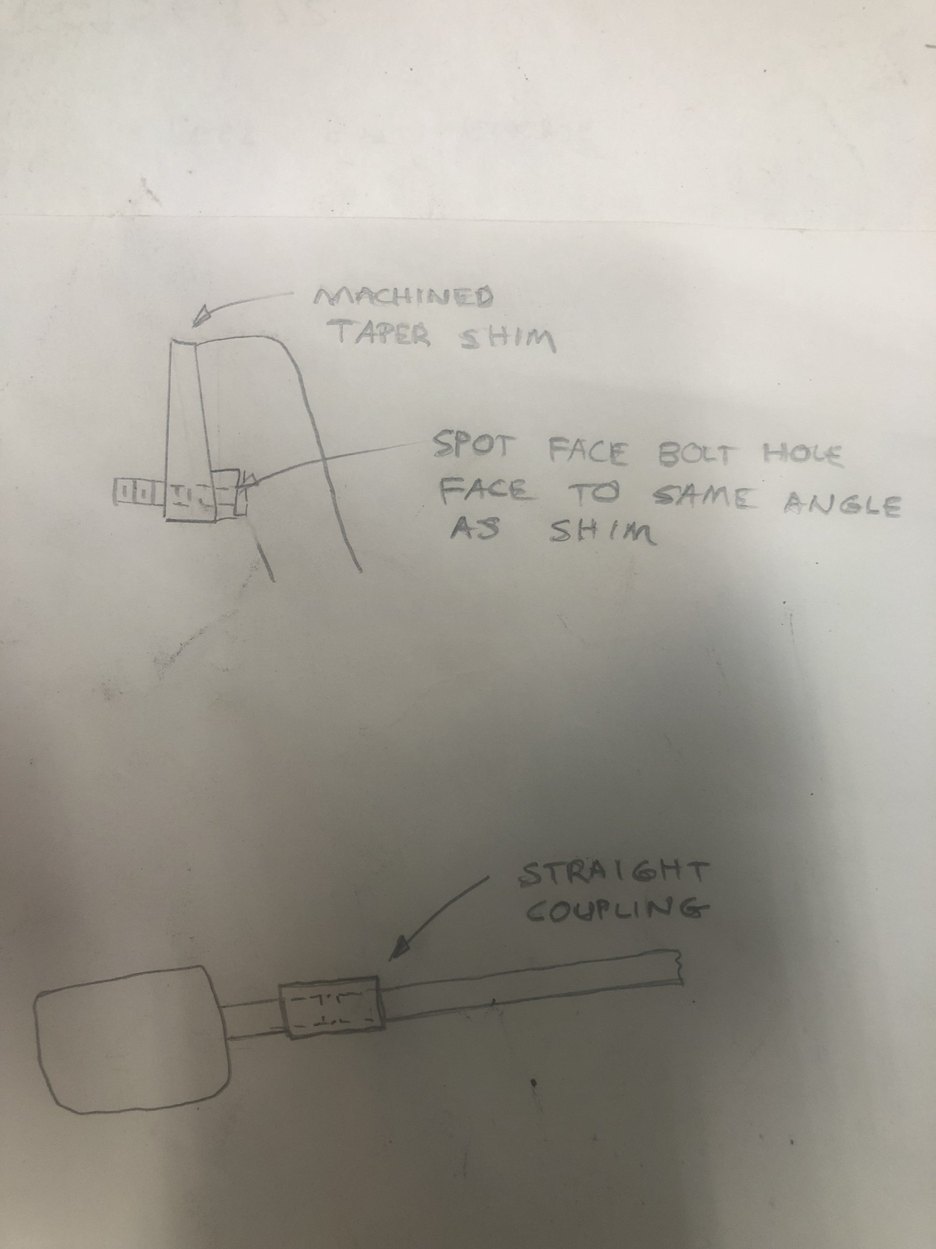

    Good question but no because a couple spots on cylinders 1 & 7 flange is only 1/4” and removing would make an awfully narrow sealing surface. I’ve thought about making a taper shim to place between the manifold and head but that would require spot facing the bolt area. Machine shop rates would make it pricey to make the tapered shim and spot facing. Dang I retired to early, sure miss the machine shop. My photo ****s but it shows the thickness 7-3/4 to 8
    Dumb question can I use a straight coupling / basically a piece of tubing instead of a u joint if everything is lined up in other words in a perfectly straight line?

    Actually my shim drawing is b*** ackwards the thick side should be on top

    Edited drawing

    The shaft that comes out of the steering box has splines. You can use a straight coupling if it has the correct splines to mate with the steering box. I'm not sure coming straight off the steering box is going to help you much, unless you can shift the angle at which the steering box is bolted to the K member.
    Those couplings on the steering box don't like to come off easily. Make sure the end of the shaft is really clean, and the whole thing is well lubed. Then, its still a battle, be careful about wedging things between the coupler and the end of the box where the shaft p***es through.

    Picture 4: If you can point the shaft on the steering box down and towards the left in reference to this picture (by shimming the steering box mounts), you should have more clearance between the manifold and the steering shaft. Its hard to tell how much clearance will exist from a picture (which are great, by the way), but even gaining another 1/8" of air gap helps a lot. It appears that maybe a straight coupler with splines on one end would clear the manifold, and heat wouldn't have much effect on a straight coupler.
    Gaining extra clearance was also the reason I would put a U joint on the steering box, it would allow the shaft to be moved even more towards the lower left side (based on the 4th picture). The only issue then is you need another U joint to turn the shaft back towards the column, and you would need to support the modified steering shaft neat that 2nd U joint. Then you would need that 3rd U joint to align the new modified angle of the steering shaft to the column shaft.
