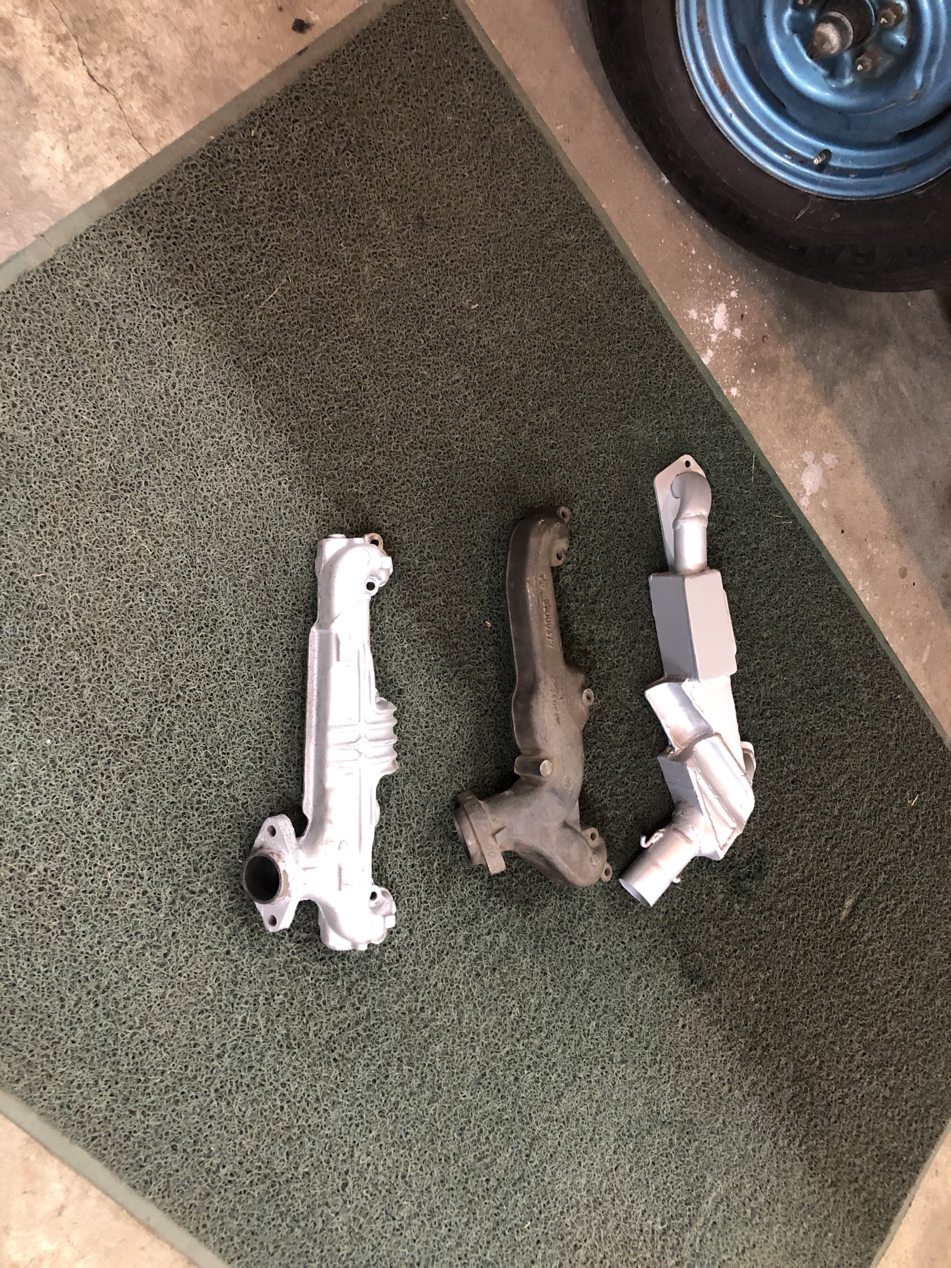

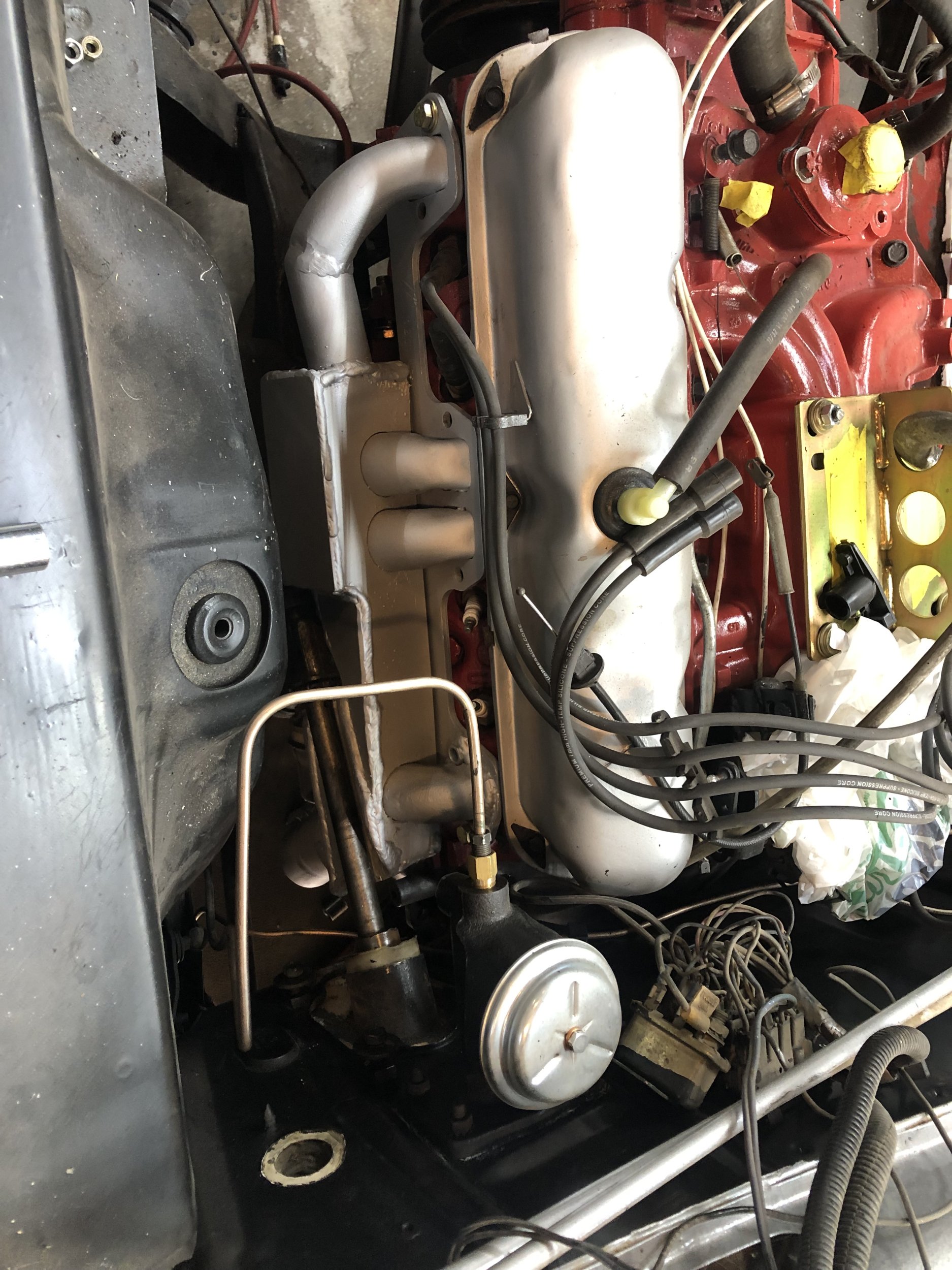

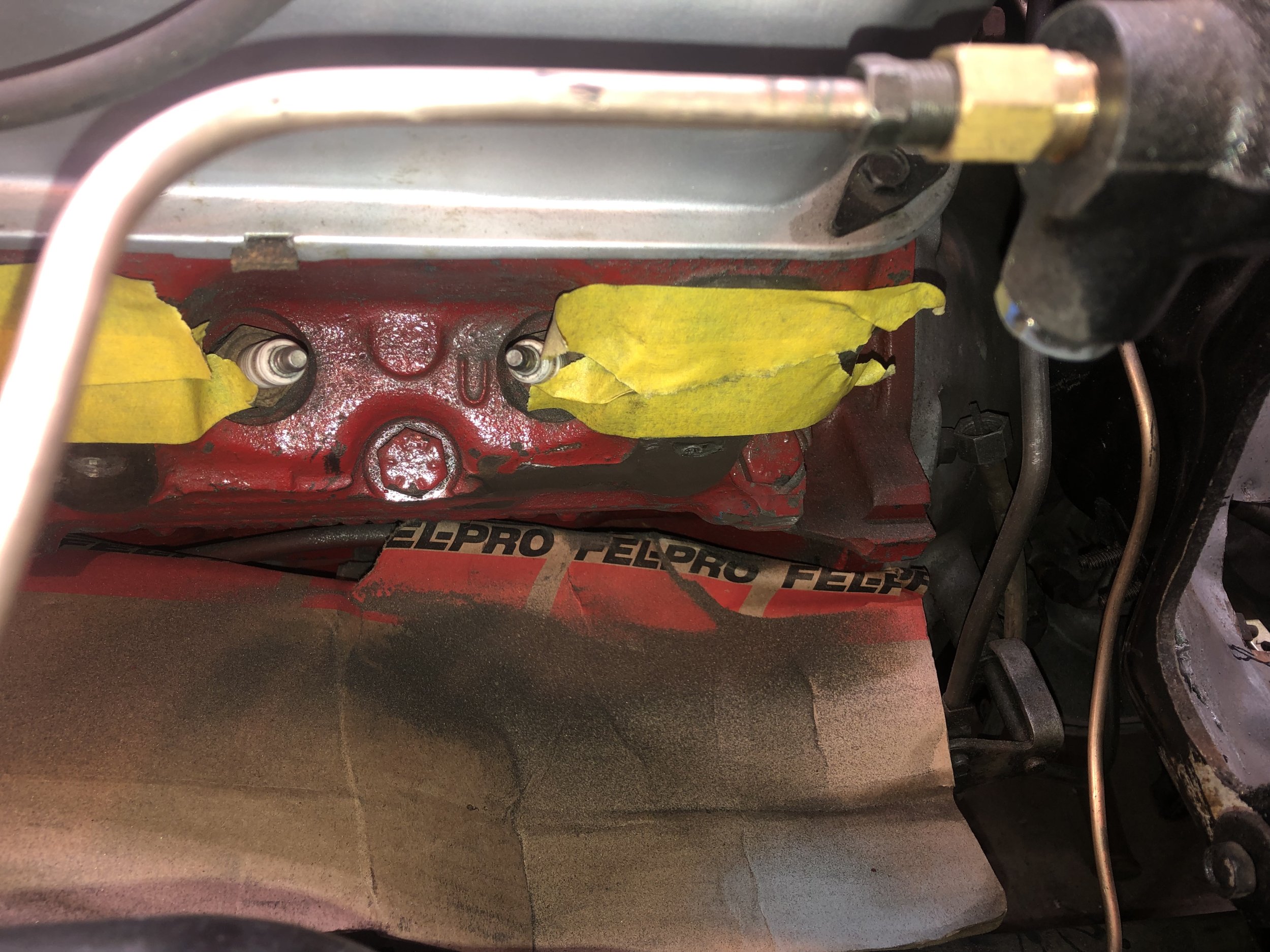

    IMG_3469.jpeg IMG_3471.jpeg Made up a manifold to fit.
    Lots of tacking welds, test fitting, cutting tacking …,, somewhat crude but from my measurements should be less less restrictive than the silver stock manifold. If it works ok I may remove and clean up the welds, or I may buy a 273 manifold but being stubborn I had to make my original idea work.

    After messing around with this I believe I could make a really nice log style header/manifold. Down the road I’ll order a a couple stubbed flanges.

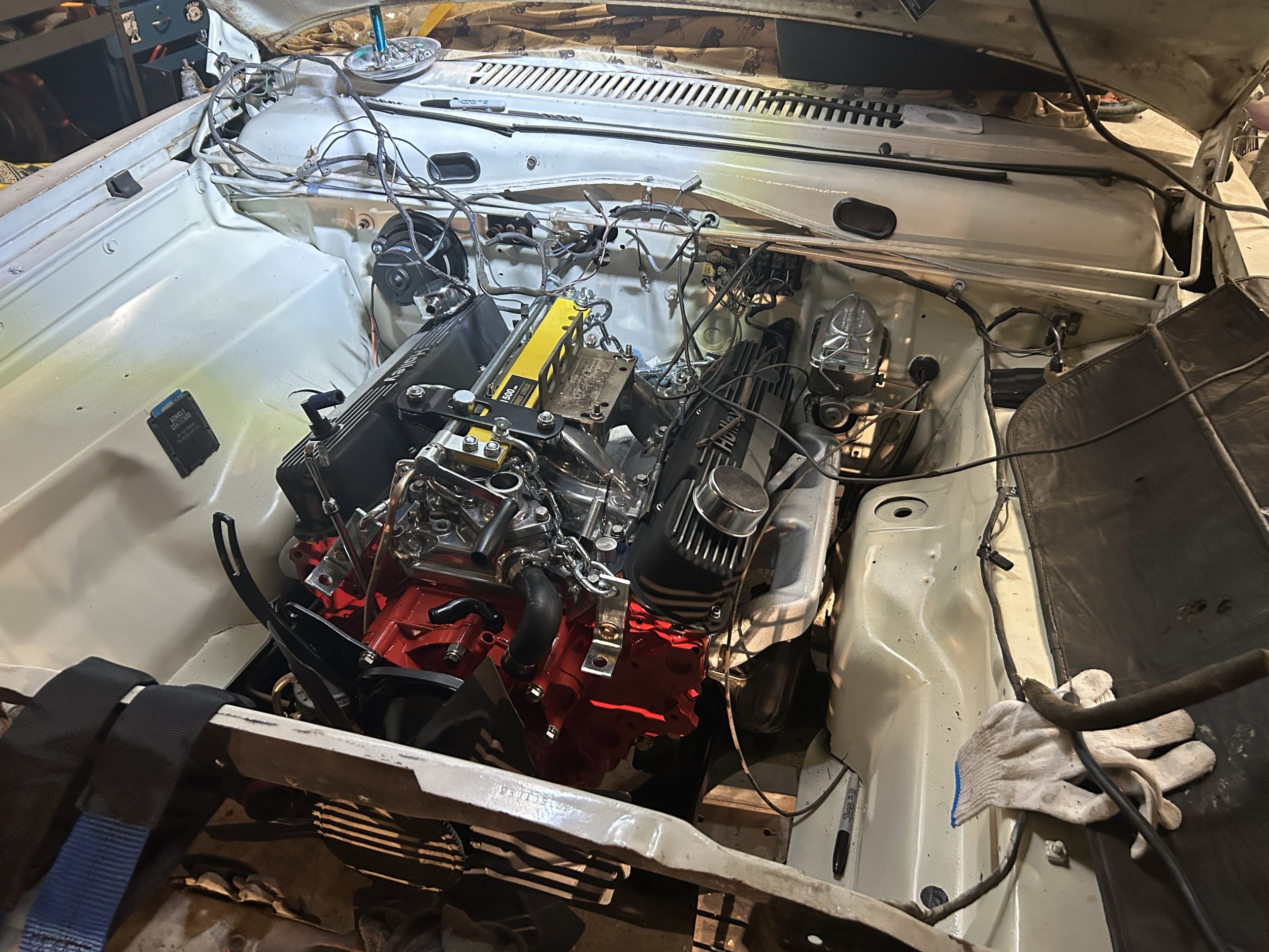

    IMG_3474.png IMG_3473.png The above photos show the break down of the steering coupling. There is a rubber seal that probably can’t take anything over 250 degrees it’s packed with grease I have some high temp sticky wheel bearing grease that will handle 450 I believe.
    I’m not worried about temp on the steering shaft or the coupling but I’m not sure about how much temperature the steering box can handle 200 to 220 maybe? The steering box is lubed with grease. My question is will the coupling and shaft conduct too much heat to the gear box and possibly cause damage?
    One option is to use a 273 manifold as suggested above.
    Opinions?
    Thanks

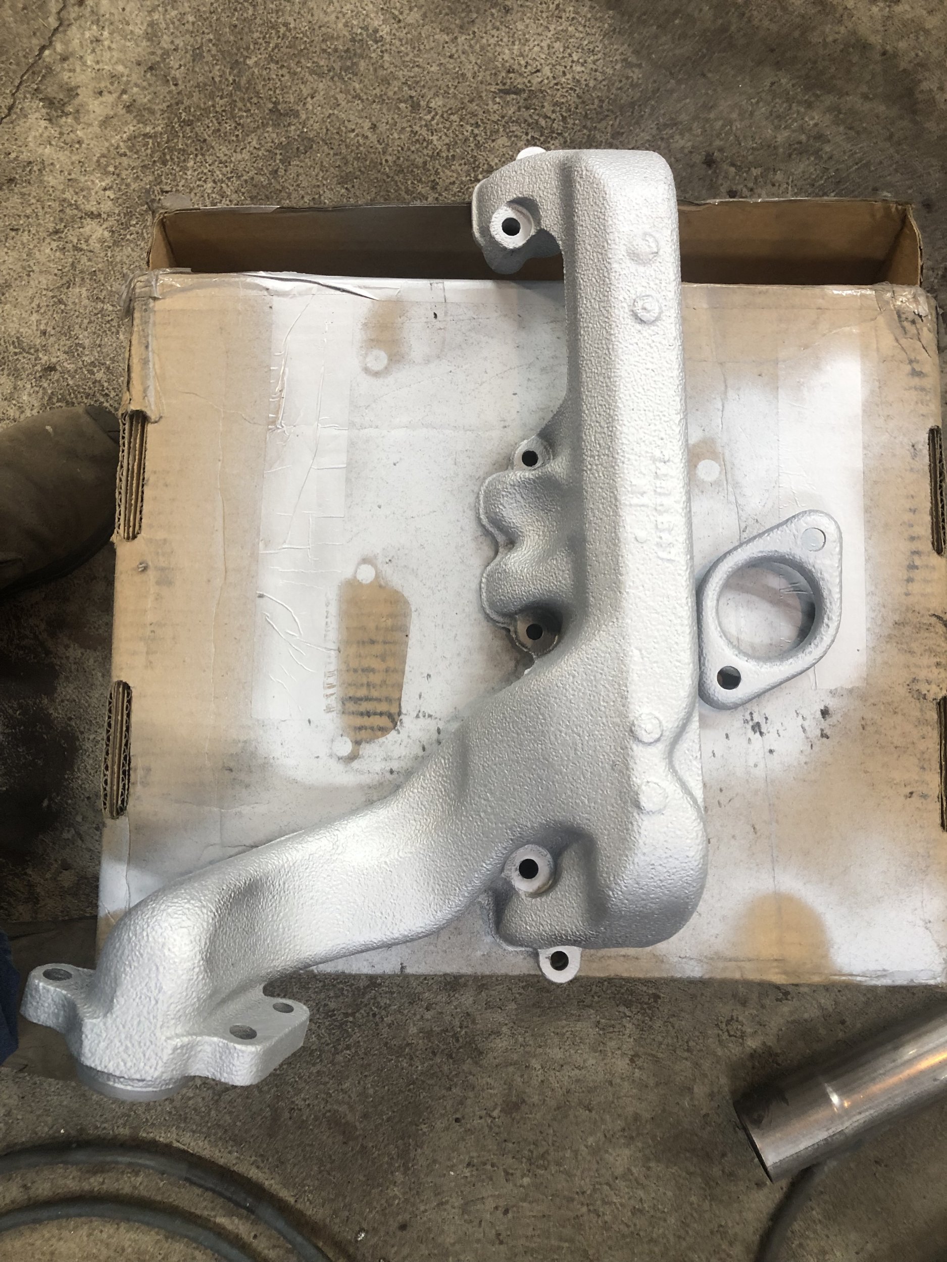

    Ordered a manifold today should be here this week about 200 with shipping.
    Thanks all I learned a bunch.

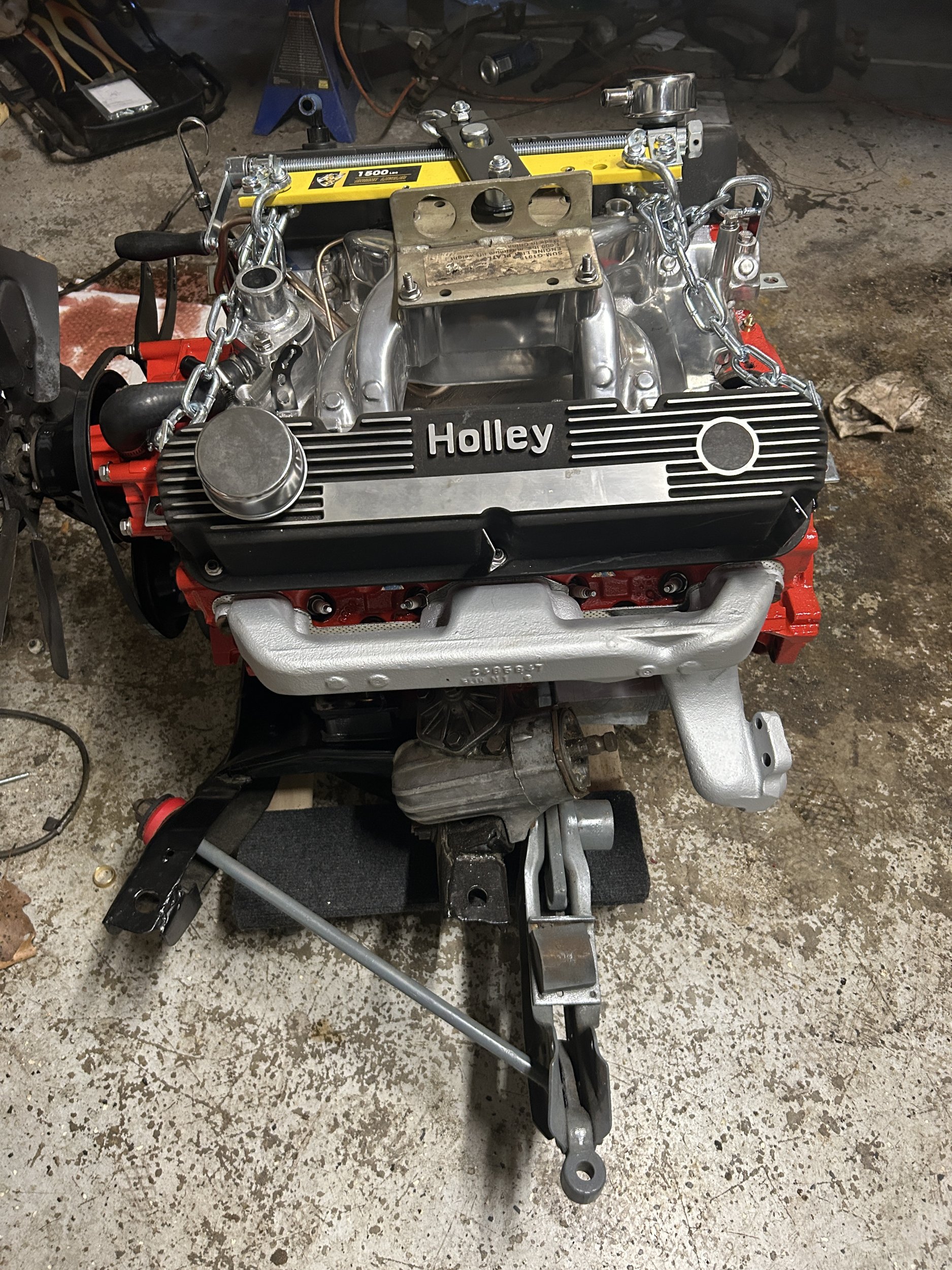

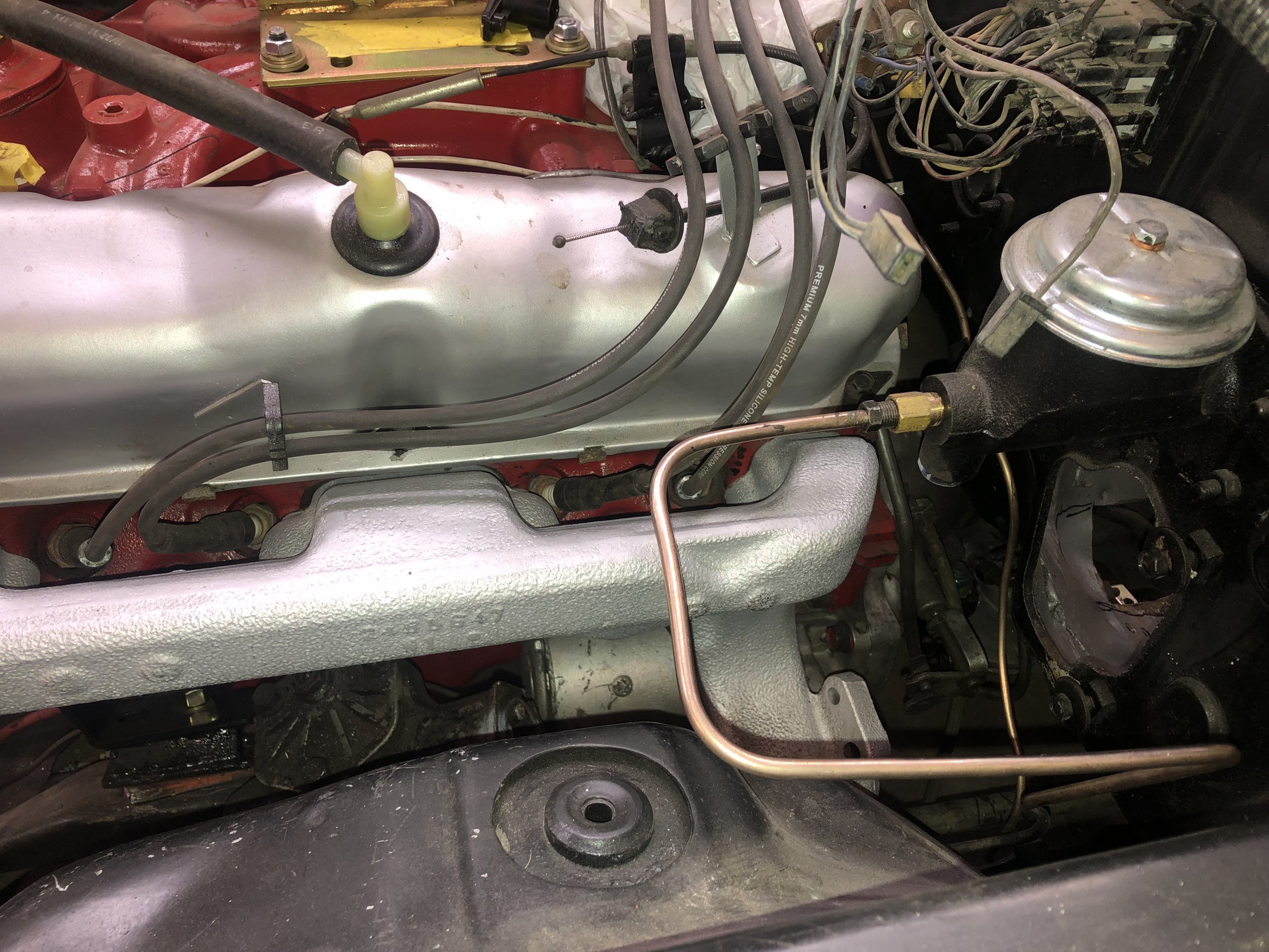

    IMG_3496.jpeg IMG_3497.jpeg IMG_3498.jpeg Got the new(old) manifold, a little interference with head, a little grinding on the head and manifold. A few try’s (5) before I got 0.018” clearance.
    Thank you to all for your input.
