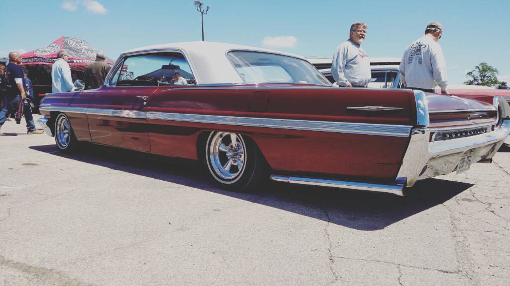

    ^^thats entirely probable. I just came from a car show where I saw a 63(?) Catalina laying real low with bellflowers....put my wheels in motion, ya know? But once I get in the old girl and go for a cruise.... perhaps I'll think twice. IDK.

    Mine is a wagon...and blue...but this guy's ride had me itchin' to get low.
