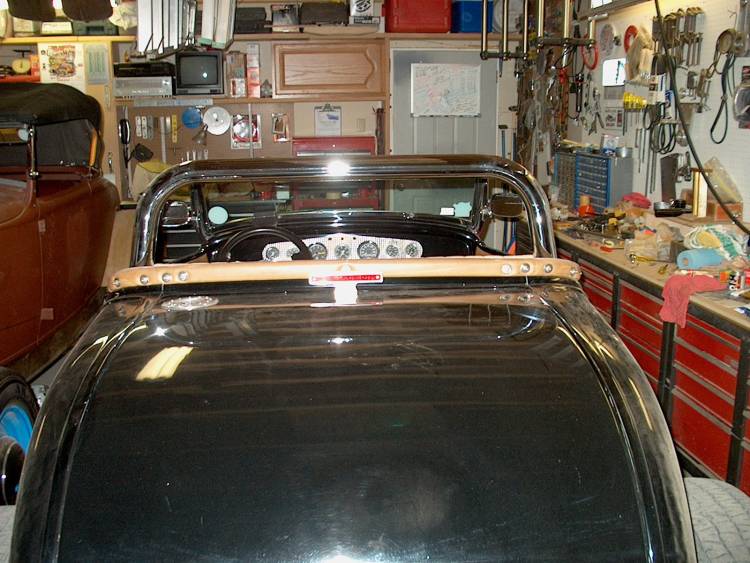

  19. A little difficult to see, but you can get a pretty good idea.
    Just short of 16' of Sears rollaway style workbenches - four of them bolted together.
    The top consists of the 7/8" particle board top the workbench came with.
    On top of that, two layers of 3/4" MDF, the top layer hanging out over the middle and bottom layers to make using clamps easy.
    These red benches have drawer slides that are simply . . . slides.
    They're working ok, need a shot of silicon lube once in a while, but I highly recommend you get the charcoal colored workbenches since they have roller slides like a rollaway.
    You don't have to get started with four of them, two will suffice, bridge them with the top and add one or two or three more benches later on.
    Did this for my bother-in-law and it made a nice workbench for him.
    Chairs fit under the open middle and he can sit down and work.
    Not a workbench seen in the background, rather a heavy duty shelving system.
    2 x 12"s all the way.
    Dadoed with a shallow dado and lage screwed together with 3/8" lag bolts.
    Heads, cranks and the like don't faze the 2 x 12's as long as the span is not too great.
    I have a pair of 16', 1/8" angle steel skids bolted on to the legs of the big workbench to facilitate moving.
    I moved this bench by myself and it was a bitch even with all the drawers and contents removed.
    I recommend - highly - you build the bench in two sections to make moving easy.
    First time I moved the big bench, all the drawers were empty and it was about all five guys could do to carry it into the moving van.
    Fwiw, Sears has several different top styles available.
    The sheet metal top is a good way to go for a single workbench.

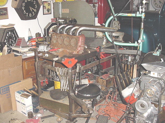

    Well here's mine not that you can hardly see it with all the crap stacked on it. So you're gonna have to look close to see anything, so here's a couple highlights :
    The near side - has the holes drilled in the web to store my TIG rod at my fingertips when needed.
    The brace below it is solely to hang junk on c-clamps, vise grips, etc - I plan on adding more of those.
    The right corner leg supports my swiveling stool - it pivots under the bench for self storage. The top also slides on the upper brace so you can get real comfortable while welding - pivot/slide anywhere you need it. The bench is pretty heavy so my ass can't come close to tipping it over.
    Next the whole bench is on wheels and if you look close at the bottom is a BRAKE - no rocking - roll it where you want it and step on the brake - it stays rock solid - junk scavenged from the machine surplus place
    meaning it was CHEAP. It's so solid I have even rolled it outside and put a ladder on it when I needed an extra few feet.
    Underneath is a small hose reel and associated regulators etc.
    The planishing hammer (homemade) pivots left/right and rotates to store underneath when not needed.
    The farside - there's a vise mounted on a hinged bracket - comes in handy to pivot it down out of the way and give me a full flat work surface - nice when working with full sheets of aluminum/steel. yeah with all the junk stacked on it you can see that need hasn't come up recently.
    On the FAR LEG - you can barely see my hammer rack - it too pivots off the leg so you can swivel it out of the way (underneath it) when not needed.
    Of course there's some future plans for it, but I haven't had time for those yet. For instance I started to drill and tap the top for "tooling" holes. It's SLOW going - only got a few done - meaning to do a bunch more.
    My friends have dubbed it the "SWISS ARMY BENCH"
    I use it nearly every day - definitely worth the little time and effort to make it user friendly when I built it.
