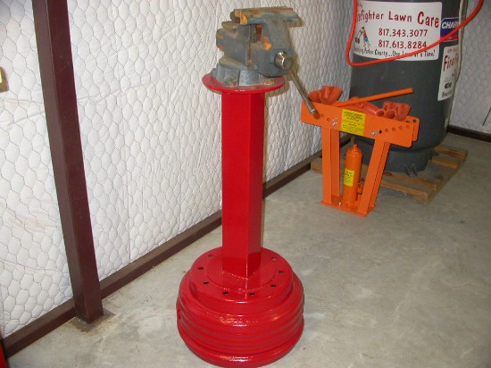

    I used other people's shops my whole life till just a couple of months ago, when I finally got my own. I'm tall, and I hate hurting my back by stooping over. I built this bench with a kitchen countertop and s**** 2 and 3 inch square tubing. It's 46 inches tall, which is just right for me.
    To keep the open concept on the bench, I built seperate stands for my vice and grinder.
    The vice is mounted to an old dump truck brake drum, the grinder to an old wheel.
    I like both setup this way, as I can move either outside for truly dirty work, so I don't mess up the inside of the shop too much with grinding and such.
