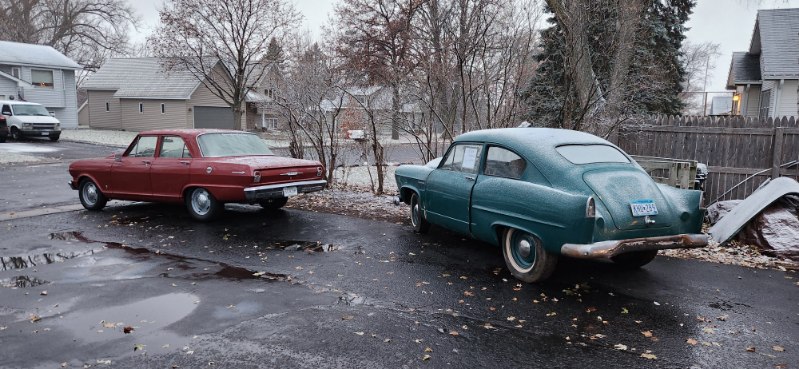

    image000003.jpg 20231209_132005.jpg Thanks for the welcoming everyone. Here are a couple pictures of when we moved it outside to re arrange the garage so we could start on it.

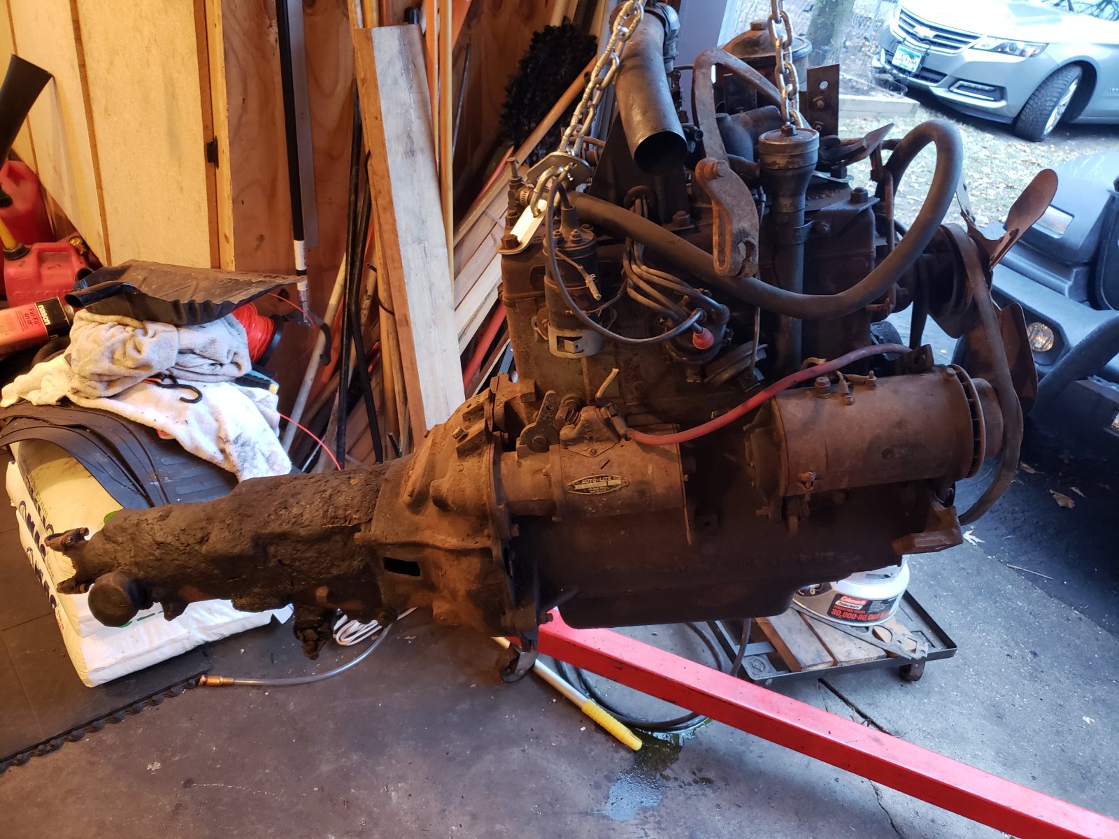

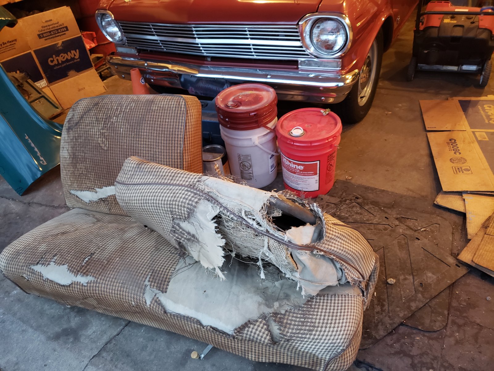

    20231209_175251.jpg image000008.jpg image000006.jpg 20231220_160353.jpg 20231222_161534.jpg 20231222_161534.jpg 20231222_161534.jpg 20231220_160334.jpg 20231223_155338.jpg I bought the car for her like 17 years ago and put it in the corner of the garage wigh the plan of getting to it eventually. So last year we built a Nova sleeper for my youngest son and i got back in the groove. So here are some pics of the teardown.

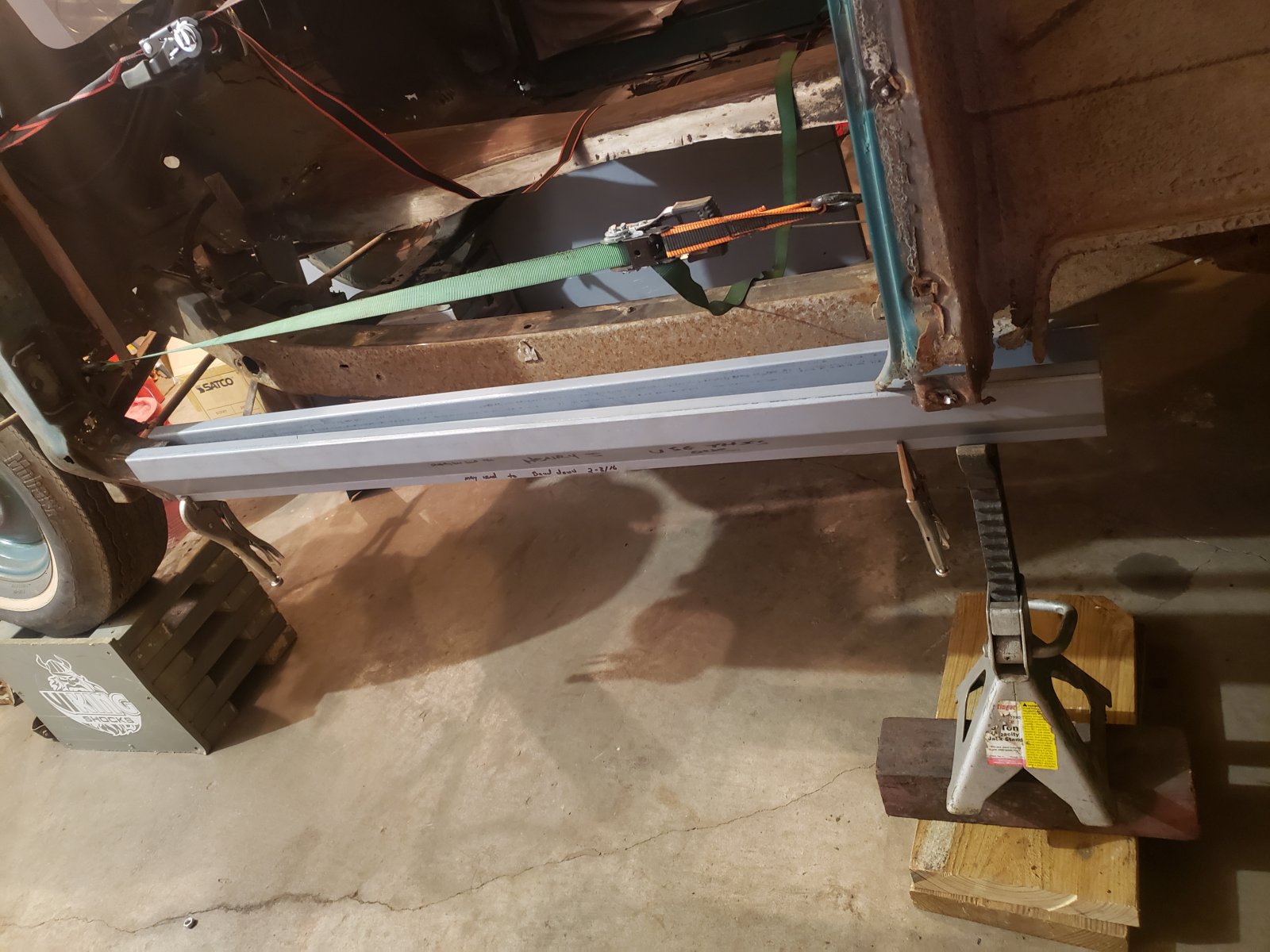

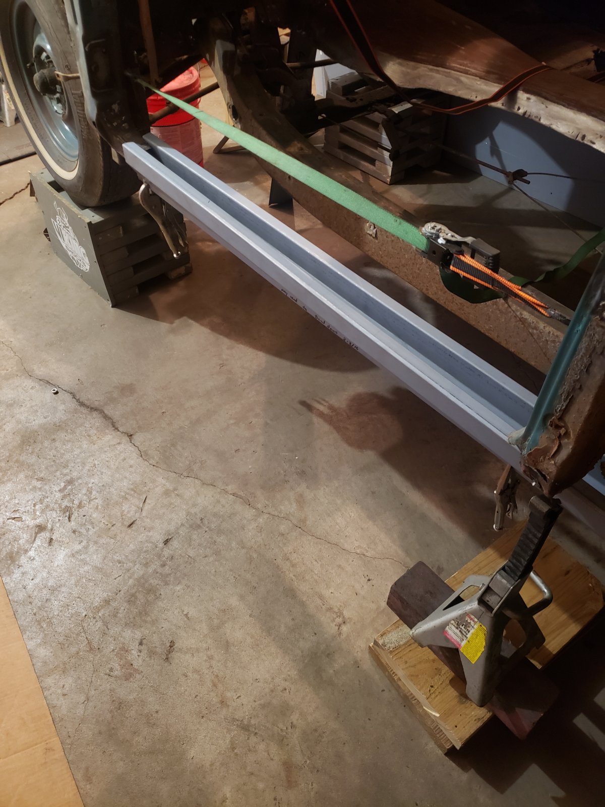

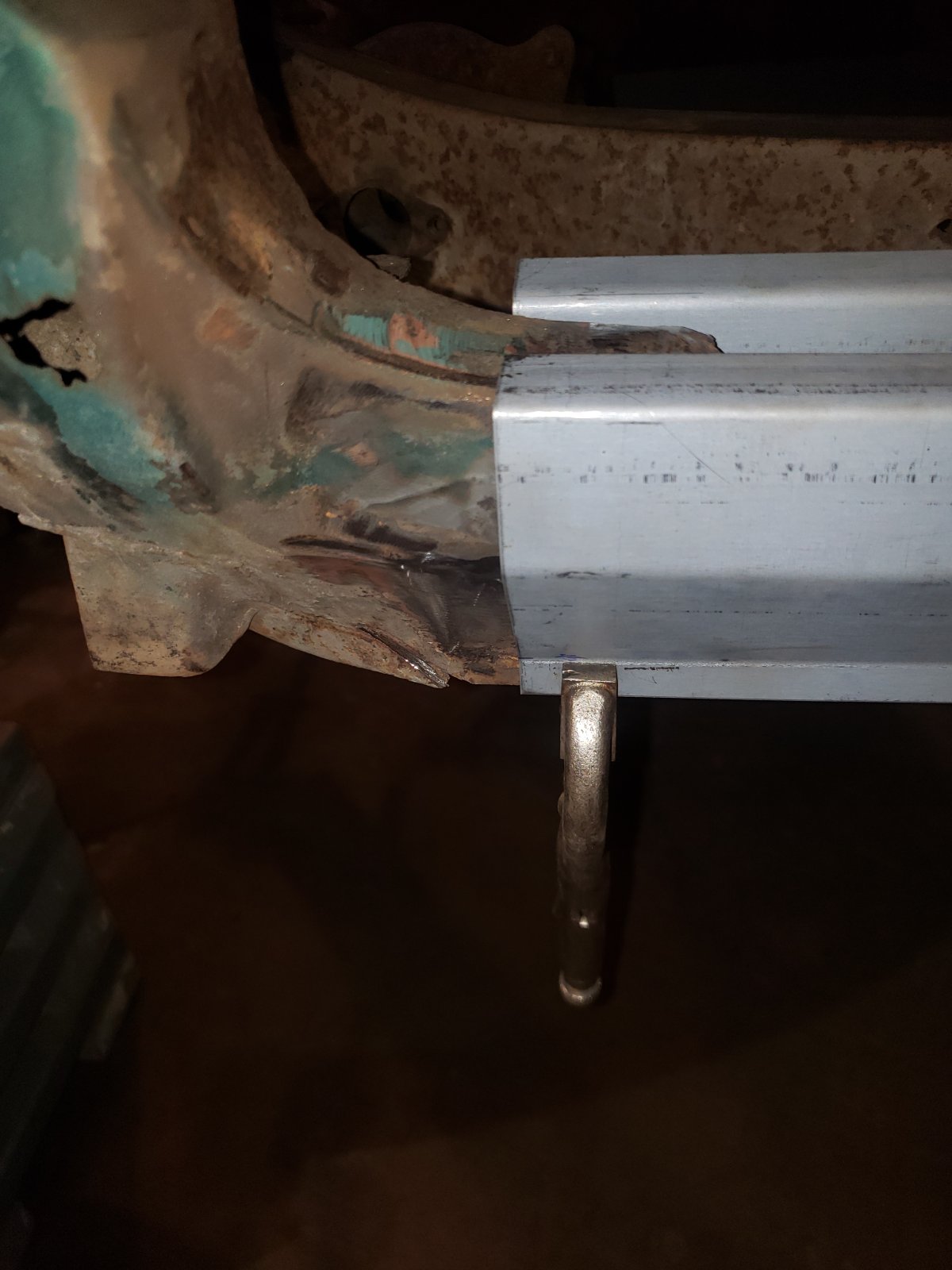

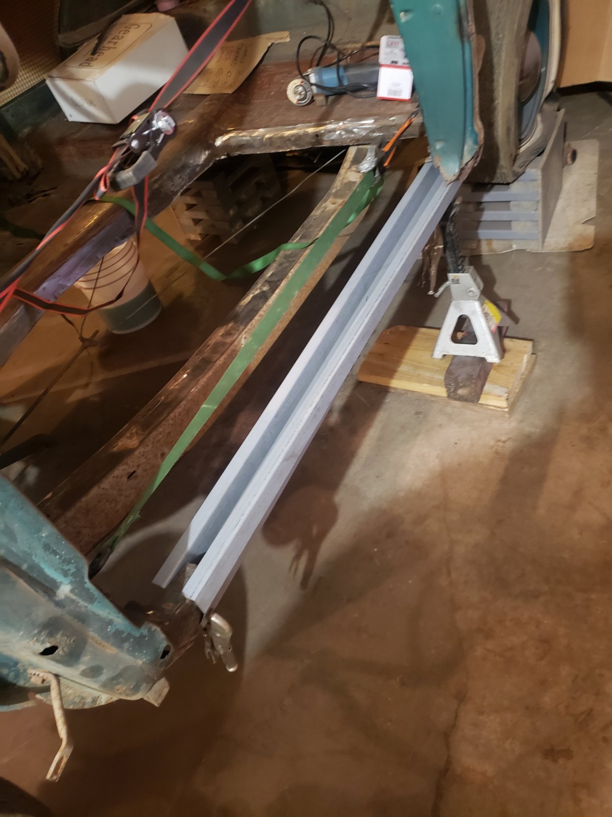

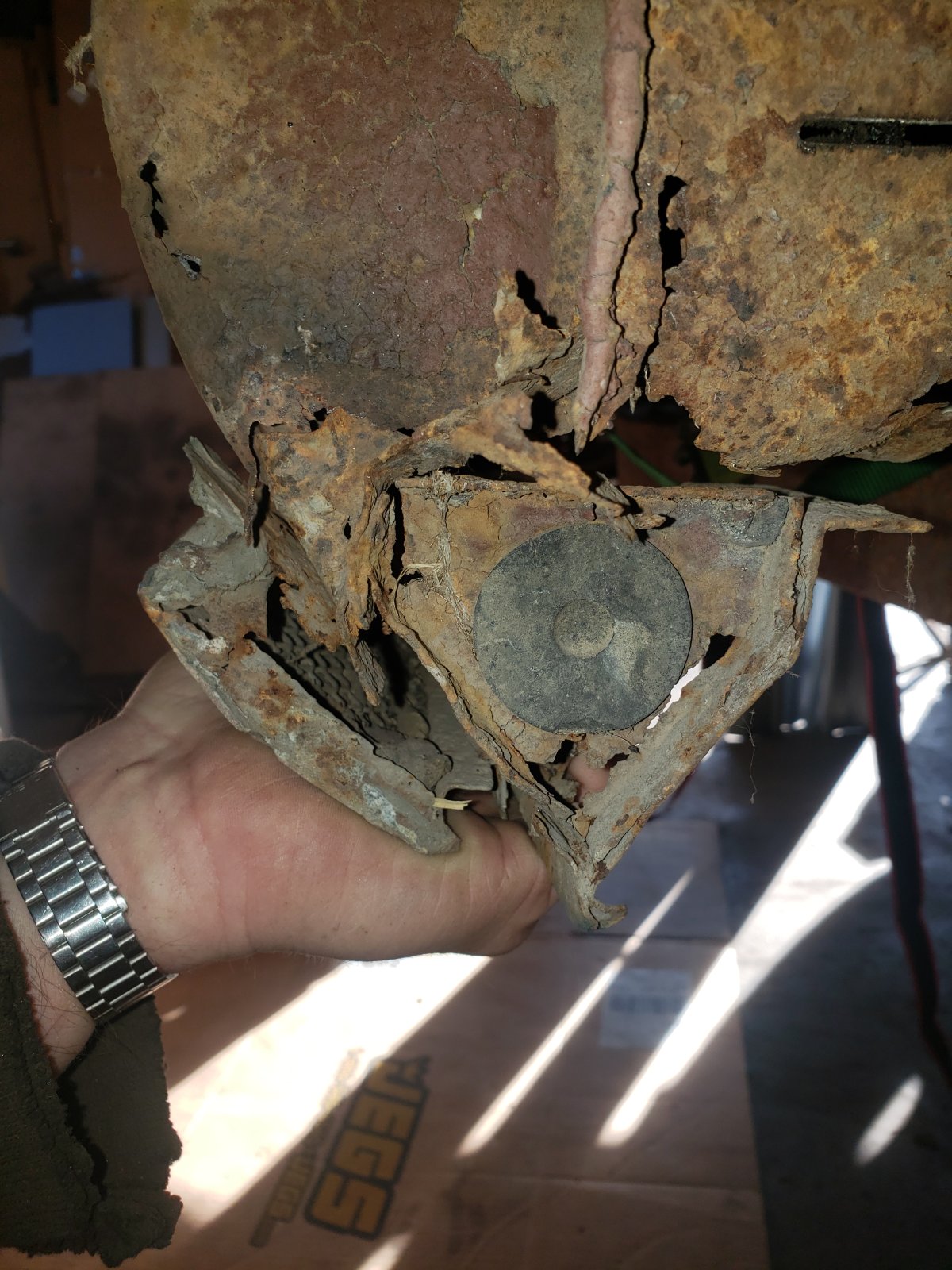

    20240204_151745.jpg 20240210_155814.jpg 20240210_155839.jpg 20240210_155824.jpg 20240210_160155.jpg This is the area im trying to tackle next. Rebuilding or repairing this mess. I already made new floor pans, floor pan braces, inner rocker sub structure, and outer rockers (bought the outers). Im just not sure if this B pillar needs to be rebuilt piece by piece (i can do it that way if need be i guess). Whats your thoughts? I clicked full image this time. Hope it helps.

  15. swade41
    Joined: Apr 6, 2004
    Posts: 14,635
    swade41
    from Buffalo,NY
    I'd say however you can get it rebuilt is the way to go, 1 piece or 10 as long as it's solid.
    Keep the future tucked under wide tires on the quiet, this forum doesn't allow those kind of cars.

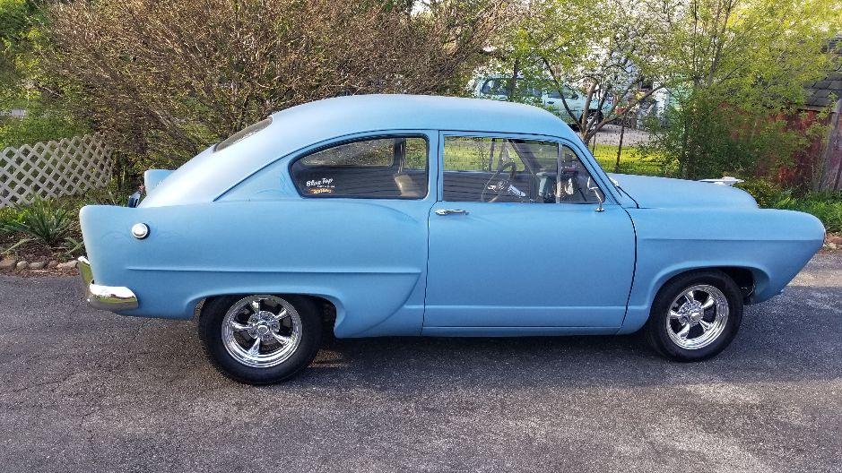

    My J is on a different ch***is. Not a g***er.
    Jibs, bchctybob, swade41 and 3 others like this.

    Judging from the picture of the pillar, I doubt even patch panels would get you everything you need. It's probably fab as you go.
    Hinge pins I'd go with the next bigger, same length and drill out the worn hinges to fit (if you can unbolt), maybe even go with bushings although they will probably outlast your use steel on steel.

    Im wanting to install bushings and new pins and just do it the right way. Yes the hinges unbolted and the pins come out just fine. Actually better than i thought they would. This car actually hasnt given a fight on anything yet. Ive got 3 more pieces to make for the outside of the B pillar then ill weld it all together then start fabing the inner side. Like a puzzle, 1 piece leads to another then next thing ya know its done. Using 18 g (same as factory) for rockers and patches but upgraded to 16g floor and 3 floor braces (factory was 2) made from 16g also. Im a perfectionists so im not happy till all the fitment is just right and looks perfect. I made templates from thin cardboard then transferred to steel and cut out.
