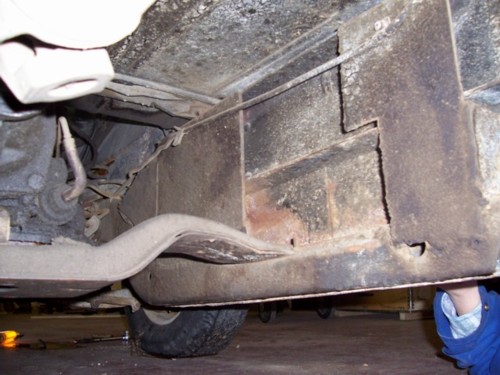

    Here are the pics of the Nova clip that was welded into our 58 by the previous owner 14 years ago. YUCK!!

    anothe rpic of the other side. You can see the ugly fish plates on there

    damn, how high does that sit?

    SON OF A BEACH THATS UGLY. It must look like a 4x4. Time to start over. Keith

    There is 12" of difference between the truck frame and the Nova subframe. And the guy drove it like this for 12 years man!! friggin crazy. This is why I am looking for pics on how to do it properly. I am also looking at swapping the chassis out for the spare 72 pickup chassis I have.This is the worst weld in I have ever seen

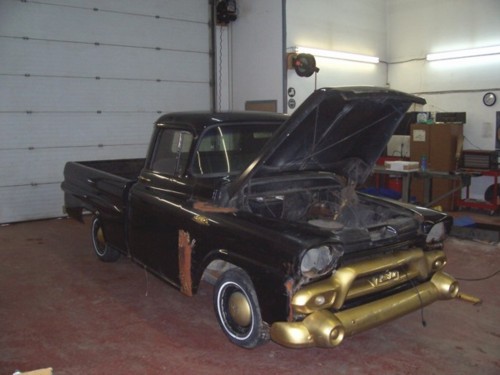

    oh, here's a pic of the truck before we started tearin it down. He never even had the front wheels centered in the wheel well

    Yikes you sure that's welded...nasty

  12. A clue that I have used on Nova-type subframes: Cut off those nasty 'legs'. Massage the OEM frame to meet the sub fairly well. Box the OEM frame if it is a 'C' section. Cut the sub approximately 1 foot rearward of where it meets the OEM frame. Cut along each corner of the sub and peel like a banana. Slide the OEM frame into the sub. Roll the 'peels' back and seam weld ALL joints. Fishplate if you want, but usually not necessary as you will end up with around three foot of weld on each side, which should be strong enough [​IMG]
    Oh, measure that bad boy eleventy-seven times, and at least twice after you start welding, 'cause sh*t happens.
