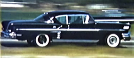

    upload_2025-7-20_3-9-27.png Lion's Dragstrip 1958-59
    We had all of our Firestone stock factory tires shaved and balanced on the 58 Impala. No one wants to go through the 1/4 mile with tire shaking. It definitely lowers the resistance as the tires were round.
    Every time we got a new set of tires for any of our cars, tire shaving was the second thing done.
