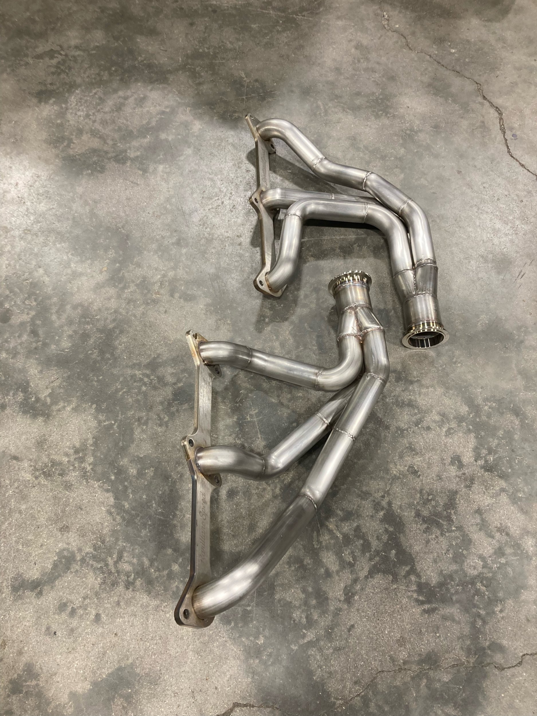

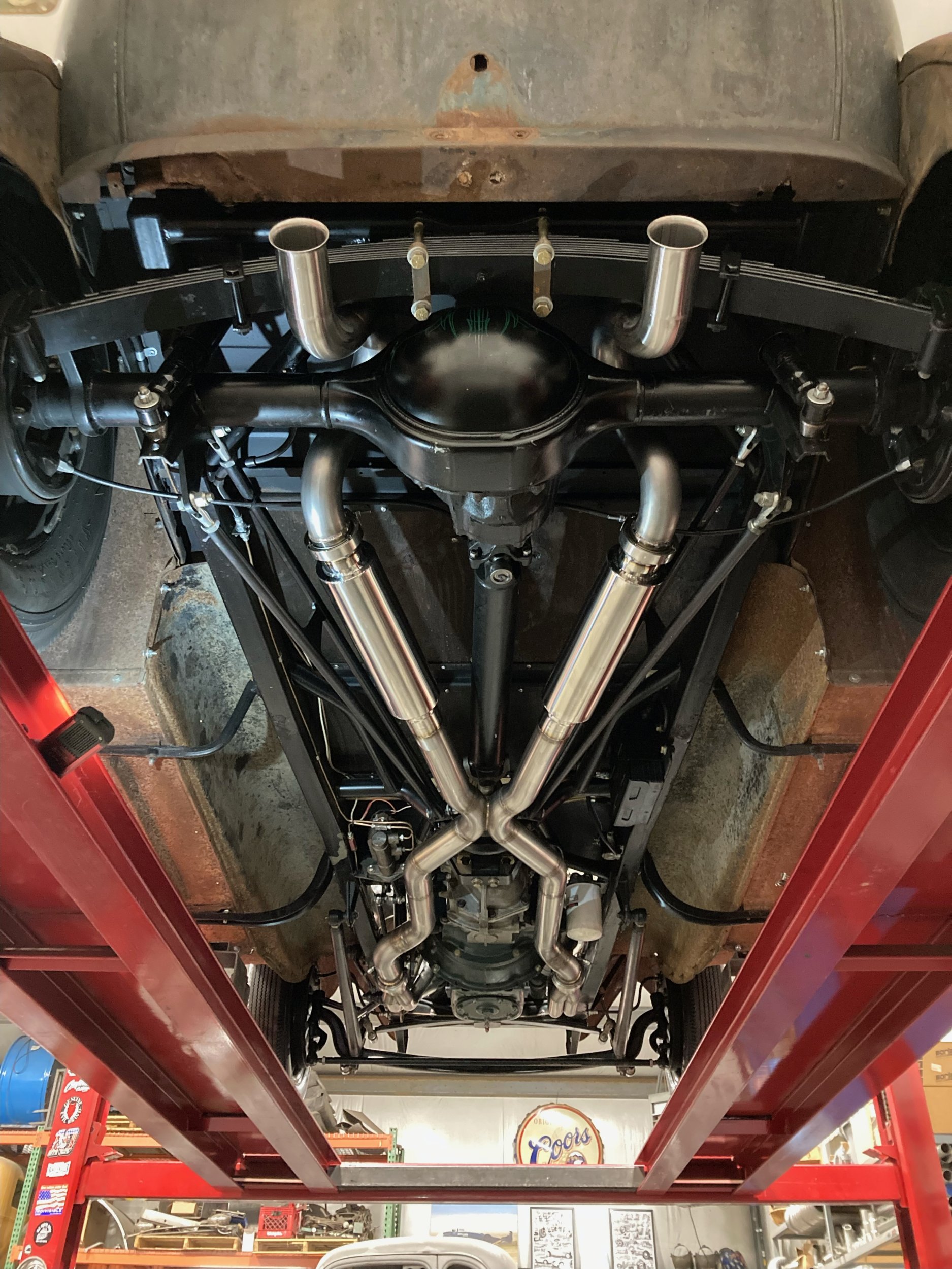

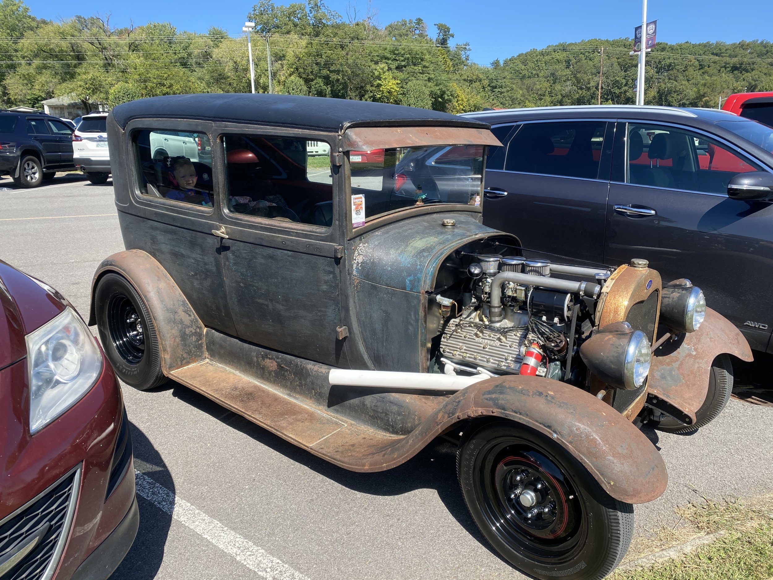

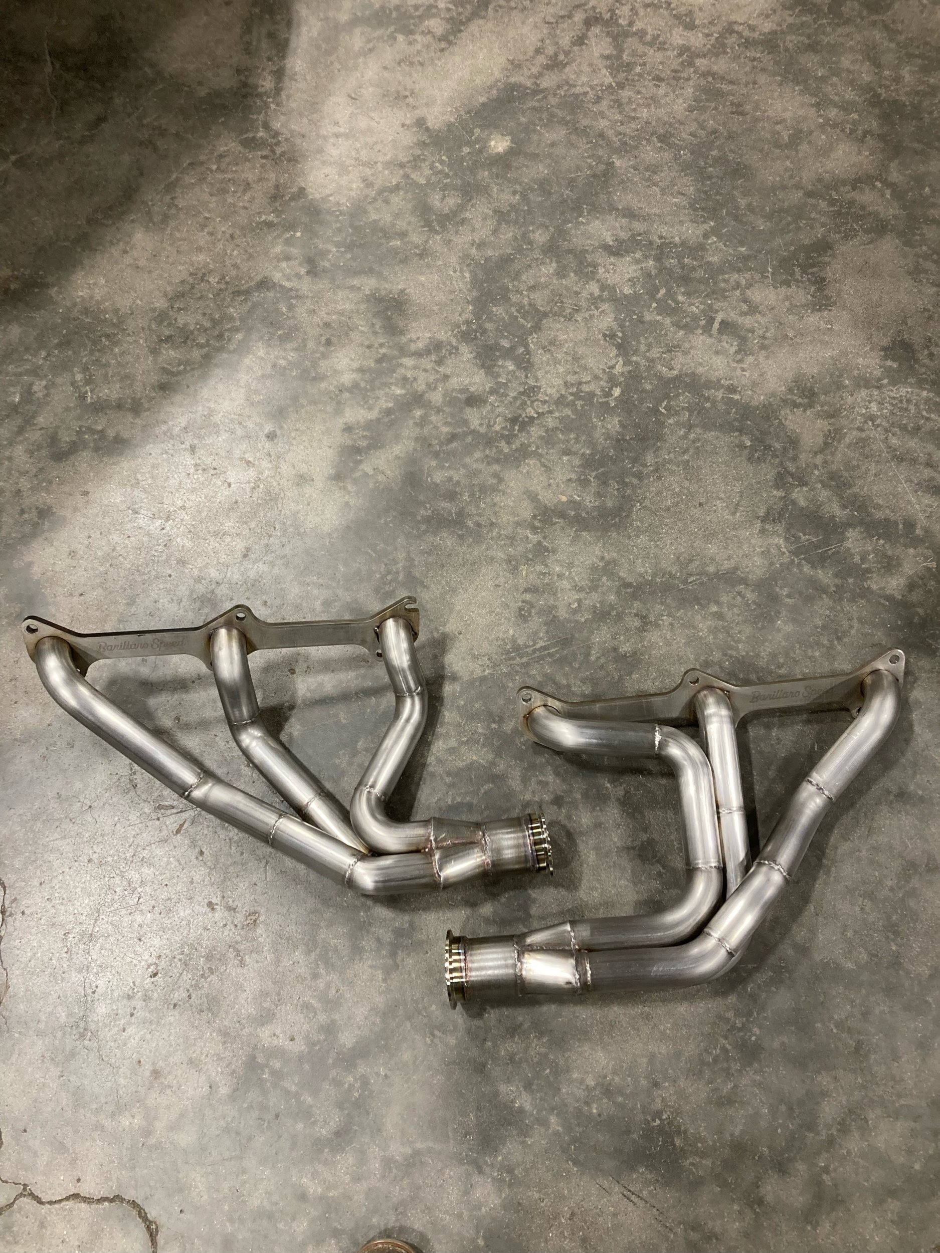

    I thought I had other pictures but this is it. Mike and Jim Barillaro do killer work. They are in Knoxville Tn for those that don’t know. Barillaro Speed Emporium.

    Sweet, I'd bet that over the next few months you get a lot of compliments on how great it sounds from folks. You don't always have to be able to hear them from inside the car to have a great sounding set of pipes.

    I bet that tiny human in the back seat likes the new exhaust.

    Redhead Headers?

  10. Agreed 1-3/4" max.

    The Barillaro brothers are expert craftsman in all areas of hot rodding, Mike is especially adept at fabricating custom headers that's why I call him "The Exhaust Wizard".

    with the headers and that size pipe, that X will do zero...but it's cool A/F so I would leave it,,,
    You probley lost low end grunt, and killed the 60' time at the drags... but the cool factor pegs the needle... impressive job on the exhaust...for me.... I would add another V band and make a test pipe that fits where the muffler is.. then you could run straight pipe or mufflers at will...probley find it not all that loud with out mufflers... the shop made tips look perfect...

    Ever since she was a baby she has loved riding in this car. More so than my others. Yes she doesn’t have to wear the ear muffs now with the quiet exhaust

    The white headers were made from a 36 torque tube by Mike and Jim. They also built the stainless headers.

    Definitely a good idea about the mufflers.

    beings i own a custom exhaust shop in vegas.... this is the kind of well thought out exhaust system i like looking at....4 bolts and you can have the whole center section out and on the ground

    Sweet system! It's wise to have the center section removeable for future maintenance. Even though the 2 1/2" pipes may be a tad oversize for a flattie, there is still a little more back pressure, a.k.a. resistance of flow, than the straight side pipes, which helps, and I'll bet it sounds *****in'!

    Back pressure is a myth. But that's a discussion for a different thread.

    I bet the x-pipe and overall pipe size are doing a lot of muffling and making the sound deeper on his setup. I bet if he changed the pipe size to something more optimal for power and no other changes the exhaust would wind up being a lot more obnoxious.

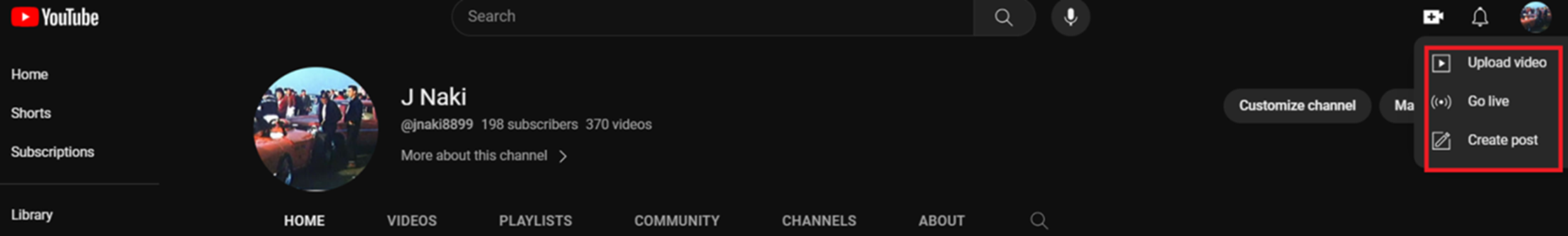

    Once you have created your page, then click on the red highlighted box +. That goes to the next screen to up load your film file saved from your files in MP3 or mp4 style. Those are best to save and use.
    Now, you are ready to upload your saved film.

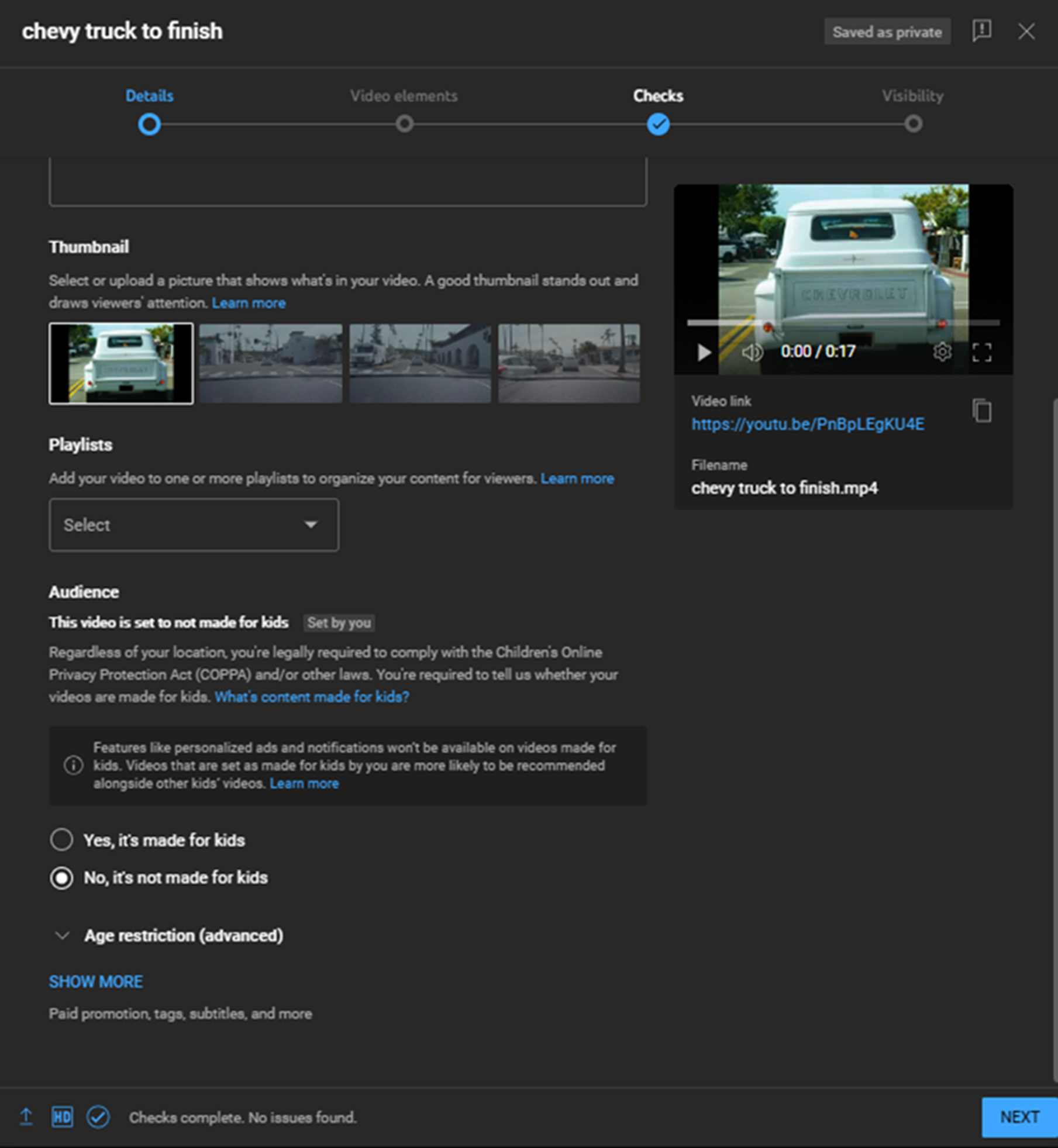

    This new screen is important. If you check "not for kids," then the process moves on to the next screen, if you check Yes it is for kids, then it is another whole set of screens, etc. Just check not for kids and everyone can see it finished. I also made my own thumbnail photo, instead of a You Tube generated thumbnail.
    Once the film is edited on your computer and it is ready, save with a specific ***le. For sample sake, this one is labeled “Chevy Truck to Finish.” In reality, it certainly looked finished up close. Another section calls for a thumbnail that will be the visual description of your film on any website or your You Tube channel.
    They automatically find several shots and you select one. Or, you can save your own photo, but make sure it is smaller than 2mb so it can qualify as a custom thumbnail photo. (most digital cameras are shooting in over 6 mb-20mb+ per photo. Most phones also shoot in 5-10mb.)
    The action you do on the screen pops up another screen telling you of the progress. And/or some type of violation with copyright, like adding music from a popular source, etc. Since most of my films are taken in a silent mode, there is no commercial music added, nor would I want one. It just detracts from the action. Who wants to watch a drag racing video with smooth jazz playing in the background? Or even rock music of sorts? This is where the copyright problems start.
    If you want people to see the saved video anytime, then check “Public.” Otherwise no one can see it publicly. Now, the You Tube search feature we all use to find a video comes into play.

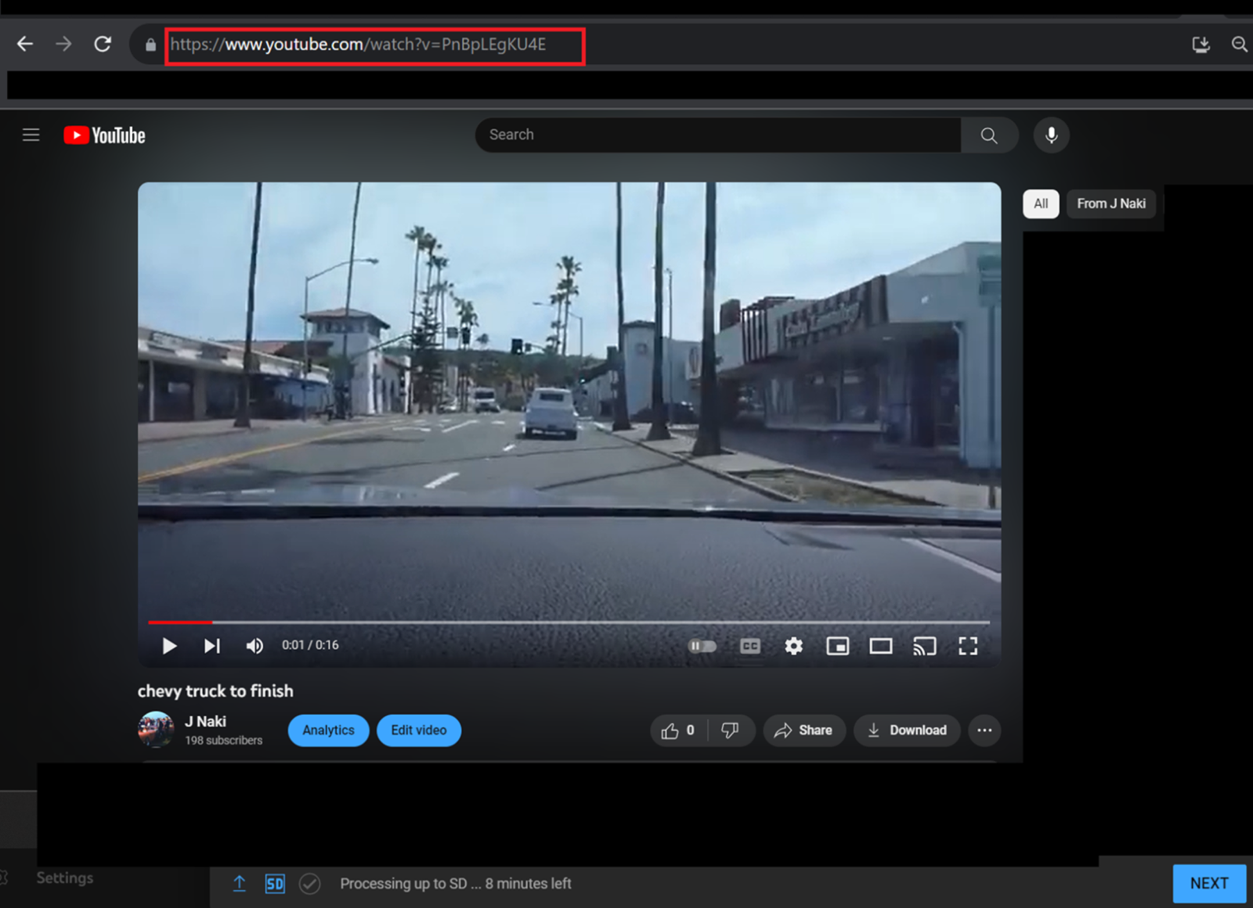

    The final screen pops up to show you where your video is located. Now, open the film and copy the top information box.
    The last screen to check is your channel home screen.
    Click on the video you want to watch. Once it comes on your laptop screen, then copy the HTTPs// address.

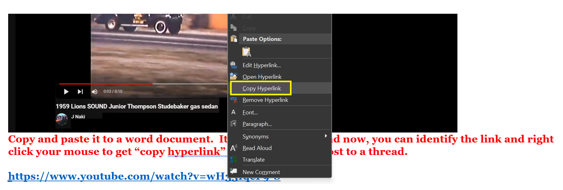

    When you make your video, copy the top information ***le:
    Copy and paste it to a Word Do***ent. It will post cleanly and now, you can identify the link and right click your mouse to get “copy hyperlink” you are ready to post to a thread.
    When you paste and then right click on the address, you will get this pop up. go to "copy hyperlink" and copy that choice. Now, you can paste that copied hyperlink on any thread as part of your typing of the story presented.
    The thread shows the link, but not the video, as yet. When your finally click on "post reply," then as it gets posted to the HAMB thread, the screen fills up with the actual video with an arrow to view the film.
    This bit of information is the one you can post on any website that allows video links to be posted.
