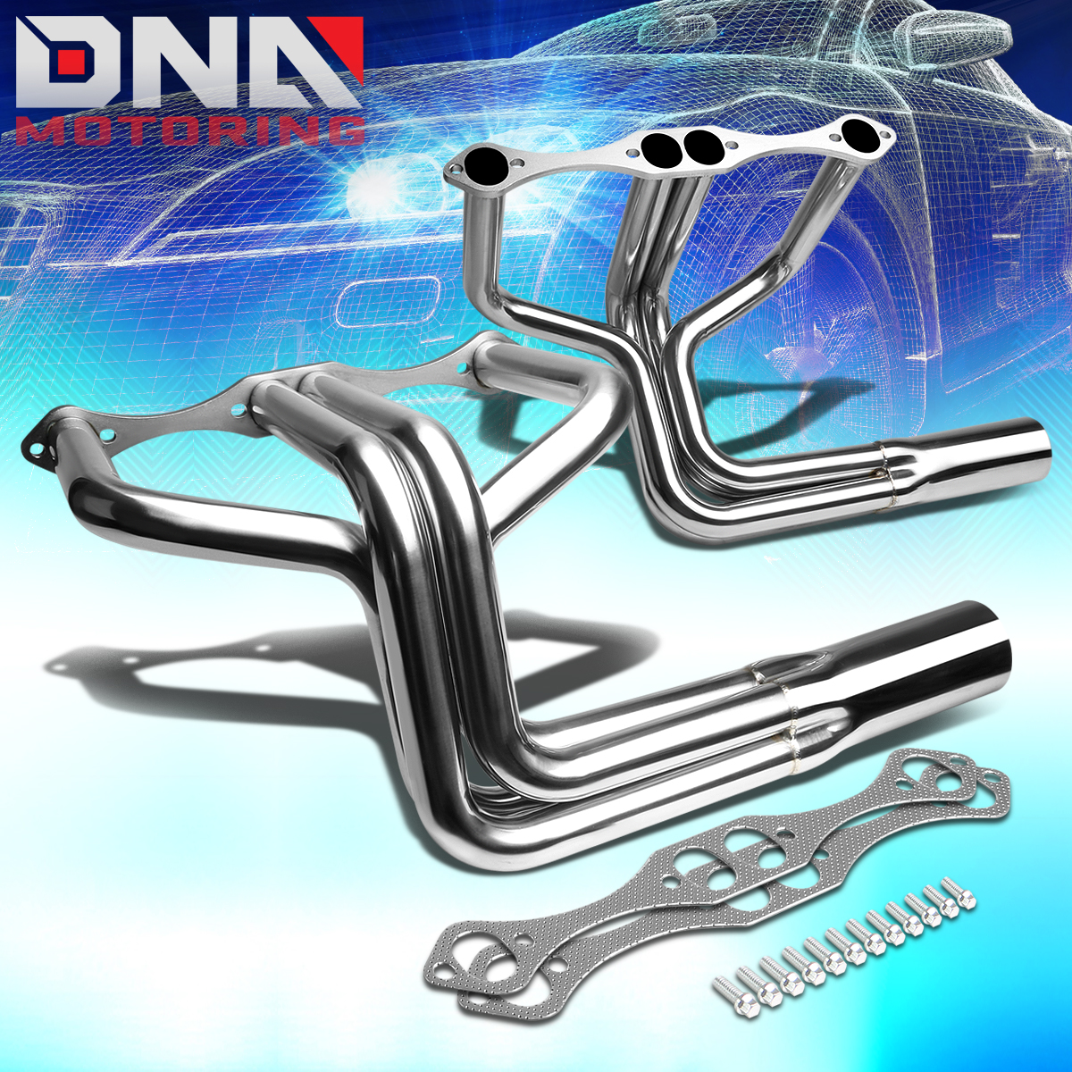

    Hi guys! I'm wanting to install a set of outside ch***is headers on my 1930 Model A, similar to graffiti headers (pic attached). Does anyone know if these will work on a standard Model A wheelbase and clear the front tires when turning full lock? I've looked for pictures and not much luck. I see lakes headers all over the place, but I'd like something a little different.
    Anyone have any advice or pics they can share?
    Thank you!!!
    Pat

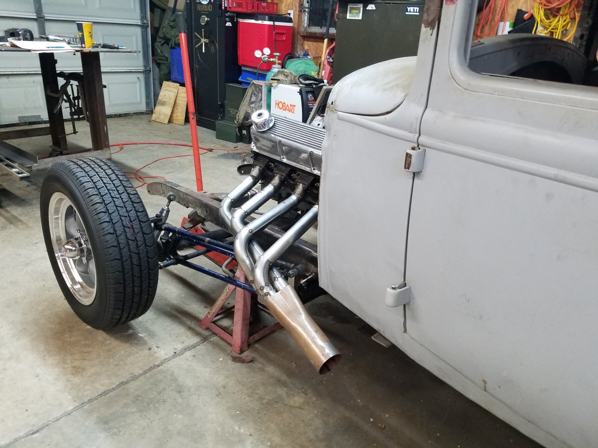

    Highboy style headers on mine, Tires wont hit turning and through full articulation of front end 52.jpg
      133.8 KB
      295
      133.8 KB
      175

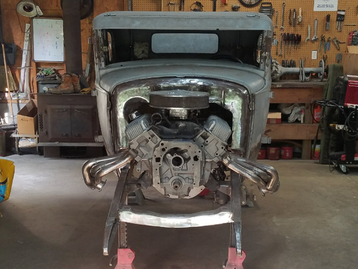

    Home built from Schoenfeld J bends.
    WC145, sandman460, alanp561 and 4 others like this.
