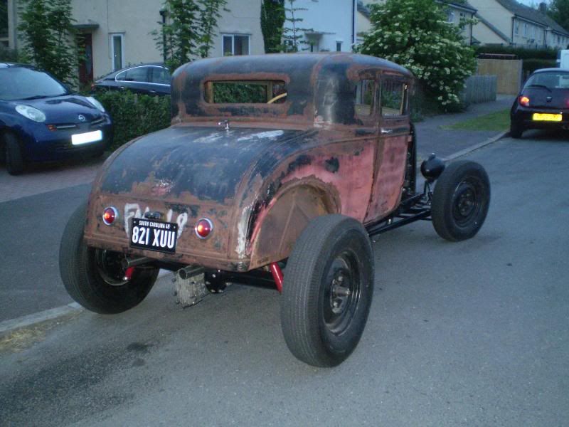

    For the last couple of weeks both myself and Pete have ben putting the hours in after work, weekends and the whole of this bank holiday (the girlfriend's stopped talking to me [​IMG] )
    Front and rear brake lines are now run and clipped in (still have the flexi to go in and bleed). The wiring is almost there, rear lights/flashers work lovely and for some reason the rad fan comes on when you put the right hand indicator on [​IMG] luckily Pete sorted the spaghetti out! Hopefully all the visible wires are now sleeved in black cotton overbraid from Synders.
    Oil lines are all plumbed and hopefully all leak proof. Fuel lines have been run in a mixture of 8mm copper and rubber fuel hose. We're running the electric fuel pump and filters on the inside of the bulkhead to keep the underside of the car and the enginebay tidy.
    Radiator is all plumbed in and at the moment it appears as we only have a small leak where the temp probe is routed through the top hose, so with any luck a little silicon sealant.
    We've mounted a tiny gel battery under the seat to help keep the boot space free and to keep things neat aswell. A little more fettling was required when we found that my fat ass bouncing on the springs meant there wasn't as much clearance as we hoped, so we just cut a dirty great hole in the wooden floor!
    Talking of seats here's a sneaky peek at the one I'm using. It's been covered by a friend of mine that swore blind he'd never touch another Mexican blanket! Don't whatever you do cut one, they just start to fall apart [​IMG]. Well the seat will make do until the winter when if all goes well a leather replacement in a more traditional shape will be the order of the day.
    Did I forget to mention that she runs!!! [​IMG] [​IMG] [​IMG]
    The French motor from Jim sounds really strong, just waiting on a dizzy from Bubba in the US and then the motor can be timed. Oil pressure is good.
    Still a lot more things to finish up, all the tiny annoying jobs that require the patience of a saint and the left hand of Jeremy Beadle.

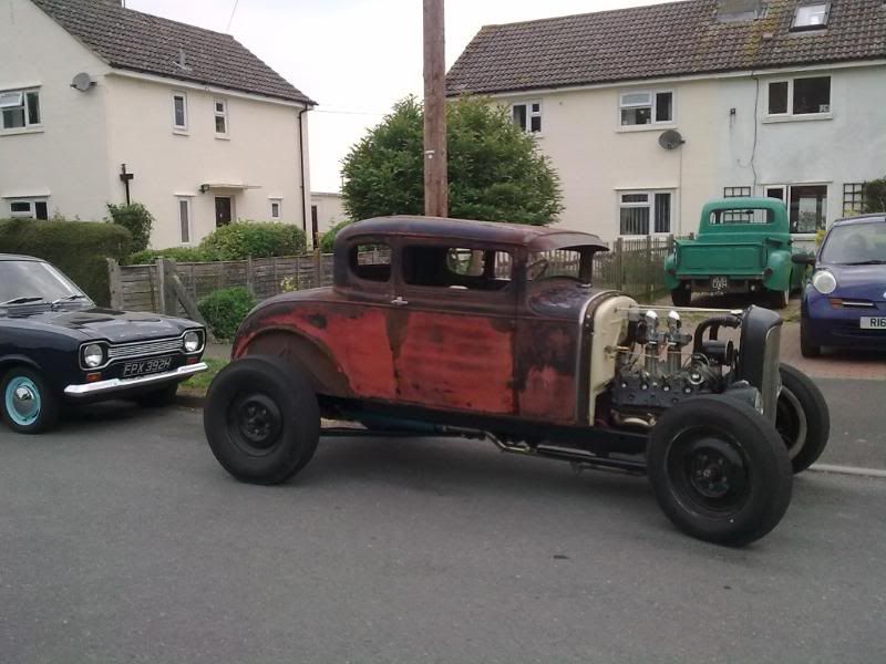

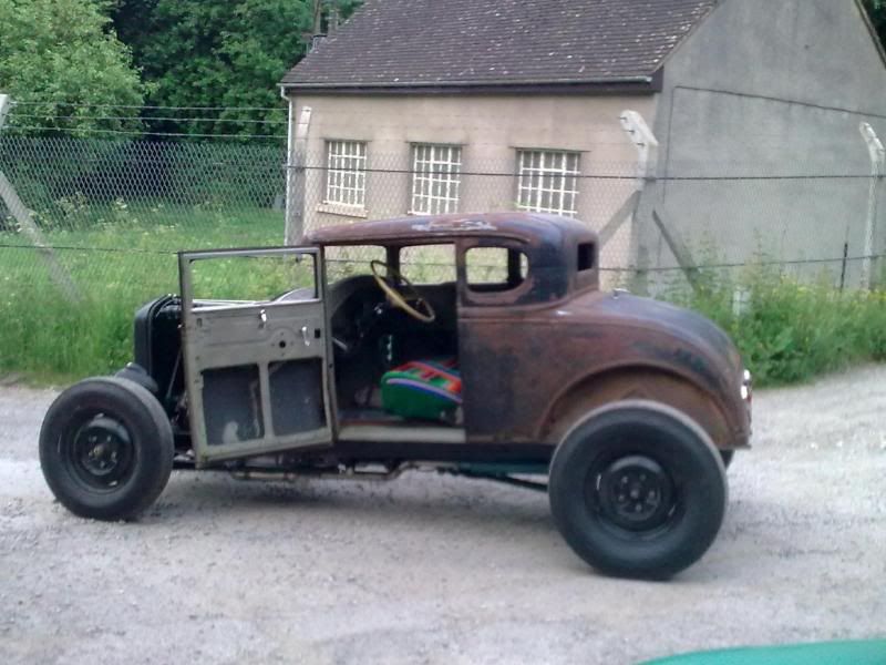

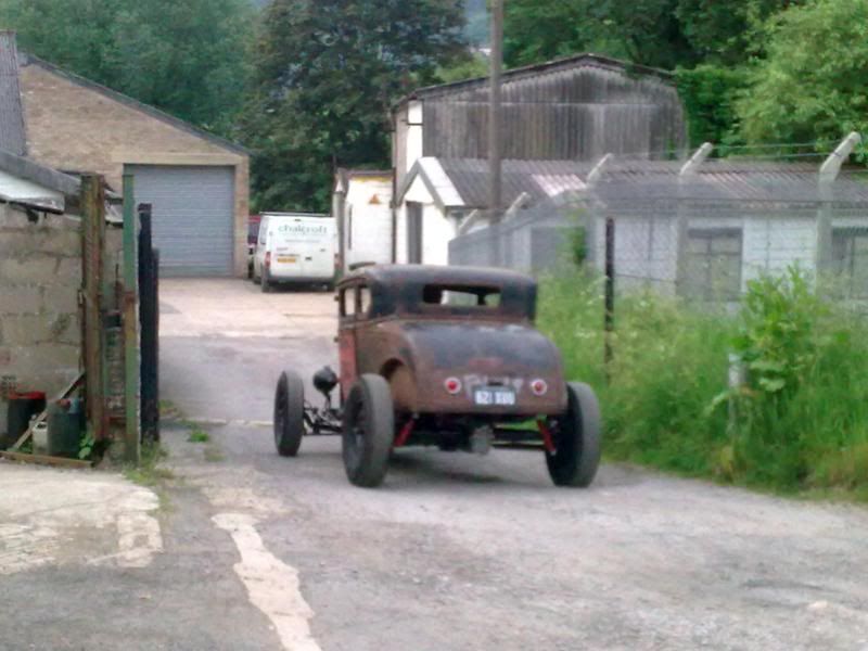

    The Coupe hit the road today! It's mean, it's nasty (admittedly a little rattly [​IMG]) but bloody hell it's incredible.
    After a fair few hours finishing the wiring, tightening a few things, fitting the floor,seat, greasing and filling with fluids, we drove the coupe out into the early evening light.
    I was anxious as anything when I fired the engine up and put her into gear, expecting a jerky clutch, notchy steering, poor brakes and a lumpy running engine.......how wrong could I be! It really is a testament to the quality and attention to detail of Pete's work.
    Gearbox is smooth like the Fonz's chat up lines, the steering is surprisingly good (little free play but it's a 50 year old F1 box running on crossplies). Suspension is great and soaks up the Gloucestershire potholes easily.
    Engine [​IMG] , considering nothing is set up and the dizzy is fixed with 15 degrees advance (vacuum only advance dizzy (not hooked up)at the moment until the one from Bubba turns up), it's strong smooth and has some get up and go. Pete told me to keep the revs down to about 2000 and take her steady and short shift. I hesitently took her out for the first time , slowly slowly catchy monkey. After a change of drivers Pete gives it a try out.... I followed in his Rover powered F1 pickup and even with my foot flat on the floor my car was disappearing over the hill [​IMG] [​IMG]
    There are still a lot of things to tidy up, but for now I'm going drive it, enjoy it and smile my ass off all the way.
    None of this would have been possible without Pete who has done an amazing job on this car, stamped his mark on it and woked tirelessly to make it what it is. Thank you Pete, you're a true mate. <!-- google_ad_section_end -->
