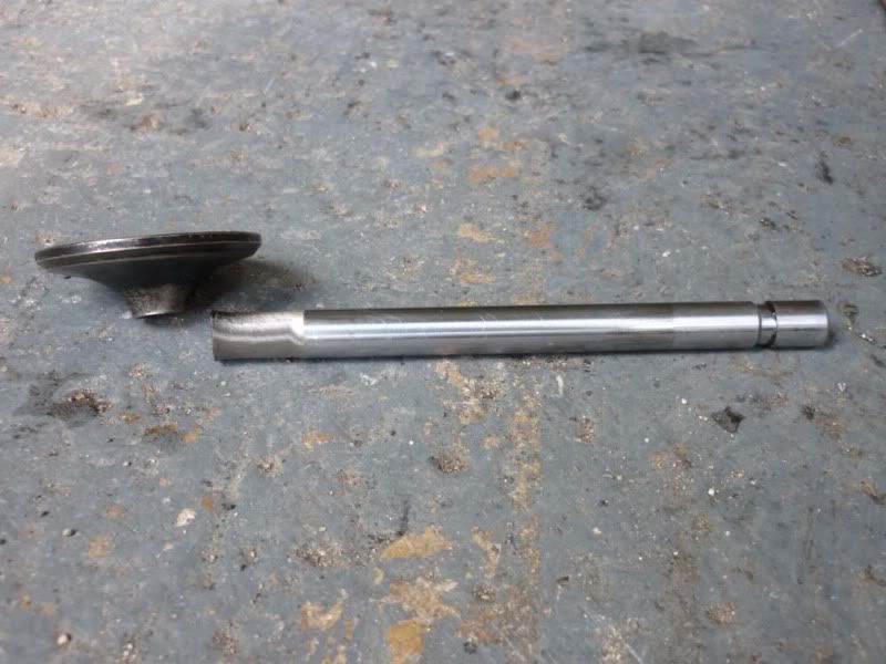

    So on 30th of August last year the engine was in and running sweet. I was gently breaking her in cruising round the local towns and villages and enjoying the countryside. I picked a mate up and took him for a spin and then things took a turn for the worse......
    Here's Pete's synopsis..
    "Nathan was putting on some miles to run the motor in for the drags it developed a misfire and strange noise. So after talking with Jim and running a few tests at Jims request it was found that a valve had hit a spark plug.
    Jim being a good all round chap who stands by his work arrived at Rich's shed this morning with tools and parts to dismantle the motor to find out what had happened.
    Removal of the head reveiled a broken valve. Bit of a strange one (I think J.P. has pics, hint hint) as it didn't appear to have hit anything and also didn't look like it had bent, but just broke in two just below the point where it gets wideat the base of the valve.
    Jim fitted a new valve, checked all the clearences and removed the other head to check that as well. Left Rich's shed at 7pm with the motor running sweet.
    Big up to Jim, having looked at the break I think it was a duff valve and nothing that was Jims fault, yet he still drove the 2 hours up this morning and spent all day on the motor and has prob only just gotten home now.
    Nathan has just gotta put some miles on it and ramp the **** outta it at the drags, bring it on.
    Pete"

    In my laymans terms this is what had happened
    "Pete pretty much summed up what happened. The engine was running sweet as a nut last wednesday, cruising at about 60-65 in top occasionally bringing the revs up and with no warning started to misfire. On tick over the engine sounded like pidgeons stuck in your loft (that's the only way I can think to discribe the fluttering noise coming from the head). It wasn't until thursday after work I could get back to the car and have a closer look, removing the plugs revealed that No7 inlet valve had flattened the plug's electrode.
    When I spoke to Jim and relayed the information he sounded quite relieved having spent a day worrying as to what the issue with the engine might be. Without any hesitation he said he'd be up on sunday with everything required to rectify the problem.
    As mentioned the valve appears to have broken fairly cleanly, with no twisting and can only be down to a bad quality batch. (Jim has said that the valve will go back to the maunfacturer for annalysis)
    I have to say that I'm totally amazed by Jim's commitment to providing the best service and high standard of work, he does go way beyond what anyone could ask. Top guy. Unfortunately we were so busy all day I didn't even get to buy him a pub lunch [​IMG]
    Have to be JD and Dr Pepper next weekend instead [​IMG]
    Having got the engine back in it's hole (had to unbolt it from it's mounts and pull her out to get to the p***enger side head) we tried to fire her up. No joy [​IMG] After what seemed like an eternity trying to fault find we found that not only had the main fuse blown and the ignition circuit fuse but that the relay I use for the push ****on start was fried to! We byp***ed all the electrical ****e and eventually fired the motor into life [​IMG] [​IMG]. Sounds superb. Heads torqued down and Jim could finally make his way back home.
    20mins later I get a call from Jim asking if I had a spare fuel pump!! He'd only found a stranded boat tailed Fraser Nash on the side of the road. I'll be honest I don't know if Jim's made it back to Dorset yet.
    Once again a m***ive thanks to Jim for all his efforts, I can't thank him enough and highly recommend him and Jules to anyone thinking of having any Flathead work done.

    and here's the culprit, the ****** that gave us all grief on that sunday
