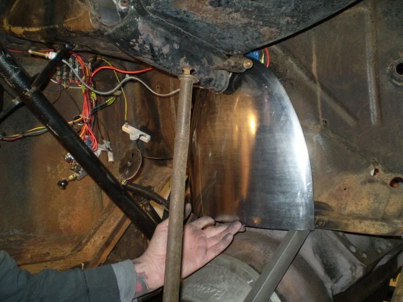

    "Been back working on the coupe the last couple of days and while it doesn't look much, progress is moving along.
    We left it last time with the body being placed on the ch***is to get an idea of how it'll look, so now it's time to start sorting how to mount the body and making new structure for the floors etc.
    The body is generally good but for the usual places where they rust plus some areas around the rear cross member which were expertly butchered.
    First was to make some support for the plywood floors around the gearbox tunnel. The wood will sit inside the 'L' and be screwed down with the trans tunnel either screwing down ontop or be sandwitched under, not made up my mind yet. You can see where the gear lever will come out.
    I needed to make a floor panel to cover the rear cross member and ch***is kick-up. Had a hard time trying to picture how it would be but just drew a blank, nothing would come to mind so I just fab'd it as I went. It's not very pretty but it'll do the job for this season and more thought can be given to it as the year p***es and it can be re-done next winter when the body gets done.
    Next was to make a sub rail for behind the seat for seatbelts. The floor here will be just plywood again so I made a small tapered panel which will be braced will some 4mm plate."

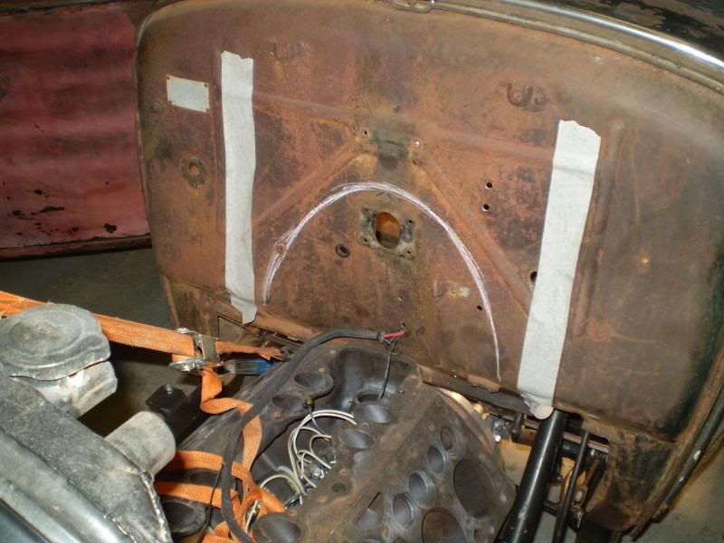

    Pete gives us another narrative on how he tackles the need to make a little more room for the Flattie..............
    "With moving the body forward and closing the gap so a standard hood can be fitted it will be necessary to recess the firewall. I want to do it in a way that won't stand out and look ****, so taking a guide from how Andy did the one on my roadster I started to make a compound curved panel which will have the ends bevelled over which will be welded to the firewall with it's edges bevelled over so it'll hopefully look like the original pressing just bigger.
    That's it for now,I need to wait for a while before I can cut the firewall. Tomorrow I'll hopefully do the front wishbones if I don't get snowed in again."

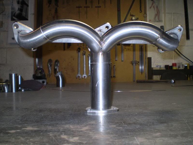

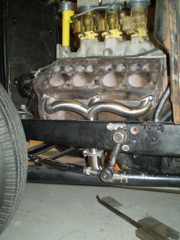

    Well we finally recieved the exhaust flanges from Paul at Wengparts http://www.whengparts.com/ (seems like DHL got lost in the Christmas rush). Laser cut in stainless, with a spare mild steel header flange to send to Jim to enable him to start on the exhaust ports.
    Don't know if any of you non Brits know but flange is one of our many slang terms for lady bits, the front bottom, hairy clam (guess you got it now, I'm not going to draw you a picture)
    Pete's put a lot of work into turning these 90 bends and flanges into these mad headers...
