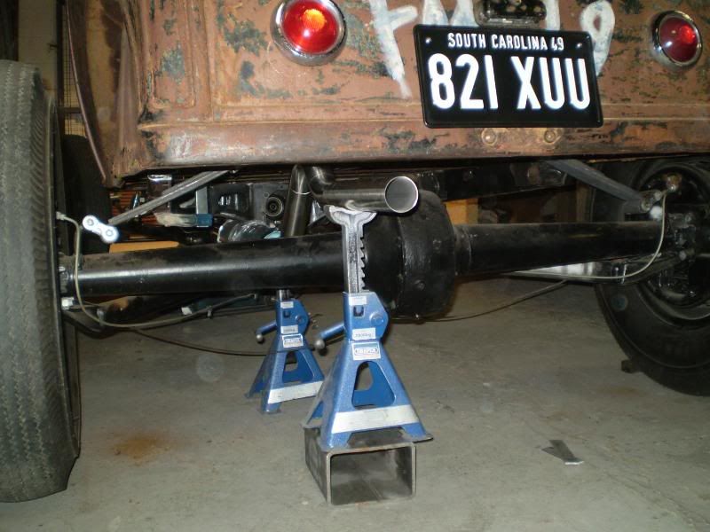

    You sir are doing some dam fine work. Just an observation, I noticed that when the boys from HotRod Works in Idaho USA do a rear wishbone set up like yours in one of their open drive conversions thye use a torque arm to keep from tweaking the rear bones. Have you had any experience with a setup like yours before? The only rod I built with a setup like yours I actually broke the 36 rear bones and that was with a very potent 4 banger. I see a lot of builders doing what you are doing and am just curious.

    We're gonna be doing a twin torque arm system once the prop shaft and the quick change are in. I could have made it before but decided to leave it so I can pick up some lines from prop etc.

    I do however have a concern about the position of the tierod you are using. I think the range of motion and the side stresses should be on the side of the joint ( like a steering setup) versus the pole direction. There is usually a spring in the joint between the joint and the grease cap and you don't want motion thoughout that spring. The way it sits in there now the thrust of the wheels wants to rotate the diff nose up and it will want to compress that spring in the joint. The joint is designed for side load and wearing longevity.
    I was going to run mine in the same fashion until I discovered what was going on.

    I did have some initial concerns that the joint would be the right one for the job but after seeing several companies selling the same style as a kit I thought it would be fine. I do understand what you're saying though. I might see about changing it for the sort that's fitted to the TCI mustang II front wishbones. Same sort of joint but designed for the up and down motion.

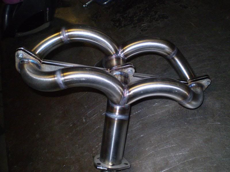

    Following on from the header a 2" stainless pipe with cut out has been fabricated and bolts up to a Smithy either side supplied by Geordie Paul at Duksville http://www.duksville.co.uk/
    Not an easy thing to photo and Pete would say a ****** pain in the *** to make,but his efforts are well worth it because it does look fantastic when you see it in person. Pete decided the system would look better if the silencer was bolted in place using the 3 hole flanges instead of normal exhaust clamps (he was right!) so 4 mild steel flanges were ordered as well as the stainless parts.

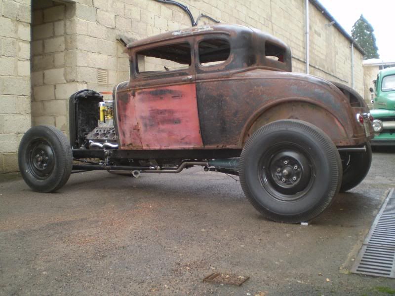

    we managed to roll the car outside to get some better side on shots to see how the silencers and the system looked in profile
    Things are coming on really well now!

    Car sits really nice.Great wheel/tyre combo.
    Lovely work on the exhaust.I have a bag of those small bobbins,think they're for Harley oil tanks.Thought they were too small to use on mine.Didn't think of doubling them up.Doh!

    "bit more progress today.
    I have now done the other header and both are now fully welded.
    A bit of tech for those who are interested.
    As you can see from the pics the headers are bolted together. There are two reasons for this.
    One, when welding the flanges will turn up (warpage) as the weld will shrink as it cools. By bolting the flange to another flange that will be welded they will both put against each other as they are welded and the turn up will be almost nothing. This works even better than bolting/clamping to a large steel block etc.
    Second, you'll see a small pipe on one end and a cap with a small hole in it on the other, This is so I can p*** pure argon through the headers as I weld them. This is called gas purging. What it does is gives any weld that penetrates (which is most of the weld on pipes like these) a gas shroud and will stop any oxidization (sp?) and will make the weld on the inside a nice smooth bead instead of the normal jagged ****ty mess.
    Last pic is just to show how the bead of weld on the inside looks when welded from the outside. This is a 6" stainless pipe and although the weld doesn't look neat it is clean and very strong."
