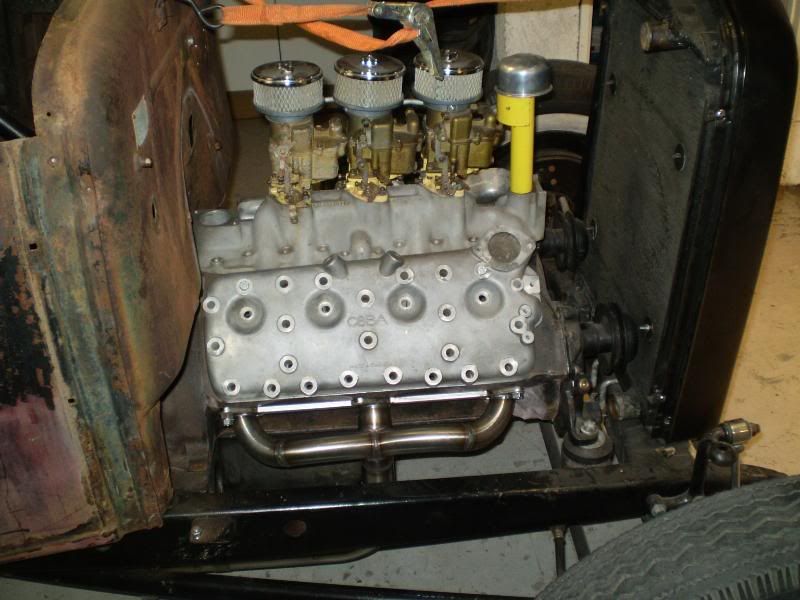

    "Had a bit of time today so started on the right hand exhaust. Already had the manifold done so was just a case of mirroring the left side and welding it all up.
    The left side is now fully welded and the right just has a few welds left to complete.
    Finally a pic of one of the inside welds on the actual exhaust. All the insides should be the same.
    Hope you are all still finding this interesting, let me know if ya getting bored etc.
    Pete"

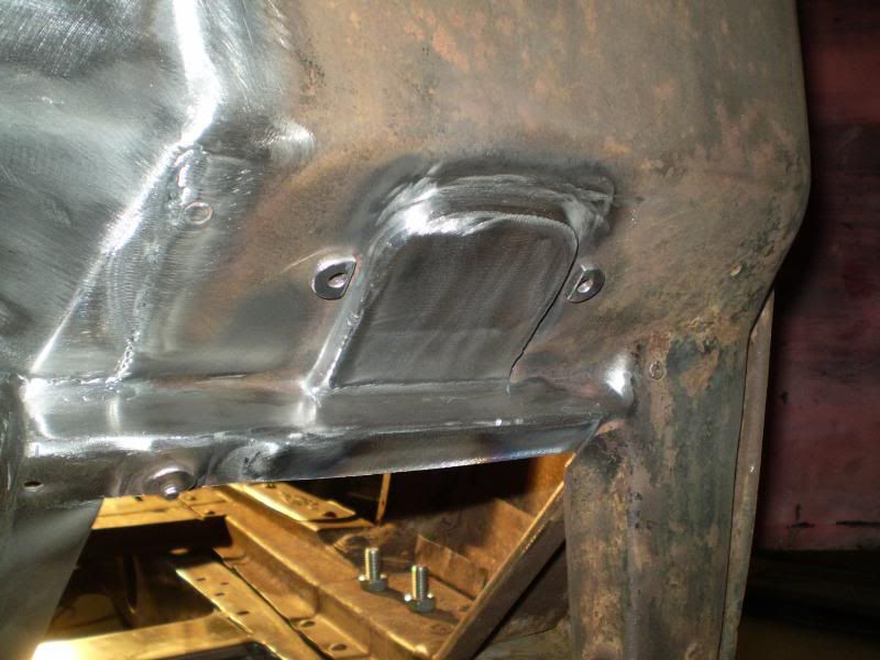

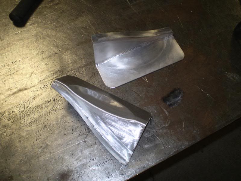

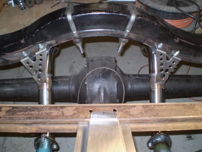

    Few more photo updates for you guys.

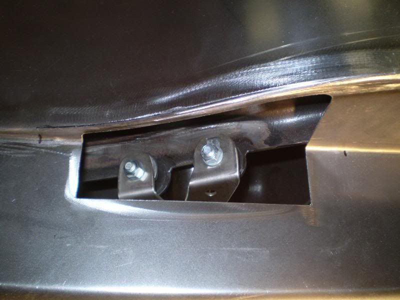

    To make the removal of the exhaust a little easier and to add some clearance above the rear exhaust bobbins, Pete fabbed up a pair of aluminium access panels that will get screwed in later on.

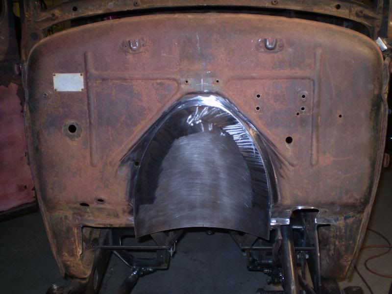

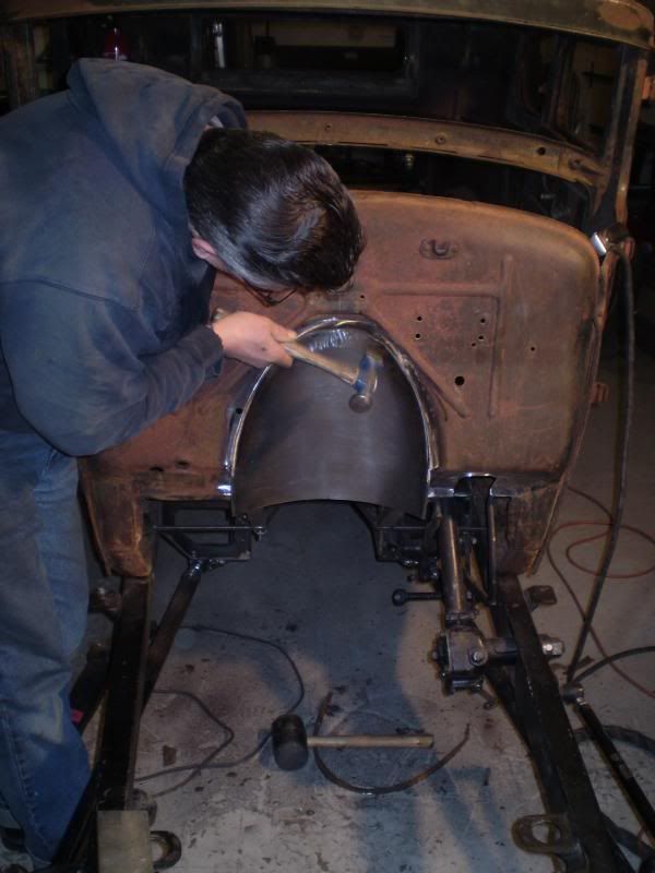

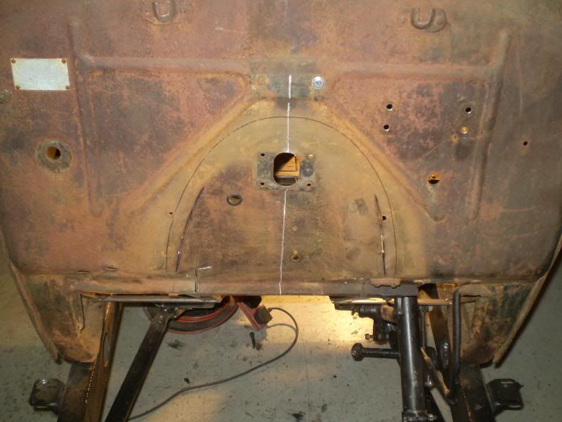

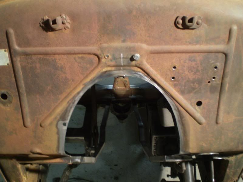

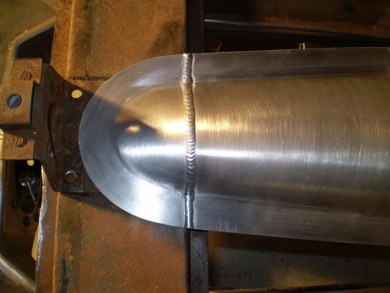

    from UK
    After ogling the heads for 20 mins with Pete mumbling lucky ******* under his breath, we turned our attentions back to the old collander.
    We dropped the exhausts, dropped the motor and box and pulled the petrol tank out (needs to be cleaned and sealed so that we can get shot of the ali tank in the boot). With everything out of the way Pete could focus on cutting out the bulkhead to then weld in the 1.2mm rolled panel he'd made previously.
    Pete beat a return edge on the panel to make welding it easier and leave a lot cleaner finish.
    A lot of tacking and hammering, welding,hammering and dressing
    Next thing to do will be to work out how the return at the base of the panel will run into the cab

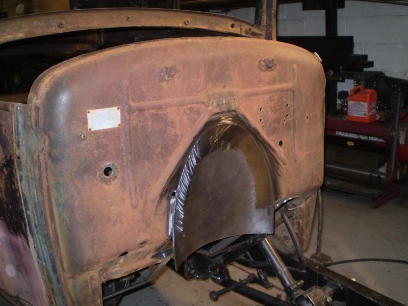

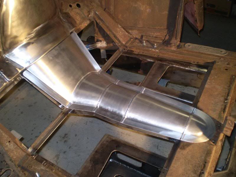

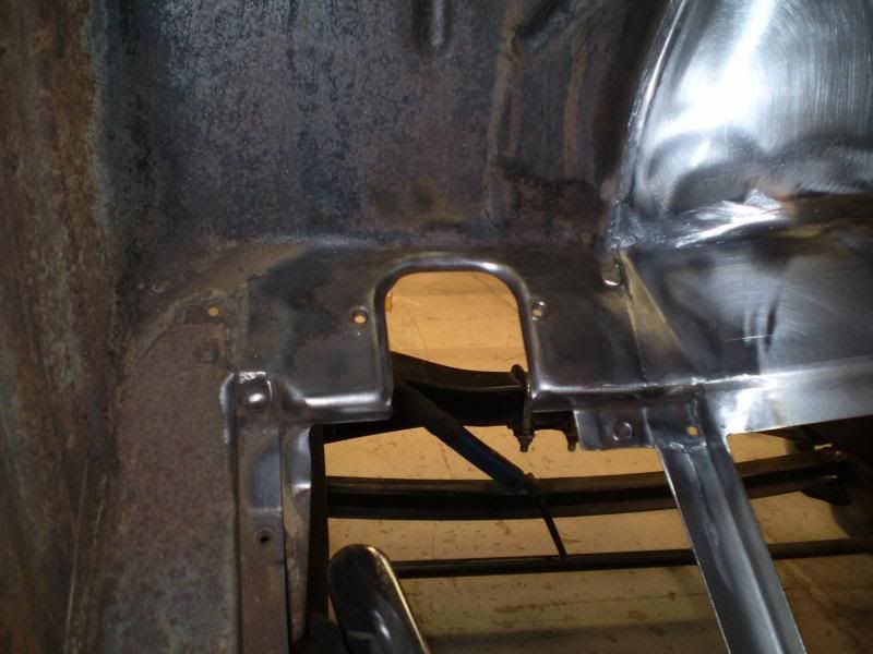

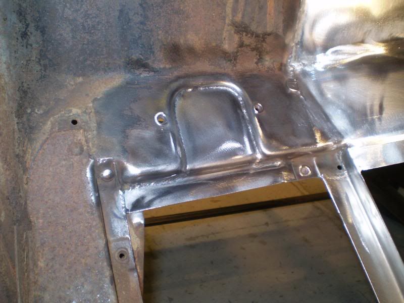

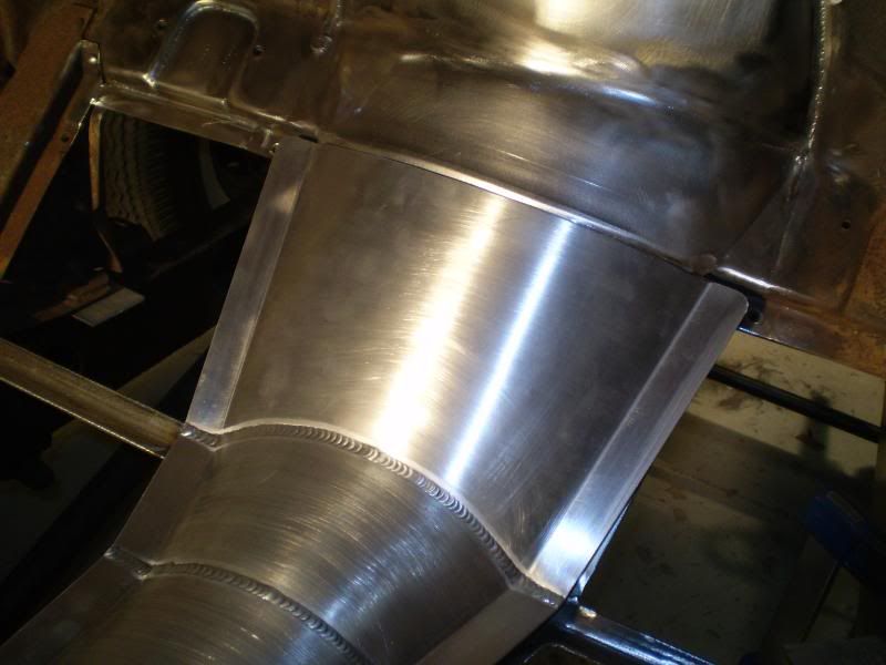

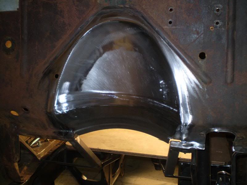

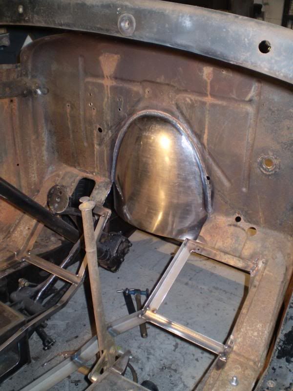

    Just in case any of you guys were wondering, Pete's got a handle on the transmission tunnel
    "been tidying a few things up today. Wanted to get the firewall recess finished. The main part was done the other day, so just needed to sort the return, weld and clean. Took me longer than I thought but came out OK.
    On to filling the existing hole that the steering colum went through. Make a simple plate and weld in and clean."
    this car is getting so close to being completely pulled down before the final build up. Roll on summer <!-- google_ad_section_end -->

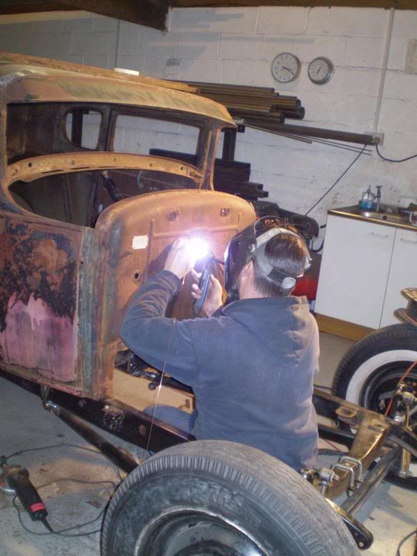

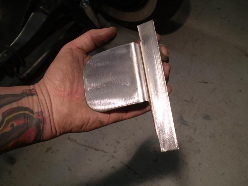

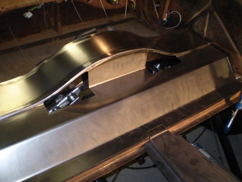

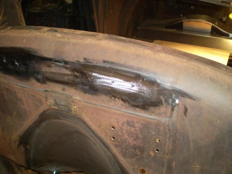

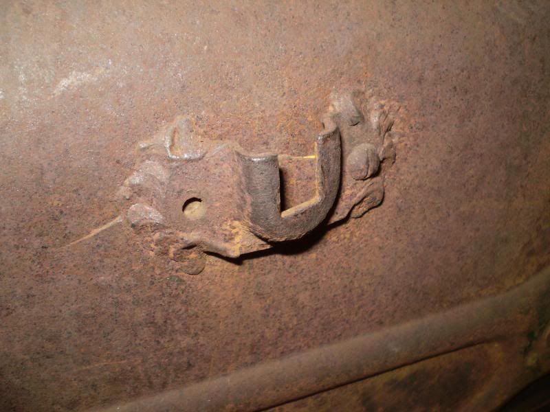

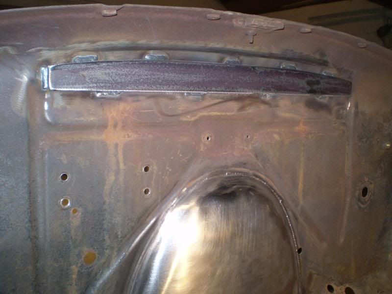

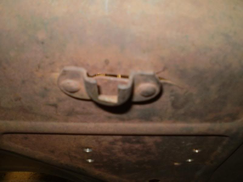

    "Now the bit I'd not been looking forward to. The little brackets that hold the rad stays were well ****ed.
    One had been welded on some time ago, not a bad job but would have been nice if they'd flatened and welded the cracks in the firewall before welding the bracket. The other one was just cracked and loose on the rivets.
    So, first thing was to cut them off, hammer flat the cracked plate and weld and clean.
    The one that was just cracked went nice but the other was an ****. What was left was thin and didn't want to be straightened. So it was never going to be stong enough to do the job required so I decided to weld a 40 x 5mm flat to the back for support.
    Job done.
    Tomorrow I will be mostly beating ally!" <!-- google_ad_section_end -->

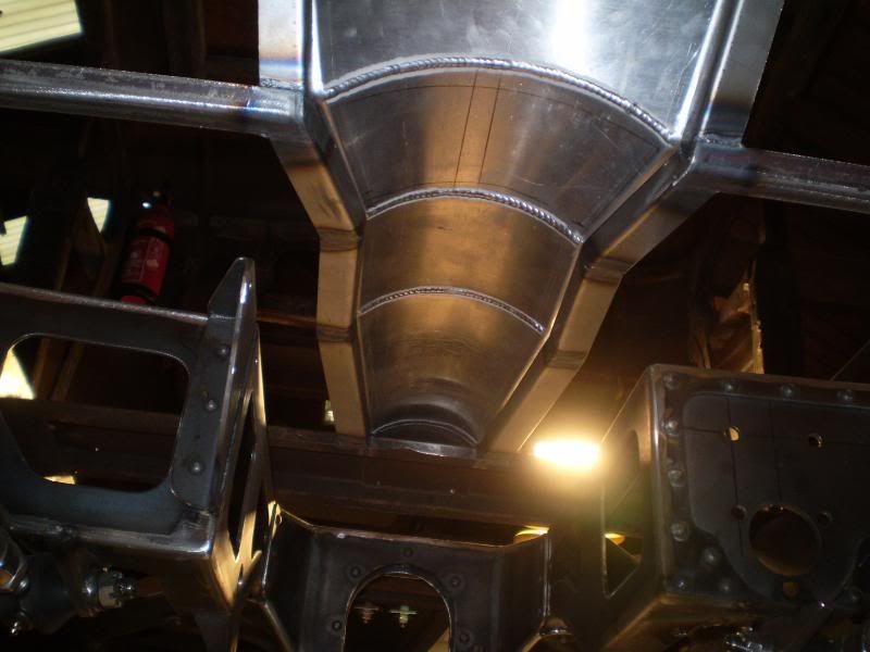

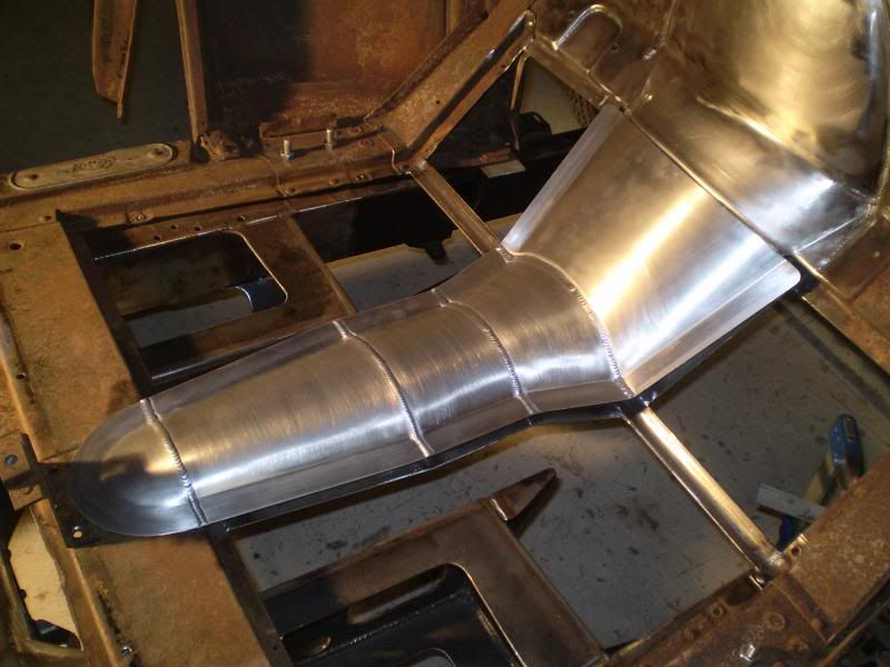

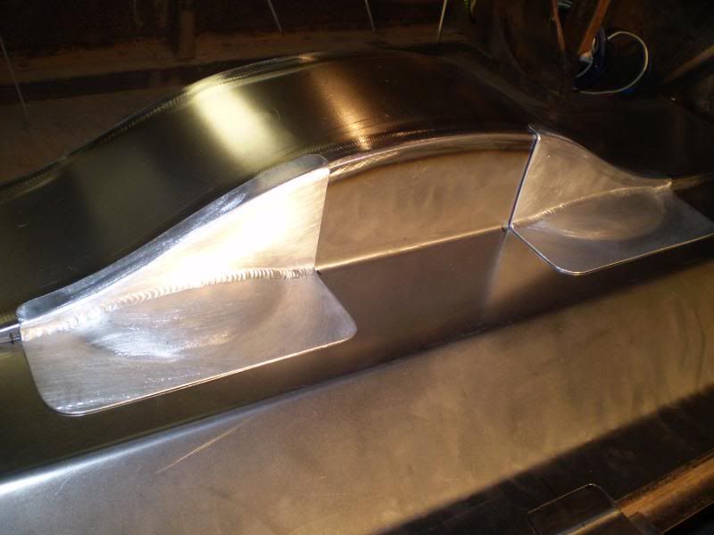

    Here's the latest update from the man that can, check out his tig welding...***y as f@#k!
    "As I said last time I have been mostly ally bashing today. Not alot to say really so I'll just leave ya with the pics.
    Cheers......Pete"
