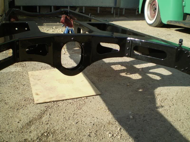

    Bit of an update for you, the ch***is is back from the powder coaters and looks very nice indeed
    I also called in to see Miles in his new shop in Farnborough, it's starting to look really good and is already equipped with hot and cold running Hobnobs, always a pleasure to visit Jackhammer.
    Picked up a new Walker rad, aluminium windscreen frame and a whole load of necessities.
    I stripped the front axle out and together with the front wishbones, is heading off for powder coat on monday.
    Pete has pie cut and welded the front wishbones hopefully bringing the castor back from 11 degrees to a more user friendly 8. He also welded the new bungs in for the tie rod ends.
    I'm heading over to "the Forest" today to pay Becky and Kelvin a visit. I bought a new kingpin set from Miles and Kelvin has the reamer for the bushes, so I'm taking the front hubs over (I've told Monique we're going for a drive in the country and stopping for lunch in a riverside pub!)

    Frames come out fantastic.Looks even better with some colour on it.
    Nice work!

    looking good nathan all you and pete have to do is put it back together

    that frame is a work of art

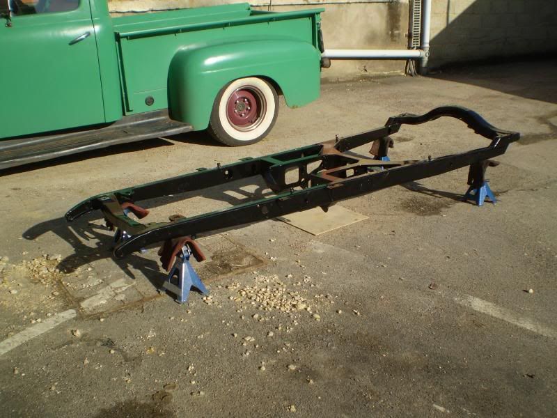

    Got the ch***is round at the lock up, front axle and wishbones have been powder coated too. Just spraying all the remaining front hubs, tie rods, ubolts etc ready to put the front end together. Oiling floor panels with Danish oil.

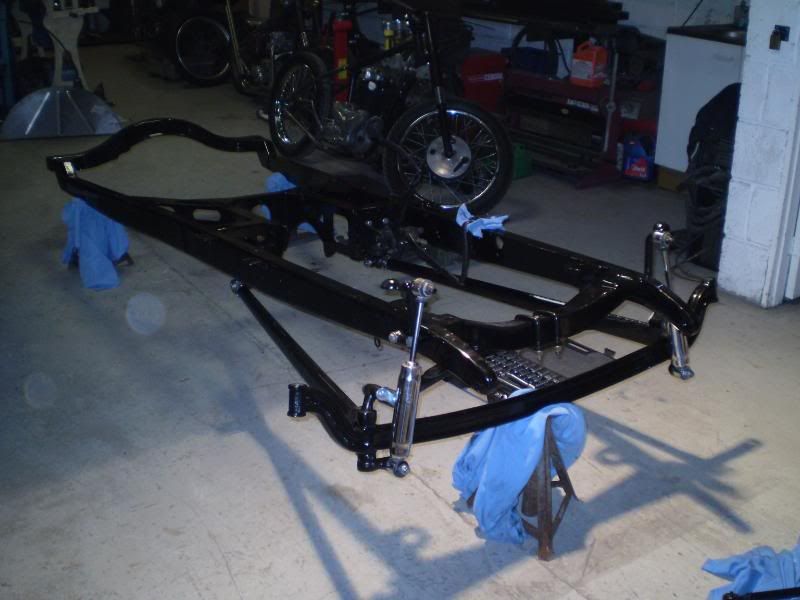

    Front axle, bones, shocks and pedal box in

    Nice rear!:D Ch***is looks fantastic in color!
