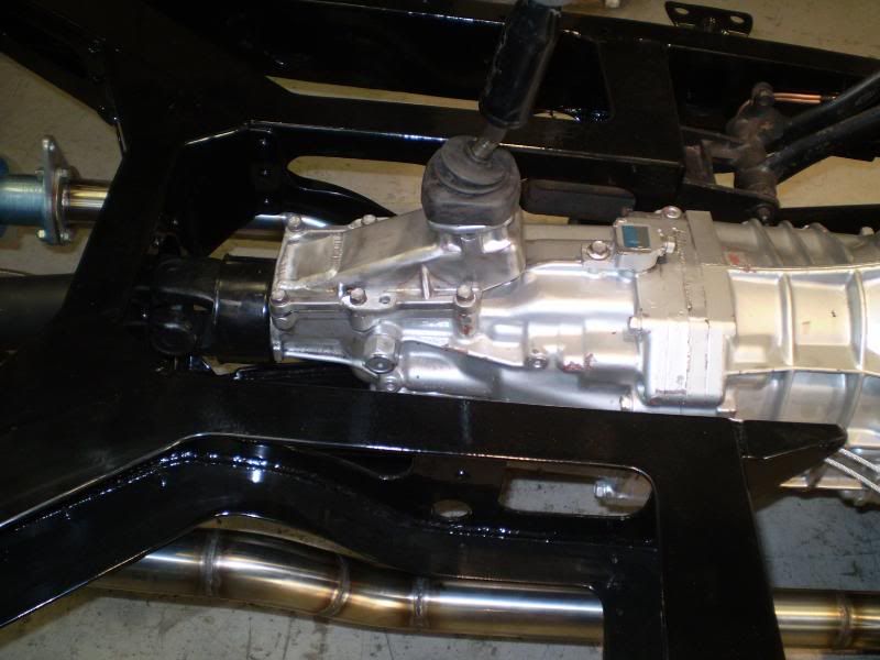

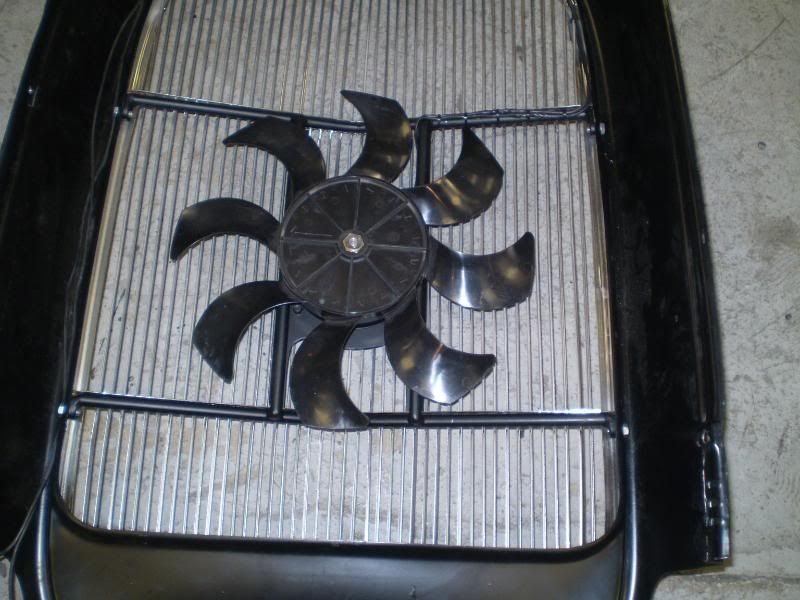

    Here's the latest update from Pete who's been working on the Coupe whilst I've been working away from home.
    "It's been a while since we had anything to show regarding updates. There has been a delay in the motor through no fault of Jims so we're going to run it with my engine until the built motor is complete.
    So we nicked some of Nathan's bits back and borrowed a few other bits from Jim and fitting up the french flatty. We've fitted the Supra gearbox with the Flatatack adaptor kit and settled the motor in the frame. Looks good and is nice to finally getting it back together.

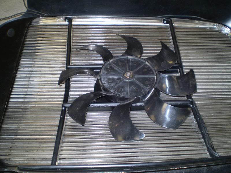

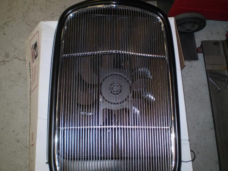

    First job was to change the way the electric fan was mounted. It was originally mounted inbetween the grill and rad and to make room the rad was moved back in the shell. Not only did it look crap it was also one of the things that started the rebuild. So I have removed the fan and motor from it's housing and made new mounts which are stronger and smaller and although seen from the outside is much less noticeable.
    Next on the list was to reposition the gear lever. For some reason the photos were all corrupt so don't have any of the modification. But here's a nice one of it done [​IMG]"

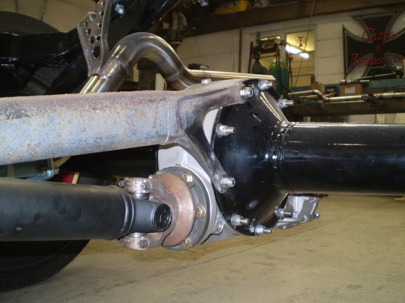

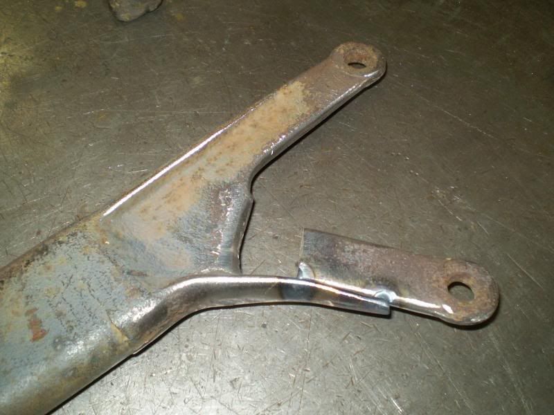

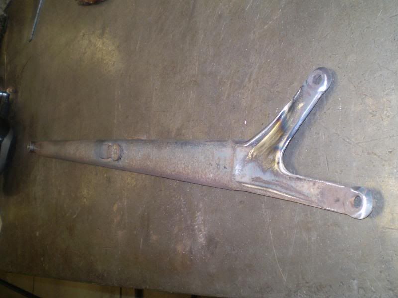

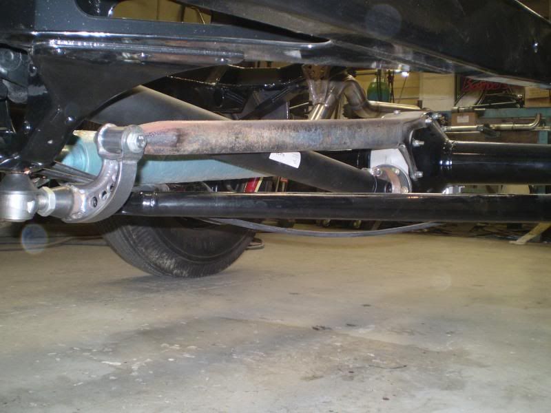

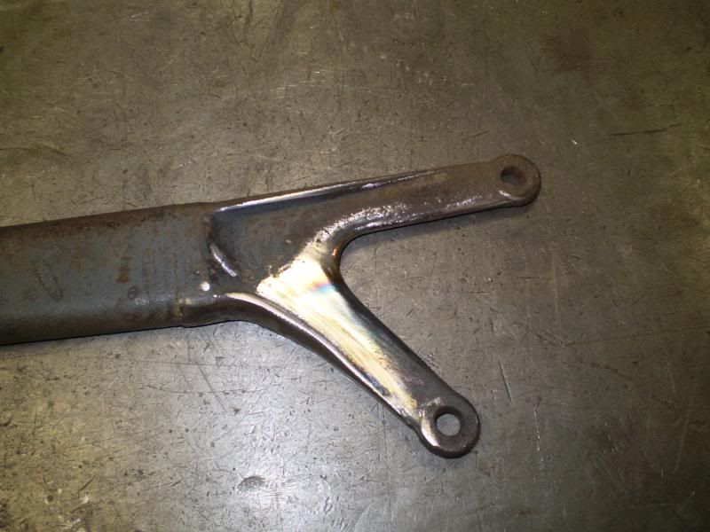

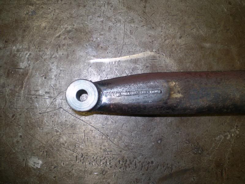

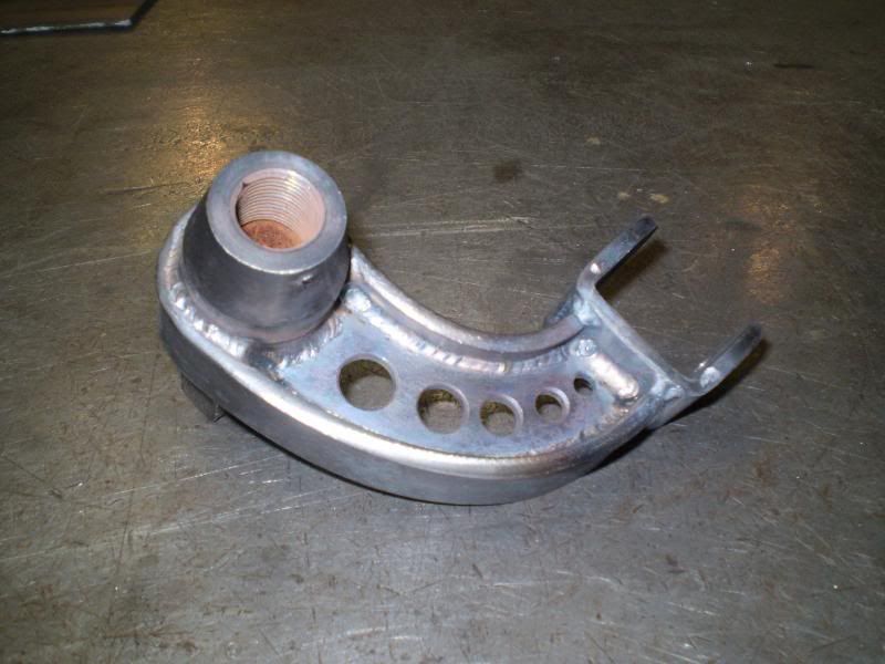

    Here's some more from the Boy Wonder...

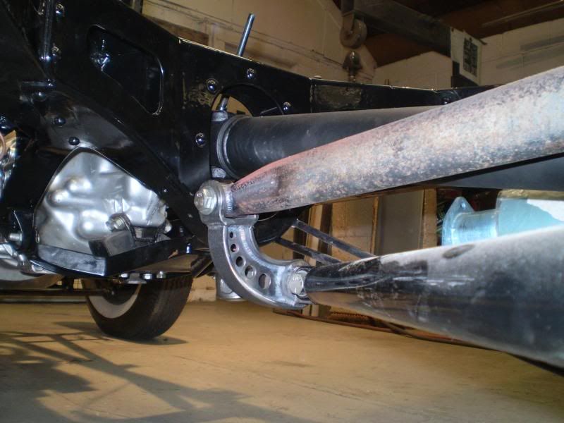

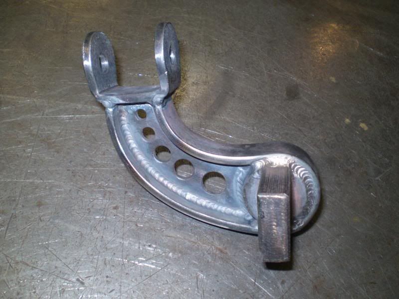

    "As a few guys pointed out the rear wishbone front mount was not gonna work. This was something that was always going to be changed but only after the propshaft was fitted. Well the prop is now fitted so it was time to sort the mount out. I needed to stop it from pivoting on the mounting bolt, so I fab'd up an arm to take the front of a torque arm. this will also have another arm going from the top mount to one of the wishbones just to add more triangulation.

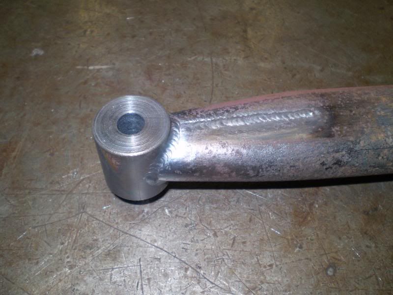

    Next was the torque arm. We used a standard Model A rear bone. Now I know they're flimsey crap but with a little work it'll be just fine. First was to run a thin cutting disc down the unwelded seam and then weld it fully. This made the wishbone much more rigid. Once cut to the right length one end was pie cut to give it more taper then welded to 30mm dia steel boss with a 10mm hole.

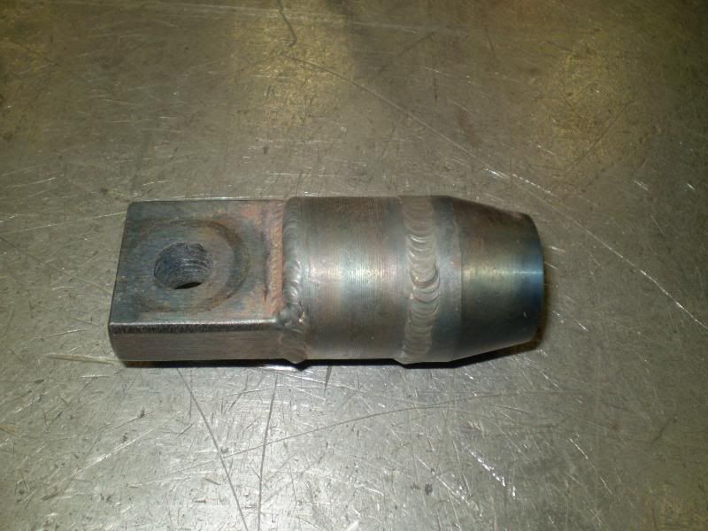

    The other end was then cut and bent to match the studs on the quick change. The original end was quite nice so it was cut to keep the outside casting webbing. Make a small filler peice and weld up and clean.
    And finally all fitted."
