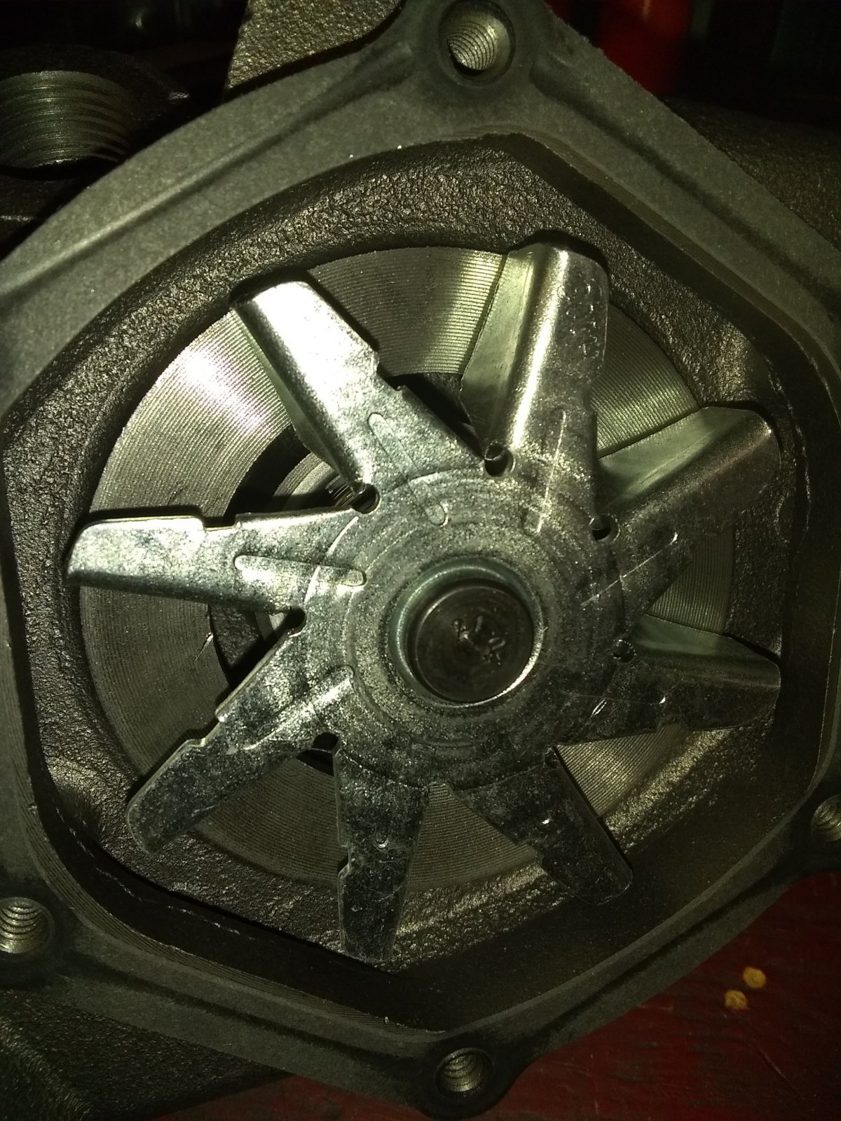

    Ok, just got this waterpump from NAPA. I asked for a waterpump for a 1977 monte , thinking they used v belts . I opened it up before installing and I think this is reverse flow also. Does this look like reverse flow? image000000 (16).jpg
  9. Mr48chev
    Joined: Dec 28, 2007
    Posts: 36,506
    Mr48chev
    Sure looks that way.

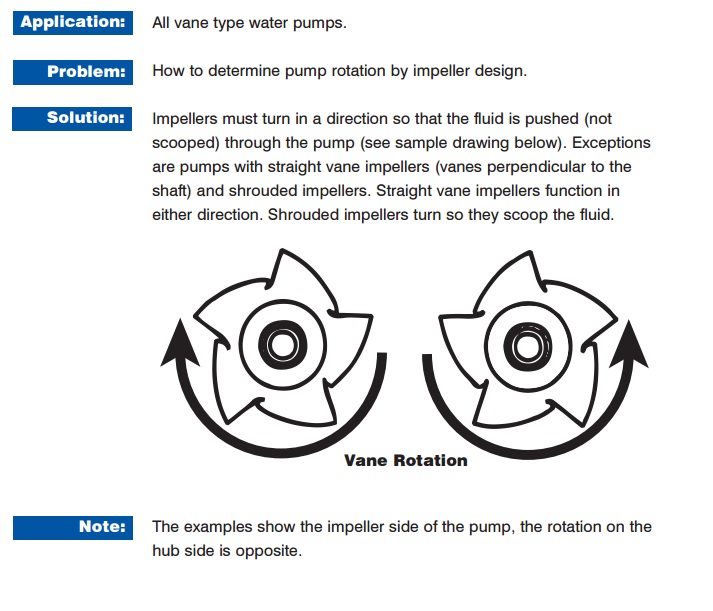

  15. That new pump looks to be what is referred to as a "straight vane" pump in post #62 ("solution" note section) because the 'vanes' intersect the center of the shaft. That's what I think I see but I don't know much about pumps or what you have for sure.

    If that pump is a straight vane, it will work either direction. Lippy

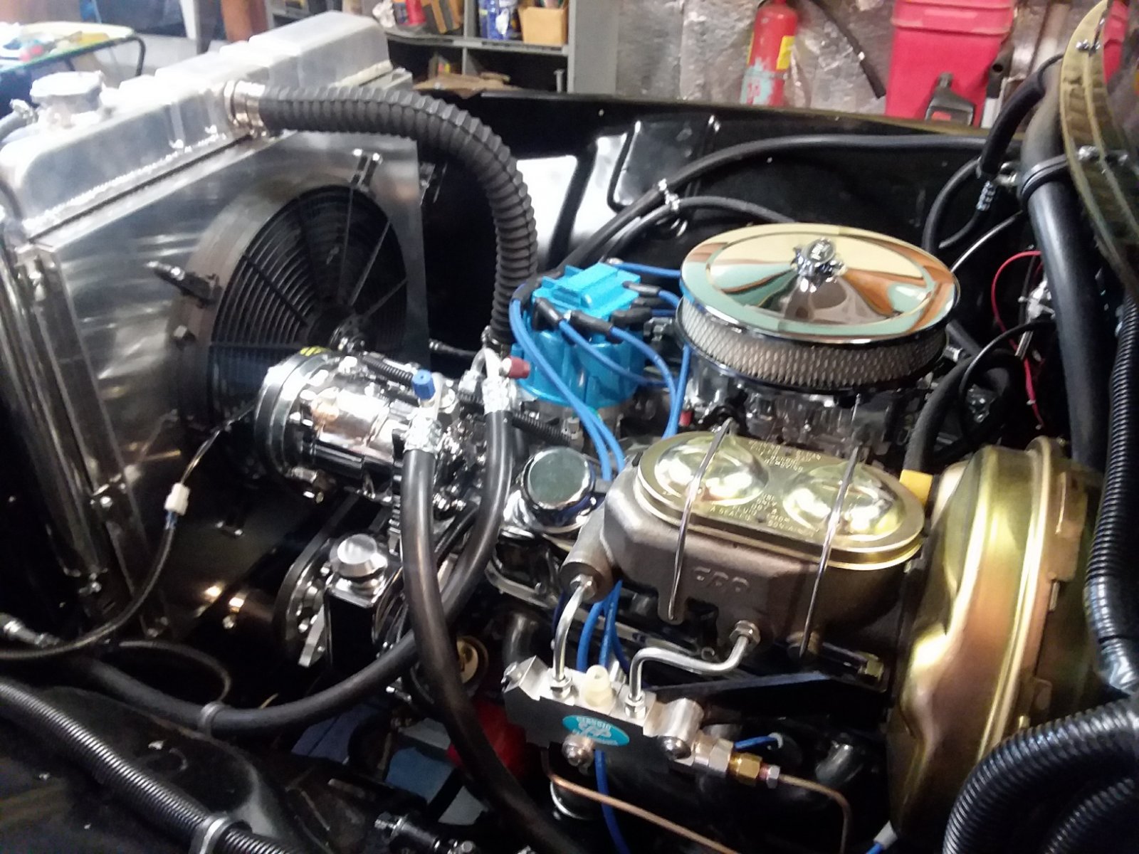

  19. Country Joe
    Joined: Jan 16, 2018
    Posts: 560
    Country Joe
    Fellow HAMB Members,
    I stand before you in shame and disgrace:(.
    I have found my overheating problem. Thank you all that offered help. It was appreciated and did indeed lead me to the path of a solution.
    And I feel every thread should have closure.
    So, here is a picture of the engine I built below. Have mercy.
  20. Moriarity
    Joined: Apr 11, 2001
    Posts: 41,122
    Moriarity
    SUPER MODERATOR
    Oh oh, put the intake gaskets on backwards..... dammit

    I was pondering my engine trouble and the intake gasket being installed wrong crossed my mind. I thought naw.....maybe? So, I took the heater hose ****** out of the intake and shined a light inside, over at the port and then I saw that wall of blue, DAMN IT!
    lol....I am relieved that it will be fixed with a new set of gaskets and an oil change.(trapped water went inside when I removed the manifold)
