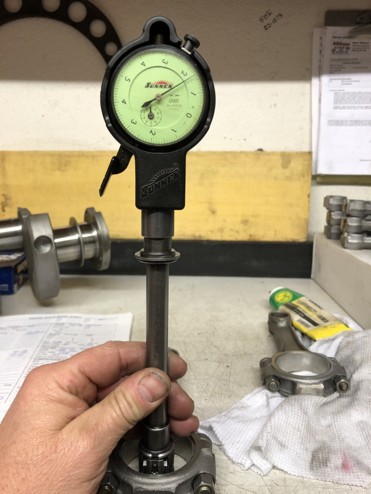

    Received theARP rod bolts, installed and torqued to
    35 lb ft measured 0.0002 - 0.0003 out round
    45 lb ft measured 0.0002 - 0.0003 out of round
    55 lb fly measured 0.0002 - 0.0003 out of round
    No distortion that I can detect 0.0002 is probably my limit for accuracy using snap gauges and mics I also installed rods torqued to spec and spun on crank to see if I had any tight spot No tight spots.
    Checked clearances 0.0015
    Measured bolts at torque
    Start 1.87
    35 lb ft 1.876
    45 lb ft 1.880
    55 lb ft 1.885 spongy feeling
    55 lb ft 1.890
    Relaxed 1.886
    Looks like the yield is close to 55 lb ft Glad I changed bolts also looks like new cap screws may not distort the big end.

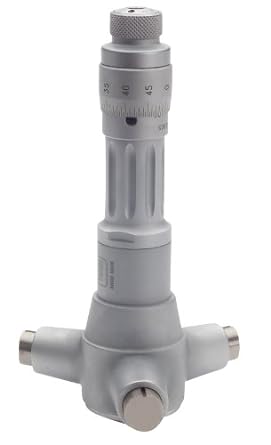

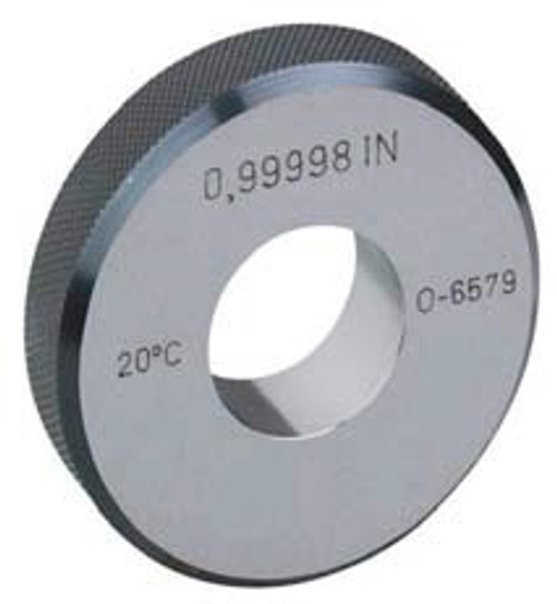

    Not trying to be a "smarta**" here......... I just want to clarify something. I know people often have to make do with what they have or can afford. Using a snap guage and a micrometer is a decent attempt at insuring nothing is majorly off, but its not a reliable way to measure .0002 (2/10,000 ths)of an inch. I'm pointing this out simply so other builders don't think this is the acceptable way to measure a rod bearing. There are several ways that will give acceptable and repeatable readings but some of them aren't found in home shops. My suggestion for anyone trying to measure the inside of a rod bearing would be to buy a "dial bore guage" and a standard thats close to the size you want to measure. The "standard" is a round ring thats precision ground. It doesn't have to be the exact size you want to verify, but if its close/in the general area then a builder should be fine. The other option is to purchase an "intrimik" and a standard.
    The dial bore guage needs to be one that has .0001 increments, not .001
    The ring guage would be found "used" on Ebay. New ones are expensive but I have seen some new ones that were not too expensive.
    Intrimiks will be a "used" item off Ebay as well and you need the ring guage to make sure they are correct or so you can adjust them.
    What I'm trying to point out is that when checking any part, you will get some reading and think that its correct, but if the tool/guage you are using is not really accurate.........the person is fooling themselves. Many things do not need to be within .0002 to operate OK. So if someone thinks they have an accurate reading and the part works ok....then they ***ume their method for checking the dimension is fine. It could just be that the particular thing being measured is actually out of tolerance but still works. If the item is out of tolerance on the large side creating more clearance it will usually function OK. If its out of tolerance on the small side however, it may sieze up.
    Like I said, not trying to be a smarta** here, just trying to help people understand what they really need when measuring close tolerances. :)

    Ekimneirbo I agree wholeheartedly. When I’m using snap gauges I take several measurements at each point. I take measurements at three spots on both sides of the rod journal so six points and three or four measurements at each point to ***ure that my measurements are consistent. On this engine ,upon tear down the bearings and crank looked beautiful. I checked the old bearing to journal clearance with plasigage and had 0.0015 to 0.0017 clearance well within spec I didn’t have any machine work performed on the crank or rods. I polished the crank with 600 grit and crocus cloth. Had I not over torqued the rod cap screws I wouldn’t have given any more thought to the rod and crank Using my somewhat crude measurements I am reasonably sure everything will work just fine I will not be turning this engine past the factory red line. Someday I will buy I dial bore gauge and standard when my budget allows. For me like many it comes down to $$$s. I agree that getting everything to a high degree of tolerances is best, but that can be a deep rabbit hole - torque plates , running coolant through block while boring/honing ,custom crank ,rods ,pistons , line boring , head flow work by a pro etc etc etc Damn I should’ve been born a kazilionaire

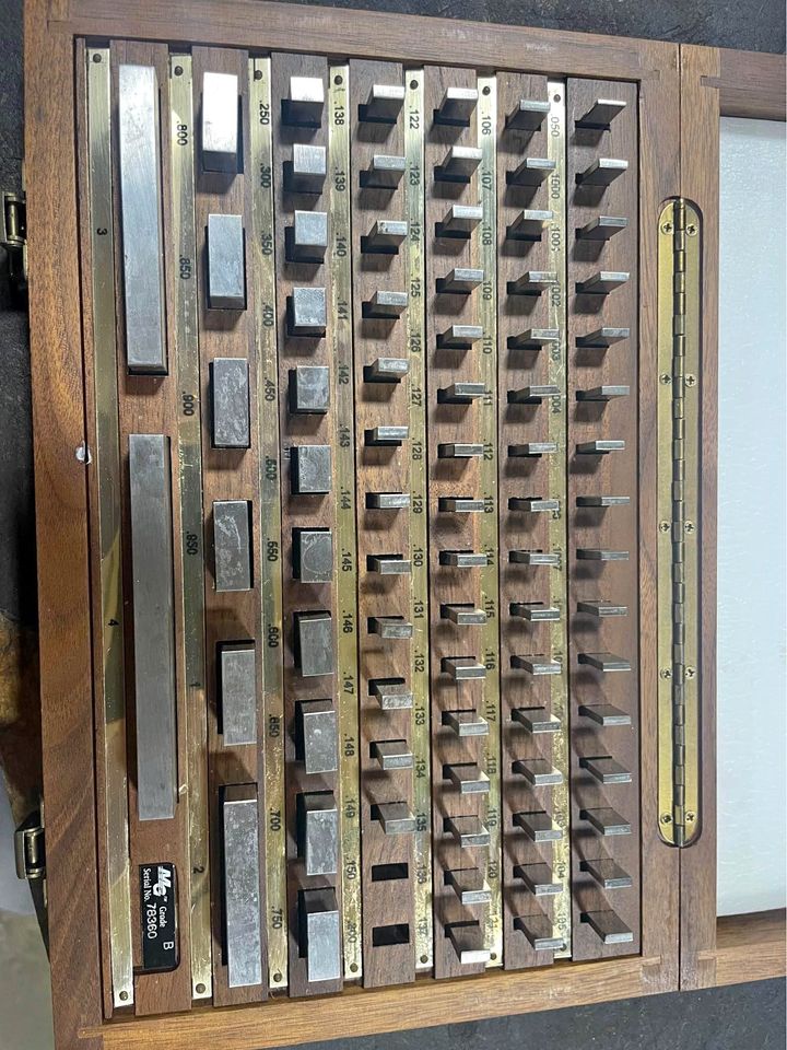

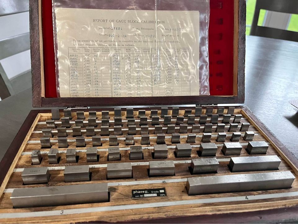

  11. ekimneirbo
    Joined: Apr 29, 2017
    Posts: 4,218
    ekimneirbo
    Just for informational purposes, let me explain the RING guage a little more.
    In a perfect world all parts would be measured at an ambient temperature thats always the same. Metal things/parts expand and contract as the temperature changes, and that includes the measuring tools and standards we use. Generally you don't want to be measuring .0002 tolerances in your unheated garage in North Dakota when its below zero outside. Most of the time if someone is working in a reasonably temperate situation measuring engine parts, you will be fine.
    If using a ring guage to verify/set your dial bore guage, the ring guage does NOT have to be the exact same size as the part you are measuring. In that perfect world situation, the best choice is a ring guage that is EXACTLY the size you want to verify...........but unless you are measuring a somewhat standard size like 2.000 its unlikely you will find a RING GUAGE that is exactly what you want. In industry, they often make custom ring guages that are the exact size as what they want the production parts to be. Generally there is a range of motion for the tool/gage you will be using. By that I mean something like a micrometer will check dimensions from say 1.0000" to 2.0000". If you have a "standard" that you use to verify the micrometer is accurate........the guage can be any known size between 1.000" and 2.000". It could be 1.3435". If you check the micrometer and it reads 1.3435", then its ***umed that the micrometer will be accurate anywhere in its 1.0000 to 2.0000 range of movement. If someone had a 2.0000 ring, it could be used to verify both a 1.0000-2.0000 AND a 2.0000-3.0000 intrimik.
    My next suggestion is for someone new to using a micrometer. There are name brand micrometers that have been used forever and have proven their merit. There are also a lot of lesser known brands that do just fine. Don't shy away from a good buy on a set of micrometers because they aren't name brands. Just check them against the standards that they came with and see if they are accurate. Practice a little with getting a "feel" with them. I would suggest looking for a used set of "gage blocks" also called " Jo Blocks" (Johanson) . You can find them on Facebook for $100 or less. Some people want a lot more, but you can get nice ones for $100. Then you can pick a random block out and mic it and see if you/and your mic are reading/feeling correctly. I guarantee gage blocks are more accurate than your micrometer is. The thing is that you can put multiple blocks together and make different sizes and then put a scribe on them and scratch a line exactly where you want it. Or you can check the height of them with a dial indicator and then check the part you have.
    Here are some examples that were listed locally for $100-$125. The larger sets are better. Don't be afraid of a set that is missing a few blocks....they usually sell even more cheaply if you make an offer. You can also get gage pins which are good for checking sizes but the blocks seem to be handier for different things.
    These things will always be worth what you gave for them and can be resold if you want. Look also at some of the other prices for them........$300+. The key thing to remember here is that if you have a way to verify that your measuring tool is reading correctly it doesn't matter what brand name it is.

  12. bobss396
    Joined: Aug 27, 2008
    Posts: 18,908
    bobss396
    Most micrometers come with a "standard" that is used to check and or calibrate it. The ones I have snap into the micrometer case itself. My good old Lufkin 1-2" came with a standard round gauge. My good micrometers I have had to maybe calibrate one of them over the years.
    Gauge blocks aka Jo Blocks come in a variety of grades from laboratory down to shop floor grade. Serious shops have them sent out for cal on a regular interval. Bad blocks are either discarded or regulated for shop usage.
    The finish of the blocks is key to "wringing" them together when they are stacked up to use for measuring or setting up a "Cadillac" Gauge, aka a height master. They fit together on a molecular level. Damaged blocks will not wring together squarely and can damage the mating block(s).
    Any case of blocks I have used come with a chamois cloth to clean them before use.
    Gauge pins, these also come in grades. Some sets have a chamois as well. These have to be kept clean and free of dust and moisture. For accuracy, these are often calibrated and bad pins are tossed.
    I worked with one real old time inspector. We had sets of Deltronic pins. These are a set of nominal and plus-minus .0001 pin sets that are quite precise.
    https://deltronic.com/cl***-x-pin-gage-sets/
    I saw him do this a couple of times. Someone would take a set out and put them out on a surface plate loose and he would put them back into the case in size order just by feel.
    Sharpone, Budget36 and ekimneirbo like this.
