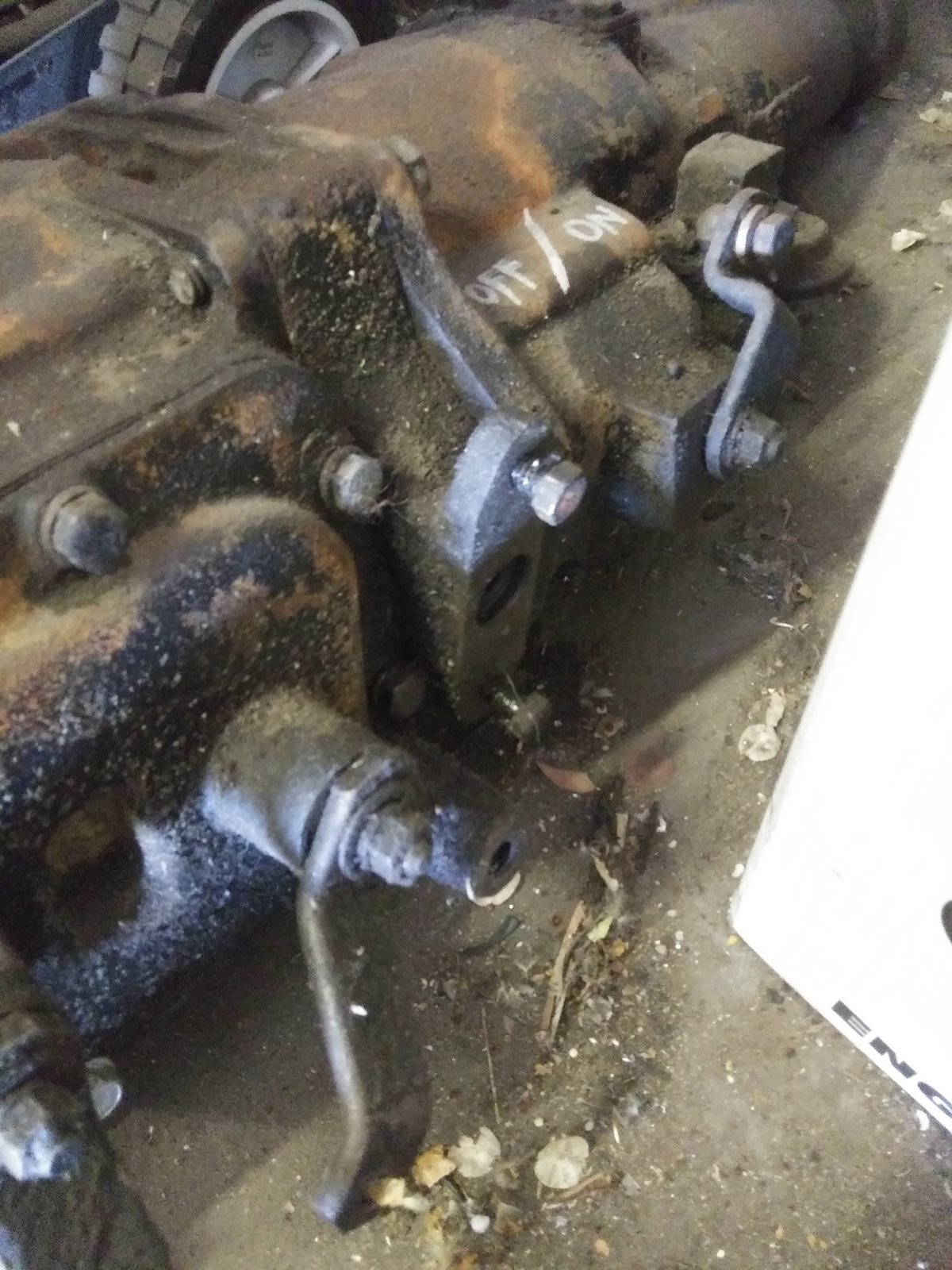

    I put a 1951 Ford Three Speed OD transmission in my '49 Ford Coupe.
    The solenoid for the OD was missing, so I bought one for it.
    A friend put the transmission in the car, and I am somewhat handicapped, so unable to crawl under the car to see what bolts it requires to install I am asking of anyone can help me out.
    Thanks in advance.
    Cheers...
  2. wheeltramp brian
    Joined: Jun 11, 2010
    Posts: 3,340
    wheeltramp brian
    The solenoid is held on by two 5/16/- 16842635821413068778798456063063.jpg 18 bolts that are about a half inch long
