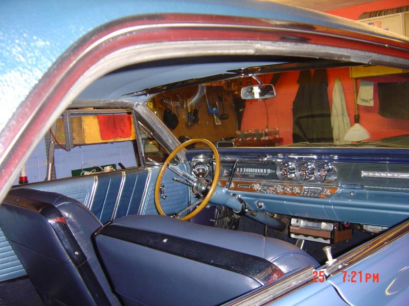

    I once put a 2.75 first gear set into a Turbo 400 with a excellent coupling 13" custom converter designed for this set up. The rear end ratio was 2.56:1..
    This really worked well especially with Rhoads lifters taking duration out of the 300/316 cam shaft. The issue was the noise. Those lifters were so noisy my ears hurt after a long drive..
    This was in a 64 Bonneville with a updated suspension that could handle very high speeds.. I was running 8 degrees positive caster..
    Before I installed the above turbo 400 I had a 4 speed hydro. This transmission had no torque converter but had a fluid coupling and had a first gear of 3.97:1. with a final ratio of 1:1.. Those fluid couplings lock up almost as well as a clutch..
    Out of both set ups I liked the old hydro. When I would nail the gas going 30 mph all hell would brake loose when that ****** would hit 3.97:1 with no converter slip and automatically bang through the gears till I was going 150-160 mph if I wanted.. I was always afraid the windows would blow out going that fast. This get real quiet when going that fast and it almost seems like your just going 30-40 mph.. But the tach said 4500 rpm so you do the math, tire were 28" diameter. I was using Z rated Firestone PV-41 in 225/70r15. They were good for 150 mph.
    If you look at the one photo of the bell crank, I put an extra ball put on it to change the linkage ratio. This really snapped things up..
    I had a lot of fun with this car but the 69 el Camino I have now is a lot of fun too lol...
    2.75 first gear set TH 400.jpg 64 bonneville interior bench.jpg Hurst dual gate.jpg 462 1.jpg 1964 bonneville 8 lugs.JPG Hydro adjustment bell crank 1 002.jpg 64 interior gauges.JPG Interior shifter.jpg Sun Tach 001.jpg engine passenger side.JPG

    Those Ponchos had the most beautiful interiors! Nice car!

    They sure did, that were designed by the Dames of Design... GM had the sense to have women design the colors and fabric textures for there interior..
    Notice the wine chiller in the arm rest.. LOL
