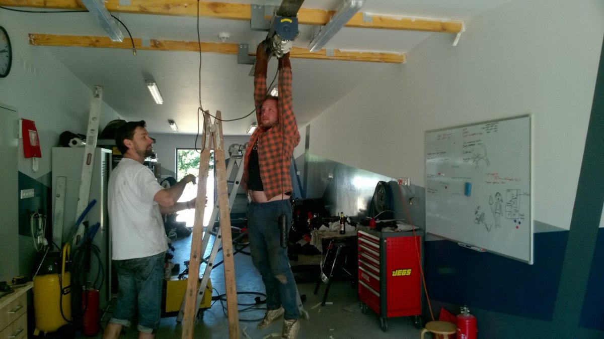

    I have wood beams in garage. I connected them to roof supports, but they are quite sturdy anyway. WP_20170603_14_11_39_Pro_LI.jpg

    No disrespect intended, but I would never trust the set up in your picture. If any of it ever fails you will be in big trouble. At the very least I would put upright supports under each wood beam where the hit the walls. I would hate to see anyone get hurt....or worse. You are asking an awful lot from the fasteners and wooden beams.:)

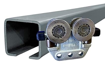

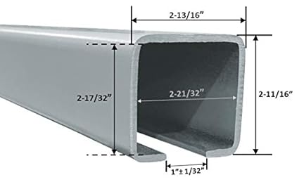

    This monorail is rated for 250 lbs and would be ideal for a small shop. HRP
    Monorail

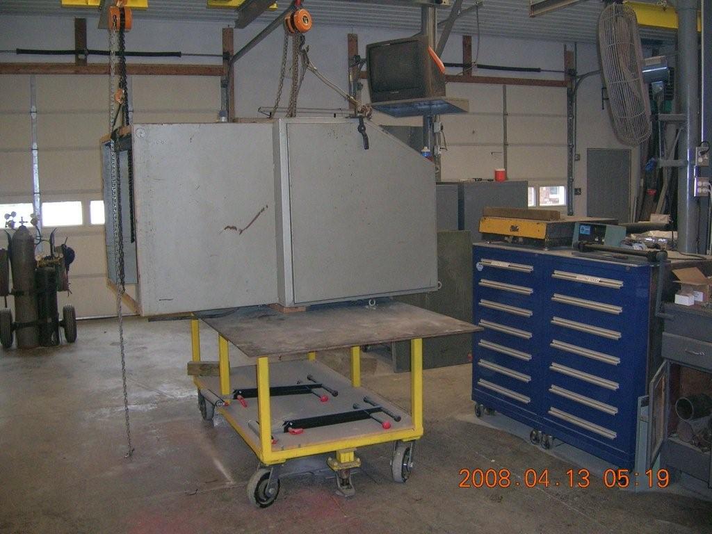

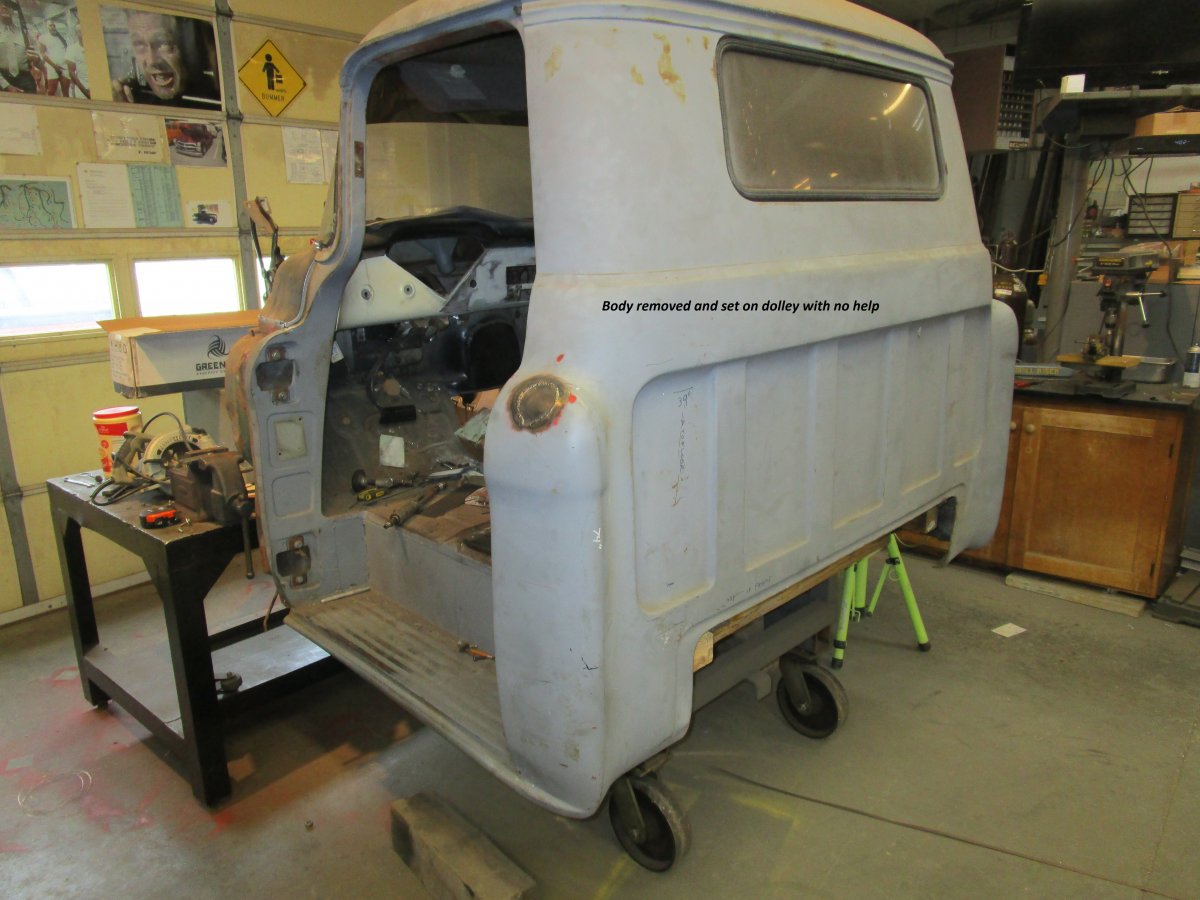

    Its not that wood won't work but it isn't going to save that much money, and the steel makes it much easier to install a trolley which lets you not only lift, but move the engine.

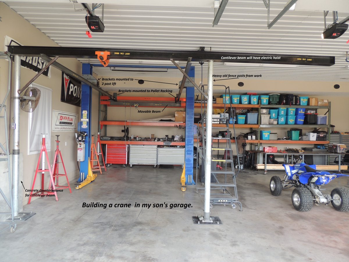

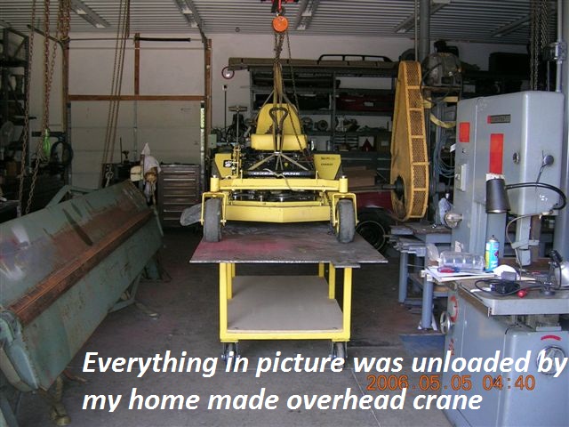

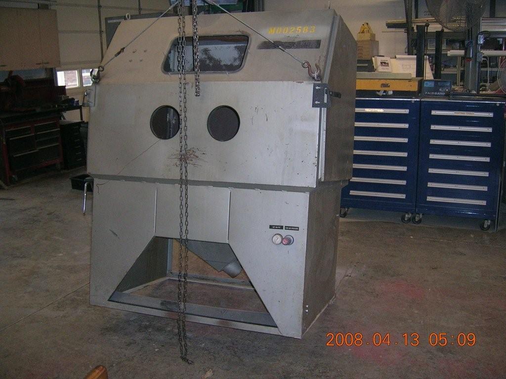

    I have several homemade overhead cranes in my shop and one of the monorails like Hotrodprimer suggested is under the roof in a leanto. Once you get used to having an overhead crane, you can't live without them. Anyone who has a shop should look into
    cobbling one up....you will absolutely love it. I can pick up motors w/******, lift truck cabs off the frame and set them on a cart, and then pick the frame up and set it on a welding table..........all by myself and very quickly. Not everyone has room to build a large one, but I recommend building the biggest thing you can accomodate in your shop. You will always find something to lift that is heavier than you ever though you would.....
    Irishsteve.....a 10' x 4" I beam isn't very heavy but sometimes you just have to be creative when trying to get things in place. My first Ohead crane had 8" beams 20 ft long. Before I put the ceiling in my shop, I put some wood across several rafters (trusses) and used come- a-longs to raise them in place. I used that size simply because I bought them at an auction for $25 each. I once lifted an 8' welding table that had a steel top that was almost 2" thick. I buy lots of things at auctions and I can lift virtually any kind of tool any time I need to. Don't want to sound like I'm bragging, just want people to realize that if they take the time to build a decent lifting crane, how valuable it is to them. If I had to pick two tools I couldn't do without, they would be my welder and my crane. ;)
    Body Cart 1.JPG Crane Beam 2.JPG Matts Crane 5.JPG Sandblast+..2.jpg Sandblast+..2.jpg Sandblast..1.jpg Tools 7.jpg

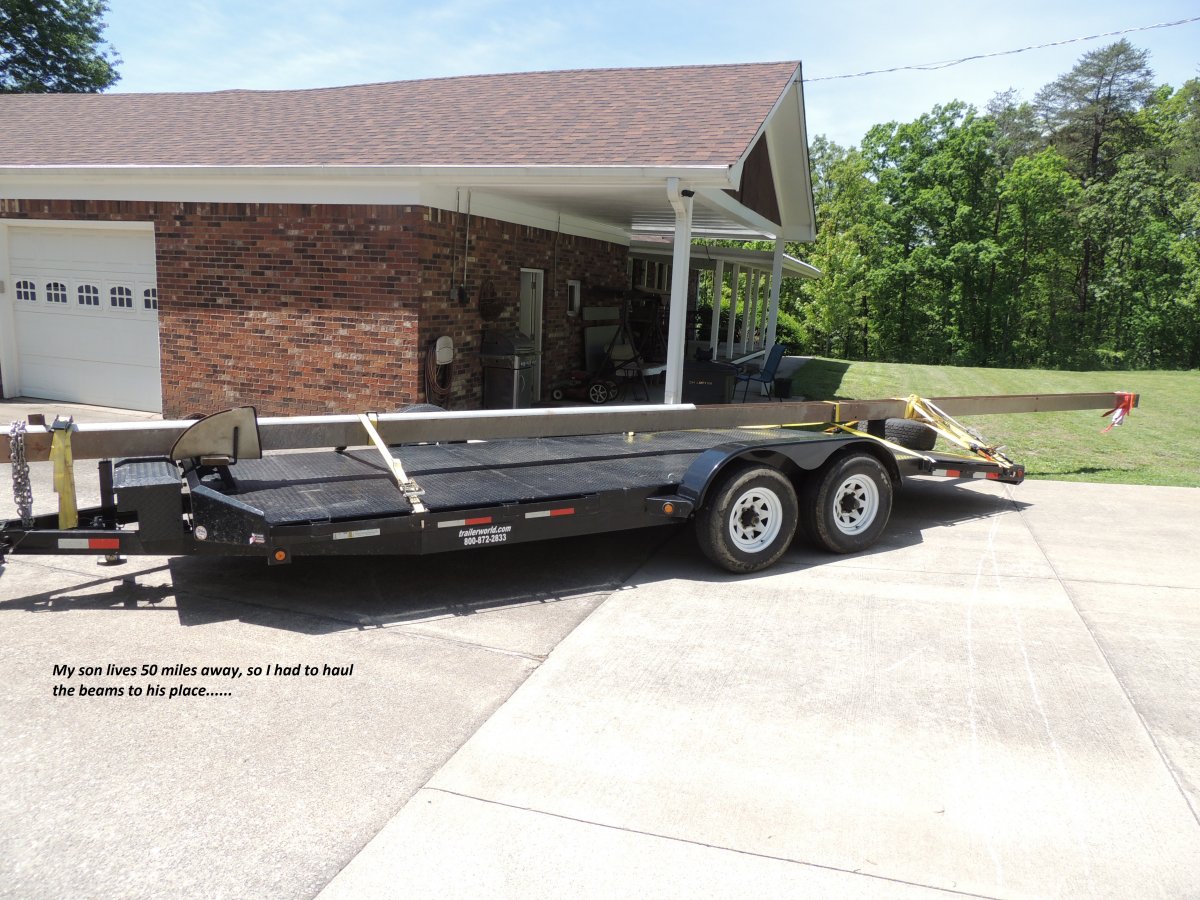

    I know everyone doesn't have as much room as I do, but cranes don't have to be huge. I have another crane thats made from just 4" I beams and we built a second crane in my sons pole barn using his 2 post lift as the main support and 4" beams for the rails. It opens up all kinds of things for you to accomplish easily. You just have to make up your mind that you are going to do what it takes to have one. Here are two lighter duty 4" cranes we made.

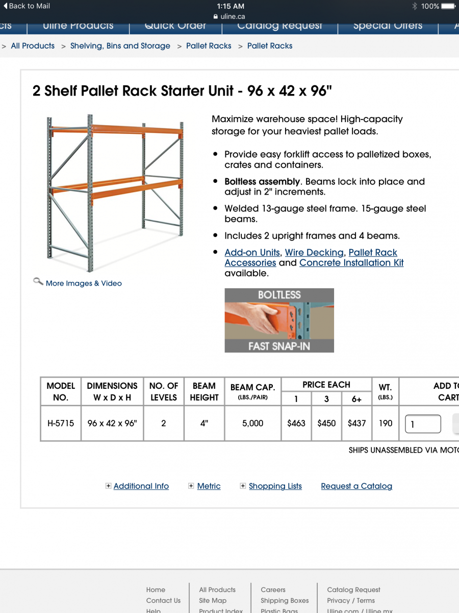

    Just came across an ad on kijiji and someone is selling a bunch of 8' pallet racking beams. Has anyone used this stuff? Seems sturdy enough.

    Properly placed pallet racking can serve to support some form of of a crane. I would keep the crane beams near to the uprights rather than in the middle. I would also watch for an auction or on Craigslist for used pallet racking. The price on what you are looking at is pretty high. We bought 40 feet of heavier duty 10 ft long and 12 ft high sections with the wire shelves and paid less than they want for one 8' section. You can buy the taller racking and cut the height to suit your garage. Use the lower rack to make a workbench or use the racks for storage. Don't buy the lightweight stuff with thin rails. If done well, you can make a sturdy crane, just don't cheap out and do anything unsafe to save a buck.

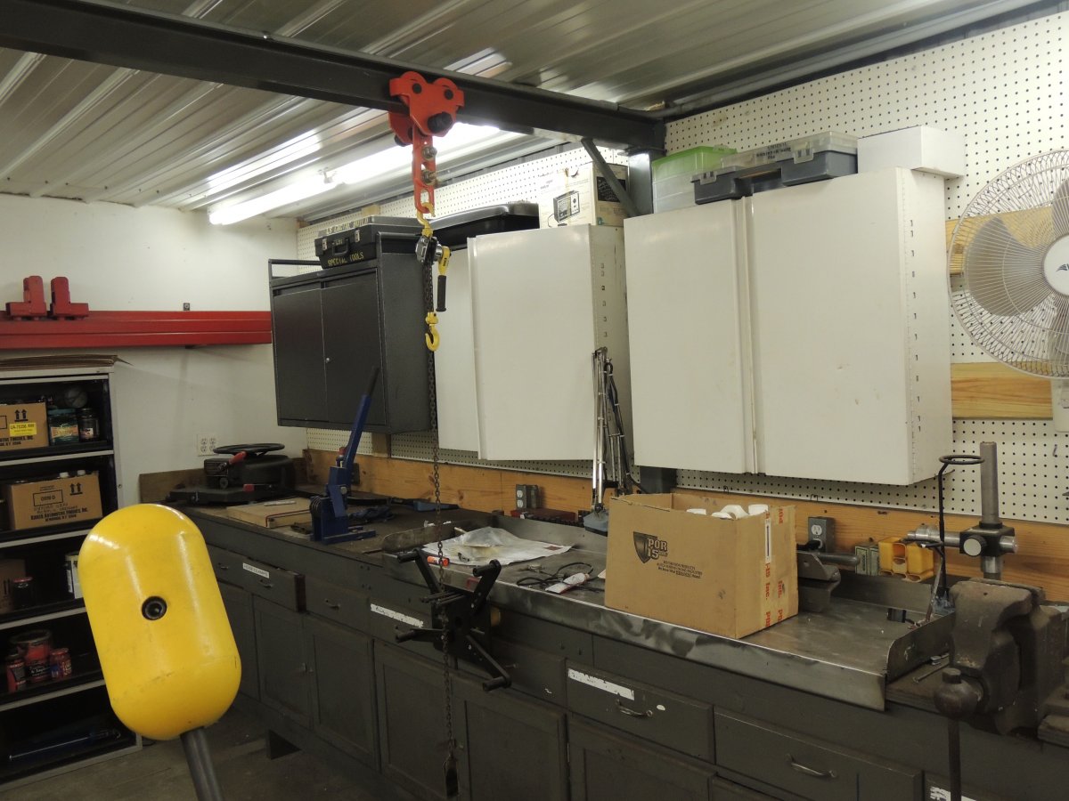

    Been there done that.......A 4" beam against the ceiling and a small trolley keeps it work able. Get rid of the trolley lug and hook a HF come along directly to the trolley cross bolt. That keeps it fairly high. An actual chain hoist can do most things but the chain type come--a-long will give a little more lifting room.;)
    Here is one I have in the lean-to on the back of my shop. Its about 8' ceiling and I use it to load engines onto the engine stand and put heavy stuff on the work benches on each wall. If I took the links out of the trolley to gain some height, I think I could pull a car engine out but thats not what I use it for. Simple 4" beam with a support at each end and about 12' long. The uprights have brackets that let me screw them to wall studs. I use two studs in each wall. Probably $100/$150 in the steel using "off fall" from the steel supply warehouse and a day of my time. The key is to make brackets that allow lag screws to go into the base plate of the wall or the floor.....then weld some brackets up high that span two studs and screw the brackets to the studs. Last, weld a 45 degree bracket from the I beam to the upright at each end. It should be reasonably able to pull most car engines but I wouldn't try a diesel.........
