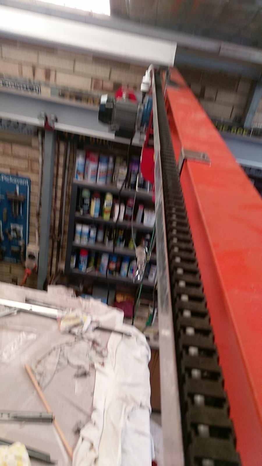

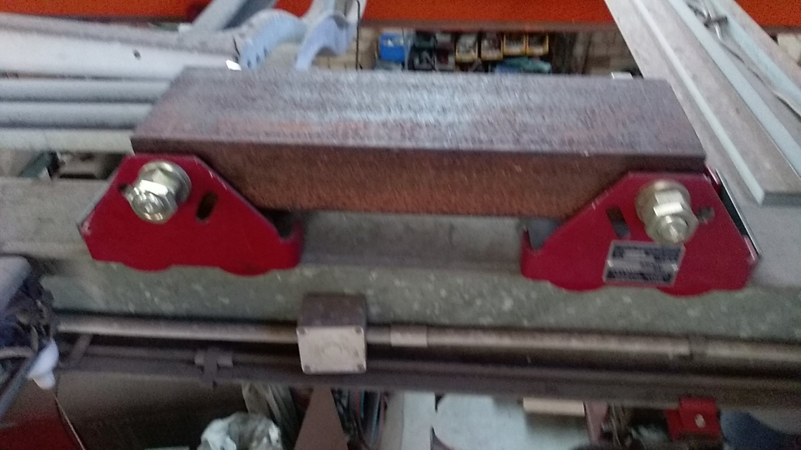

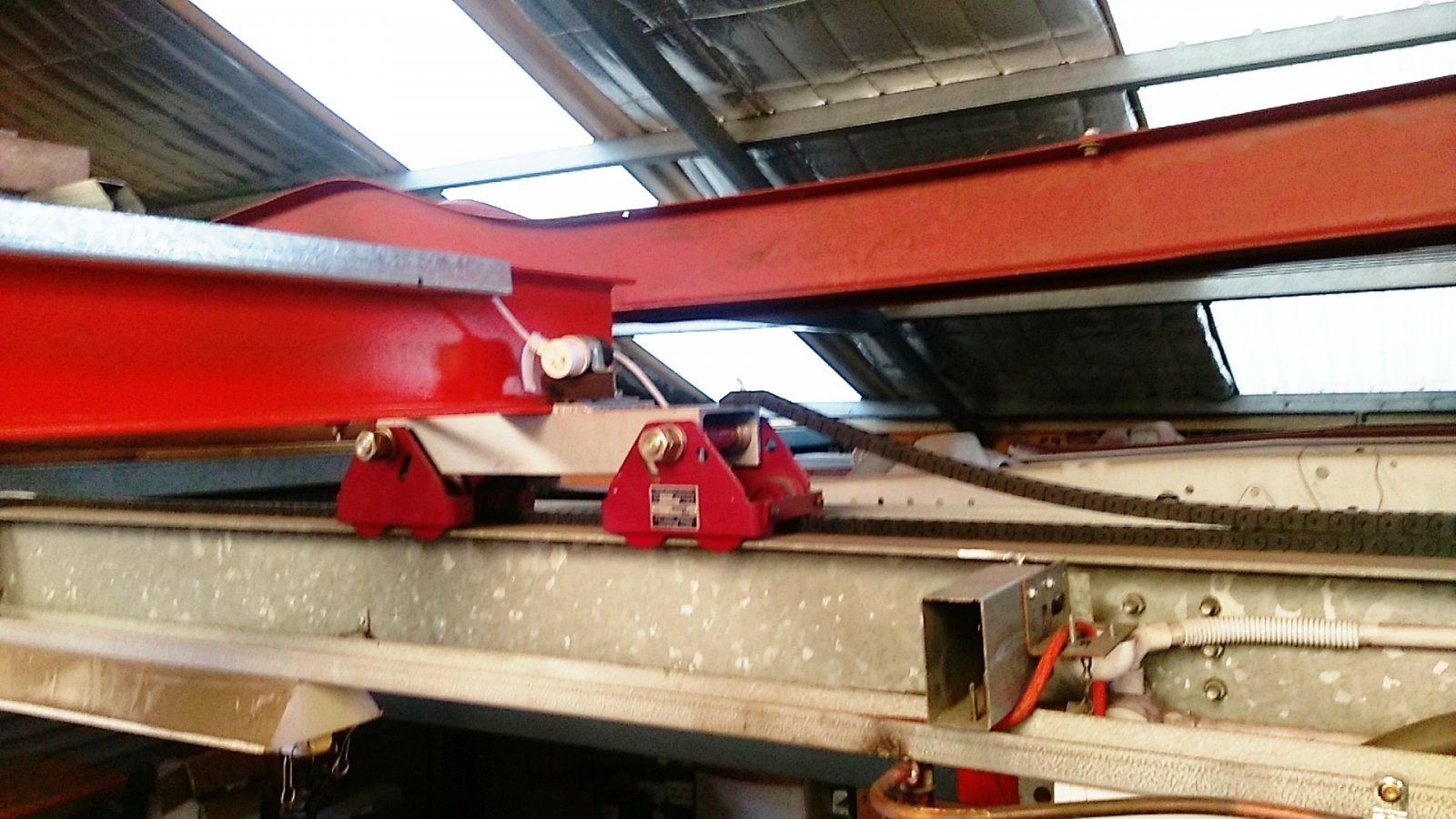

    I built my own gantry setup.
    Will lift 1+ ton, has an electric winch that traverses in two directions and has saved my back numerous times, plus reduced my beer requirements as I dont need to reward helpers so often any more...
    I posted some of these pic's a couple of years ago, but you may not have seen them.
    Winch and steel cost me less than $900.
    Guys with access to the right junkyards could probably do it for half that...

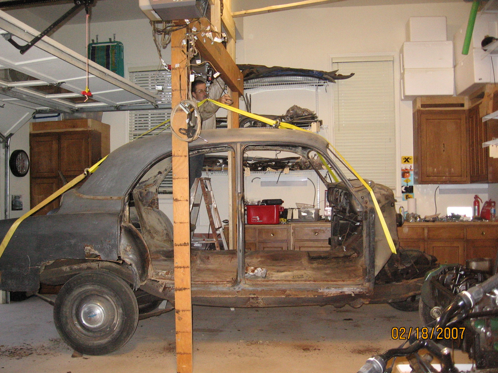

    Our constructed backyard garage had the triangle roof supports, but was not high enough to support any kind of weight on a downforce. We could move our Willys Coupe into the backyard garage, but could not do any transfer of motors or other uses for the pulley system.
    So, it was back to our original two car garage that had high enough cross beams to mount a pulley system. But, the crossbeams needed some down force supports. so, we rolled the Impala into its parking space and measured what was needed for width and support.
    upload_2022-2-1_4-37-59.png Narrow entrance to the small two car garage.
    We used additional 2x4 cross beams added to the original cross beams, sideways for strength. But, then we attached a 4x4 post to the cross beams. We had to make it removable after we finished our work because, two cars would not fit in the small two car garage. Our dad’s big Buicks took up a lot of space. The wide Impala fit nicely and because it was wide enough, the 40 Willys Coupe slid right in with plenty of clearance.
    So, when we were ready to work with the chain pulley system, we installed/bolted the 4x4 support to the cross beams. The floor had a plate drilled into the concrete. The plate took additional brackets for the 4x4 support post. When we were finished, we had to clear out the garage of all paraphernalia, so the two cars could go back into place. The 4x4 post was removed and the garage was like new.
    It was a h***le as we worked on other cars and motors, but that was all we had and it made things easier. YRMV

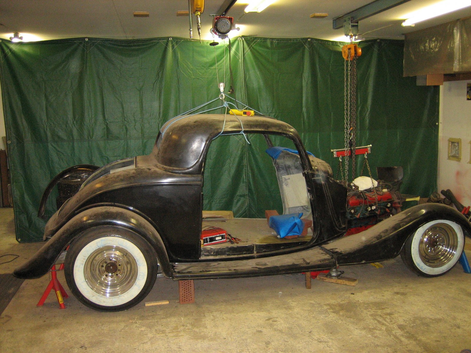

    Chain hoist hangs under 4 trussers,,lift about 1 ton.

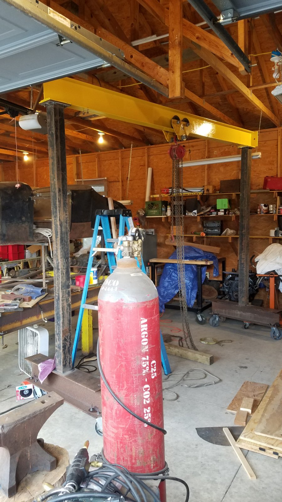

    AFC30629-4CA9-4512-906A-138DC1964BE7.jpeg I built a roll around over head crane 12 foot tall in my shop and store it at the entrance of the shop. And it works great! In your case if this won’t work for you I would buy a about 10/12 foot pice of six/eight inch I-beam and secure it in your rafters/ trusses . Then when you needed to lift something you would add removable pipe upright supports. This is for cross the car lift, if you are wanting to go with the length of the car a longer heavier piece of I beam.you would just then be using the rafter/ trusses for stability.
    Here is a pic of my hoist with my 2 moveable hoist and two stationary chain falls.
    I would never trust the vertical additional loading of any modern wood truss/ rafter.
    Bones
