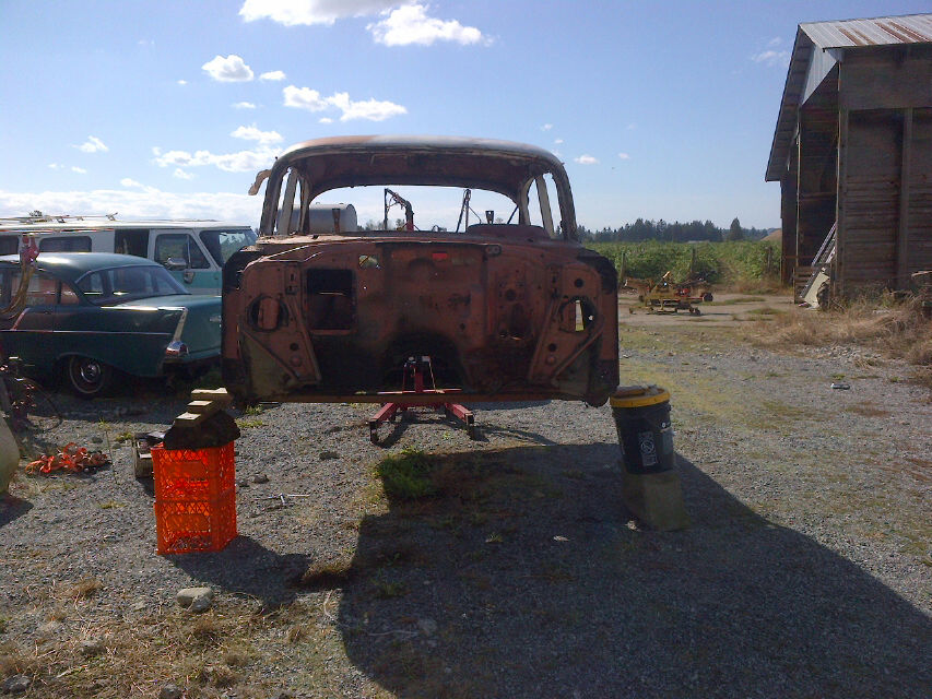

  4. I didn't have plans, just calculated what I wanted to do with it, height and width wise. Tubing as I remember is schedule 40 & 80 pipe with a collar welded on each leg and a lock nut & bolt to stop rotation and pull out.
    Also used a Harbour Freight winch and load leveller.

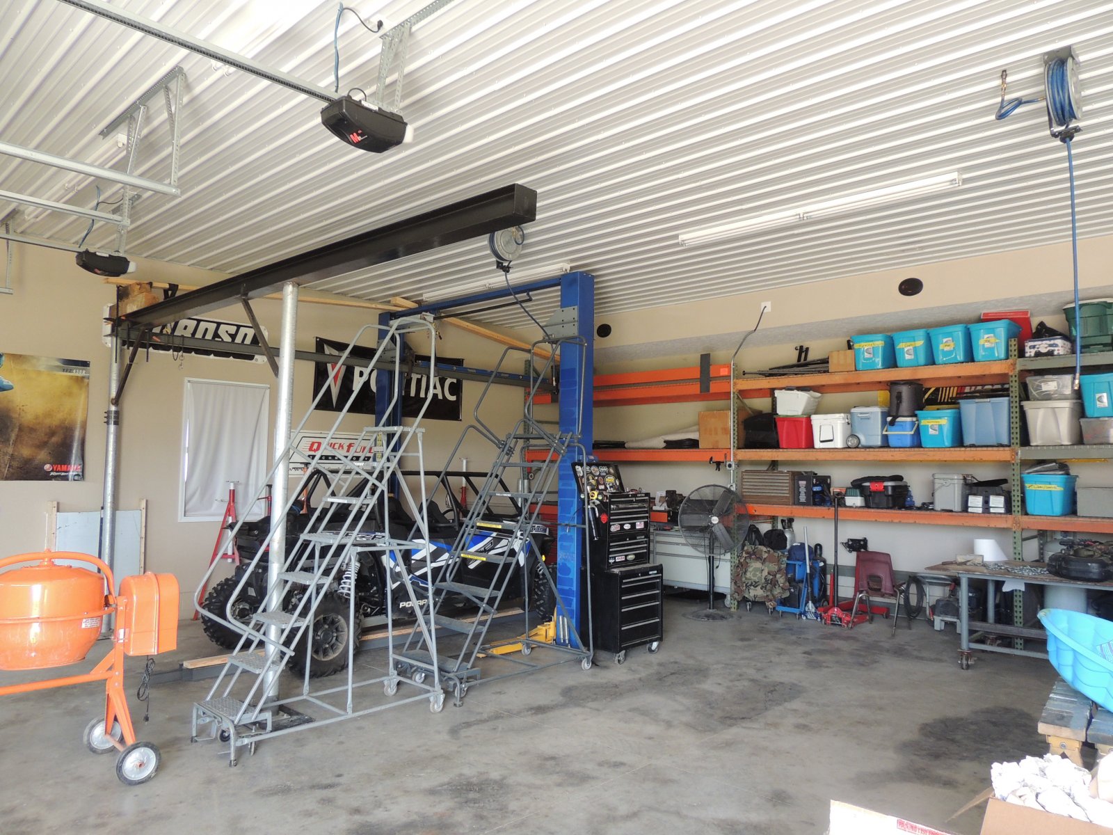

    this is the type of gantry set up I was referring to in post 44 above.
    is that a drawing board in the far corner ? Maybe someone who also has qualified experience in this type of thing ?

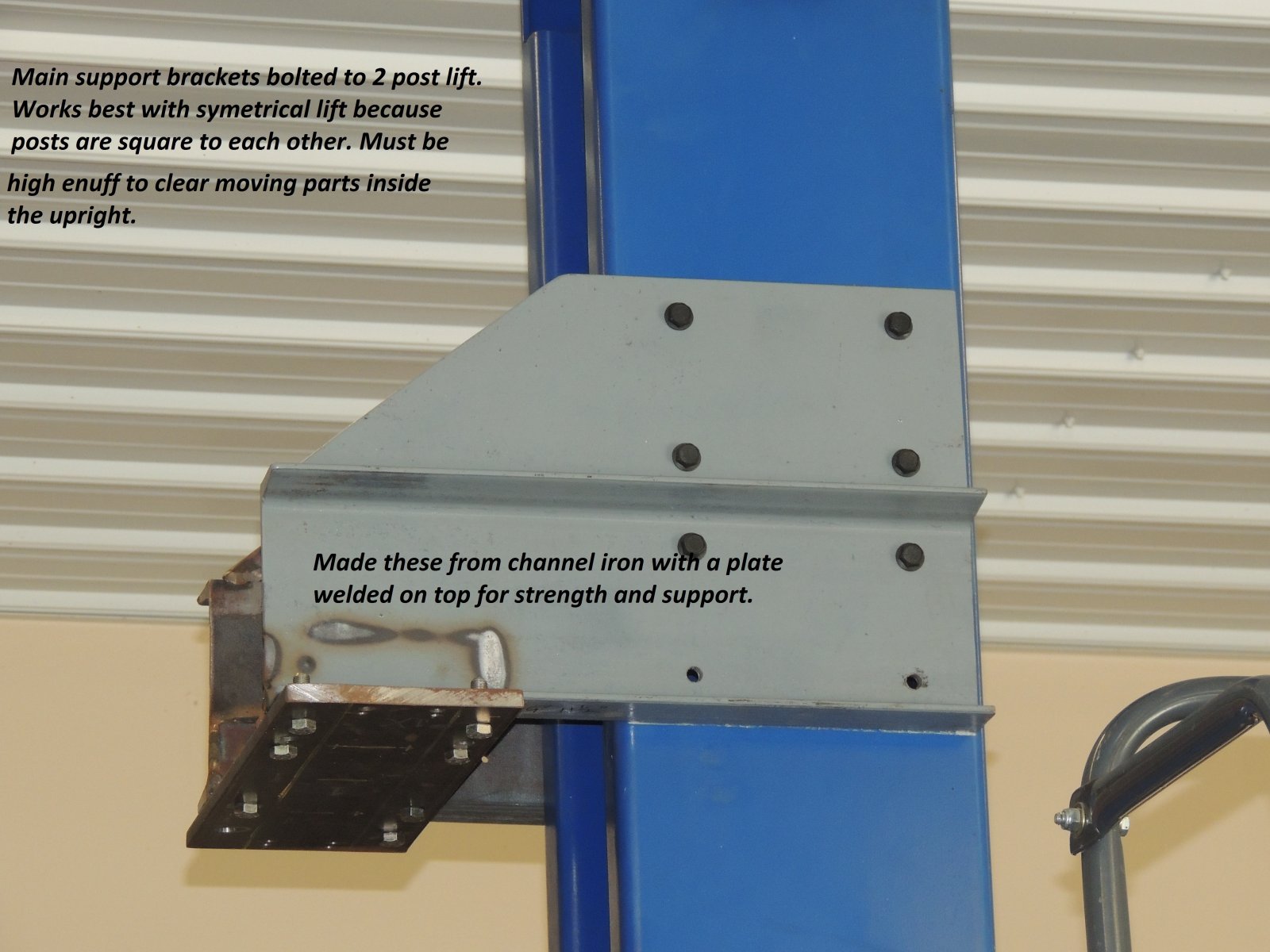

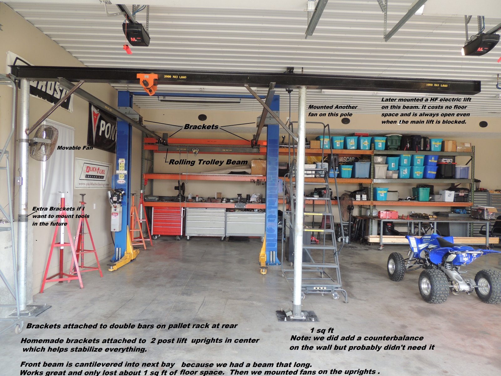

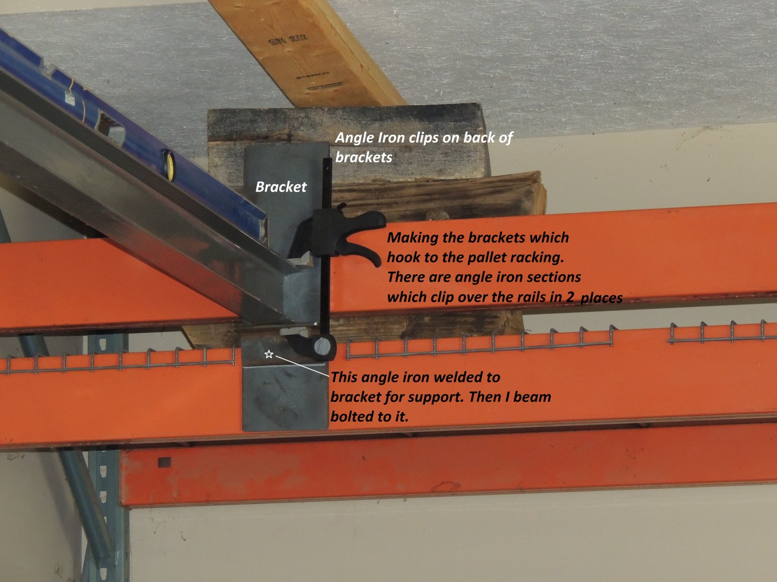

    There are lots of things to think about when building a crane. Everyone needs to take reasonable precautions to insure their safety when building one. That said, most of the people here are not going to employ the services of a structural engineer. You not only have to look at what works for others, but is it well thought out safetywise.
    One consideration is whether you want to build something that will allow movement once its loaded. Being able to not only lift the load, but to shift it fore and aft or side to side makes for a much more usable crane. Some people have very little room, but still fore/aft movement is very useful in confined spaces....and it takes up almost no room.

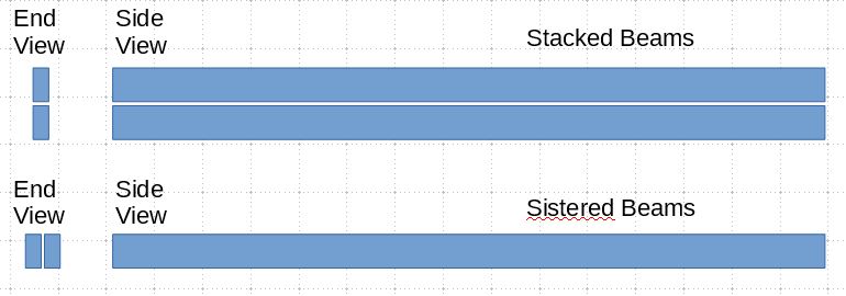

    As mentioned above there are ways to stack a beam rather than to scab a beam, and while one may be better than the other, the other can often be sufficient. I have built several large lean to roofs at my home. I used 16' 2x6s and they have held 17" snow loads with no problem. No engineered trusses, just 2' spaced 2x6s.
    Now, IF I was going to attach an Ibeam to them, it would run at 90 degrees to the 2x6 "rafter". I would add another 2x6 scabbed to about every 3rd or 4th rafter because I can't stack them. You can see one of the car port roofs in the pictures I posted earlier. I did not put my beam up this way, because I wanted side to side movement rather than longitudnal movement. The point here is that which type of movement you want affects which way you may want to build a crane. Anyway, your "rafter" in a carport or your truss in your garage will normally run from side to side. Your garage door is normally going to prevent any vertical support of a beam mounted front to rear. So strengthening the existing trusses with scabed boards will give a lot more strength. Since the I beam crosses under many trusses, weld brackets to it that let you attach it to as many of the trusses/rafters as possible... especially the end ones. Now you have many trusses/rafters spreading any load. If you build one this way, you can use a much smaller Ibeam......probably 4". Now you don't want to tempt things by lifting diesel engines, but you can put two trolleys on it and lift some car frames and bodies.
    If you want to have side to side movement, you have to consider whether you have a finished ceiling or not. If its finished, then you will need supports at each end of the beam.....at the wall. I screw them to the floor and to the upper plate on the wall for stability. The width of your span will determine how big your beam needs to be. For a two car garage, I would want a 5" or 6" beam. That said, if you use a 4" beam, you can always run a bracket up thru the ceiling near the center and put some bracing crossways over your trusses to add some center support.
    If your ceiling is not finished, then your beam can sit on top of each wall. It would be nice if it sits where there is a stud directly under it, but you can always take a 2x6 and attach it to the wall with screws into the walls bottom plate and top plate and gain a lot of support.
    Now I'm not a structural engineer and don't guarantee that any of this won't get you hurt, but these have worked for me in the past. I really prefer having some sort of support at each end of a beam, but sometimes thats just not possible. When its not then its best to spread that load over as many supporting rafters/trusses as possible. So you have to be the judge on whether what you cobbled up is safe or not, but I've told you how I would do my own.
    So best of luck to those that want to build one.;)

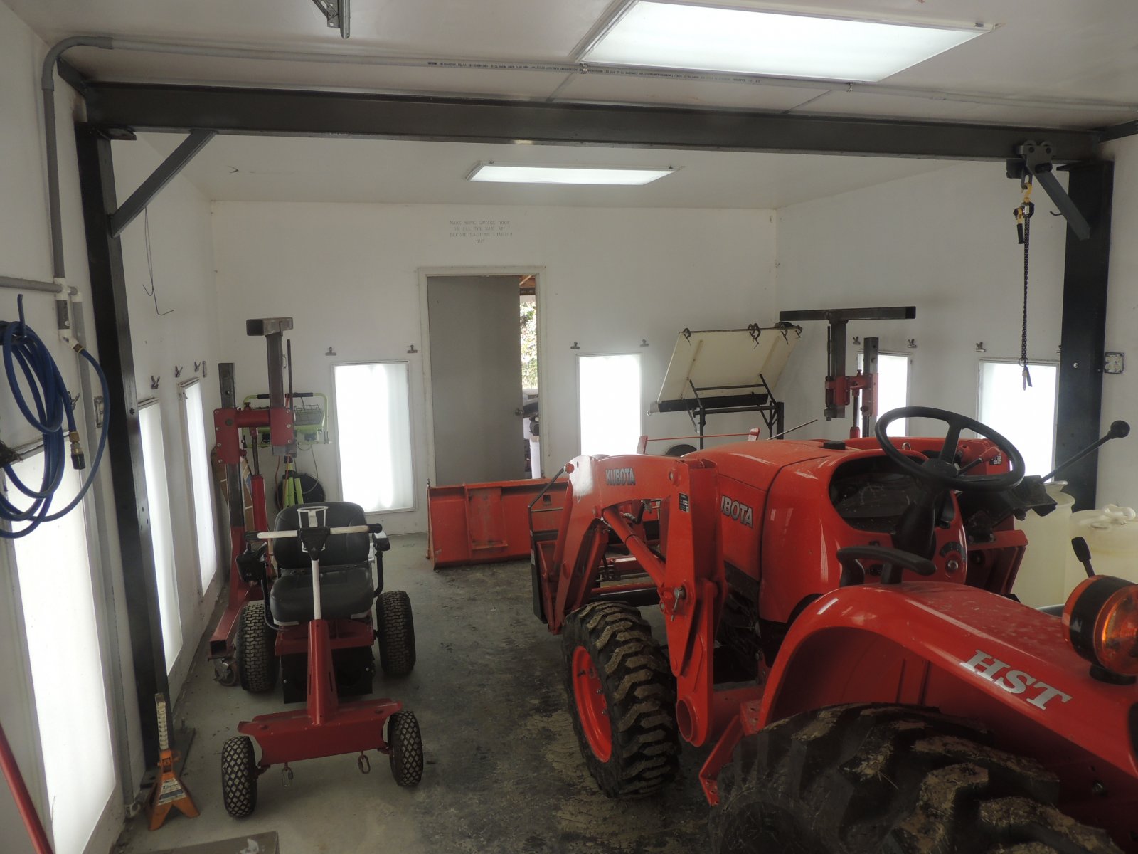

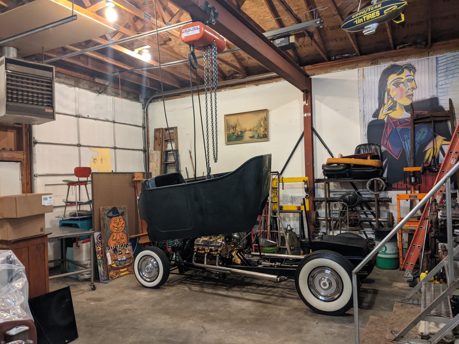

    My buddy's family gave me a steel H beam about the size of the one that Swade41 showed in his posts.
    The intent is to put that one on top of two posts up high enough to put a trolley on it and hang a chain hoist from it similar to what Clem showed.
    I do like the gantry idea and have had one made with an aluminum I beam and steel tubing that I have used for years and can be knocked down for transport in about 15 minutes or less.
    Here it is when I unloaded the 31 Vic body I had from the boat trailer I hauled it home on.
    That thing gets used on a lot of projects around here.

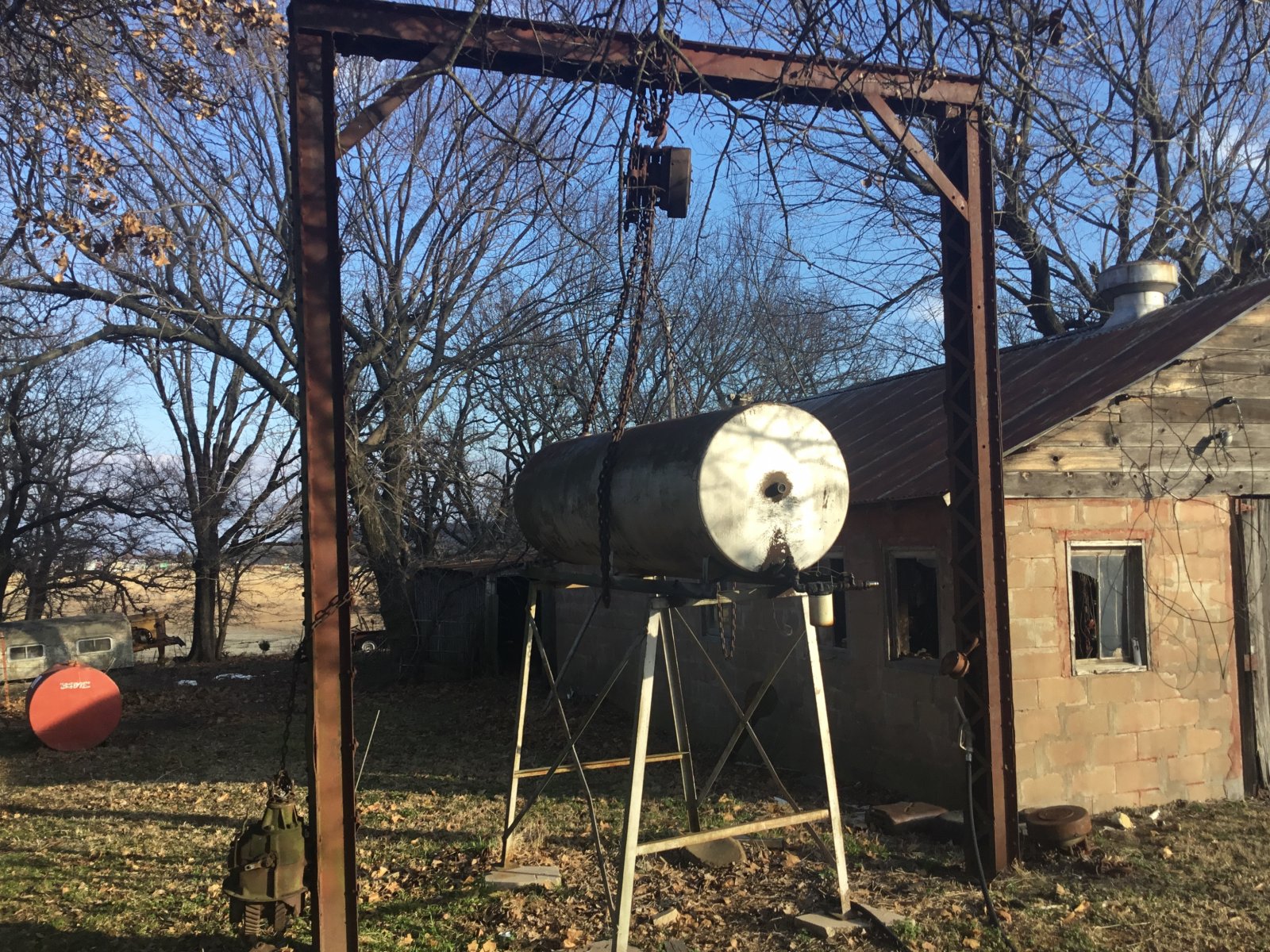

    I guess I will include a picture of the hoist we used since 1959 on the ranch, next to the old shop building. I went with my Dad on a 1934=Allis WC pulling a trailer to get those beams. My Dad loaded those beams on the trailer by himself , with a little help from 7 year old me! He welded them together on the ground and dug three foot holes. He then put boards in the holes and pulled it up right with our 1937 Ford ton and a half. Steadying it with the 34 Allis. When it was straight we filled the big holes with concrete! I still have that 37 Ford and 34 Allis!
    I cannot begin to tell tell you the amount of things that hoist has lifted, in it’s sixty plus years of existence! It is still in use on the ranch today!

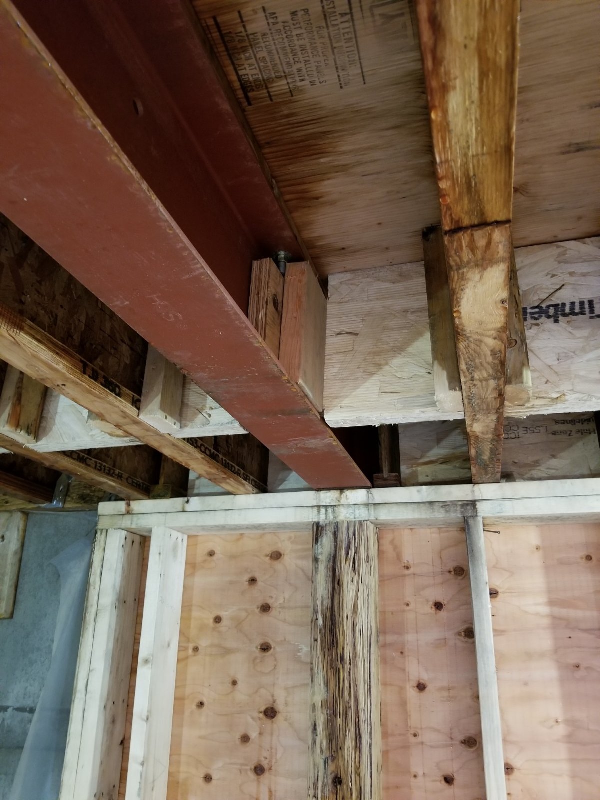

    Your trusses are a perfect example of trusses I would be scared to use for a crane. However, if several of them were strengthened with double 2x6s they could be used for a lot of stuff. Since you are located in Washington State, I imagine they see some pretty good snow loads as is. I like the fact that you went with the I Beam though. :)
    One thing I would like to point out in the picture is that the bottom boards on the trusses are NOT one continuous span. They are joined with small metal plates. Thats one of the reasons why scabing /gluing/ and thru bolting larger 2x6s will help them a lot. Any truss that has these plates joining the lower board need help. Don't trust the small joining plates. Also, don't stand under your hoist beam the first time you test it!:D

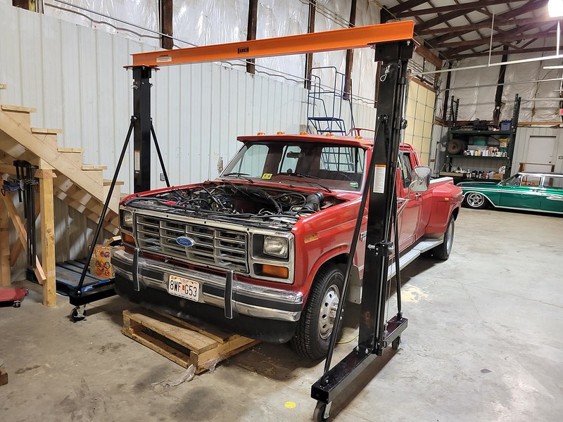

    I bought one from Northern Tool a few months ago. I love it. Makes it really easy to pull motors, either out of the front or back of the truck.
