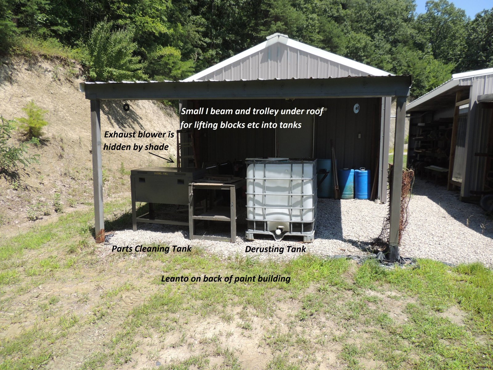

    I have 11 different lifting setups at my house that I have constructed over the years. Some are simple I beams attached to the bottom of 2x6s for simple lifting. Two are under leanto roofs and are limited to about 500 lbs. Makes it easy to get things off my trailer, or the other one lets me raise and lower engine blocks into a cleaning tank and a derusting tank. The 2x6s have no bracing in the form of a truss or other support. They work just fine and make an impossible task simple. At the other end of the scale I have two hoists that will lift about 4,000 lbs or more.
    While not a very detailed picture, This is a small I beam attached to simple 2x6 (not trusses) roof supports. The load spreads across about 6 beams and always has at least two 2x6 beams supporting the load. I can pull my tractor up and sit an engine block on the table in the middle. I lift the block with one of those small HF 500 lb comealongs and lower it into the cleaning tank. I can't do that by hand. I let it soak for days and oc***ionally brush the grease and oil off. When its done, I raise it out and hose it off. Then I slide it sideways with the small trolley on the I beam and lower it into the derusting solution. It hangs there for a couple weeks and when I take it out, magically all the rust is pretty well gone. Slide it sideway and sit it back on the table. Pick it up with the tractor and go hose it off again. Easy peesy and very convenient. I limit the load to about 500 lbs max. The leanto roof is supported by 12' 2x6s with no other truss bracing or support.

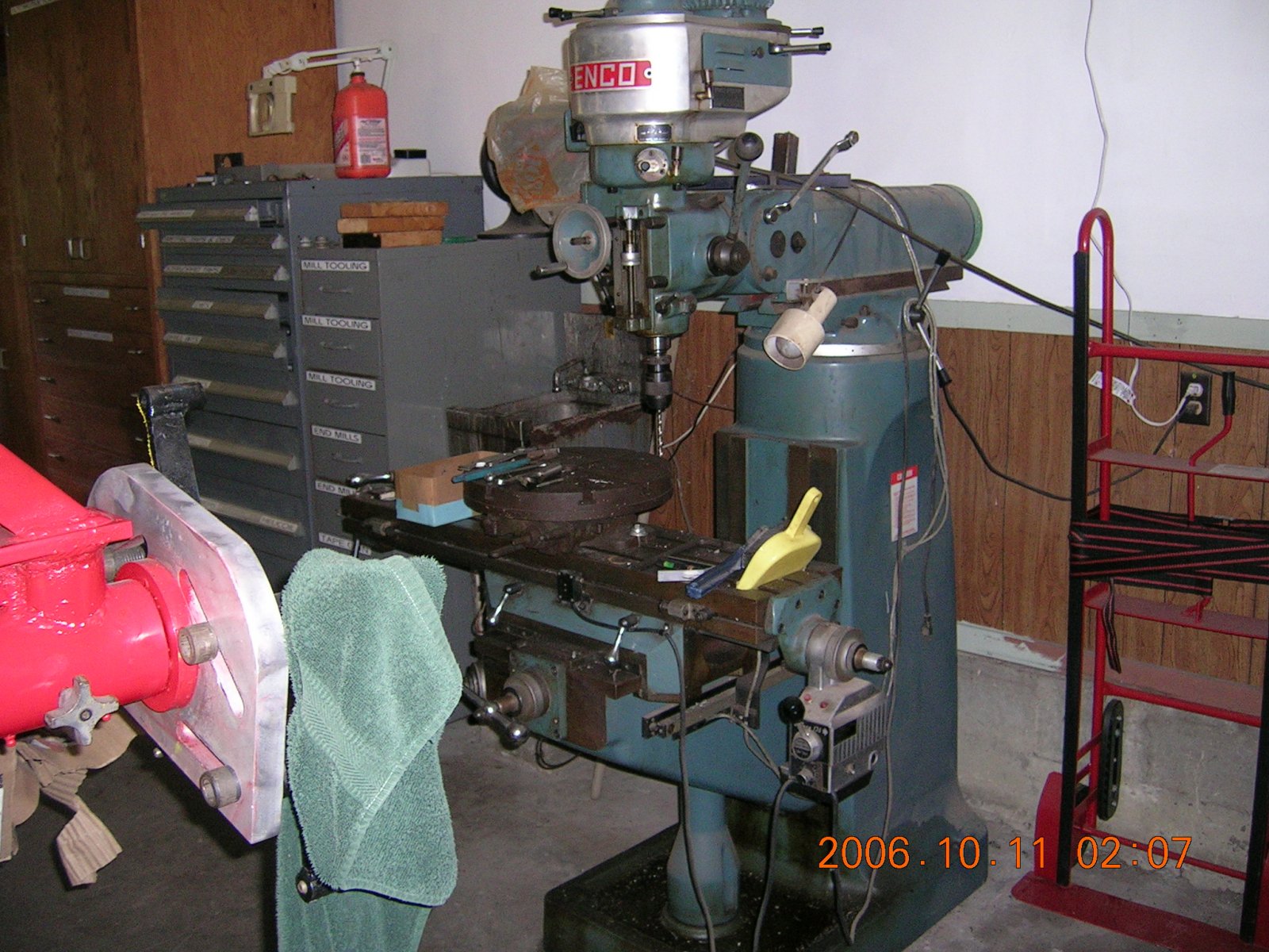

    At the other end of the scale, here are some items I have picked up with "steel supported" cranes I have made. It would have been impossible for me to lift and move this stuff without a proper crane set-up. How and what anyone decides to build should co-incide with how and what they may want to lift. I'm verrry happy with what I have for my needs.
    2500 LBs and not easily balanced.

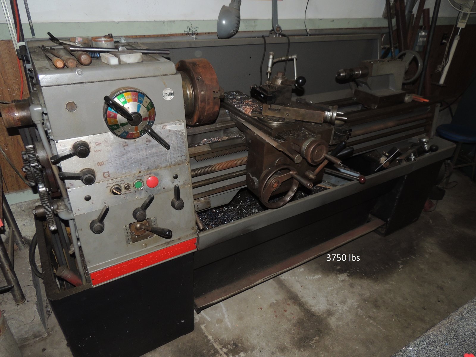

    Or the 15"x50" Clausing Lathe 3750 LBS
    Like I saw someone else post......If you want it bad enough, you will find a way. I found ways to do what I want. Anyone wanting similar things can get there if they want them enough to work at it.:)
