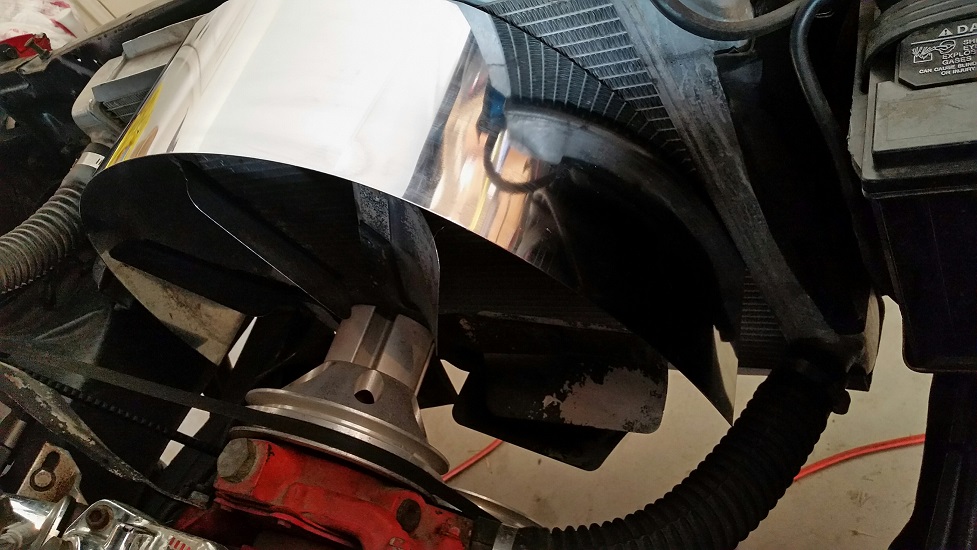

    57 shaker, from the pictures you've posted I can't tell what that sheet metal over the top of and in front of the radiator really looks like (picture 3). It doesn't look right to me. Maybe you could post some more pictures of that area.

    The shroud for the engine-side fan, and the fan caging itself, sure seems to block a lot of air. That's certainly the majority of your problem at freeway speeds. some people cut holes in those and attach either sprung metal flaps, or rubber flaps, that open as you go faster to let the air through. Dual fans that cover more area back there would be good, or if you can fit a mechanical fan with a basic shroud would do too.

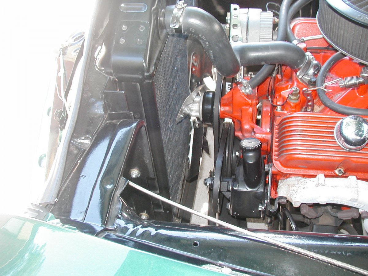

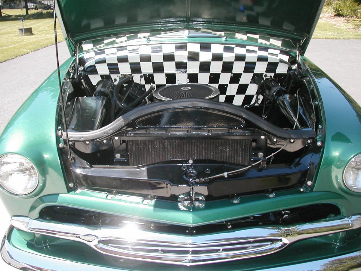

    If you at the lower left hand side of my photo you will see the top of the rubber seal mounted on a piece of sheet metal. It seals to the hood. ALL the air coming thru the grill must go thru the radiator. If the 2 side vents to the heater or air to the car are pulled open only a partial amt goes to the inside of the car,I have no shroud and just a 4 blade fan. There was no shroud in 56 for the cars, only to he trucks and birds. image.jpeg

  16. ^^^^^^^^^^^^^^^^^ That rubber seal is a very important item. My 51 has the same treatment. 51 Vicky 011.jpg It uses the Stock form Rad. I also run a far from stock Small Block Smokin 51.JPG with no heat issues. 51 Vicky 010.jpg notice there are No trans cooling lines between motor and rad and it's been that way for 14 years and 60K miles. I run a 700-R-4. No issues at all. Also No shroud. I keep saying, it's about Air Flow. I've learned Hot Rods with Heat issues are self inflicted by the builders.
