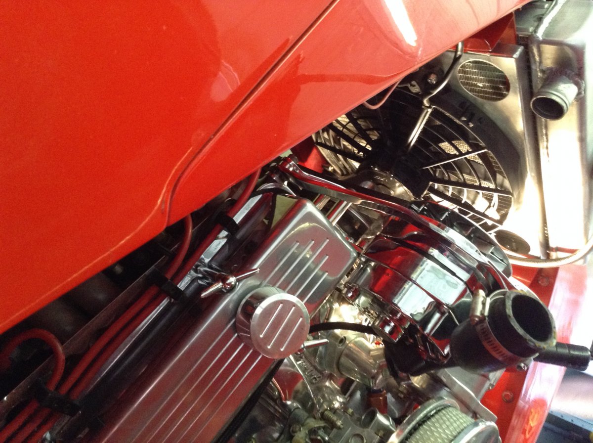

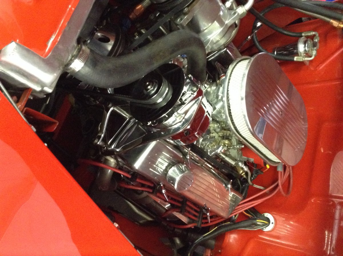

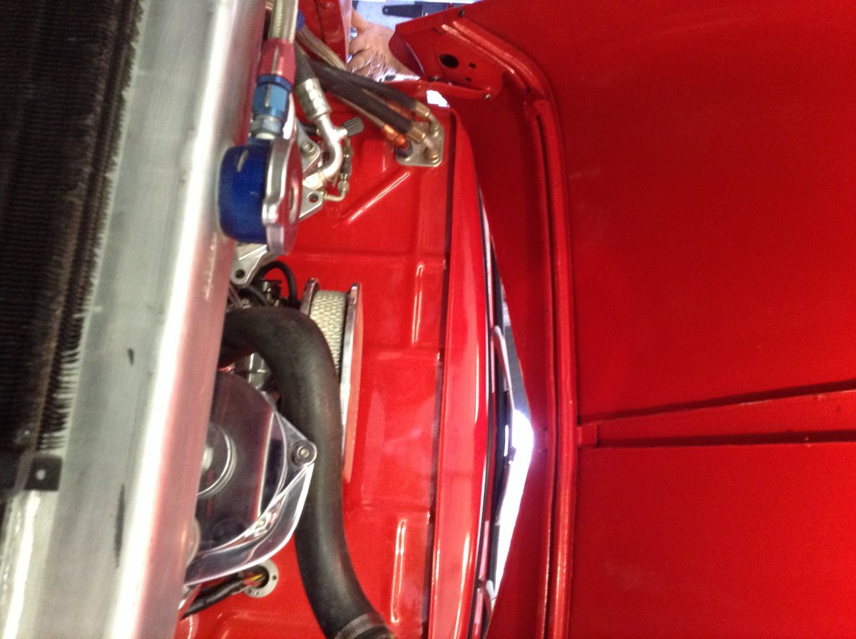

    Well so far what I've done is replace lower radiator hose, remove the ****** cooler that was closest to the grill and made a smaller setup for in the right side frame rail, I removed the elec fan that was in front of the condenser, now only condenser in front of the radiator, then I removed the elec fan and shroud after the radiator next to water pump pulley and put four 3" holes in shroud at each corner and removed every other plastic circle of the shroud and reinstalled. I got side tracked on other problems I found but...here are some more pictures.

    sorry pictures are upside down and messed up, I just cannot get the hang of this.

    so, you do realize that with those holes in place, air being pulled by the fan will come in through the holes instead of being drawn through the radiator, right? You're going to need to plug them off somehow to prevent that.
  4. Those holes in the shroud need to have flaps.
    When the car sitting still and fan running the flaps should get ****ed closed.
    Whe the car is moving and road speed air is forced thru thru the radiator the flaps can get pushed open.
    As it shows now, hot engine compartment air gets ****ed in the holes and out by the fan, never p***ing thru the radiator.

    The picture showing the radiator cap is if you make a level line to the heater connections they are about 4" or more higher then the radiator cap. Don't know if that makes a diff or not.

    I think that is a problem. You are going to have an air pocket in there, and that will screw things up for you. It will be hard to purge the system.

    That's fine, once the system is full, but when filling the system it can be difficult to get the air out of the system. BTW, air pockets in diesel engines is the #1 killer of EGR coolers, it's a well known problem, at almost epidemic levels out there.

    Put a valve at the highest point of the heater system to burp it. You can probably find something like this at your local junkyard.

    Is part of the upper radiator hose higher than the top tank? That would trap air. When I fill an engine with coolant I use one of the heater hoses which gets the majority of the air out. I run a 180* stat on my SBC, Champion aluminum radiator, flex fan with a shroud. It runs 180* unless I sit a long time in traffic.
    Have you checked the upper and lower hoses and radiator tanks, are they about the same temperature when hot?
