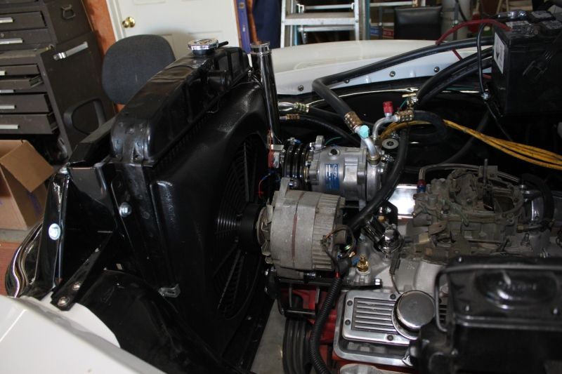

  3. Deuce Roadster
    Joined: Sep 8, 2002
    Posts: 9,519
    Deuce Roadster
    Here is your set up
    And here is a ZIPS set up ... :)
    The alternator and A/C brackets are cast into the housing ... making for a neat, compact set up.
