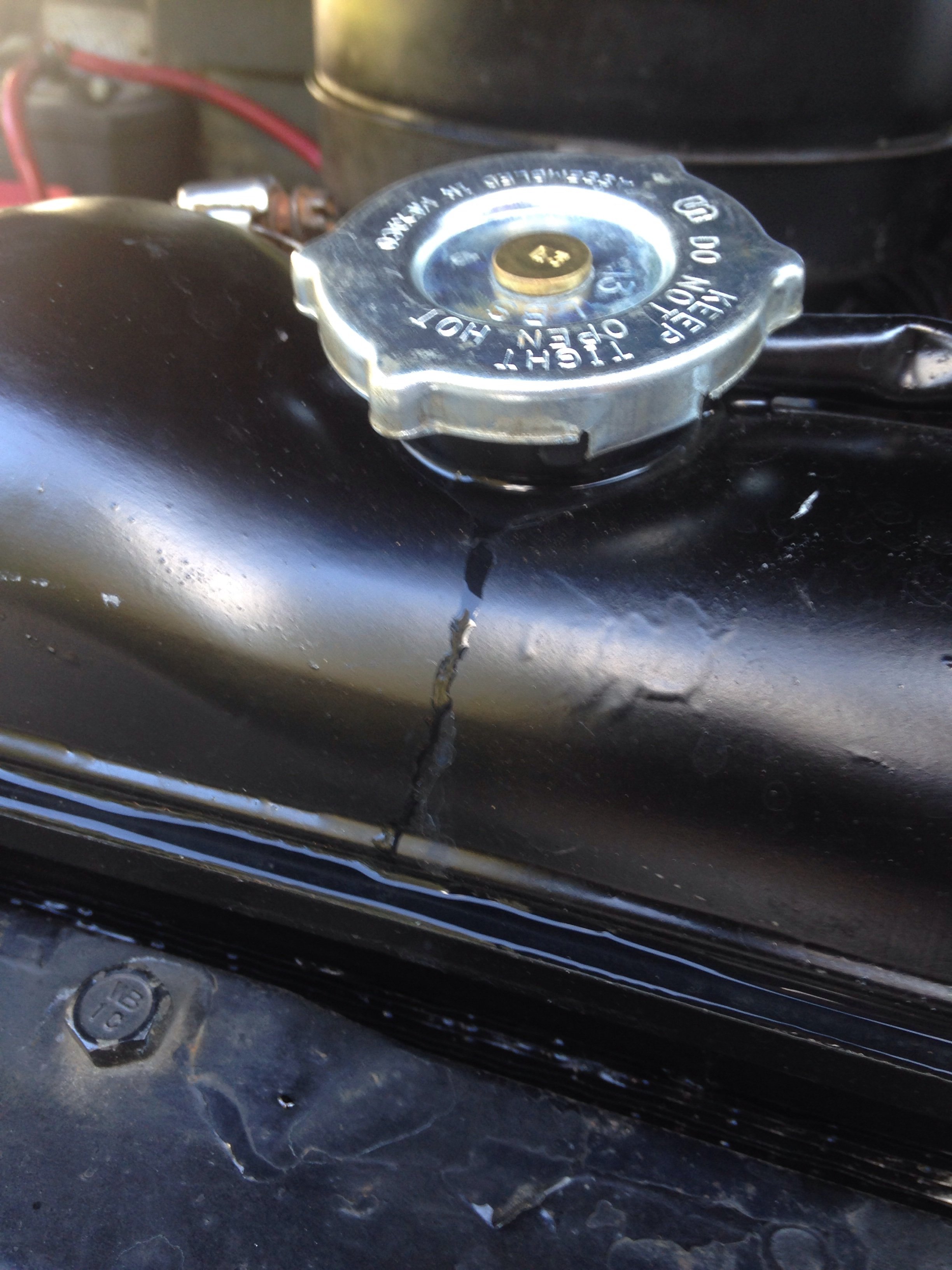

    Took it out today for its first extended ride. Mostly seemed fine, however i did notice a small bit of water coming from the base of the rad cap neck. To the best of my ability, it did not seem to be coming from the cap at all. I watched it flow and drip a few times. Back to the rad shop it goes.
