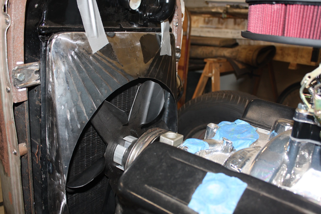

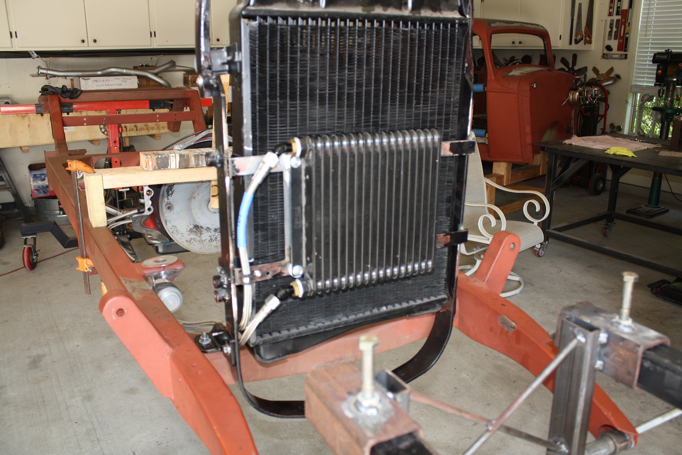

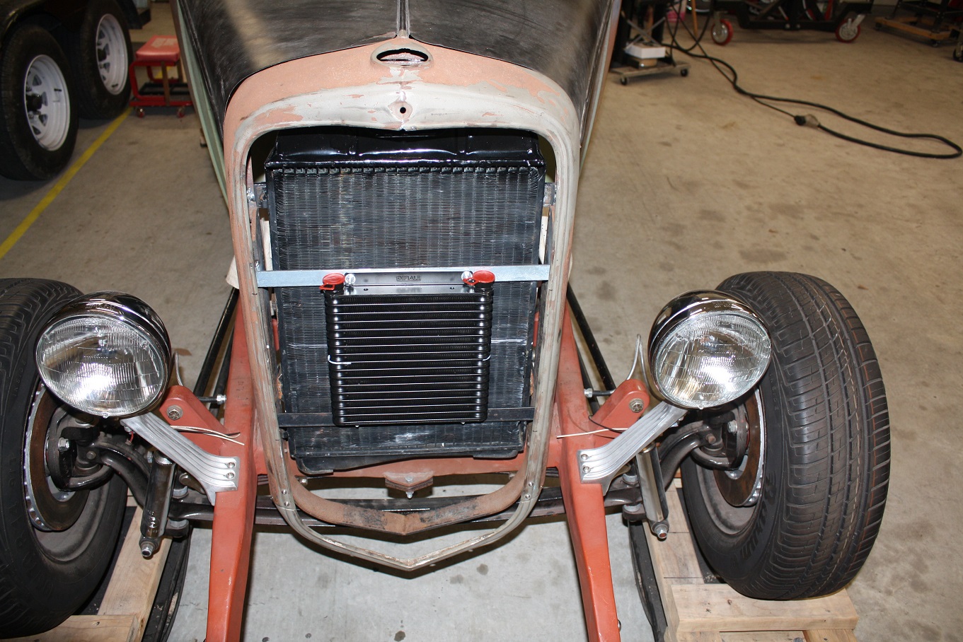

    My radiator doesn't have the bottom reservior for the automatic transmission fluid, so I install a transmission oil cooler in front of the radiator with about a 1" spacing between the cooler and the radiator. I also have a fan shroud with a 14" fan. I first ran the V8 in the frame, but the trans wasn't hooked to the ring gear so no trans fluid was going thru the cooler and the engine temp was 185-195.
    Once trans and engine was hooked up togerther the engine temp will get up to 220. The engine didn't seem hot, I was a little concerned that the cooler might be the reason for my high engine temp. The V8 wasn't in perfect tune at this high temp reading. Everything is in tune right now but haven't run the engine long enough to see any high temps.
    My question is has anyone had high engine temps running an trans oil cooler in front of their radiator?

    Idling is the hardest time to cool the engine as forward movement is not pushing air through the radiator. Air only moves by the fan.
    I'd say the trans cooler is blocking enough of the radiator to cause less cooling than needed at idle.
    I'd suggest moving the trans cooler under the car, even if it is mounted horizontally. Convection (hot air rises) should carry adequate heat away from the cooler.

    Its hard to tell in the picture, but it appears that your fan is completely inside of the fan shroud, it should be 1/2 of the fan blade pitch inside of the shroud, and 1/2 of the fan pitch outside of the fan shroud. That probably doesn't make much difference at an idle, but it could cause a problem at higher speeds when the car is moving through the air.
    It also appears to be one of those flex blade fans, I don't like them much, seen way too many flatten out way to easily, way too fast. It it flattens out too fast, it can't pull the air through the radiator like it should.

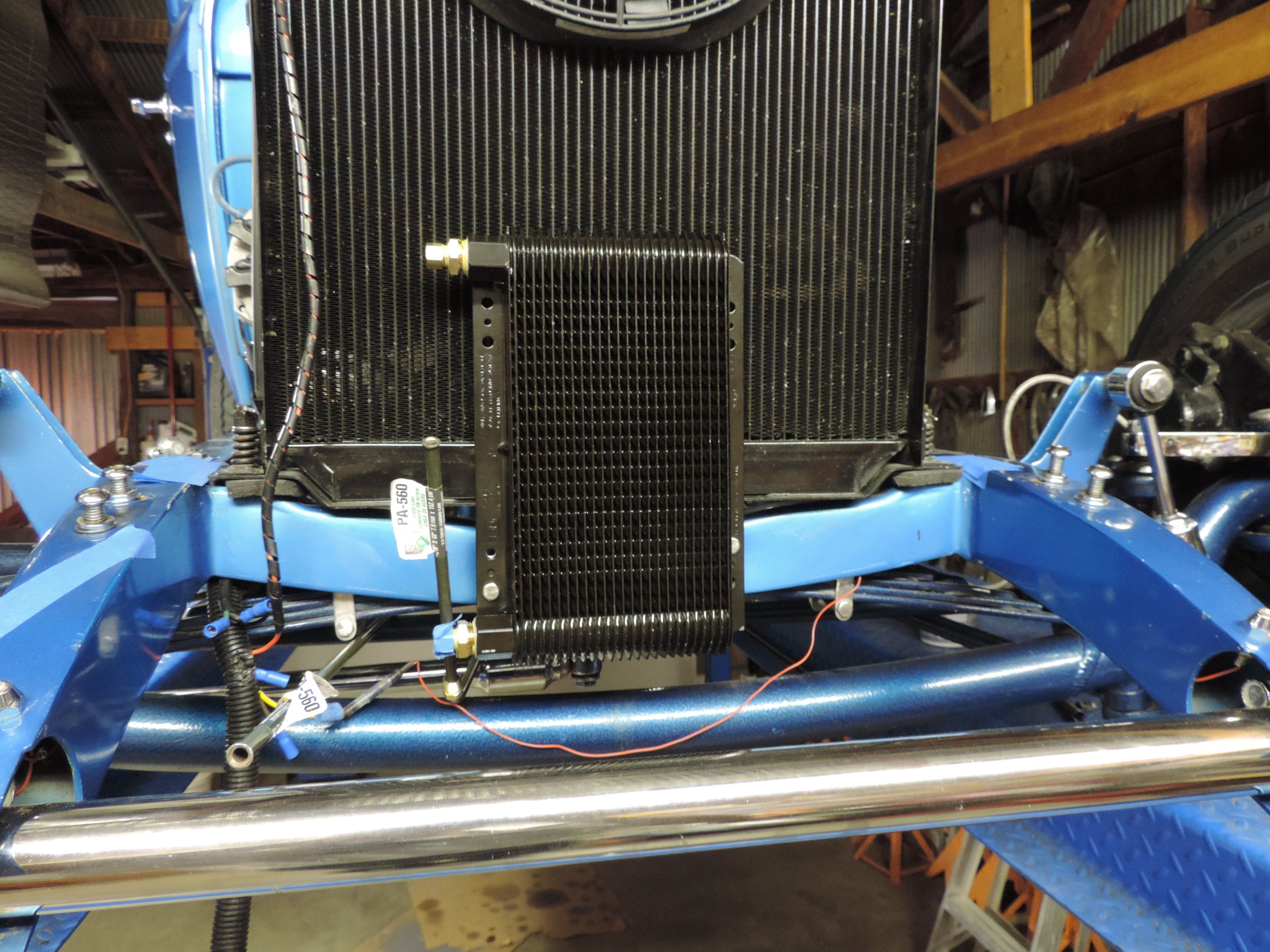

    I run my cooler up front too with an Eelco tank blocking the air and no fan shroud. It only gets hot (210) if it's at 170-180 driving around then get caught in sitting still traffic for 10-15 minutes.
    As soon as I get moving again the temp drops pretty fast, I definitely need to make a shroud for it.

    Your trans cooler looks way too large. The one in my 33 Chevy is about 1/3 that size and is mounted under the fender. I also have an A/C condenser in the front. No overheating.

    That trans cooler looks bigger than the one on my 5.7L Tundra with the trailer towing package.
    Coolant temp will always be dependant on ambient, so without knowing your ambient temp, difficult to say if there is a “problem”.
    I would say at anything below 80F ambient, at engine idle, your coolant temp should be less than 200F. If you have a thermostat, what is it set to open at?

    That's a big cooler. Might try unbolting it from in front of the radiator, run the engine. If all good, you'll know if the cooler is blocking air.
    mixerman and ClayMart like this.
  14. Rolleiflex
    Joined: Oct 25, 2007
    Posts: 1,505
    Rolleiflex
    Your car is looking real nice, great fabrication work!
    I agree with @gene-koning about the fan inside the shroud. I had a similar problem on an off-topic car where the fan was too far inside the shroud.
    I'm not saying that it's the root of your problem, but it something that's easily corrected.
    Pictures can be deceiving, but from the looks of it if you eliminated the spacer behind the fan, it'd be right about where you want it to be. As it is it's too far inside the shroud to be effective.
    mixerman likes this.
  15. Doublepumper
    Joined: Jun 26, 2016
    Posts: 1,997
    Doublepumper
    from OR-WA, USA
    Fan spacing inside the shroud looks ok, but with another look notice the fan looks rather wimpy for pulling much air. It may be that a fan with larger blades, could be the ticket to getting sufficient air through the rad. with the cooler in front. Good luck!

  16. mixerman
    Joined: Jun 23, 2021
    Posts: 255
    mixerman
    Thanks everyone for the great advise from all of you.
    I did have a 1/2" fan spacer during the first start up and changed it to a 1" spacer that you see in the pictures. I did this after reading that the fan should be half the thickness inside the shroud, but haven't run it yet. Another common thing is everyone that had posted picutres shows that your coolers aren't in the center of your radiator. This gives me an option to move my cooler down to the lowest point on the radiator. That should free up more clean air to go thru the radiator. There is another idea of installing a larger diameter fan. I did check the air flow and the fan is pulling air and it's a real had breeze. I wish my shroud had more depth, but the fan mounted without a spacer to the water pump, the baldes hit the harmonic blancer, more depth would give greater draw across the radiator.
    I know I'll get this issue worked out with y'alls ideas, and will post my solution when the temp is correct.

    Just noticed that your shroud has no “collar” around the opening. Without some sort of collar surrounding the blades, I’m guessing based on my experience, that shroud is almost useless. Blade tip clearance between blade and “collar”, and blade depth into the “collar” are important parameters in fan efficiency.
    '49 Ford Coupe and mixerman like this.
  20. mixerman
    Posts: 255
    mixerman
    I had just looked at that today, with real close clearance issues I could put the 1/2" spacer back on and maybe put a 3/4" thick collar on at best. That would be at least something.

    I got to say you all have given me a ton of good information, and the last few days I have researched all of the suggested solutions. I'm going to try them one at a time and see if any change is good or bad and give feedback on each one.
    1) Add a collor to the opening of the fan shroud (done just need to install) and set the depth of fan in shroud collar.
    2) Shorten the gap between the cooler and the radiator from 1" to 3/8" (done)
    3) Lower the trans cooler to the lowest point on the radiator.

    I got the shroud modified with the collar and installed.
    It's only a 3/4" wide, which is about all I could do with a 1/2" fan spacer.
    Before
    After
    A little bit closer view of the fan blades in the shroud collar...not to clear of a pic. The gap between the outer blade and the collor is about a finger width.
