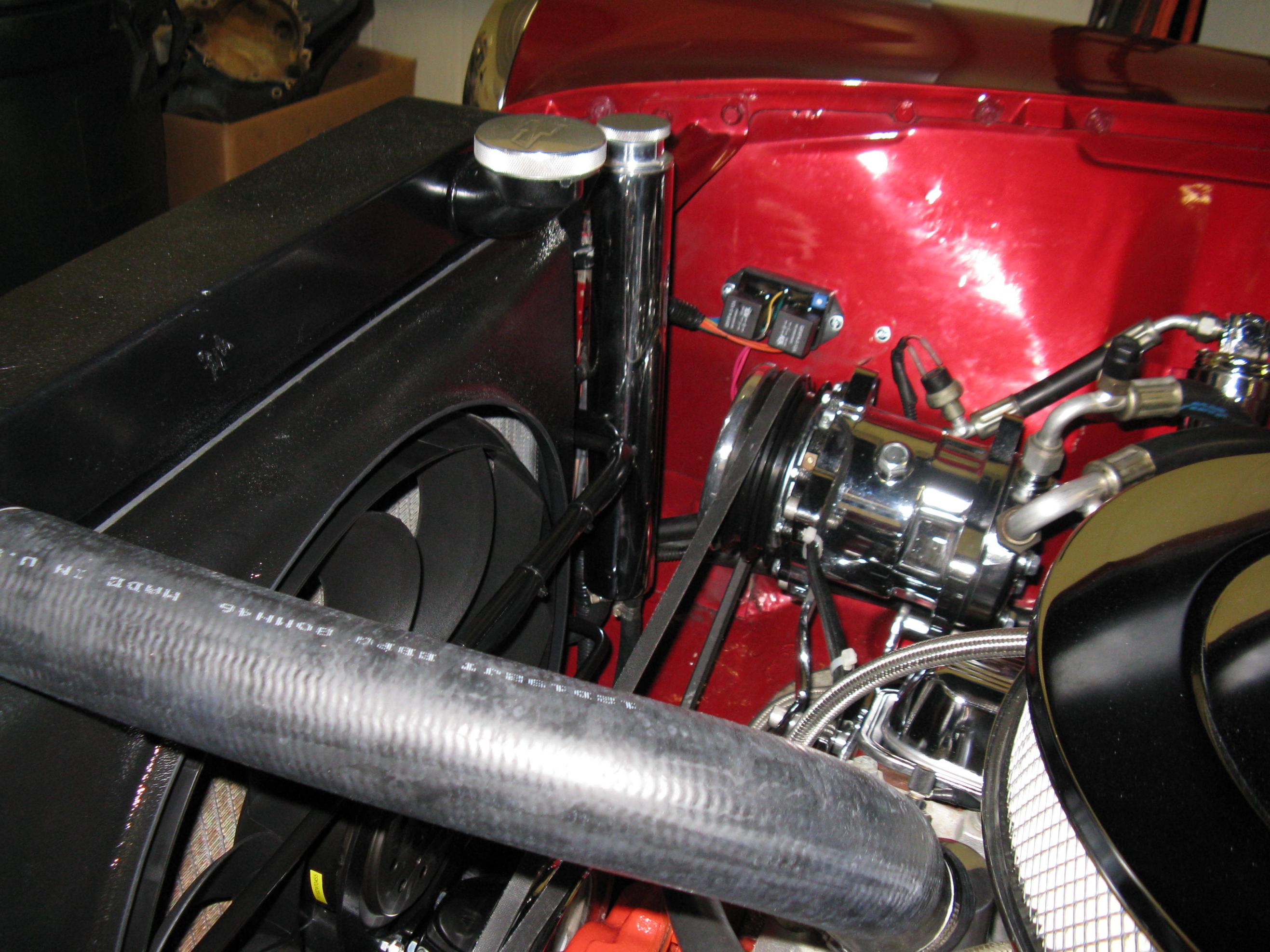

    I believe I have made significant progress. I cleaned the radiator. You will see from the pictures what a mess it was. There was a thick coat of that powder coating all over the exterior surfaces. Fortunately, it didn't get on the interior surfaces sufficiently enough that the boiling vat couldn't take it off.
    (BTW, it was made by Mattson's Radiator, not Hattson's. It must have been done back when they were building copper/br*** radiators. http://www.mattsonscustomradiator.com/ It is a very nice unit.)
    After finishing cleaning and painting the radiator, I installed the Cooling Components fan setup. This also is a very nice setup and is only 2 5/8" thick. It really moves the air, too. Unfortunately, I still had to tilt the top of the radiator out 3/4" to get the fan housing to clear the water pump shaft. I have about 1/8 -3/16" clearance now. The shroud comes with extra flange material, so you just cut it to the size you need and screw it to the radiator. Since I already had threaded nutserts in mine, I just used them.
    The two speed fan module is the only thing I had trouble with. I cannot get it to adjust. No matter where I set the pot, it comes on immediately and does not cycle off. Also, the high speed relay does not cut in.
    Despite that, I drove around in 95 degree weather today and it stayed around 185-190 while I was moving. When parked and with the AC on, it got to 200 once. I believe it will cool down further when I get the fan control fixed. So, I'm crossing my fingers and hoping I have this one finally fixed. It has been an aggravating and trying experience, for sure.
    Thanks for all who offered help.

    I would have never never thought about powder coating but from your excellent description it did sound most definitely sound like a heat transfer problem within the radiator. When that shows up, most every time its a build up inside the tubes. (99%) Heat transfer problem at the radiator due to external coating
    will now be the 01% lol.
    Your electronic controls problem, my first thought is to check the wiring - there are two functions that are inoperative. Next would be to suspect the POT since it signaling the relay 100% of the time. Or again with the wiring at the relay.
    I have had several fan controllers melt from the electrical loads. I make my own now.

    1. If it does not overheat on the road running at highway speeds....it is NOT a radiator problem....the radiator has the capacity to do its job and is doing it.
    2. Your shroud needs to be about an inch or so from the blades end....and the fan needs to be 2/3 in the shroud and 1/3 out. It does not need to be a complete circle.
    Did not read this whole post so if I am repeating any thing...then I support their answer.

    Well, I have installed the new module and have it working as it should. The 2 speed fan in the Cooling Components setup is working great. Highly recommended! It was only 90 here today but at idle, it and the newly "de-powder coated" radiator seem to be able to do the job they were designed to do.
    I will not post back to this thread unless I have problems. Thanks to all who helped.
  17. I am glad that you have apparently fixed your car! You took care of a bunch of little problems and learned much about your car.
    I can see why electric fans cure some problems, the shroud fits well, and the fan is spaced correctly. All in one package.
    The deal with the powder coating is a new one to me. The temperature that it needs to be baked at is very close to the melting point of low temperature solder! Just a bad move all the way around.
