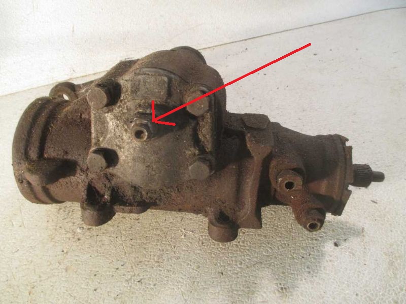

  19. And you swear on a stack of old Hot Rod magazines you didn't fiddle with this this twisty thing? 1963 pontiac steering gearbox-1.jpg
  20. Motoguy
    Joined: Mar 31, 2010
    Posts: 71
    Motoguy
    from Michigan
    I did not. However...after I changed out the front end components, and the car didn't handle properly, I took it to the local GM dealer. He checked the alignment AND he said he adjusted the steering gear box. The car didn't handle any differently when I got it back from them.
