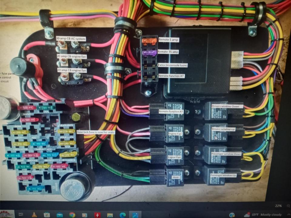

    This is what I do for my own records and to print a copy for the owner to show any additions made to the purchased harness. Easy to do in "paint".
