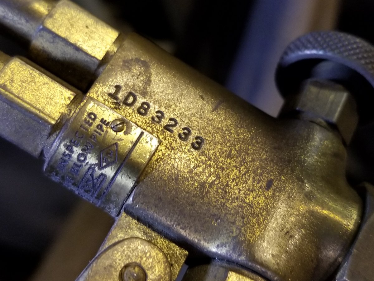

    I bought a torch set from the family of a deceased club member a few years back. Now it's time to buy some new hoses and a much needed rosebud but I'm not sure what cross references to the torch body I have.
    All the torches are Purox and this is the number off the cutting torch which shows nothing on a Google search, the torch body also has a 33 on it. So would this be the same as a Victor 300 ? 20180822_201926.jpg 20180822_201947.jpg 20180822_202119.jpg

    Purox and Victor don't cross if memory serves. Might be about the same size BTU wise, but you won't be able to physically put together different tips to different bodies. If you're running a Purox handle, best to get Purox rosebud. There's some off-brand stuff that does cross, but it usually crosses to Victor style, so it probably won't be much help to you.
    That said, ebay or your local weld shop. Usually the small shops will order you whatever tips you need.

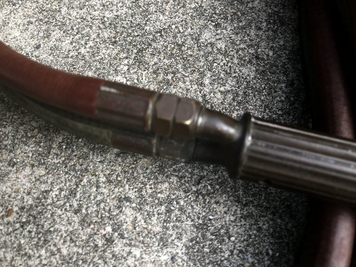

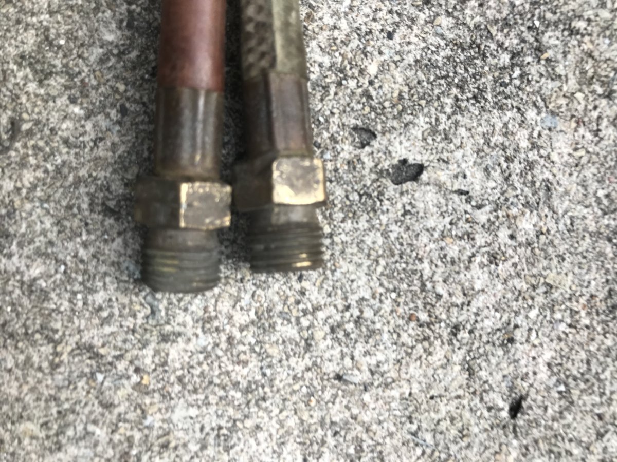

    Well the new 1/4 inch hoses don't fit, only 1/4 at one end on my stuff..doh 20180825_172740.jpg 20180825_172807.jpg

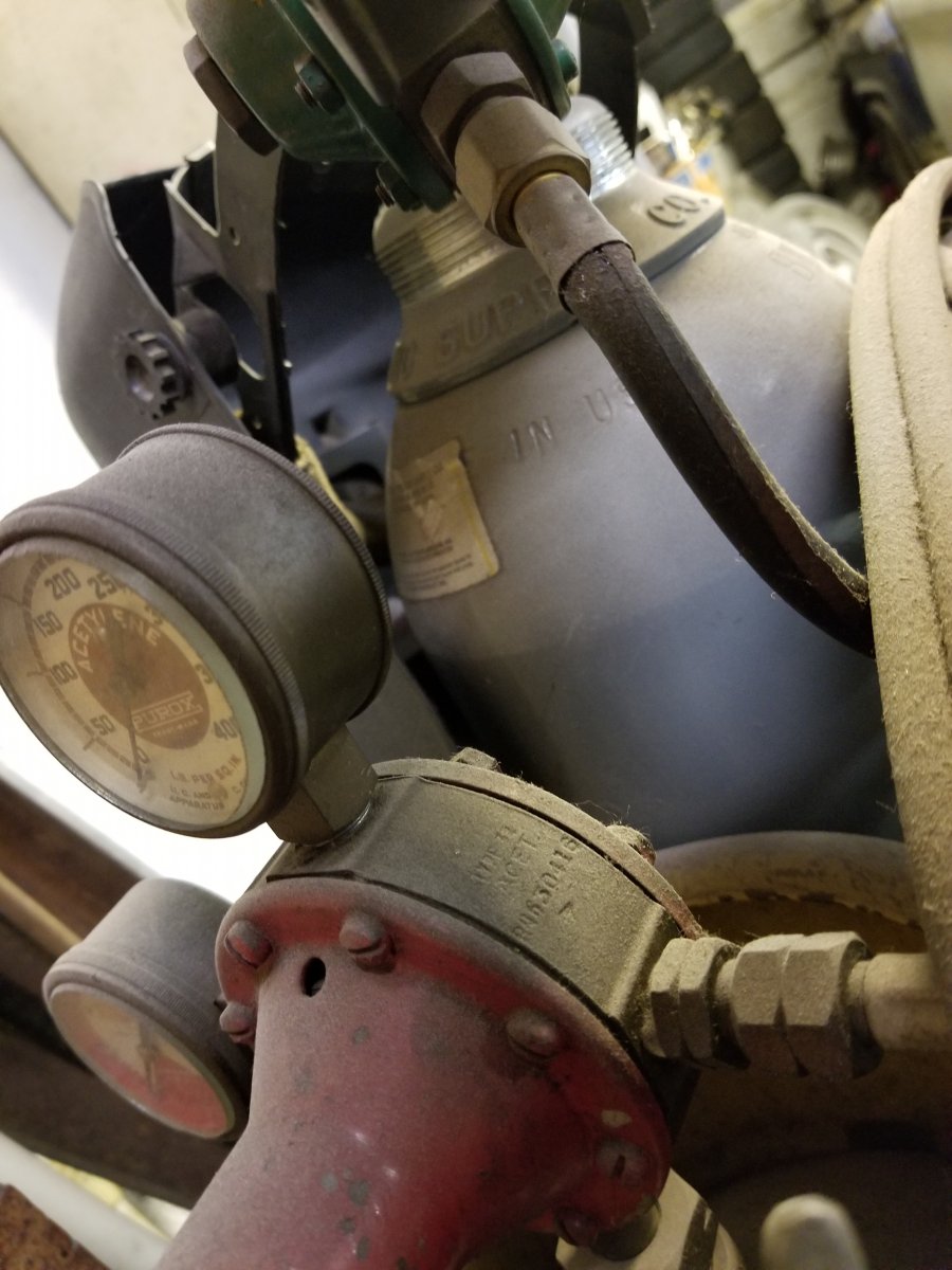

    B64EF725-37C9-48B7-A760-D4207F8585DB.jpeg 243E916B-5C35-4E5A-A27F-C15029AC3F27.jpeg C29D5978-7B09-4ADD-B90E-519506E209C9.jpeg I just picked up the exact Purox handle this week from a neighbor, but mine came with a 5’ whip that is 3/8-24 female to the torch and 9/16-18 male on the other end.
    I can hook up my present female hose ends (9/16-18) to the whip on the Purox handle, but in your case you need 3/8-24 male (to your hose) x 9/16-18 female adapter fittings to connect to your regulators.

    To bring this up to date, I found the adapter fittings at AirGas welding shop right in town, all set to go with my current torch heads and the standard hose I had purchased.
