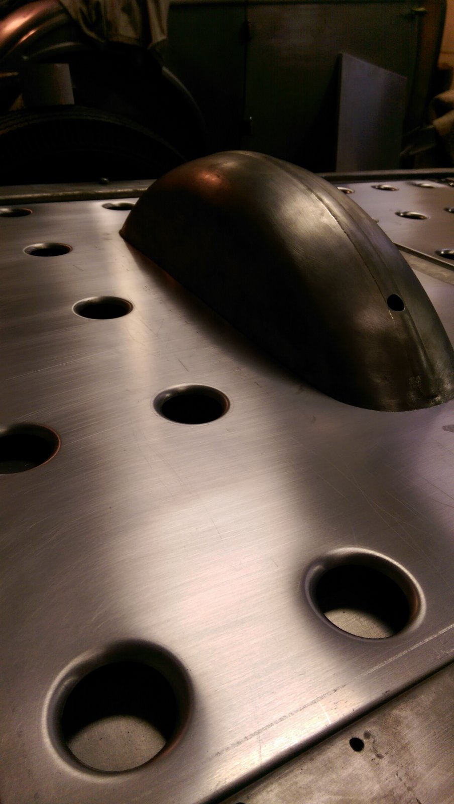

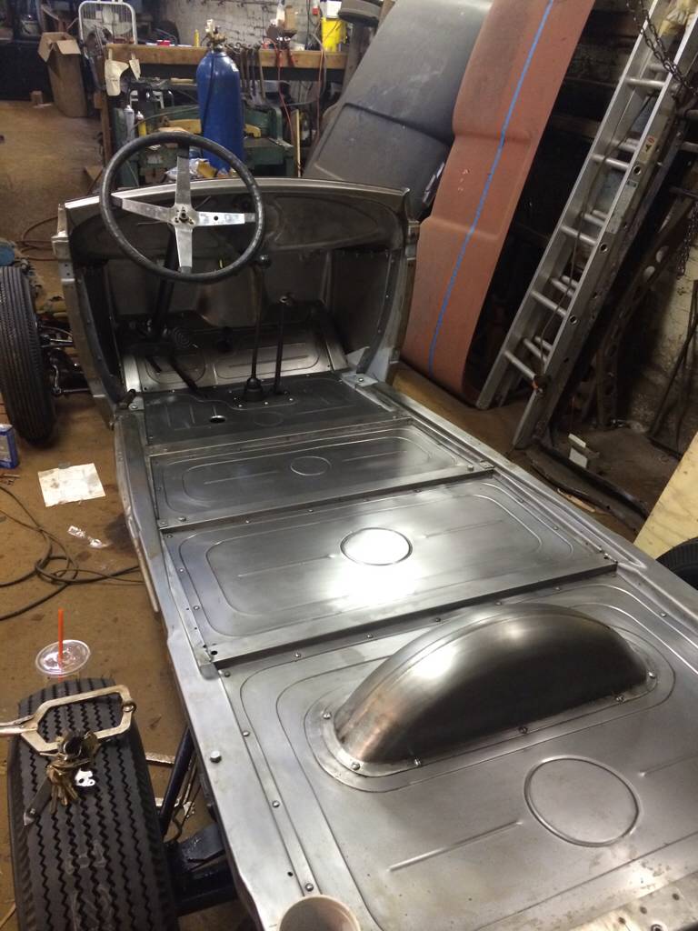

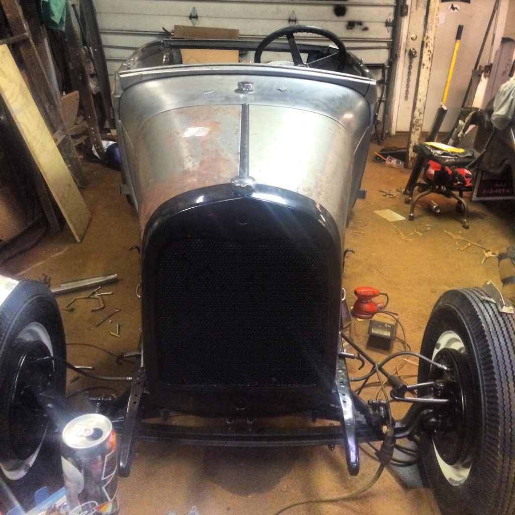

    ImageUploadedByH.A.M.B.1436482862.061901.jpg the next step of the floor

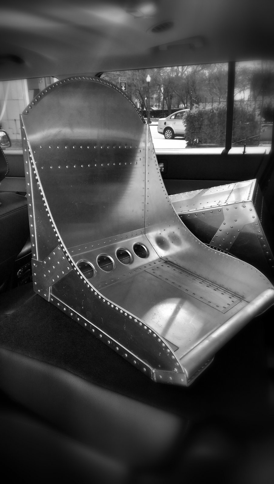

    ImageUploadedByH.A.M.B.1436482913.682437.jpg made the seat riser today .
    All aluminum work .

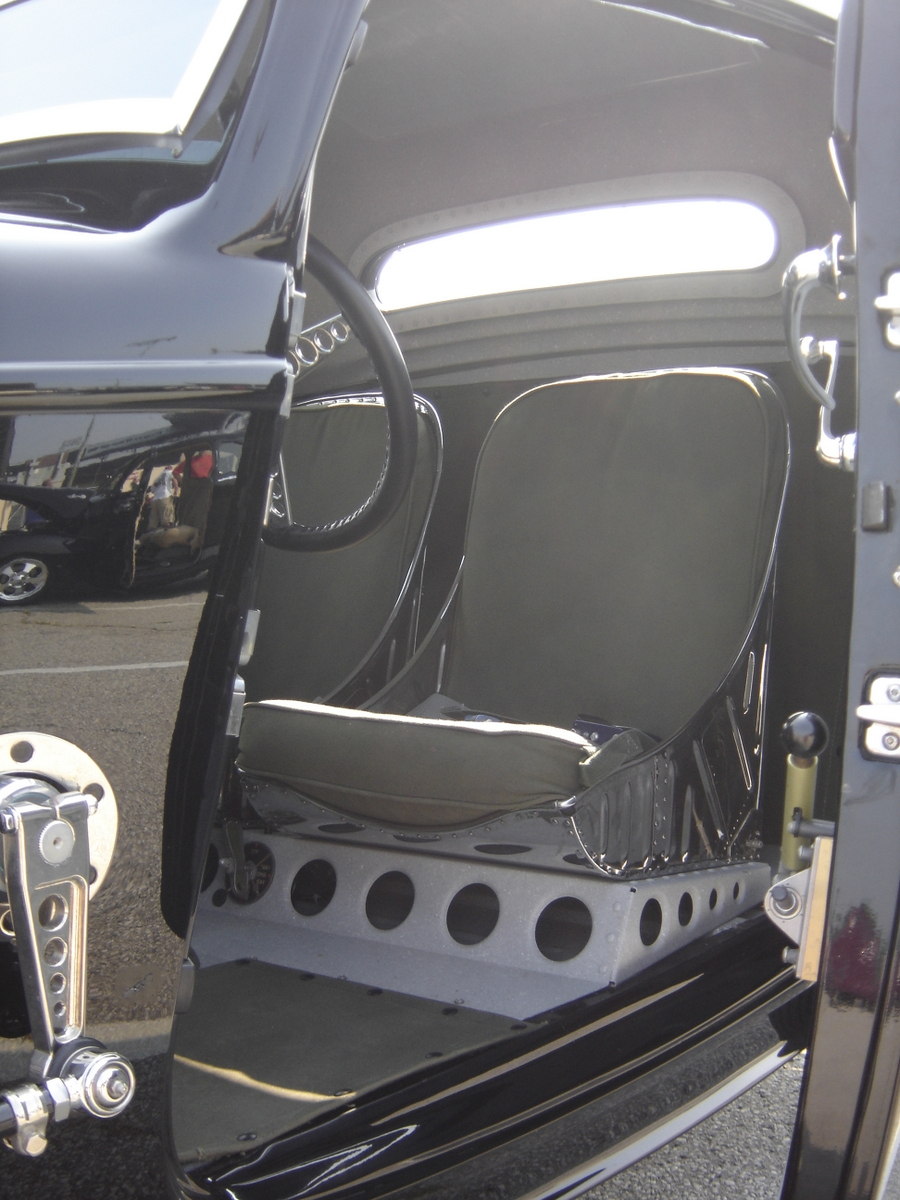

    Wouldn't mind more pics of the bomber seats.

    But why the double floor?

    Thanks everyone ! Brg .... It's like chopping a top . Custom taillights , shaved handles etc. ... What's the most prominent space in an open car with no top? The interior . So why not make it like something we have never laid eyes on before and pop .

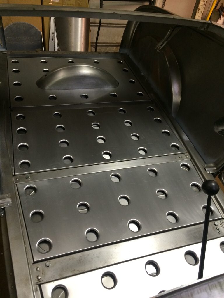

    While I think they look really cool, is there a practical reason for the holes in the floor? I'm thinking that moisture/ dirt would gather in between the skins, especially being a roadster.
    I was also wondering if there some sort of insulation you are using between the floors? I'm building a double skinned floor in my truck as well and curious as to what you may be thinking.

  21. Really great metal work...especially the seats!

    Flop didnt make the seats. I had Mike kapuscinski from Syracuse ny make them for me.

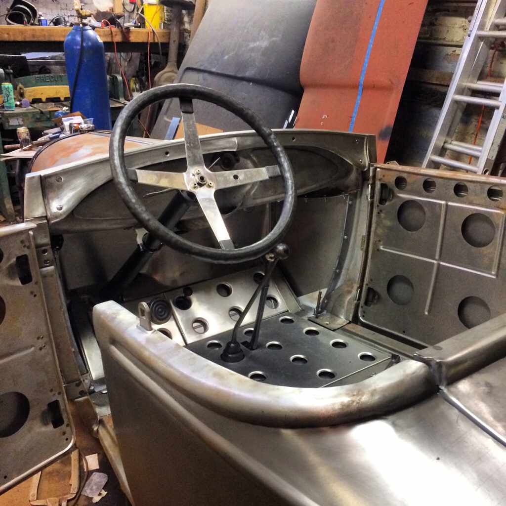

    The aluminum floor idea I had for this roadster was just like flop said a wow factor doesn't serve a purpose just different. I'm gonna have the whole car painted subrails and flops bottom floor but I'm leaving the aluminum panels that I put the speed wholes in so you can see the paint through the wholes. should be cool. Also gonna run a tonneau cover and no windshield. Did you notice the cool windshield deletes flop made. Cool little detail... IMAG0844.jpg

    I'm using little rubber spacers from Lowe's or home depot between the two for rattles and each panel is held in with 4 hidden bolts easily removed to clean the lower panels

    Pullmax and a 24 inch mittler bros on the floor . I could achieve the same with my harbor freight roller honestly . But the motorized part of the mittler Bros make life easier .
