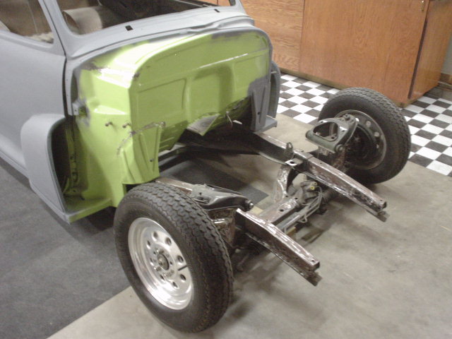

  25. oldguy829
    Joined: Sep 19, 2005
    Posts: 376
    oldguy829
    Guys, a little sympathy for a dumb ass OK? Here is what it looks like now. I should have done the front end first, but it seemed to drive OK so I went on to other things. Now I am not happy with it, especially the brakes, And it will really piss me off to tear down everything I just did. Bolt on solutions please???
