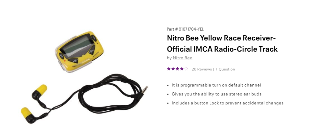

  20. TrailerTrashToo
    Joined: Jun 20, 2018
    Posts: 1,526
    TrailerTrashToo
    Old retired electronic guy here. I did lots of communications stuff in the '60s thru 80's.
    DISCLAIMER: I am "Call-a-grandchild obsolete"
    First: A link to the radio
    https://www.speedwaymotors.com/Nitro-Bee-Single-Channel-UHF-Receiver,67397.html
    Some specifications from the speedway link:
    1. ... receiving any single UHF frequency between 440.0000 ~ 469.9875 Mhz.
    2. Ability to use stereo ear buds
    3. AAA Battery Required (not included).
    4. (DCS Digital Code Squelch) and CTCSS (Continuous Tone-Coded Squelch System). Used to eliminate problems of overlapping chatter on the same frequency where more that one user is on the same channel. The audio is "coded" much like a key to a lock and the individuals with the proper "tone code" int he radio and reciever will only hear each other, locking out all other signals except ones with the correct code.
    5. An observation from the picture in the above link - This receiver should fit in your shirt pocket.
    COMMENTS:
    1. Electrical noises in the race car electrical system (still using 6 Volts?;)) should not be a problem - you are using an AAA battery and totally isolated from the race car electrical system.
    2. This radio has some form of digital modulation - (DCS Digital Code Squelch) and CTCSS (Continuous Tone-Coded Squelch System). This "should" give you some resistance to the lower frequency radio frequency (RF) noise generated by the spark events.
    RECOMMENDATION:
    Show up at the first test and tune day with your Packard 440 Solid core wire installed. Be prepared to do a quick subs***ute of:
    1. Resistor ignition wire
    OR
    2. Resistor spark plugs
    Russ
