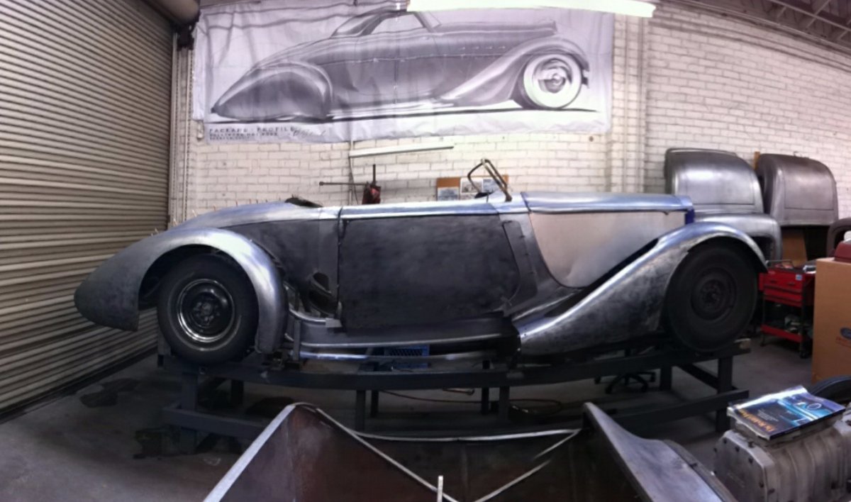

    Here I'm in mockup of the rear suspension design. We started with a Kugel independent rear end using a Winters quick change center section. We ditched to coil overs for our 1/4 elliptical/actuator setup, and we took the rest of the parts we still needed and used their dimensions to make more attractive parts to suit our needs.
    You can see here that the control arm has already been remade using I-beam axles. We made some subtle changes to the Kugel design, and as a result we widened the control arm at its attachment point at the center section.
    This is the rear hub I made to replace the stock Kugel piece. Which now includes the shackle hanger for the rear spring.
    Mocked up with a main leaf. The leaf spring pivot/mount went through a slight re-design after this photo was taken.
    Test fit of the hub, still some cleanup needed, but everything fits!
    Another mockup photo.
    Here is a mockup of some of the B-pillar structure, and you can see some sheetmetal work going on. I made the B-pillar piece, and the rest was done by other guys at the shop.

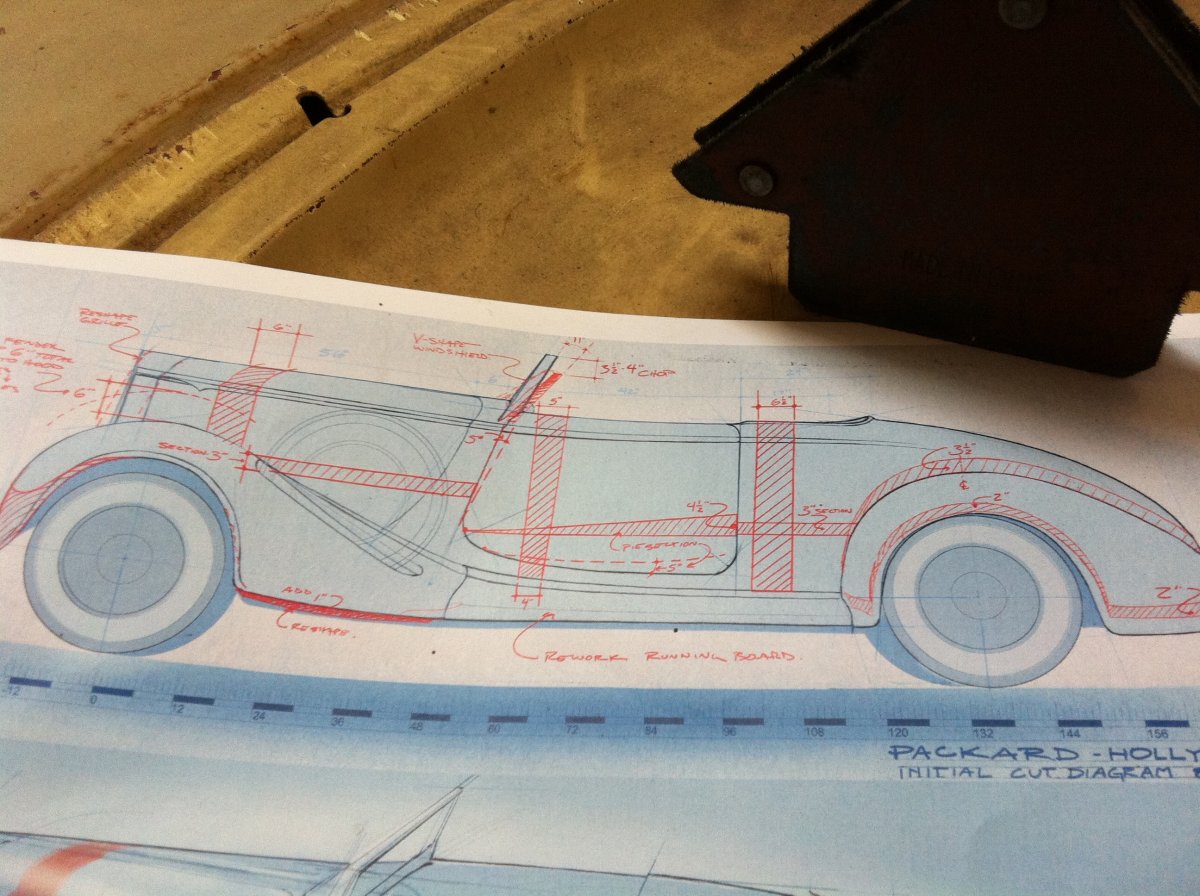

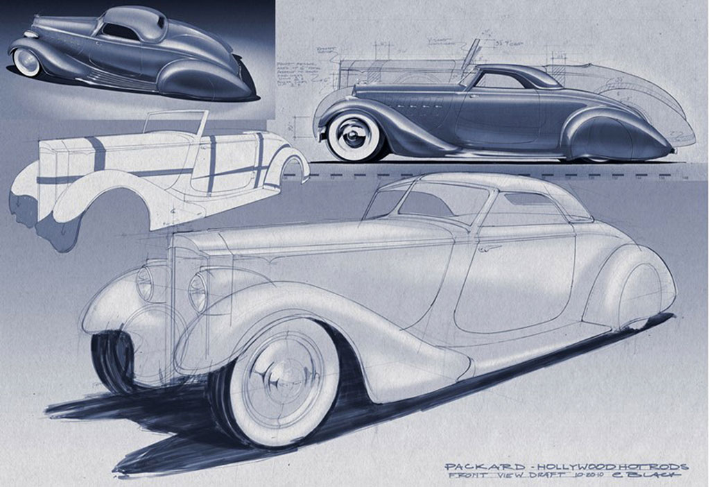

    We always planned for a supercharged Lincoln flathead, but didn't always have the Latham. Sorry it's a terrible photo, but this is a mockup of the engine with an empty case we had around.
    In the original drawings, the car had hidden hinges. Once we had a real car, and we saw the factory hinges, we knew that had to be included. They were just too cool. Some people don't like them, but we think we made the right choice. This is how they started.
