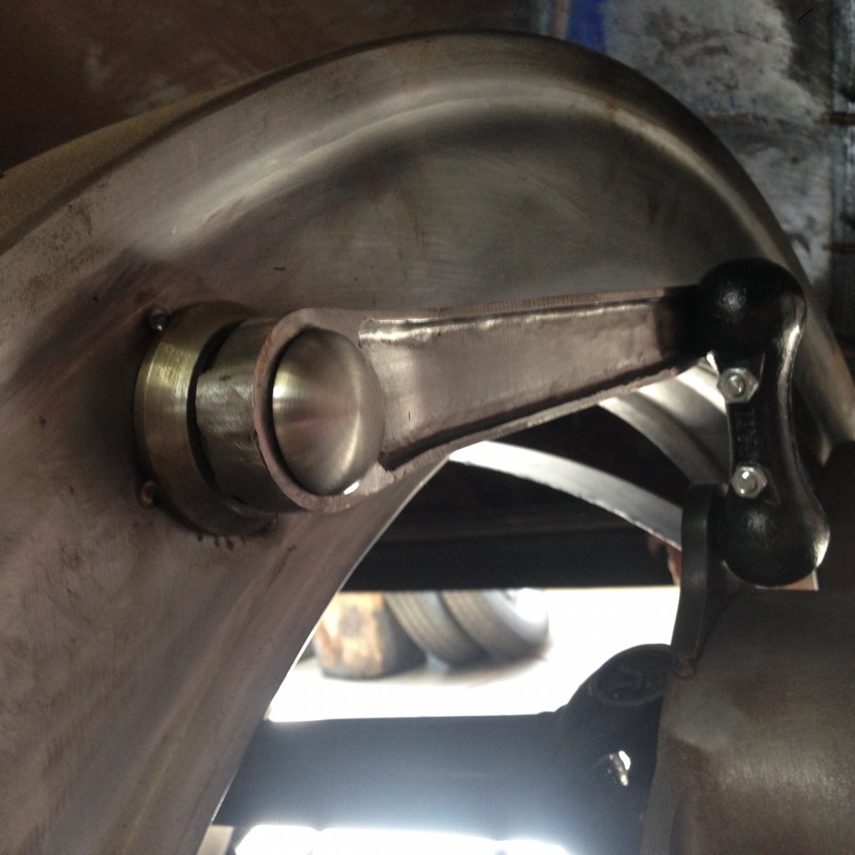

    Construction of the pitman arm. I needed to lengthen the pitman arm where it mounts to the box in order to clear the horn of power. I took a standard pitman arm, cut off the splined end and turned it round. Then I machined the extension the length I needed, and bored it out for the splined section to fit it. The splines were then welded in.
    Then I cut a radius on the end, and made a cap for it.
    Then welded the rest of the arm on, and added a rib.

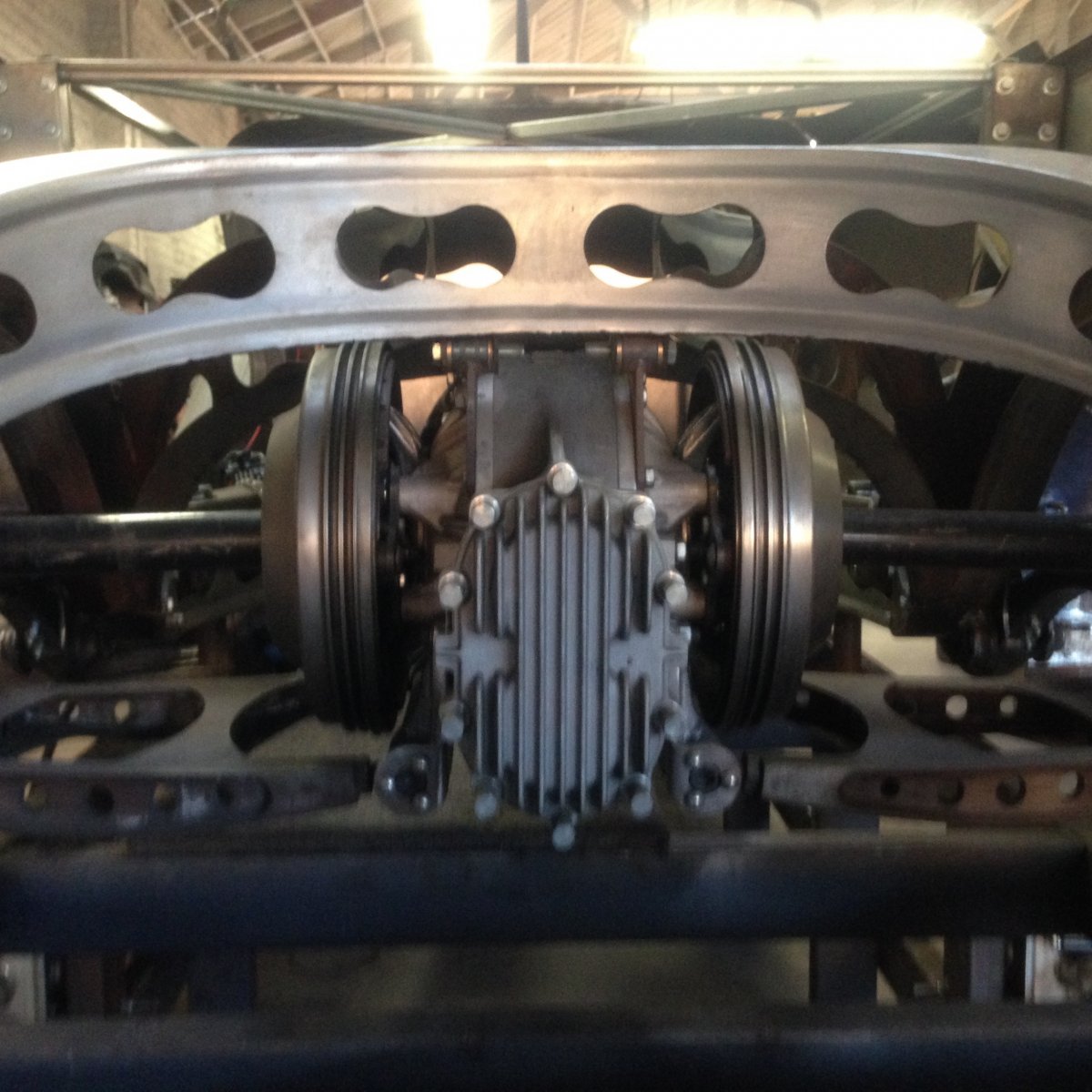

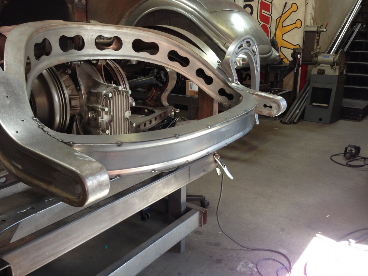

    This is how the rear drums were adapted to the rear end. These are the only custom made pieces for the ch***is that were not made in house. I drew them up on a piece of paper and they were CNC'd.

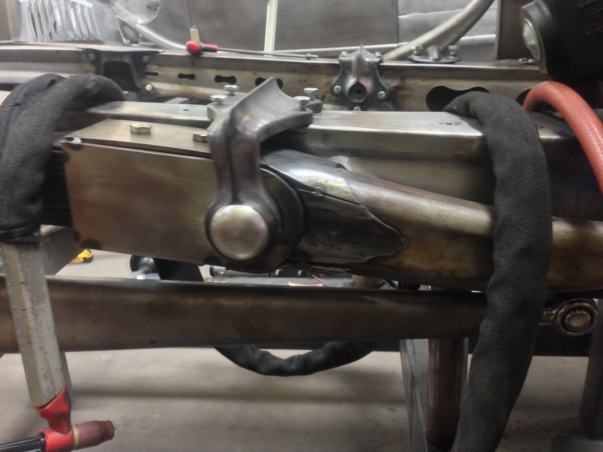

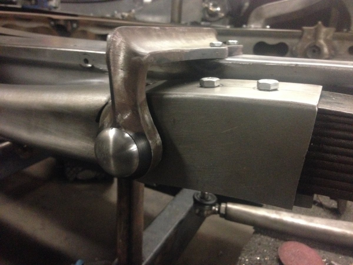

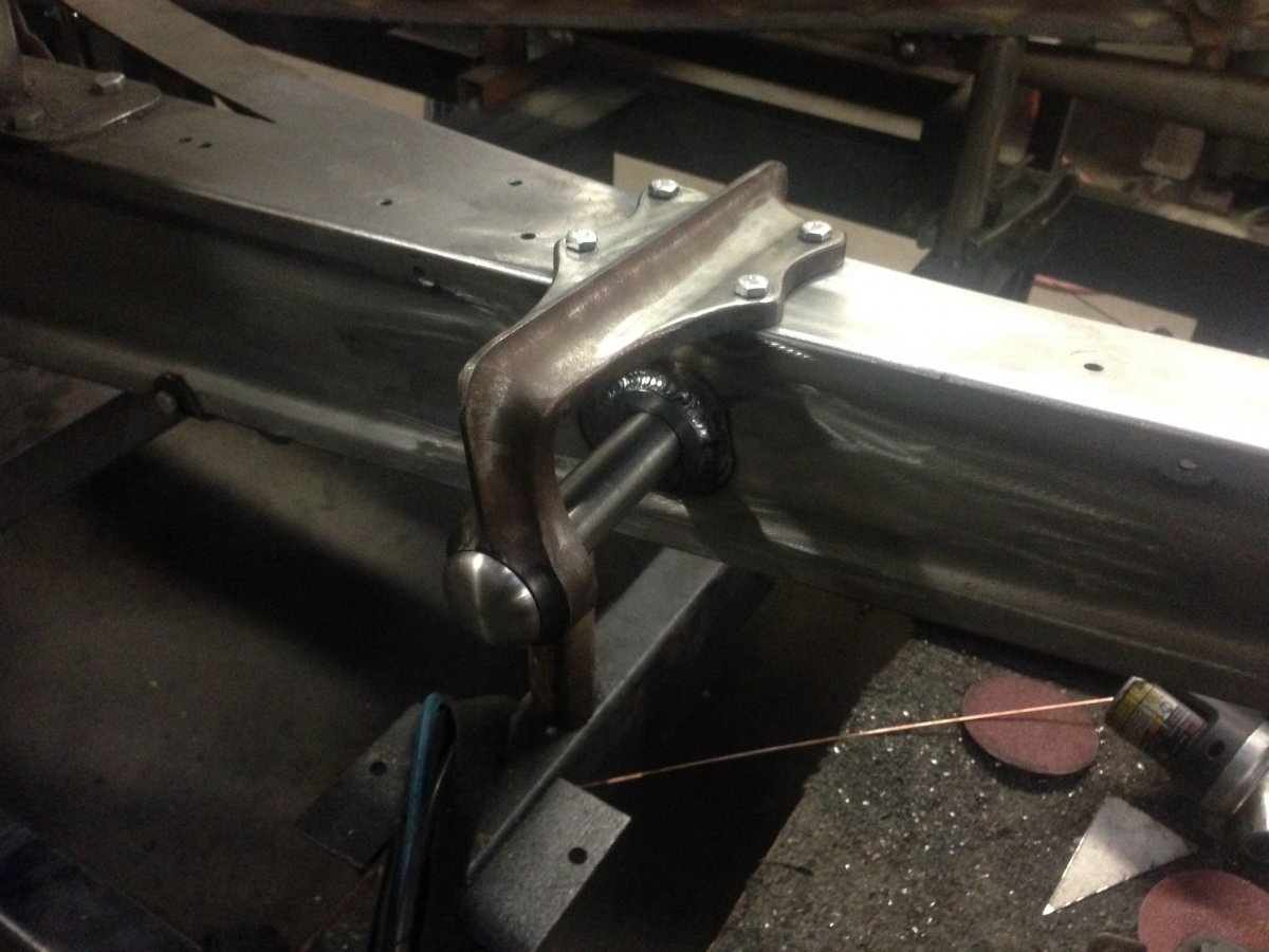

    These are just the front axle mounts. And another use of the Kyle plates, and a couple terrible photos of them installed.
    Wishbone mount, and bad photos of it installed.

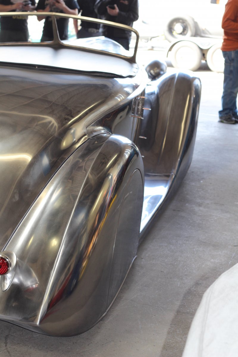

    Here are some photos I shot right before it went to GNRS '15.
    IMG_3018.jpg IMG_3019.jpg IMG_3021.jpg IMG_3023.jpg IMG_3027.jpg IMG_3039 (1).jpg

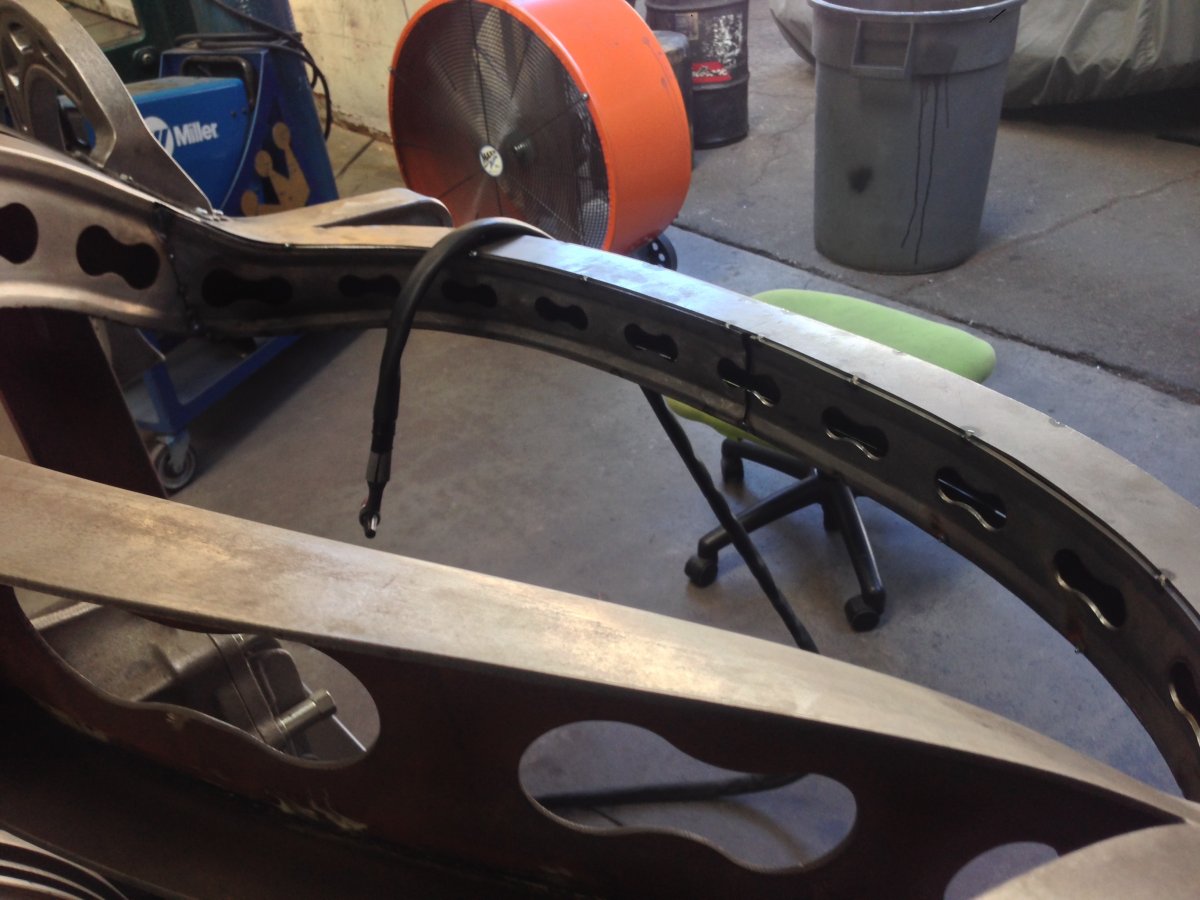

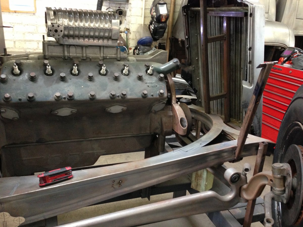

    Frame with engine removed.
    Backside of the front spring pivot.
    Horn of power connected to actuator.
    Fiting some fish plating on the front horns of power.

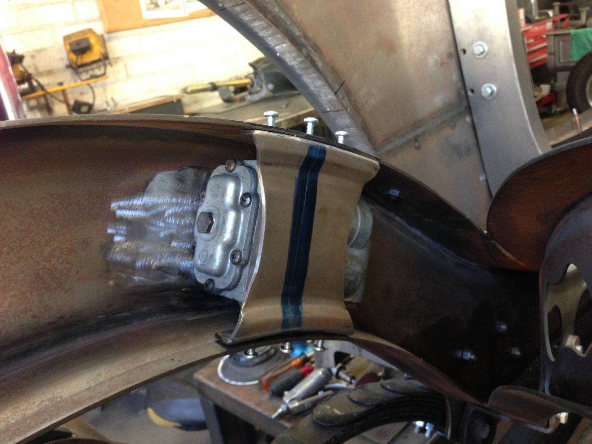

    This is the beginnings of the front shock arms.
  9. cretin
    Joined: Oct 10, 2006
    Posts: 3,059
    cretin

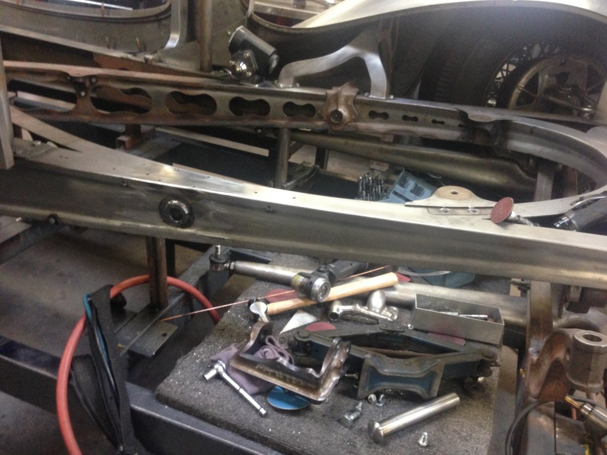

    This is the beginning of the rear most crossmember added to make attachment points for the pivots for the rear body, in order to make the disappearing top function how we wanted.
    This is an earlier photo mixed in. Engine is mocked up, as are grill, and a mock up front fender brace. In the lower left corner, you can see a template from a wishbone mount that I redesigned to the current design.
    Back to the rear crossmember.
    Inside
    Outside finished.

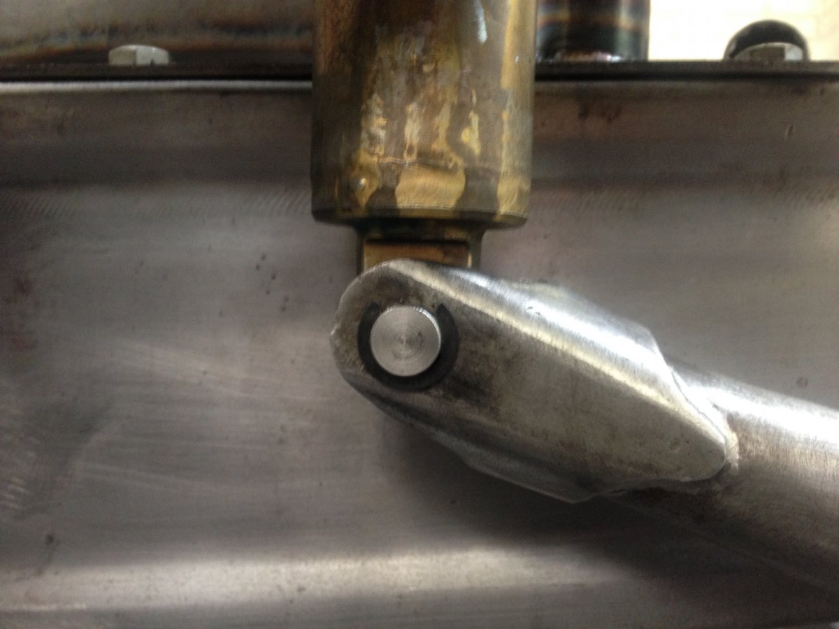

    This is the inside of the front shackles that I made showing the nut covers.
    The outside

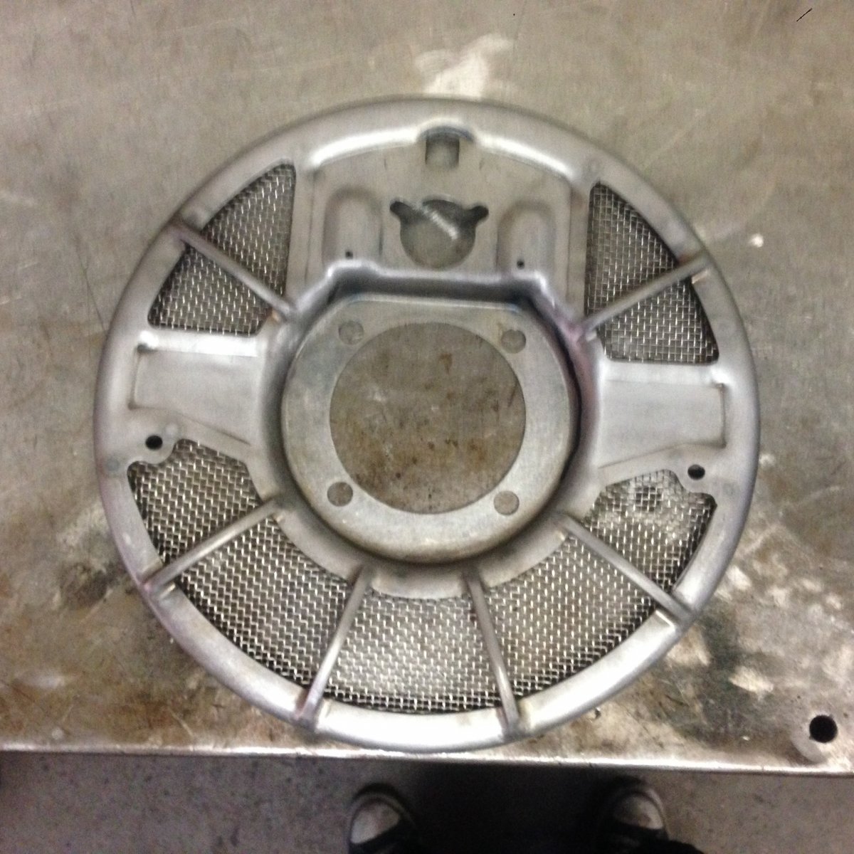

    Screens added to brakes.

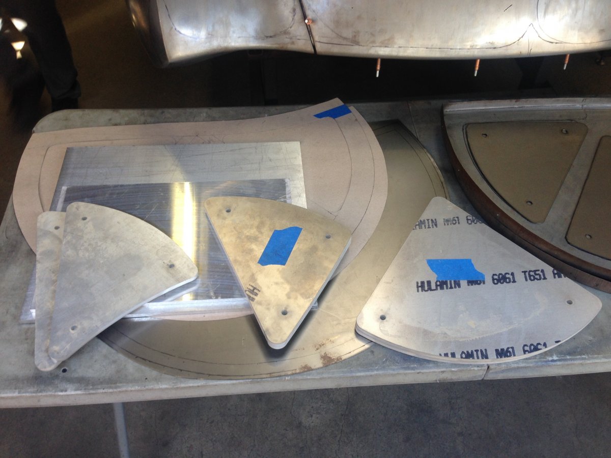

    Layout of the skirt structure.
    The die pieces used to form the structure.
    The inner structure after a 3/8" deep draw on the pullmax.

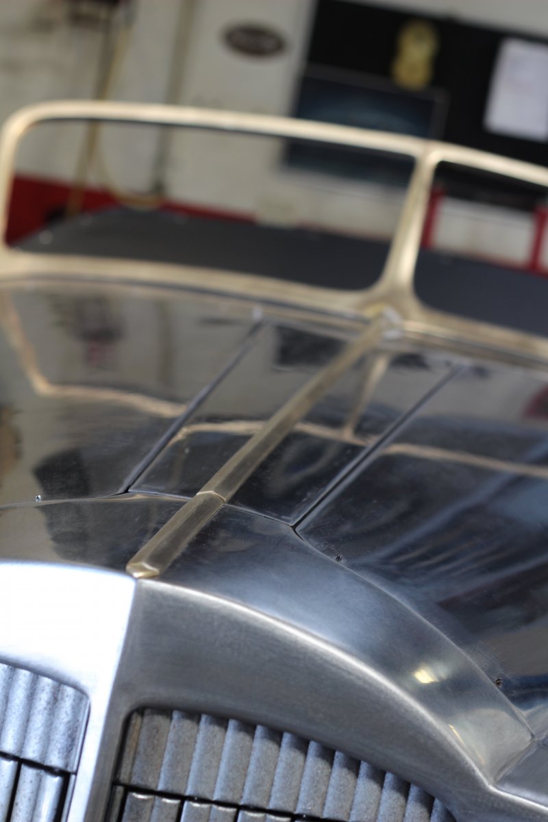

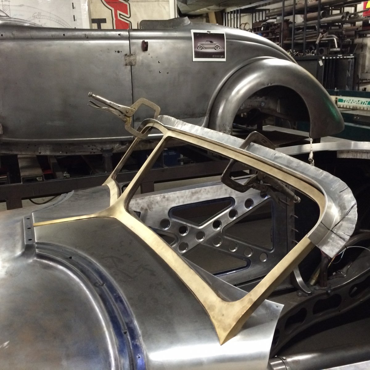

    Here, I'm working on figuring out the roof shape.

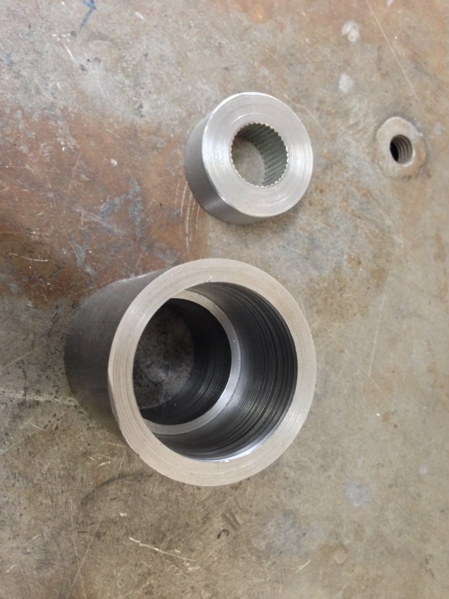

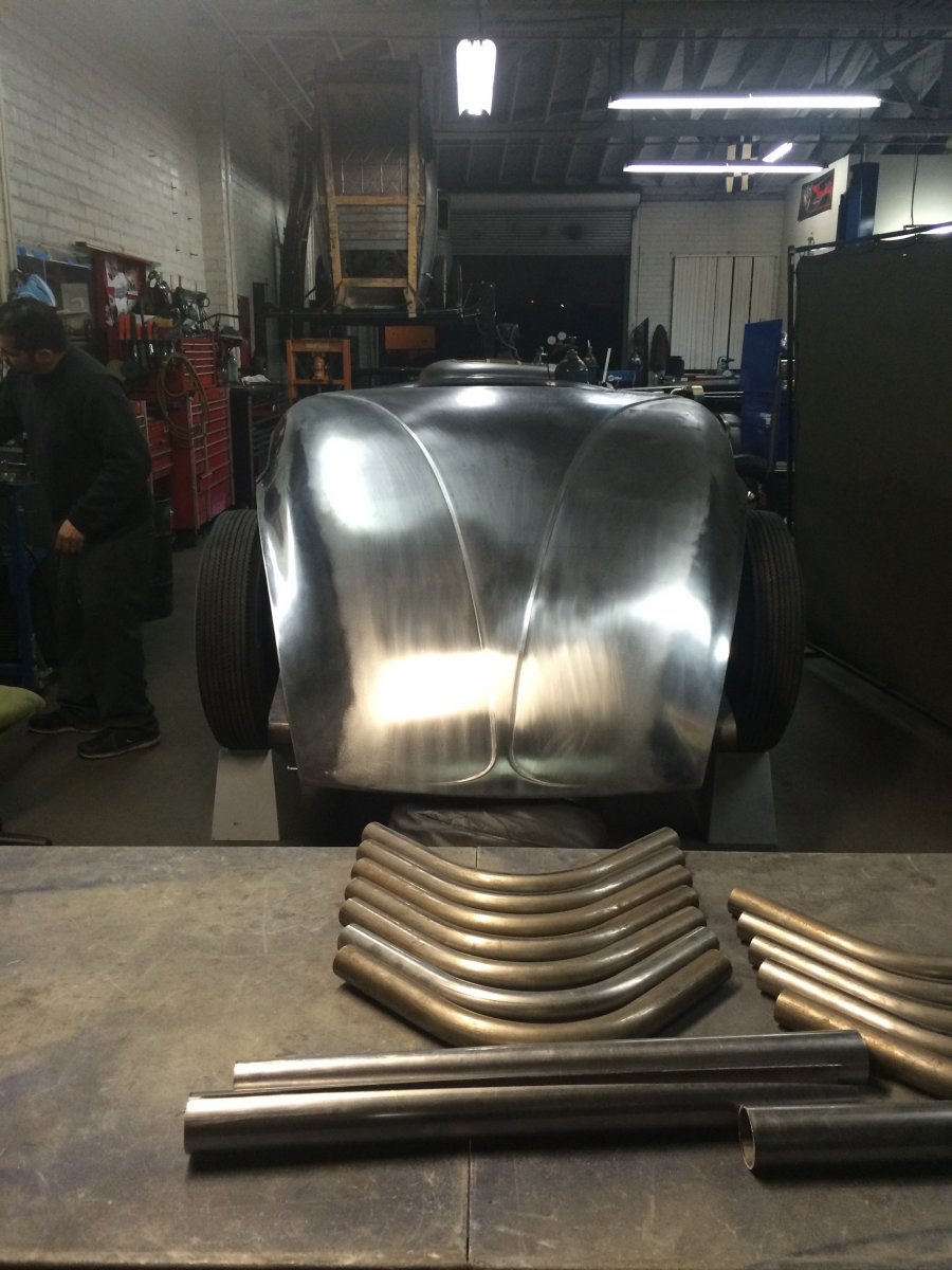

    Fitting the skirts and structure to the fender.
    Starting on making a header for the roof. Door structure in the background.
    Here you can see the fences that were made to put the beads in the rear body.
    Working on the hood door linkages.
    Beads put in rear body, and header materials.

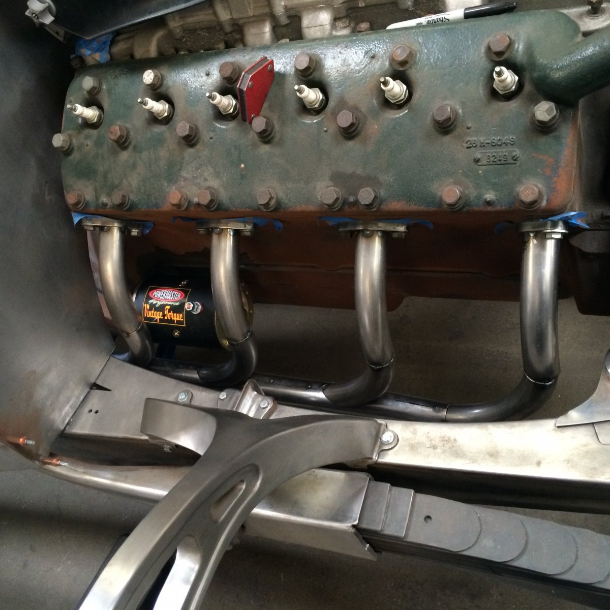

    I tapered the bottom tube, the started fitting the primarys.
    Then bolted them together and welded it up.

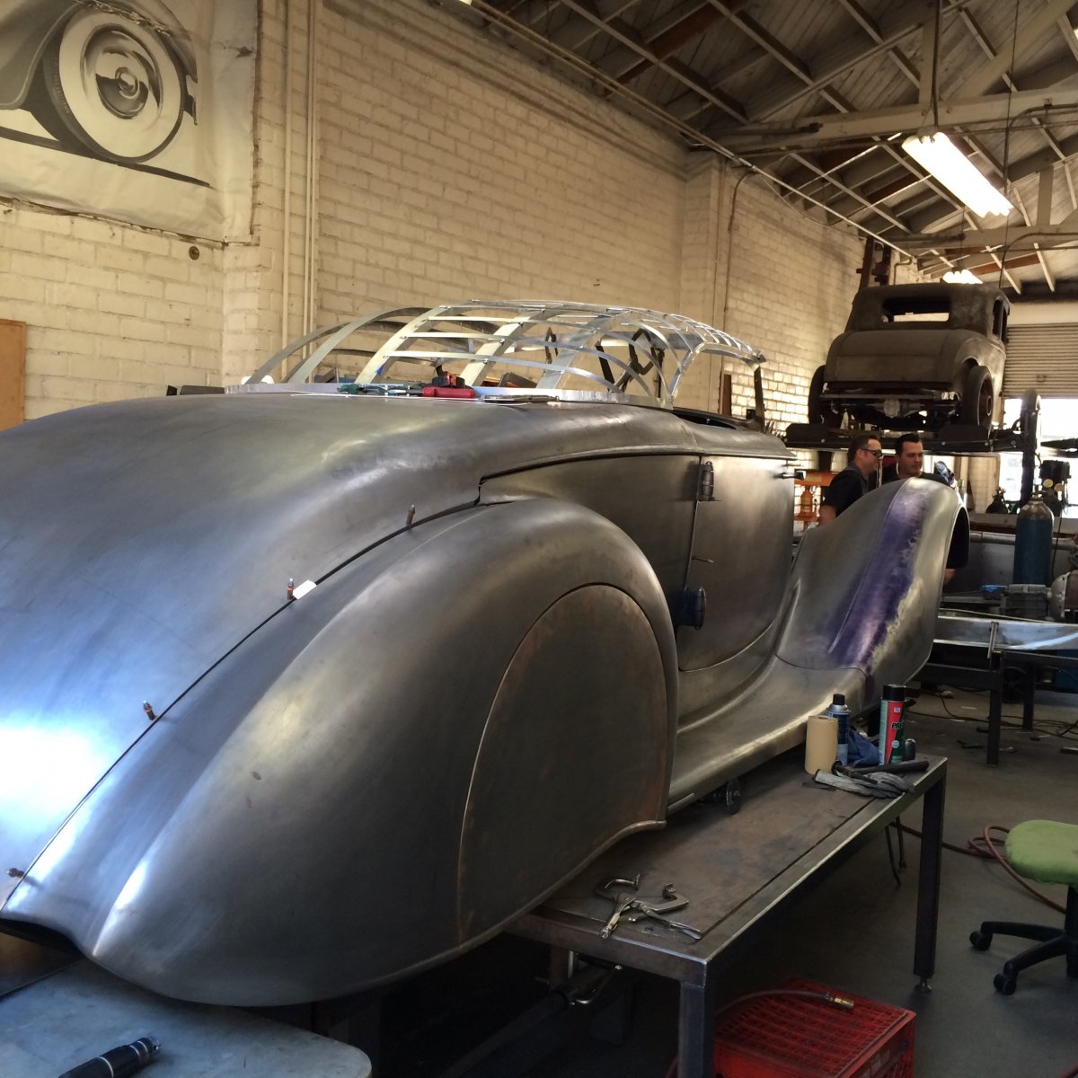

    Still working on roof shape.
    Checking to make sure our roof fits.
    Here is an early test of the mechanism to flip the roof.

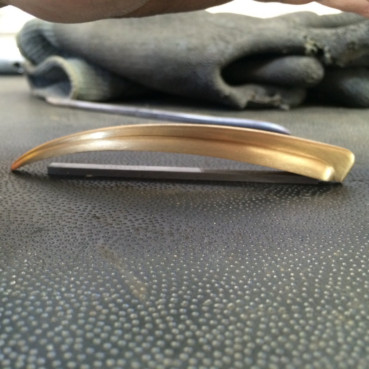

    This is an in process tail light trim, and a finished one.
    Finished trim.
    And here is the finished light.
