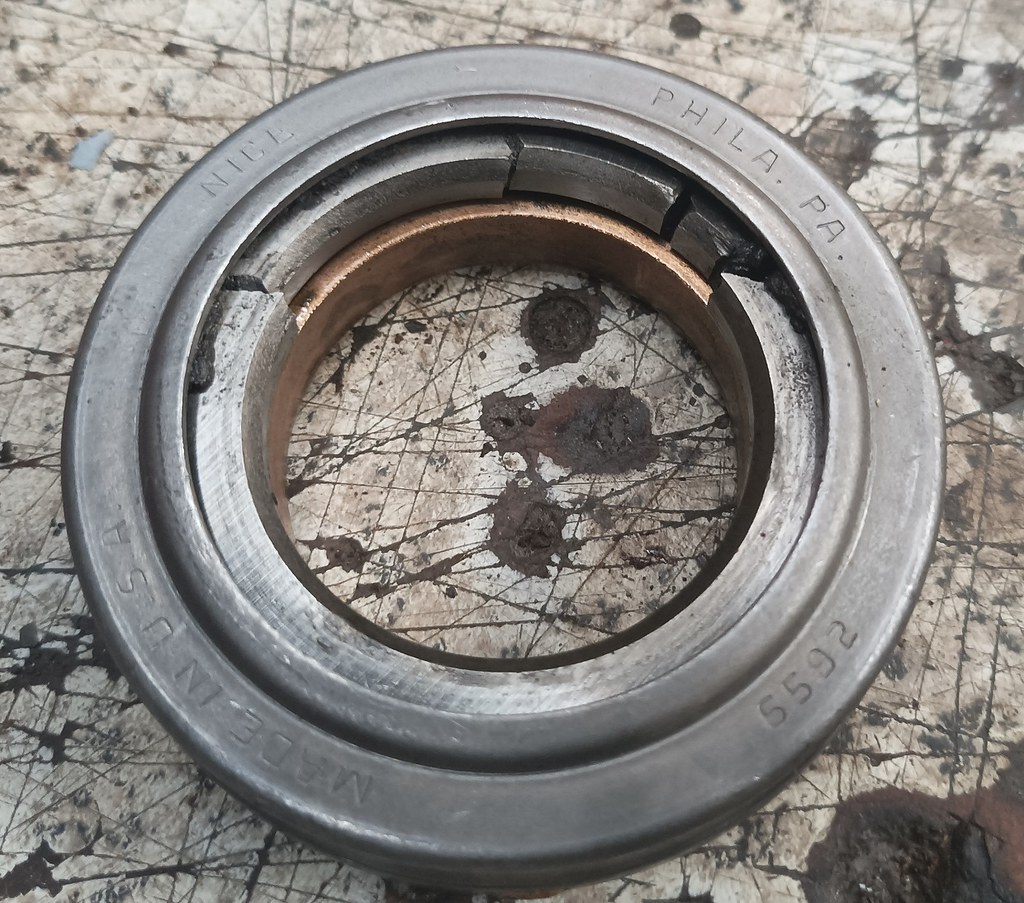

    For the moment, I need to locate and buy a new clutch throw out thrust bearing.
    It is a NICE, made in Philadelphia and reference 6592.
    Usual searches do not bring any results...
    The one on the engine is cracked in several places...

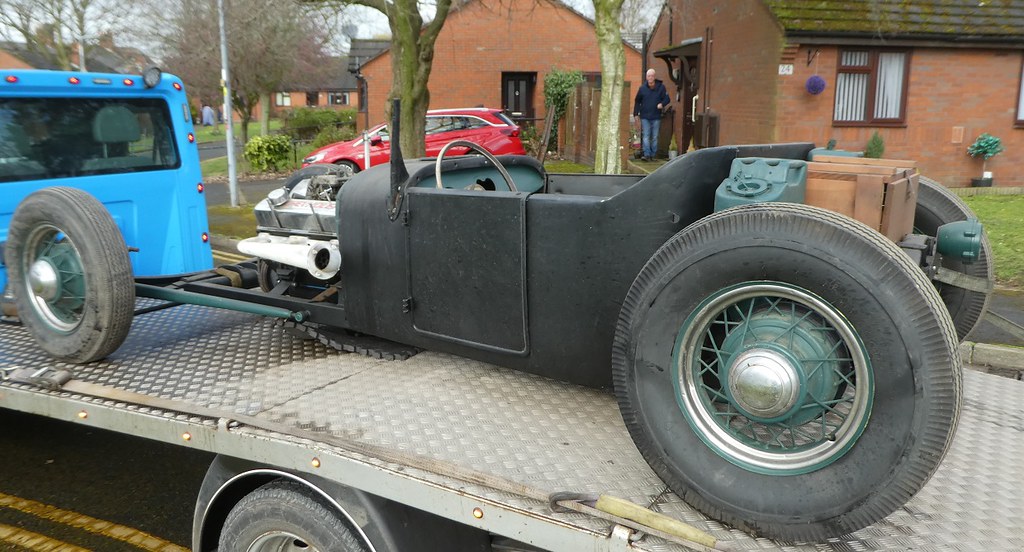

    Hi BJR,
    I have a small ch***is that no doubts will need some length added to it!!!
    Not sure I want to keep the overdrive bit, makes the transmission quite long!!!
    Patrick

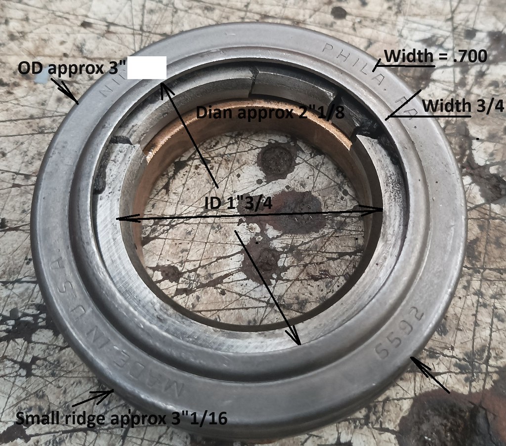

    Would be good if you could put up the dimensions of the bearing. Someone may have one that fits. I can't be the only person with a large tin of clutch thrust/throwout bearings on a shelf in the workshop.

    Dimms of thrust bearing:
    Patrick

    Lots in my Tin, but sadly nothing bigger than this.
