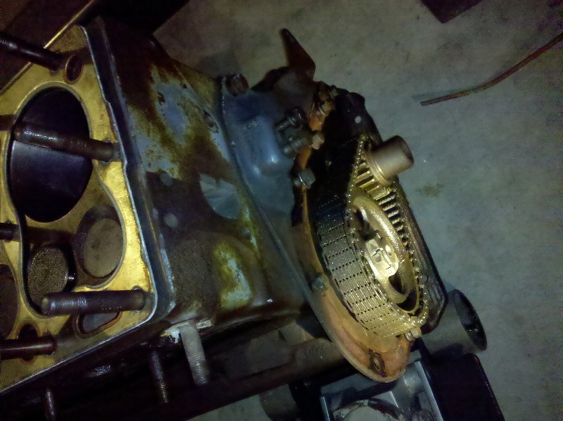

    :D! If you decide to let one of the 356 mills go, please let me know!
    Here's some pics of my new find, a pretty clean 282, and ******. Not perfect, but pretty nice!
    Anyone know if a 327 crank will fit in this block?
  30. theHIGHLANDER
    Joined: Jun 3, 2005
    Posts: 10,746
    theHIGHLANDER
    The 327 crank is supposed to fit the 288, don't know about the 282. You may want to think about a bigger bore. 288 is 3 1/2, 282 is 3 1/4 but a 3 7/8 stroke(!) where the 327 is a 3 3/4 stroke. As it stands the 282 would be smooth low RPM TQ.
