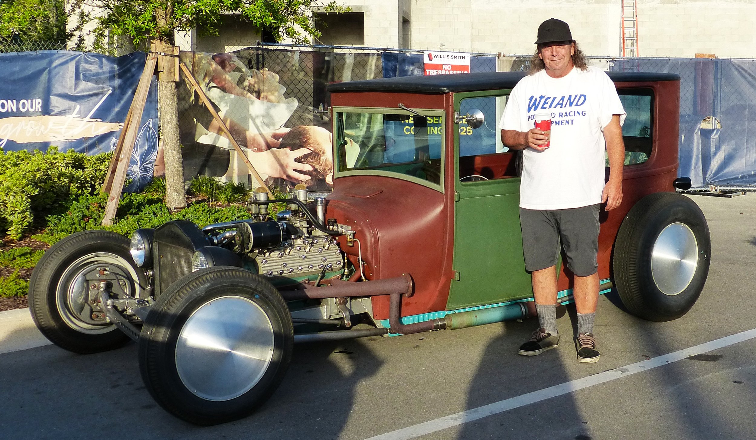

    he graduated in '57 so for me thats the build year , plus i have a great love for the traditional always have . packard trans makes sense to me , as i will be going nuts with the next short block , and overdrive is a plus ,i am a fabricator and can handle a simple rebuild and top plate adaption ,, , they held up to the overheads so i doubt ill break it ,, ROD2 (3).jpg
    heres my hero ,, ive made a few small changes since then but in the name of keeping it traditional , its that north east style ,heavy z'd , now all i gotta do is start getting together all the pieces ,, anybody got stashes under their benches ? really love thet hidelbrandt adapter , found a trend yearbook with some details in it about the packard too , didnt know i had it ..lol keep any info coming ,,

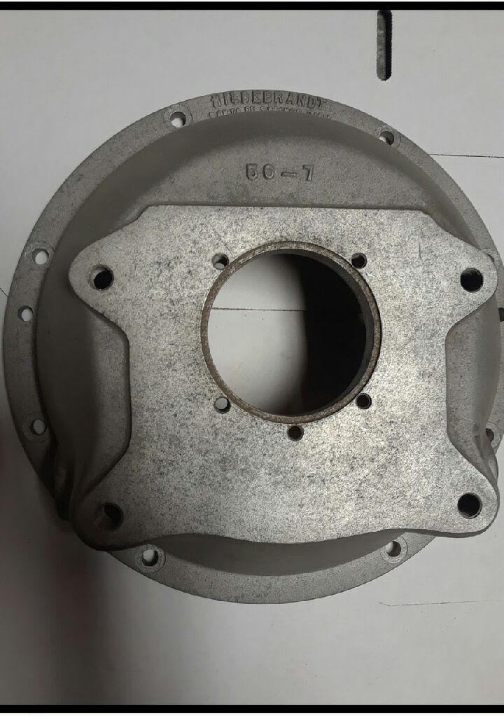

    You'll need one of these.

    Gofannon yes exactly that , thats a beautifull casting that should be put to use!!! (searching)
    first time i saw a pic of one i was like yes yes yes

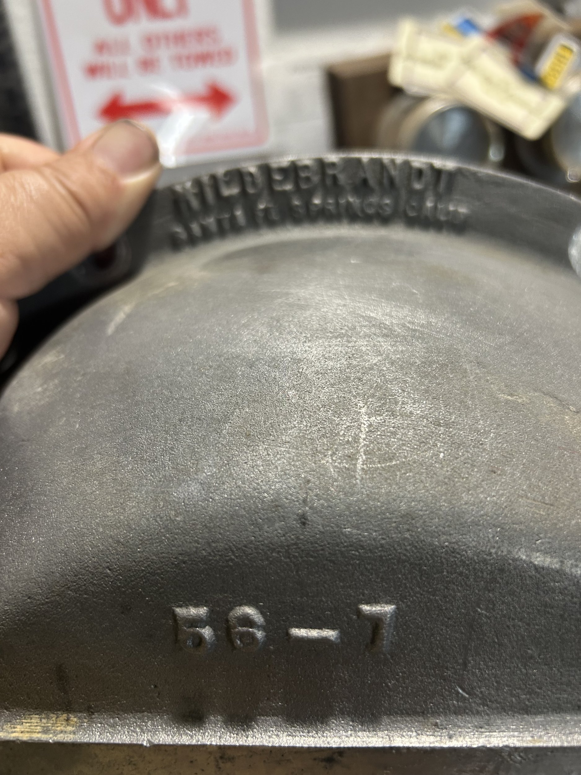

    OK so after long term research a lil blood sweat and tears , im still working on this ,, i have finally scored a top shifter ( 35-38 , 6 & small 8 ) needle in haystack stuff , need to modify one fork to go onto a later side shift box , i have one late trans already but its a non OD and a large input shaft from a big car but i got it thru swappy trady ,so it will go back out the same way ,, what i really need is either the hildabrandt 56-7 or the Offenhauser 3641 ideally ,, this will allow me to keep my pedal ***embly and keep things simple ,, any leads suggestions help or kind words will be appreciated ,,,john

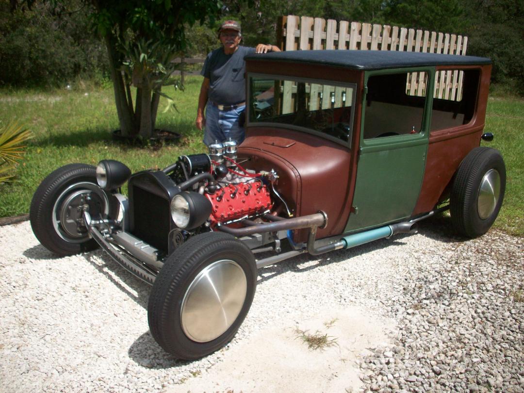

    yeah staying 100% period build , the car and i have been through alot ,oil pressure was steadily creeping down and i had collected heads cam{ 400jr) and intake but it turned into a full build took nearly 2 yrs IMG_6550.jpg as things escalated,, now .060 over, mild port n polish ,crank turned and balanced ,, (sombody had forgot to knock out the welsh plugs on the rod journals and clean the oil galleys for the rods rod bearings went to ****) , i tapped for pipe plugs before balancing ,, new french rods,arp nuts , clevite 77 bearings arp main bolts , had friend cut cam gear so i could deegree it , hollow lifters ,zephyr springs had to turn down sb ford retainers to get spring heights right ,under intake pcv , as much love as i could throw at it parts scrounged everywhere ,, navarro race model intake ,sharp 8.1 heads . mallory YB dual point etc ,,, runs like stink im real happy was a learning curve .allwork done by me and all parts scrounged im no "checkwriter" pop had built flatty many many in the 80s-90s but now im on my own . , anways keeping eyes on the prize ,,, need a adapter and a late OD trans and all this will happen ,,

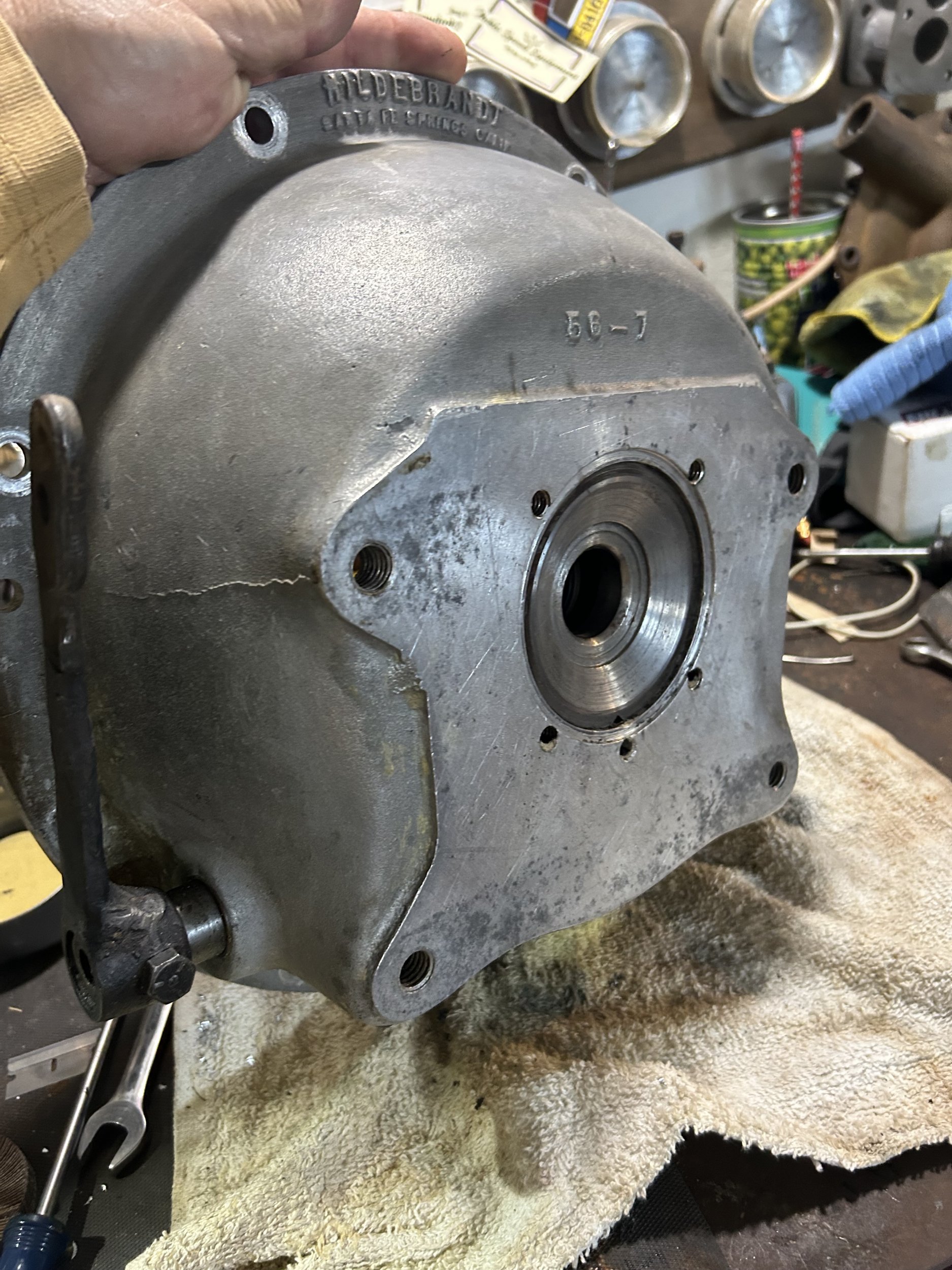

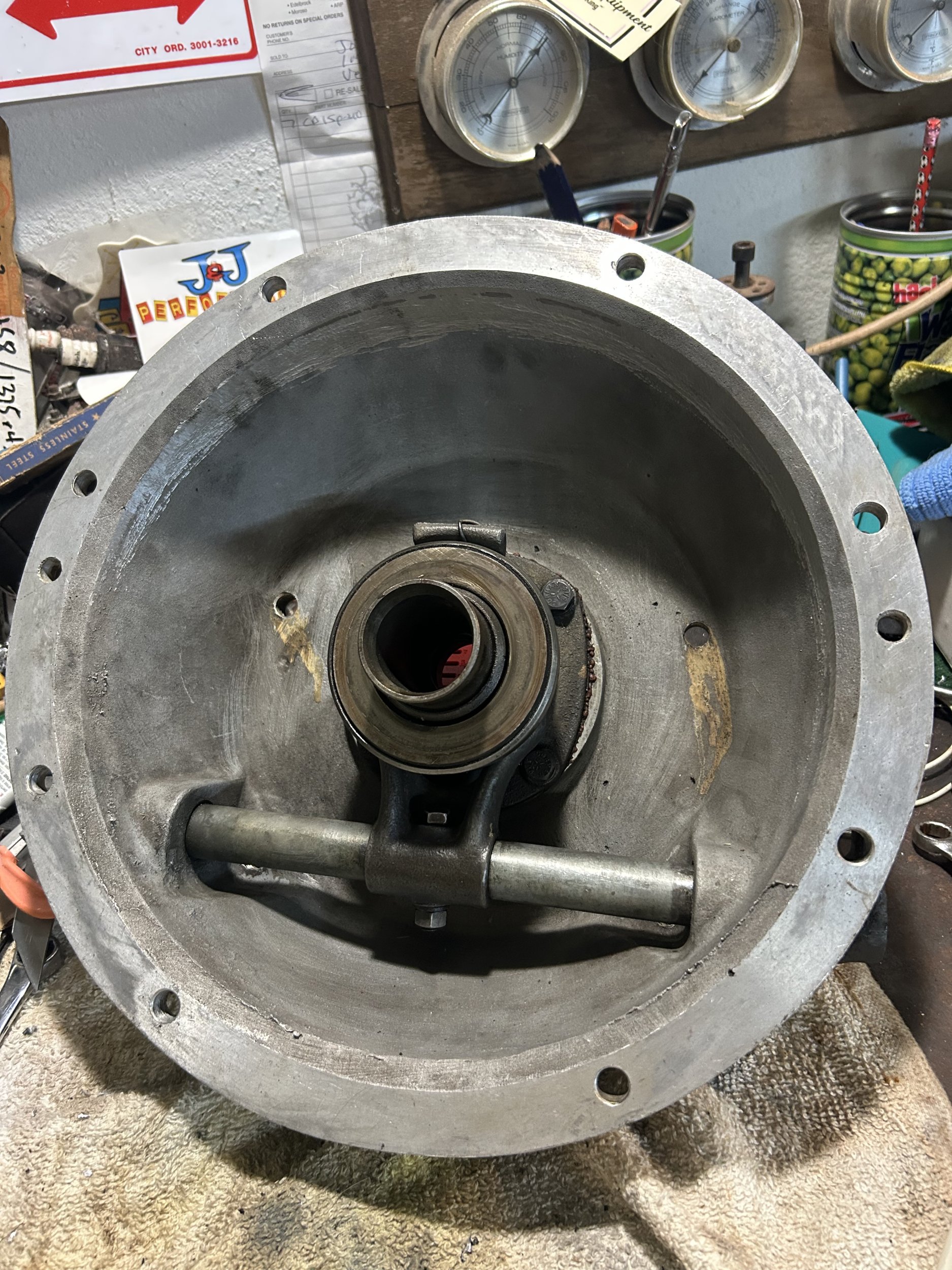

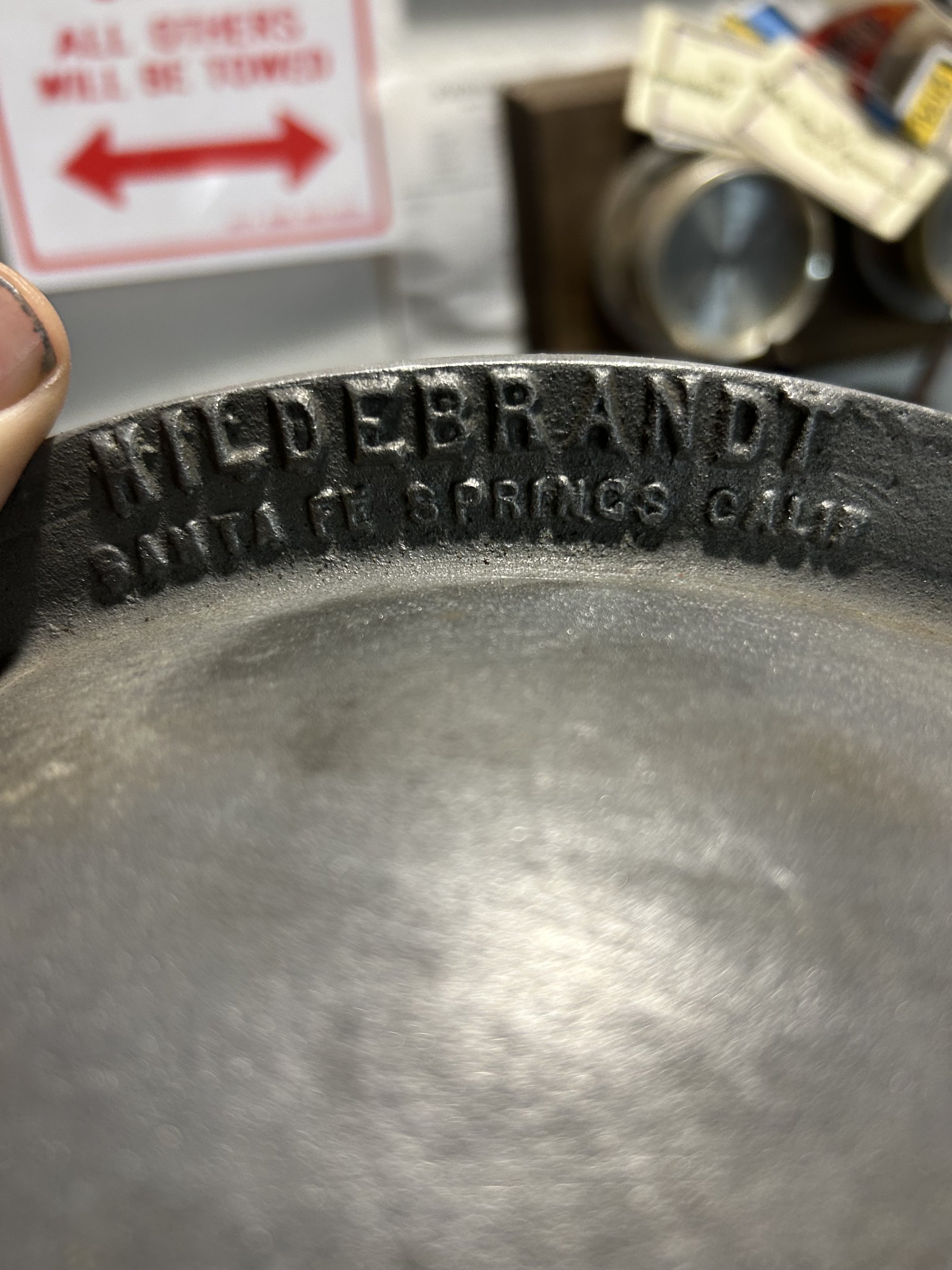

    Ok so update , here’s a win win , it hurt a lil but rare parts are rare parts , this is the hildabrandt flathead to Packard adapter was a tough find I got a message on instagram a fella had one we made a deal and waa laa ,, and then here’s a pic of the top shift mechanism , so now I’ll looking for a early post war trans , has the better R-10 overdrive ,, the hunt continues , plan on doing all the correct electrical for the OD so it will work as is shoud will keep updating as this moves along ,
