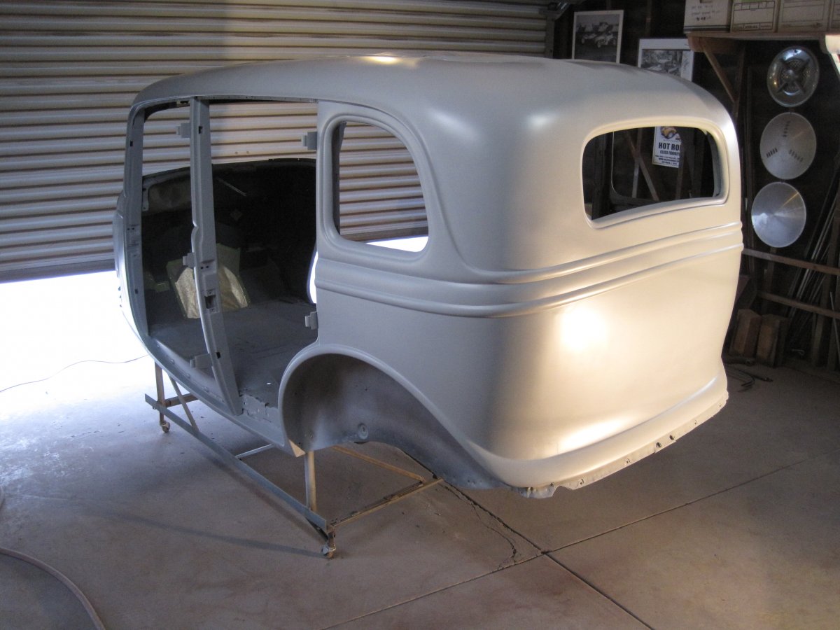

    Hope you had a Merry Christmas, and we are all hoping for a good new year. We had a great time with Bill and Sabina in SF, and Bill and I went over to his shop Xmas day to see the three projects he's thrashing on for the South City R&C display at GNRS this year. Come to the car show in Pomona end of this month and check it out--you will be impressed, guaranteed.
    Meanwhile, back in the Ganahl garage...
    Actually, this is in my office. This is the original w.s. frame that came in the car. Bob Barnes at Verne's Plating said it needed a couple small holes brazed, but it came out excellently. Those well-used mags behind it are my '48-'67 Hot Rods, with little R&Cs and Car Crafts above. The rest are in binders in the garage.
    Now, in the garage...

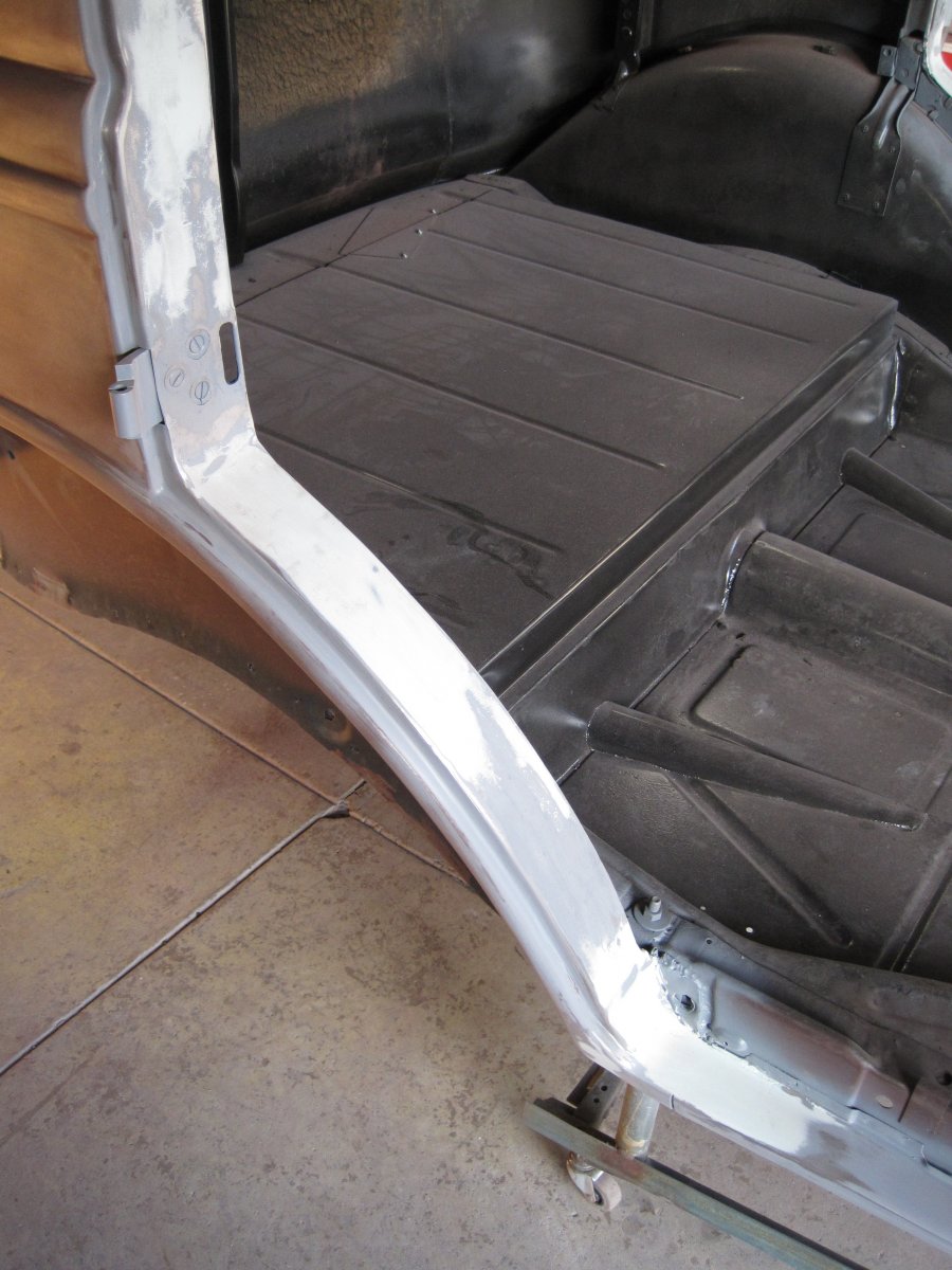

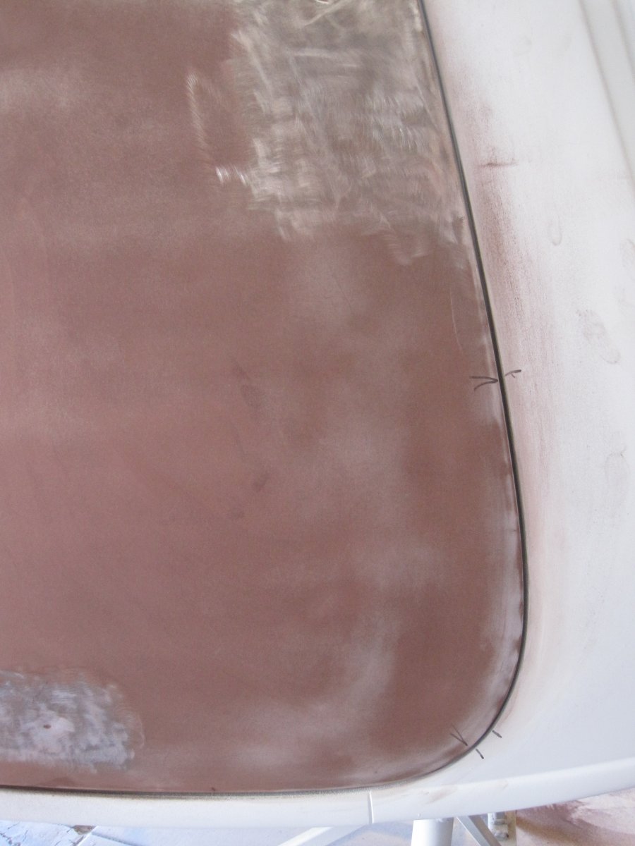

    After some hand-sanding with 80 and 120 grit, plus wiping with lacquer thinner, I was pretty close to bare metal quickly. No rust. Hardly any dents.
    This was about it, right rear beltline.
    Otherwise it was just a bit of Bondo over the leaded original body weld joints, which I first sprayed with DP-50 sealer, because I learned long ago that Bondo doesn't like to stick to lead (or brazing). Can't figure out what happened in both rear door jambs, but some old-school bodyman did some gas welding in the corner, and leaded the jambs, top to bottom. This was the most filler I had to use.

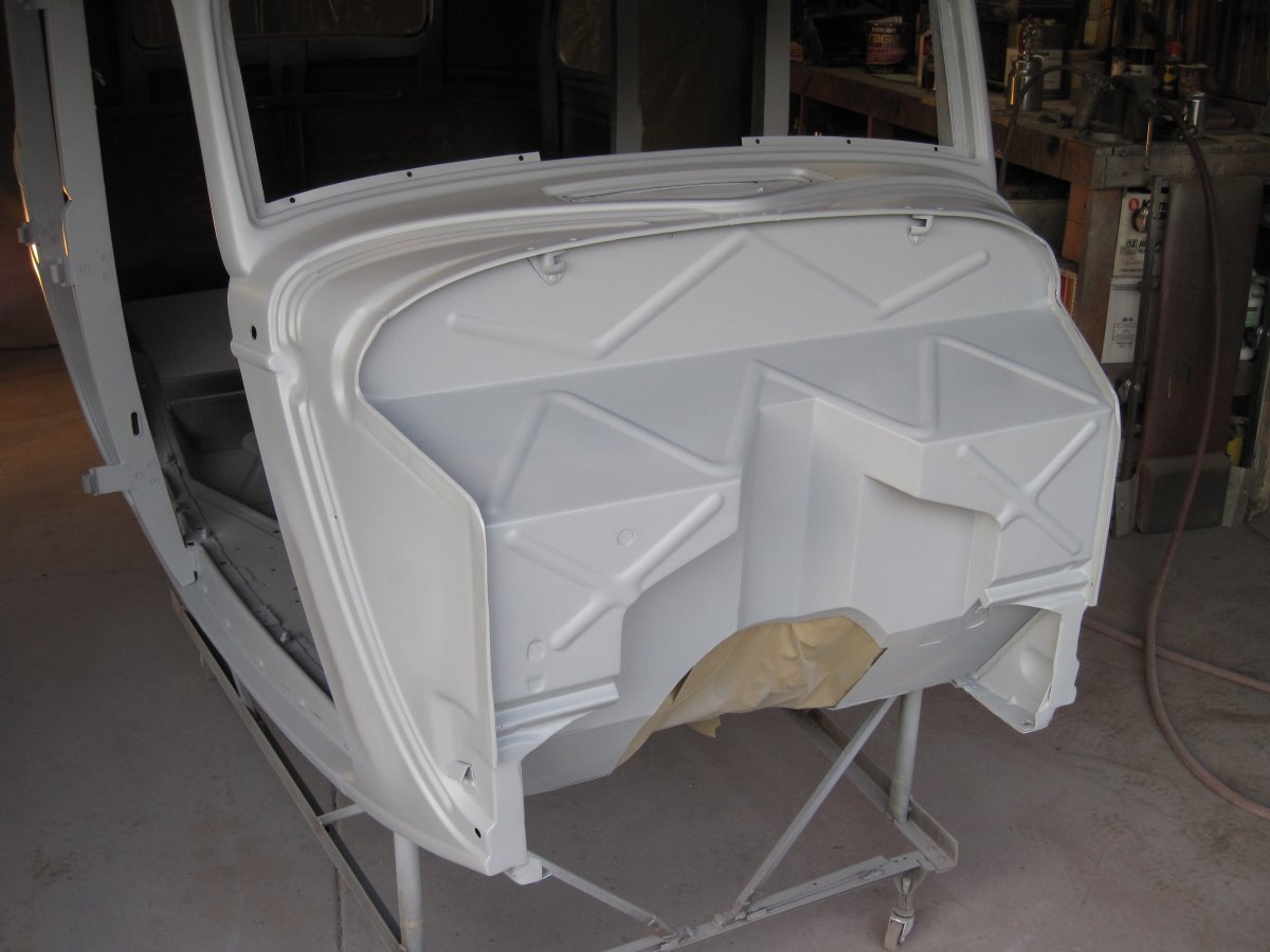

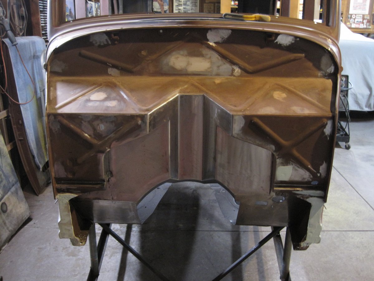

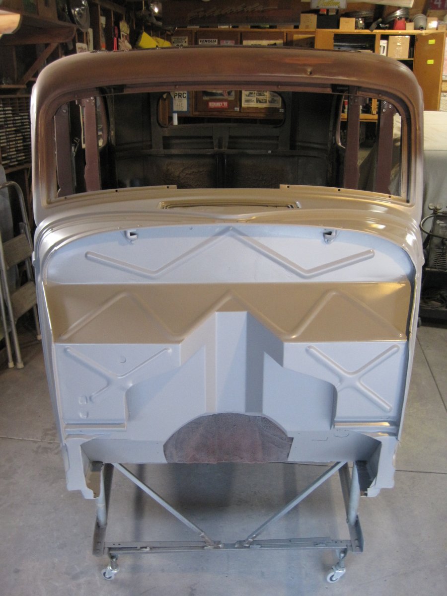

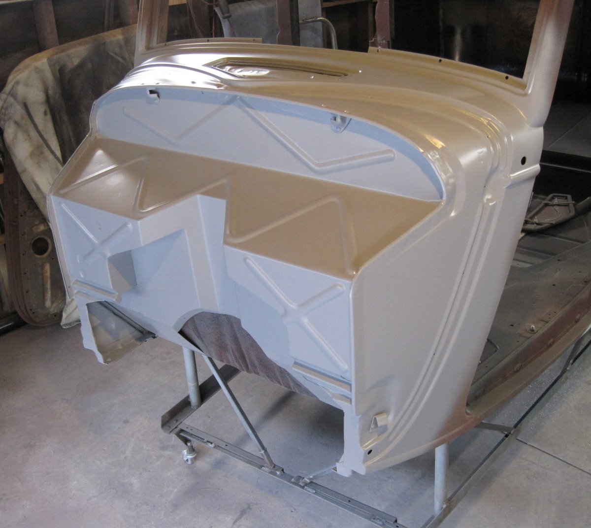

    I debated leaving all the factory spotweld dimples and divots around the firewall, but I couldn't restrain myself from filling and smoothing them, at least a little.
    This is the direct-to-bare-metal high-fill primer Junior recommended. And this is how it looks after one good, full coat on the body. I don't know about you, but I think this is one pretty good-looking body.
    Had to fill the four big holes for the spare tire mount in what I ***ume is the original rear apron. It wasn't perfect, but it had never been crunched.
    It doesn't matter how messy your workbench gets, keep your spray equipment clean and it will work right and last forever. I got this cheapie gun at my local Tool Shack because it has a 1.8 nozzle, necessary for spraying the high-fill, heavy primers. Works great. I also still use the DeVilbiss JGA that someone gave me, free and well-used, in the early '70s.
    This is as far as things got as of last night. Don't be fooled by photos, though. There's still plenty of block sanding and reprimering to make this nice body better, especially on the fenders. Note roll-down plastic "curtains" in the background to keep overspray out of the rest of the garage.

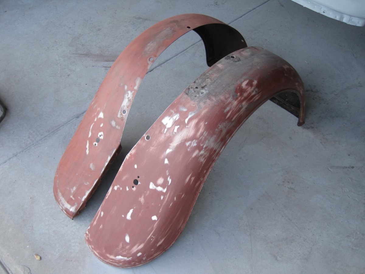

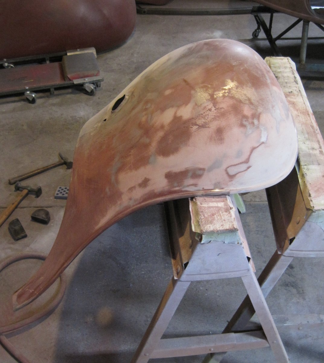

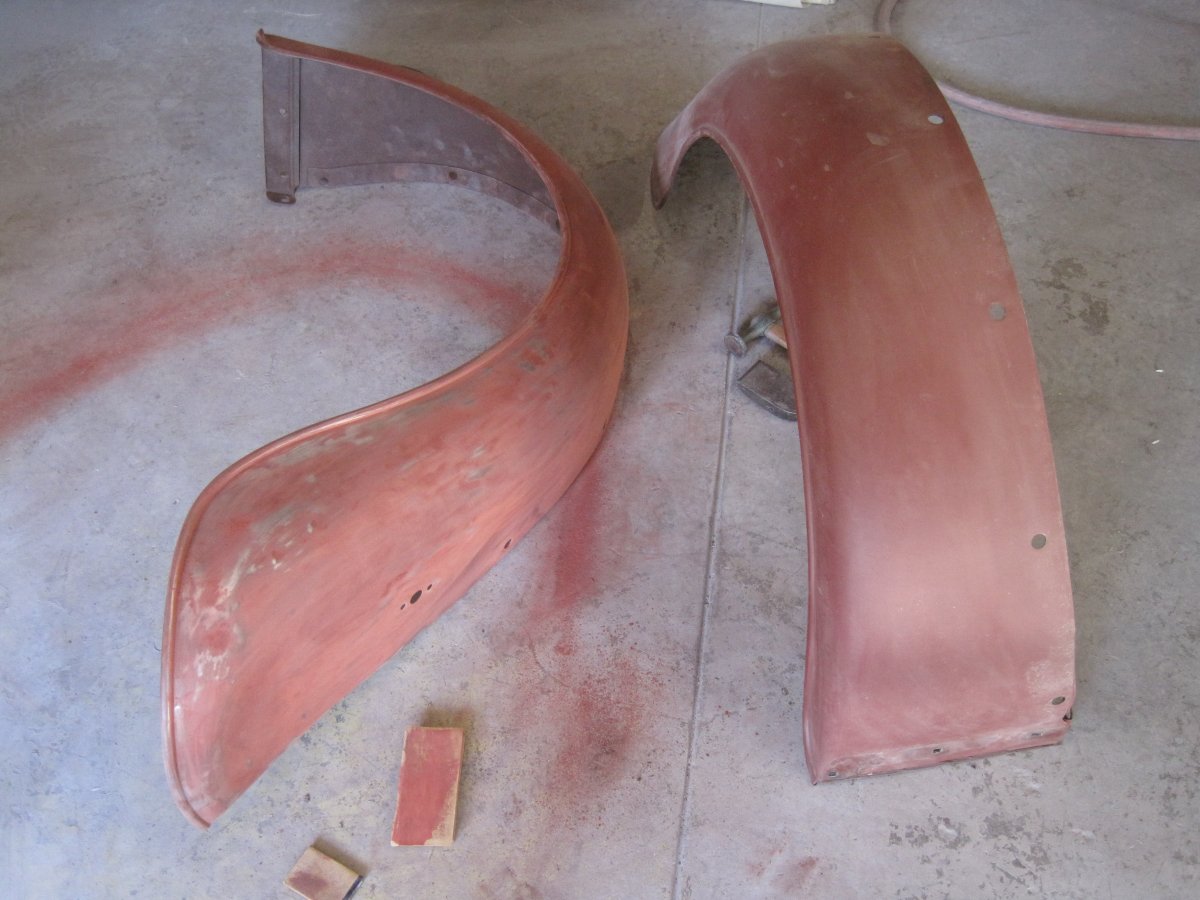

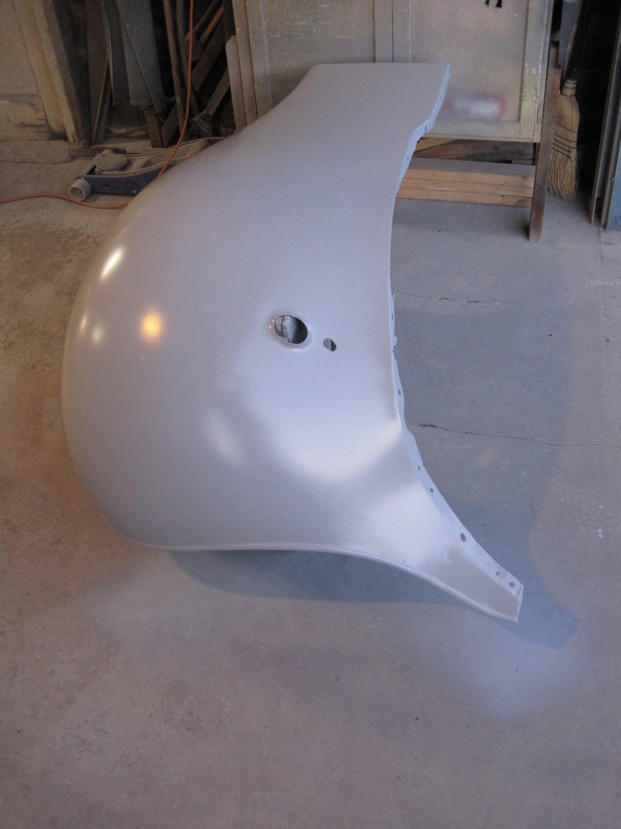

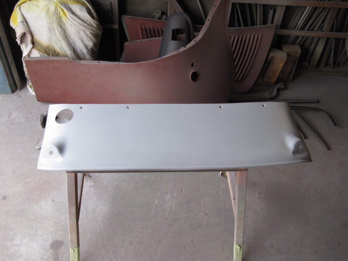

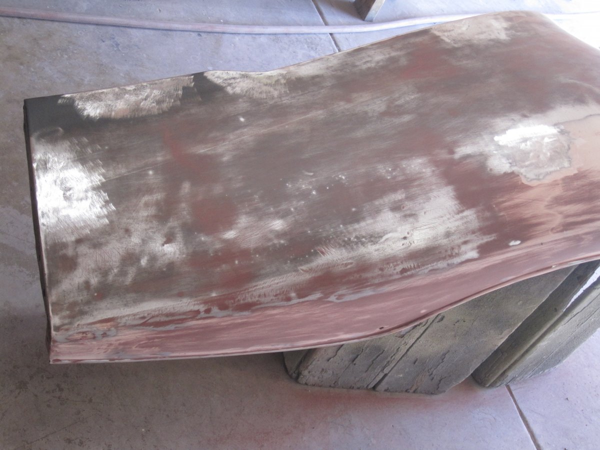

    When we last spoke, I had just gotten a second coat of high-fill, bare-metal primer on the body (after much block-sanding), and was just starting on the left front fender. After several boring days of 40 and 80-grit block sanding, lots of hammer-and-dollying, a little Bondoing, then a lot more of the same, the left fender has a coat of high-fill that makes it look better than it is. This week I started on the right.
    Turns out these 85-yr. old fenders were a lot more nervous than they looked, under the recent red primer. Who knows who-all banged and beat them back out over the years, but somebody with some talent smoked them over quickly, including a sizeable (about 4" x 8") handmade patch panel in each. They were almost metal-finished, but not. Each required a little more welding, grinding, hammering and dollying. And so was the case with each whole fender, as you can see part-way through the process on the right one. Here's a closer look before I added a bit more Bondo.
    The best part is there was only one crack in the bead, which I welded up; otherwise they're pretty good. So after a couple more days of blocking and gently hammering down high spots, this fender got its first primer coat.

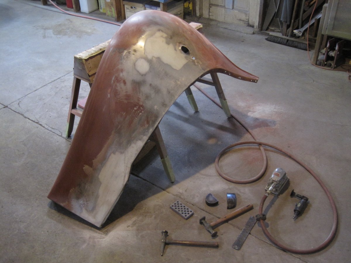

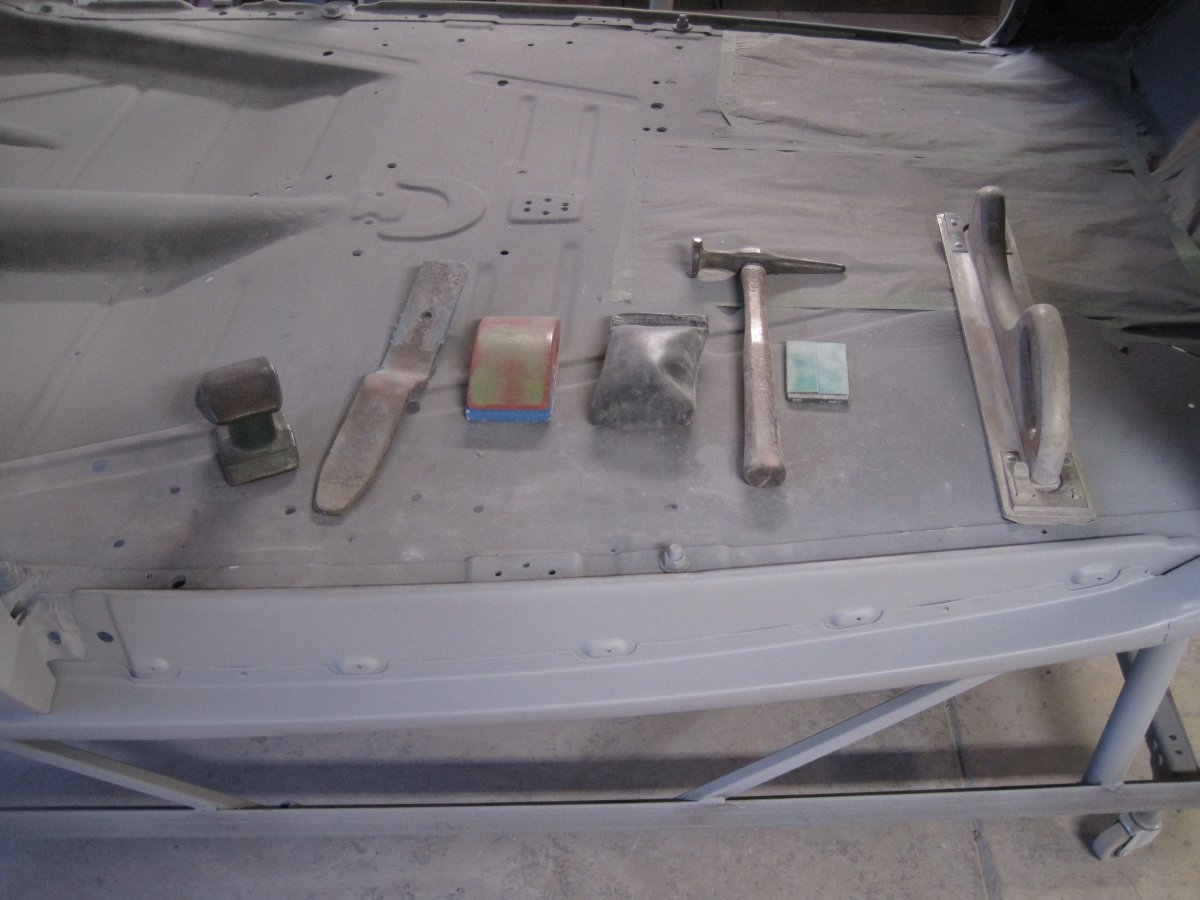

    This next photo was spontaneous. I noticed where I'd set some of my tools, and thought it made a neat picture:
    Did another round of blocking and primering on the body, too. But that's enough for this week. Think I'll get my neglected roadster out and give it some exercise since the weather here is nice, nothing's on fire at the moment, and no mud is sliding in our canyon.

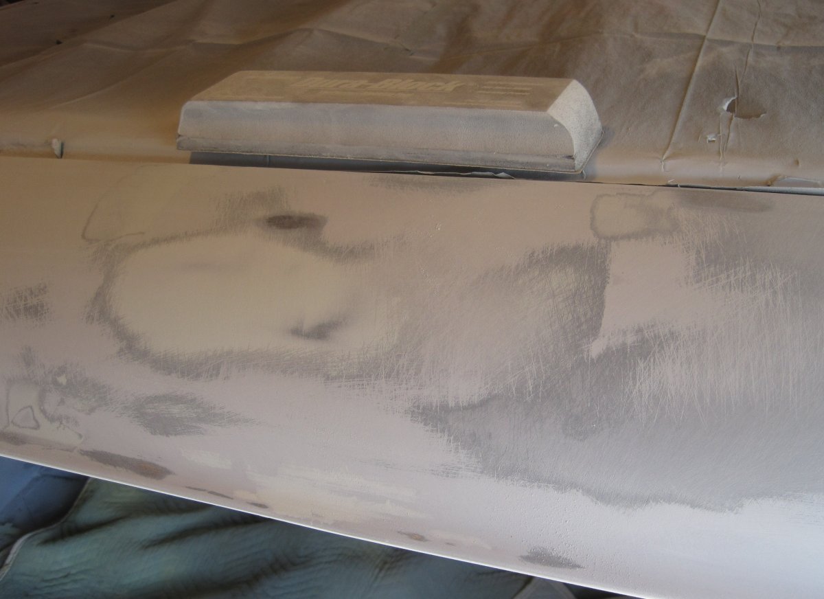

    Here's a quick report that will probably be more pictures than words. It's tedious, time-consuming, and boring. It's the stage that every mother who ever had a teenage son learning to do bodywork marvels at--you put it on, you sand it off; you put it on, you sand it off; you...get the idea.

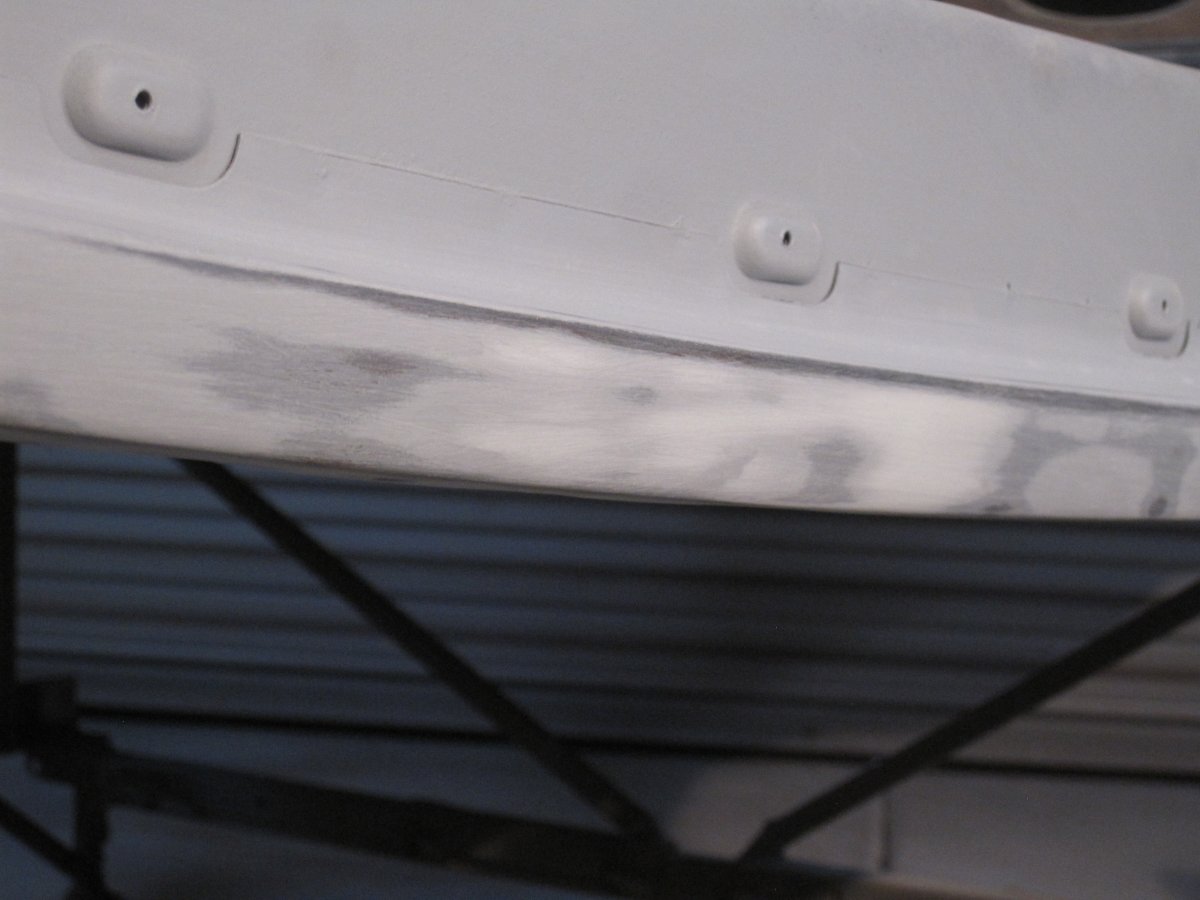

    no267.JPG It's called "blocking." At this point I've sprayed the whole gallon of Direct-to-Metal high-fill primer on the body and these three pieces, and block-sanded it with 80 and 120 grit at least four times. The darker spots are DP50, where I've covered bare metal that I've sanded down to (again), in preparation for some coats of regular high-fill primer.
    no273.JPG The blocking process also includes numerous applications (and subsequent removal) of catalyzed spot putty. You use a hammer and dolly to lower any high spots you uncover, then fill low spots. Here are a couple examples in a rocker panel, plus a door jamb (they got the most).

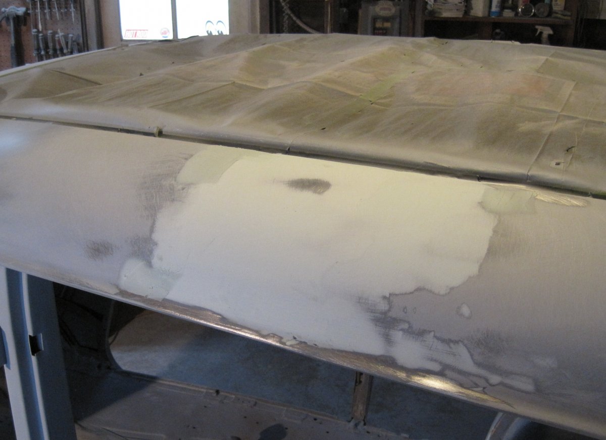

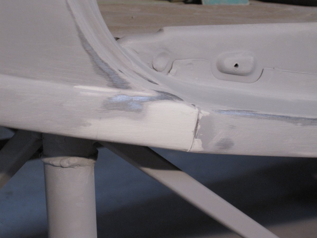

    no270.JPG As I mentioned previously, the only spots that needed much bodywork in the body itself were the factory weld-seams, which of course were leaded. This one in the middle of the roof was the worst. After trying to hammer down a large lump, I finally had to grind it clean and get out the "magic blade" to shrink it. This was the final coat of filler, before and after sanding with the block shown. You can still see one high spot.
    no275.JPG I started on the back fenders today. They looked, and even felt, pretty good until I started sanding with a flexible block and 120-grit.
    no276.JPG The discouraging part is, the more you sand, the worse it gets. At least at first.

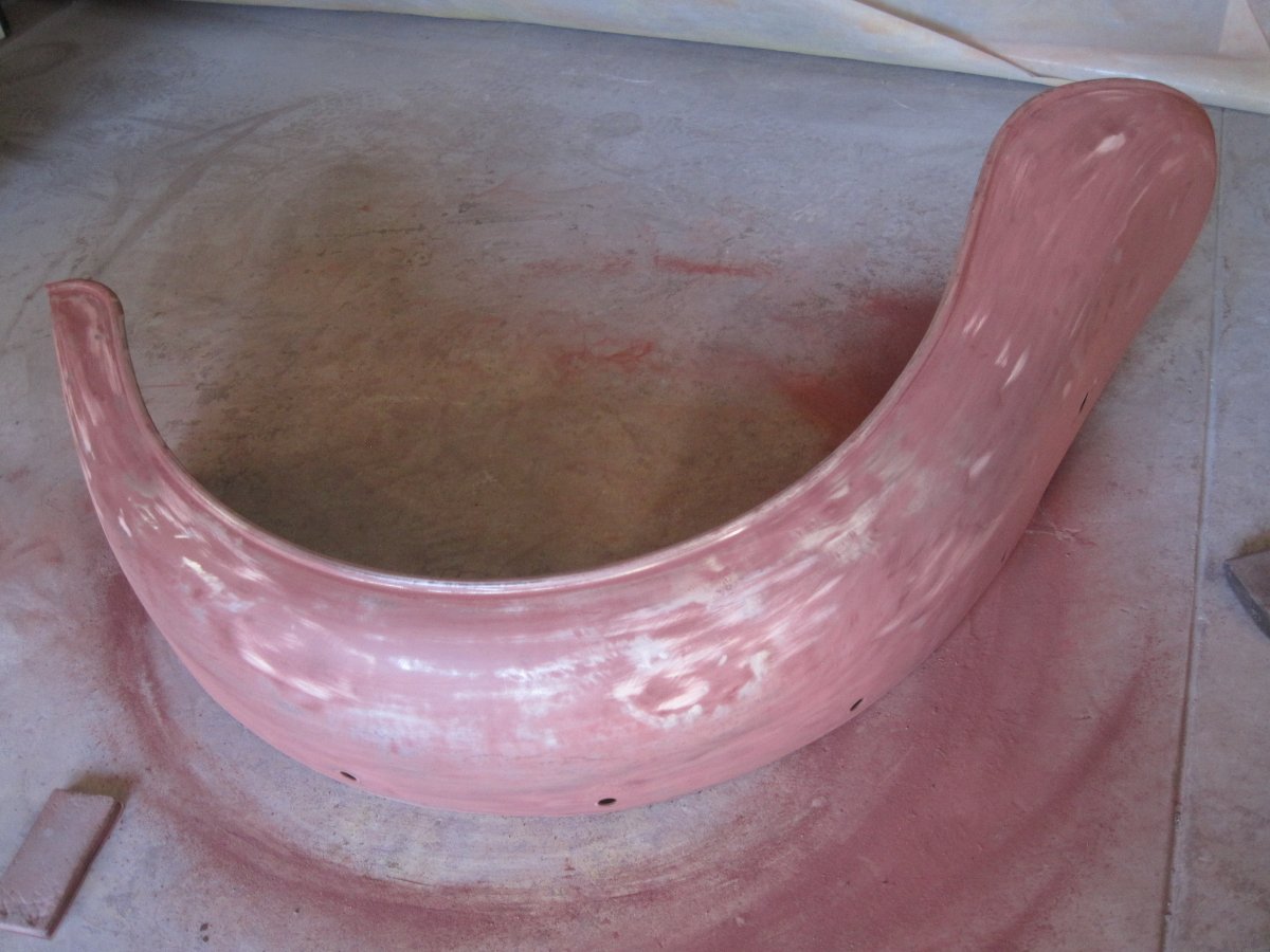

    no278.JPG Actually, these fenders are really in very good condition. I sprayed RustMort on some old surface rust, then picked down the very visible high spots. The best part is that the beads are straight and unbroken.
    no280.JPG So by 5:00 I got a first coat of DP50 sealer on the fenders and that spot on the roof. Next comes a coat of high-fill primer, blocking, spot putty, hammering high spots, more blocking...you get the idea. However, come Friday, I should have some more-exciting news. Good news. See ya.

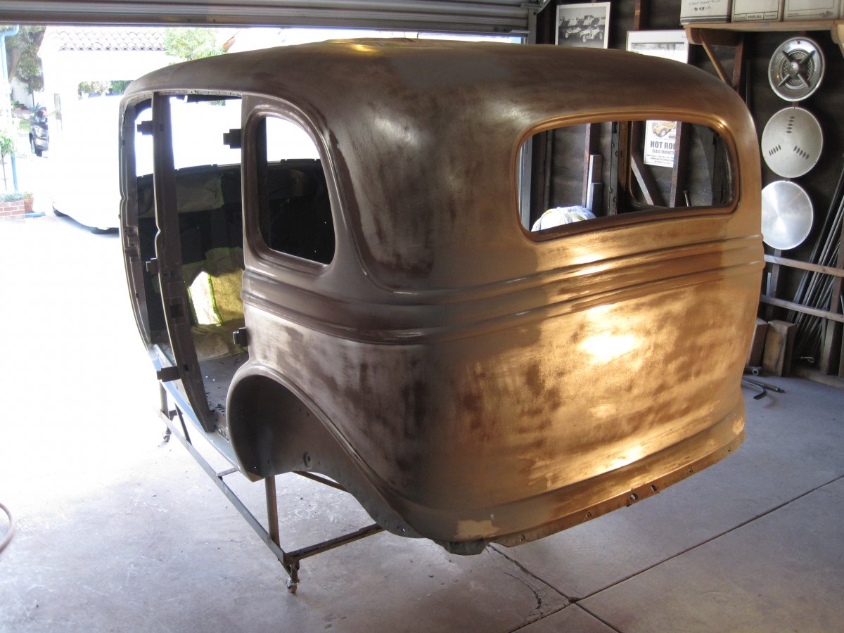

    Another two weeks of blocking and primering, blocking and primering, more blocking and primering. Oh oh, a little hammer-and-dollying. A little more Bondoing. More sanding. A leeetle more Bondoing A little more hammering. More sanding. More Bondoing. More primering. More blocking. I swear that's all I've been doing for the last couple weeks. Nothing else. Believe that?

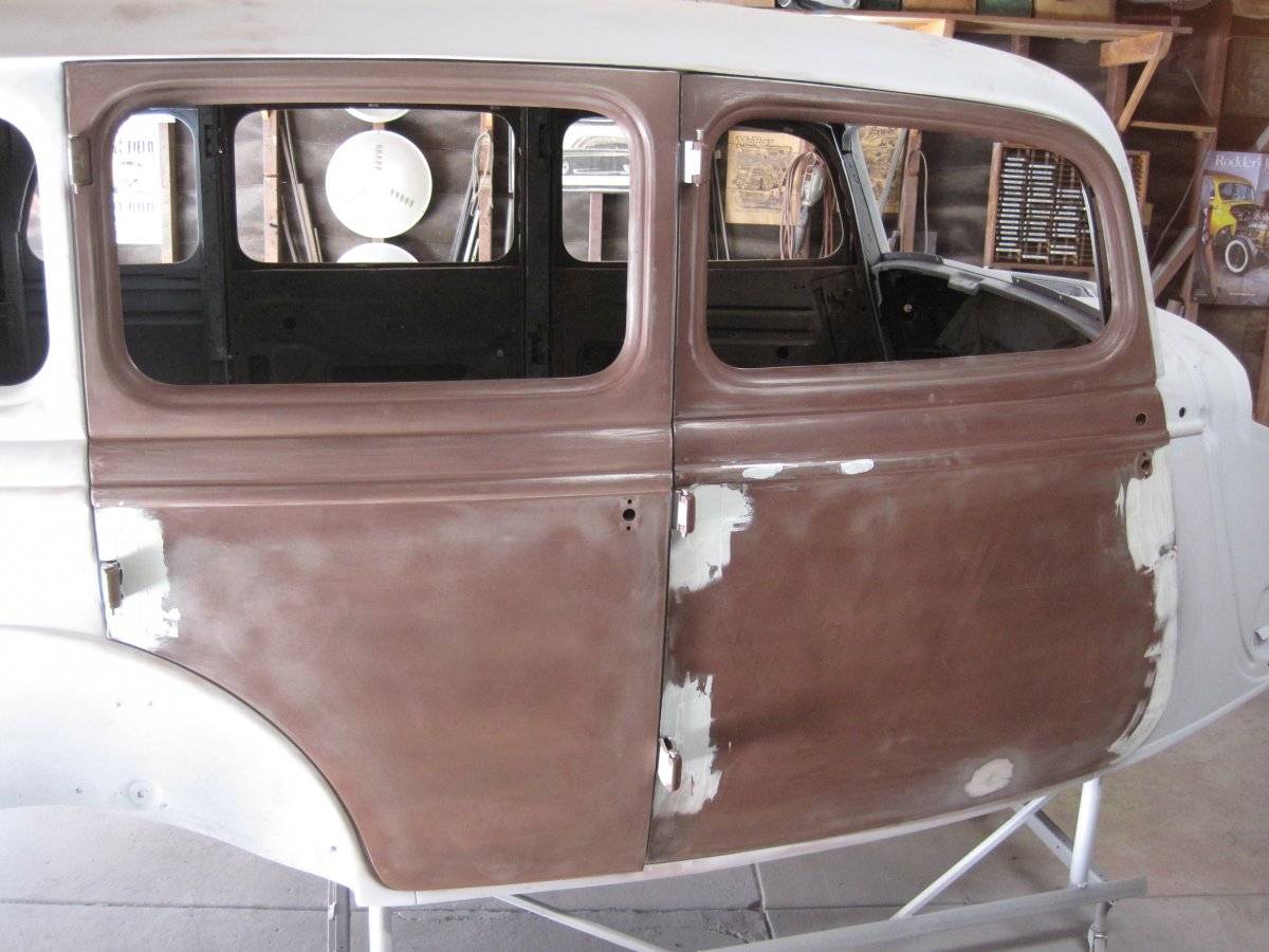

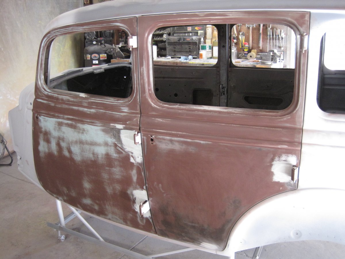

    Well, the body itself is getting close. But one thing I had to do was rehang the doors to make sure they still fit the openings. The hardest part of this job was getting the gl***, mechanism, and runners out of the doors. Took an entire day. Like working a Rubick's cube. But here are the empty doors in place. They look pretty good.
    Until you start block sanding, and you see things like this:
    There were also places that needed a little grinding/filing of door edges as well as grinding or filling of body channels to adjust gaps. Not much, but some. In the process I discovered one big surprise:
    You might not be able to tell from this photo, but when I removed a striker from a door, I looked twice at the color underneath. Yes, it's Army khaki green! Remember I told you the car had a Kirtland AFB (New Mexico) decal in the windshield, and figured it had spent it's life on a dusty desert airbase? Well I know Kirtland wasn't established until '42 (and there was no Air Force yet), but this 1933 Ford sedan was painted Army-issue khaki at the Ford plant (there's nothing but bare metal underneath), so it spent the majority of its life on bases, not public highways.
    This is somewhere early in the Bondo/blocking process, which was mainly around hinges. Suicide doors, you know. Donny at Bill's shop spent quite a bit of time bending, grinding, and otherwise fitting the hinges/doors, so mainly I had to get the skins straight. This doesn't look like much (and it isn't compared to the fenders), but....
    This is why they call this a work bench. (Photo op; couldn't resist)
    no298.JPG And this is just the first coat of bare-metal primer on the doors. More primering and blocking to come.
    But remember last time I said there'd be some good news this time?

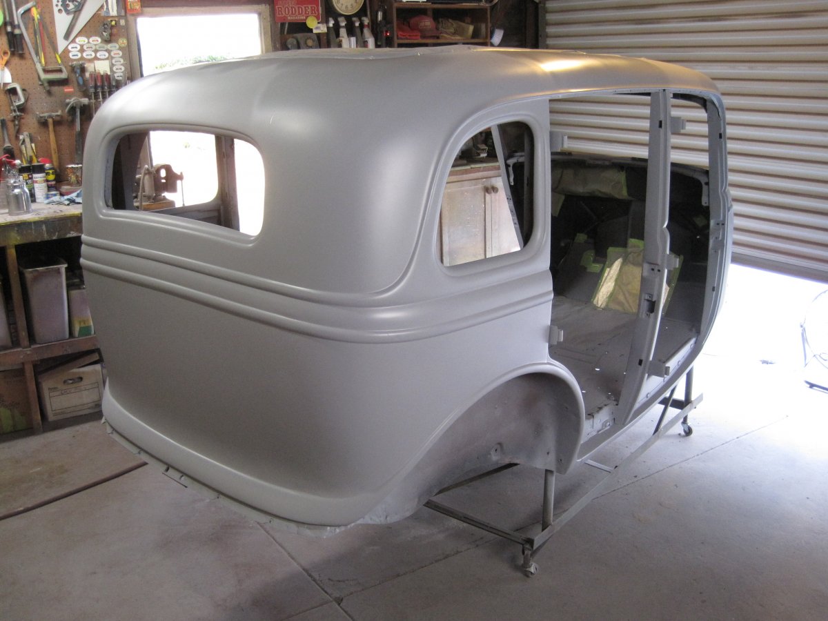

    This ain't perfect, but it's pretty damn good compared to how it started. The biggest problem is that this grille had been bent, welded, ground, and chromed a few times before. Bob Barnes at Verne's Plating didn't even want to do it. But I said, "Let's copper it and see what happens." Well, he has some "special guy" for jobs like this, who did a lot of silver soldering, hand filing, etc. Then he coppered and buffed it--FIVE TIMES--before Bob did the final polish and laid on this chrome. As I told Bob, I didn't want Pebble Beach...Redondo Beach was just fine. But this came out way better than either of us expected. Thanks Bob.

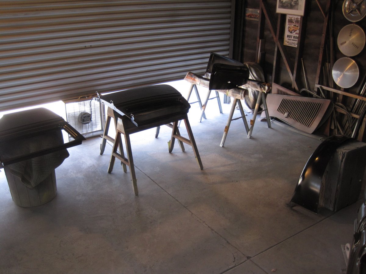

    For those of you cooped up in snowdrifts out there with nothing better to do, here's a very quick update on the '33 quatro-porte:
    This is what I did yesterday. No, it's not lacquer, it's DP90 (now DPLV), which is a sealer and adhesion promoter, which I am hoping will accept lacquer layers over it without wrinkling. I'll find out in a few minutes, because that's what I'm going to try today. Let ya know how it goes.

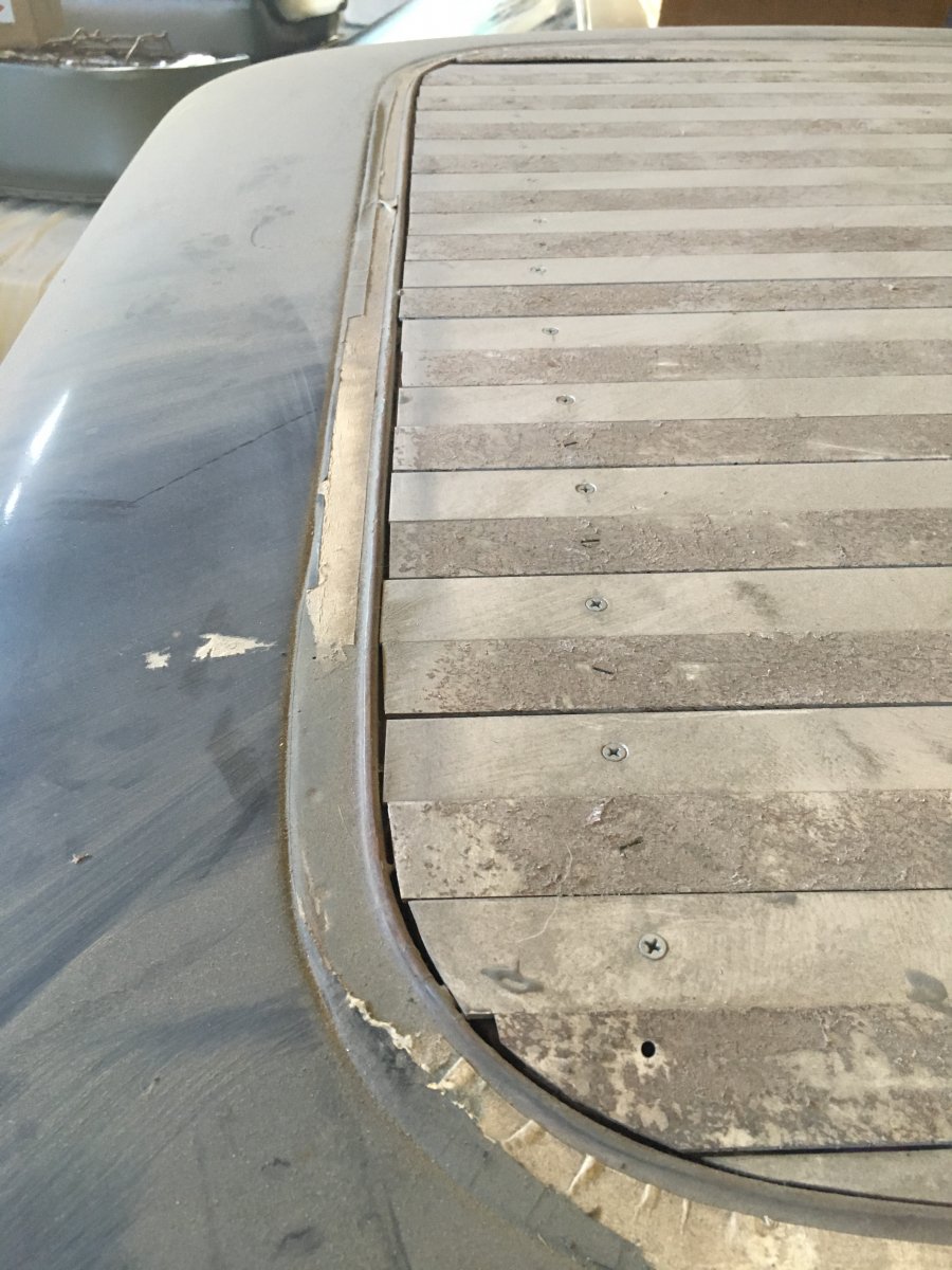

    I don't know what your plans are for your top insert but I like the original look of fabric.
    Here is what I did on my '33 back in the 70s.
    I sheared .100" aluminum strips and screwed them to the top bows.
    We glued 1/4" firm foam down and then the vinyl.
    It was solid as a rock.
    Been sitting for over 25 years since the blanket got split but is next to be completed behind the RPU.

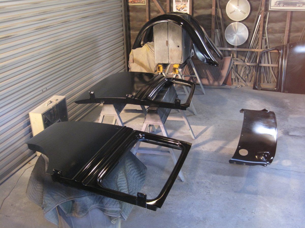

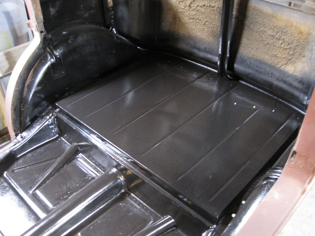

    Yes, This is actually a first coat of black lacquer--just a first coat--and just on the body, two right-side doors, and rear splash apron. This will be the first of several, with wet block-sanding in between. But it's a big step.
    And One Step Back: no305.JPG
    So this is what I did most of last week: More sanding, filling, sealing, priming, blocking, banging, filling, sanding, priming...you get the idea. These are the left-side doors and rear fenders, getting close. From 80 down to 320 grit.
    And this is what I did on St. Patrick's day (my feast day, you know). No, this isn't lacquer, it's more DP90. But that means lacquer comes next. Hopefully tomorrow. Speaking of feasts, Anna cooked an excellent traditional corned beef and cabbage dinner and I drank lots of green-canned O'Douls. Today, to take a break from all this retirement work, I'm going hiking.
    Man, I wish I had a nice, clean, well-lit spray booth. But why change now? At least I'm not working on dirt in the backyard, or out in the driveway, anymore.

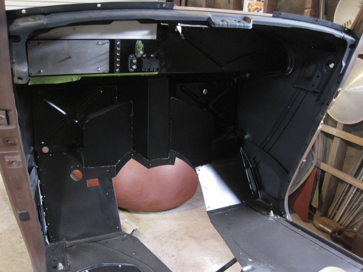

    Ooooh, we're making a little progress. This is a first coat of black lacquer on the other two doors and rear fenders. (And a slight redo on the rear apron. Don't forget the Ganahl garage motto: A Job Isn't Worth Doing Unless It's Worth Doing Twice.) no309.JPG
    This means we've got lacquer on the whole body other than the front fenders and hood. But after letting this dry and shrink a bit, next comes wet-sanding with 360-grit, and more lacquer coats until it looks straight and smooth enough to color-sand and rub out. Some patience required.
