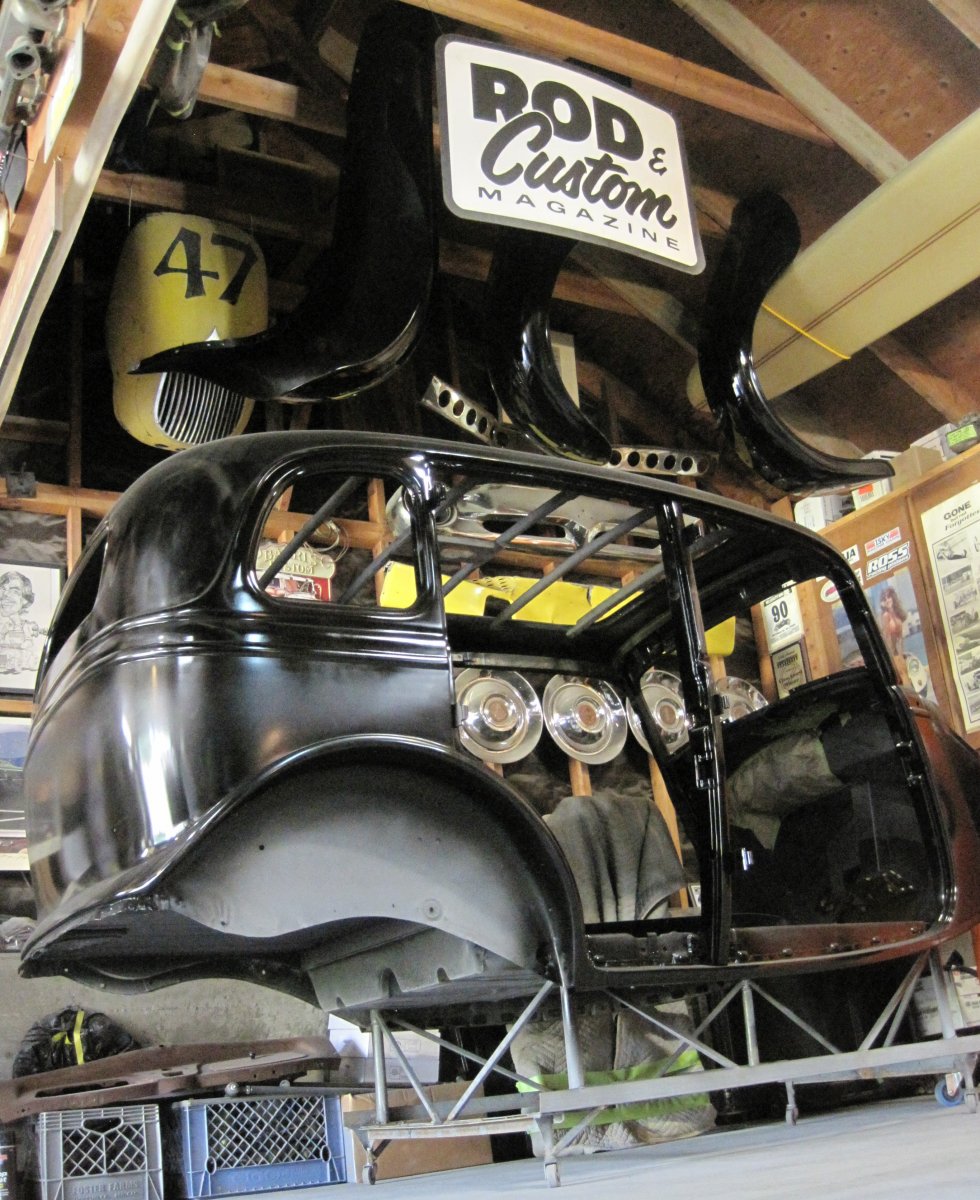

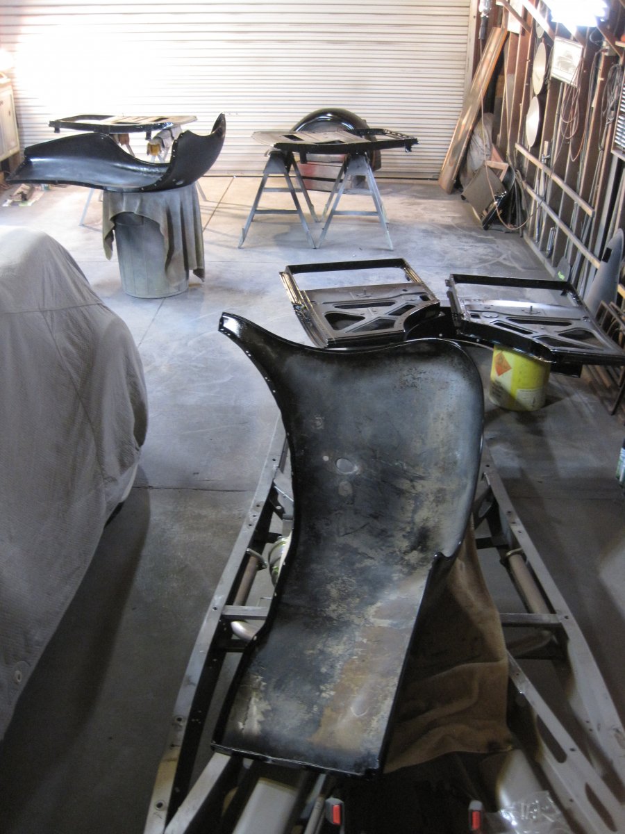

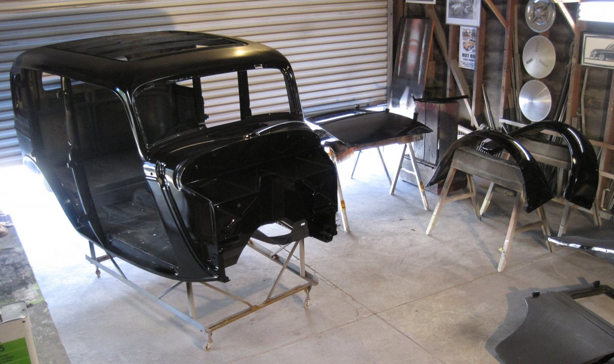

    Progress. Since Wednesday I got a couple of coats of paint on the outside of all the fenders, doors, splash apron, and the inside areas of the body. Then, after wet-sanding with 360, sprayed a couple good coats on the outside of the body, as seen. This might be good enough to color-sand and rub out, we'll see as we go. Yesterday I turned the fenders and doors over and shot the beads, jambs, and some of the insides (fenders will be undercoated). no318.JPG
    Half the fenders and doors, insides. no323.JPG Other half of fenders and doors. no324.JPG
    One big problem of garage painting is finding clean space to paint stuff, and other places to store stuff. No, I didn't paint the fender on the ch***is, it's stored there for the moment. One great thing about painting lacquer is no endemic overspray on everything else in the garage.
    If the body rubs out OK, I get to start on the ch***is, and then put the body back on it. Think this is getting tedious or boring? Imagine how I feel. But also understand what's involved when a good painter gives you a quote for painting your rod or custom.
    Cheers, Pat

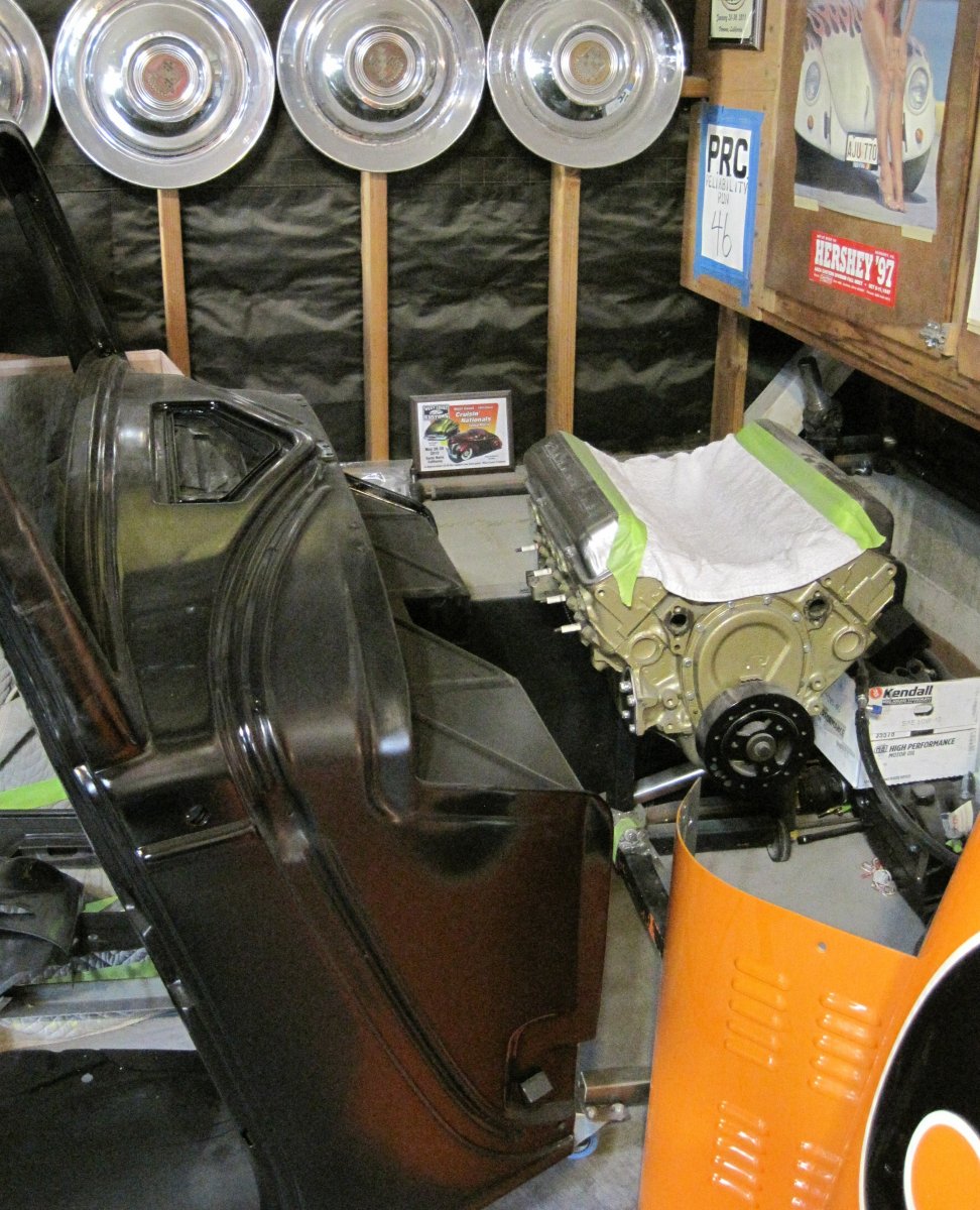

    Still plenty of diversions going on here in SoCal, but some things are moving--literally--in the Ganahl garage. The news is that painting is done for the moment, and as you can see the ch***is and body have switched places, because it's time to get the frame fully dis***embled, painted (spray cans'll do, thankyou), re***embled, and mated to a rubbed-out body. I also removed the center section from the 9-inch rear (which came out of my F-100) and took it to Hooper's Rearends for checking because it felt a bit sloppy. Very mysteriously (???) my 3.50 diff turned out to be a 3.23, so we all agreed a 3.70 gear would be better with the 700R4 o.d. trans. So Hooper's rebuilt it with a new set of 3.70s. no326.JPG
    It's hard to get photos in a crowded garage, let alone find places to store things. So fenders are now hanging from the rafters like slabs of beef to cure before rub-out. no328.JPG
    The engine has been waiting patiently in the corner, along with the trans, both built and ready to install. Over in another corner the dragster is all apart again, trying to figure out why it didn't run as well as it should've last weekend at Eagle Field. Hopefully Bob McKray and I will figure that out next week, after Anna and I get back from what we fully expect to be a fun weekend with the West Coast Kustoms in Santa Maria. Boy, I'm glad I'm not working.

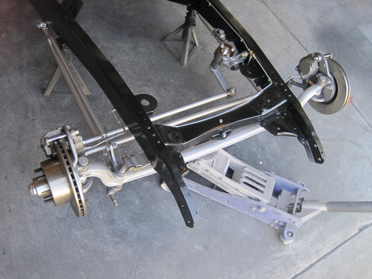

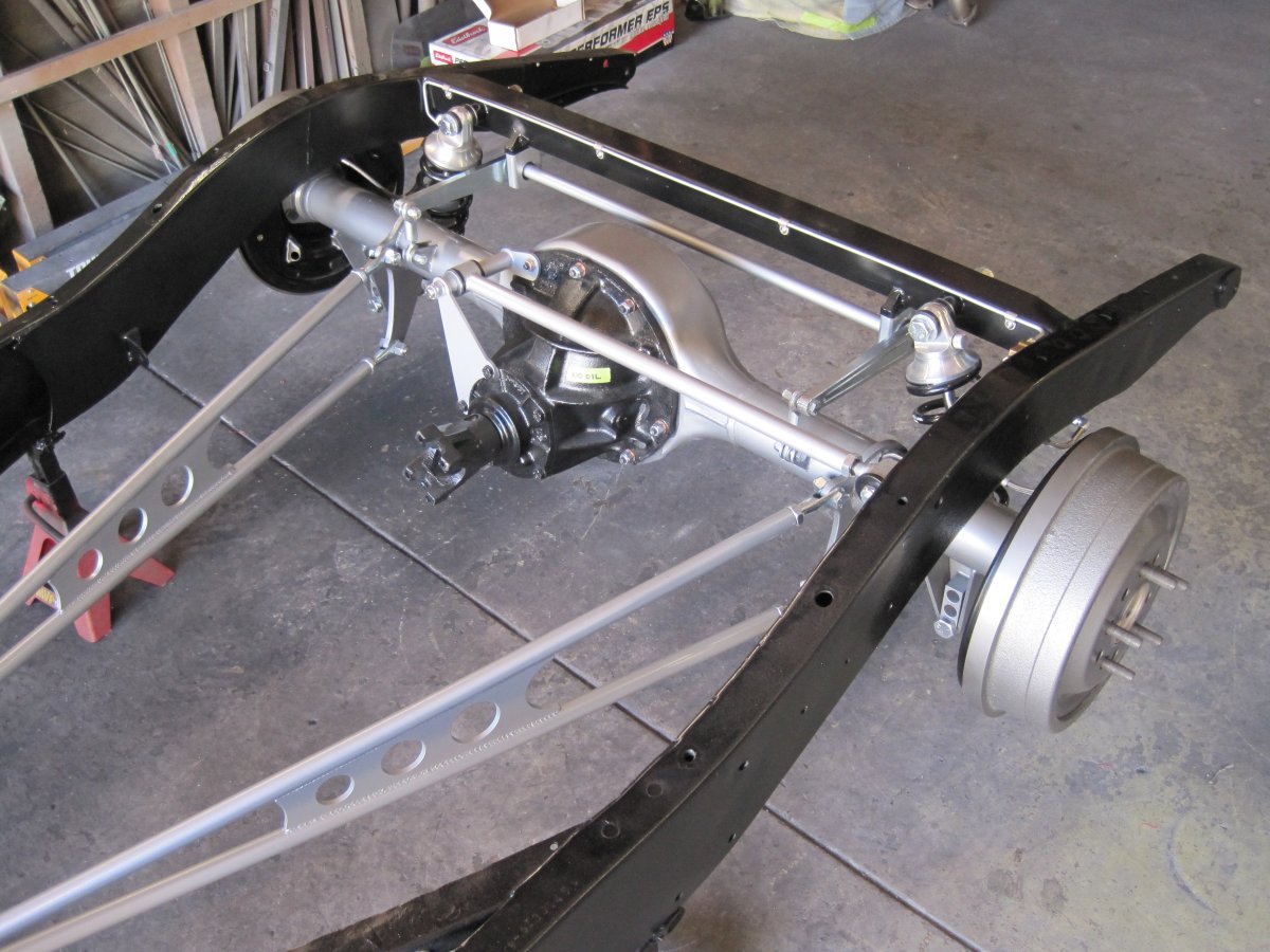

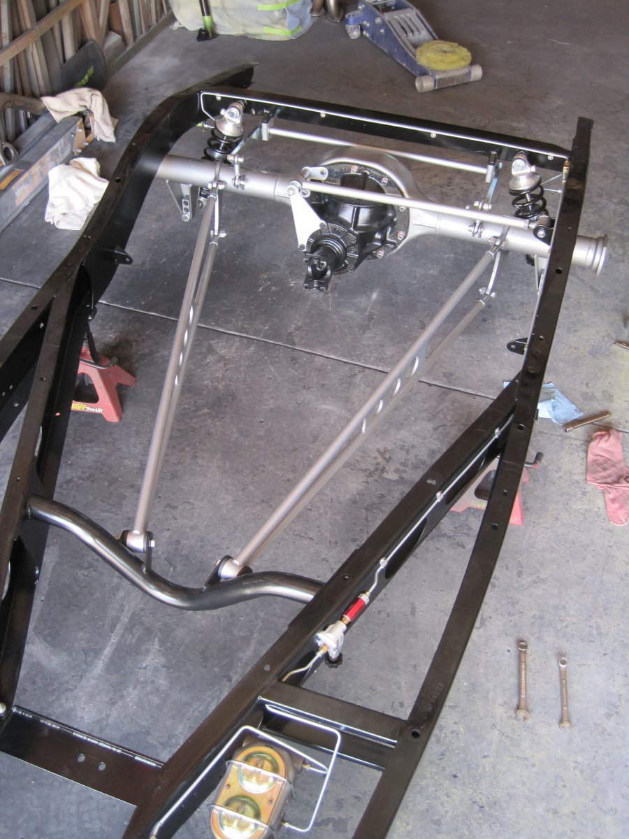

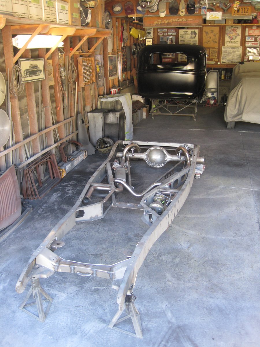

    But in between I have been working on the '33. Step 1 was to tear the ch***is down to a bare frame (carefully bagging and marking all part--especially fasteners--to know where they go back), and to buy lots of spray cans of paint. The best thing about this car is (1) it will never be in a car show, (2) it won't be in any magazine, and (3) it's being built to drive. Yes I love chrome, but I made up for my childhood deprivation on my '32 and race cars. On this one the frame is now rattle-can gloss black, and detailing is being done with "hammertone" silver and gray. Here's the beginning: No331.JPG
    The rearend housing is gray, the ladder bars are silver. The center-section was a take-out from my F-100, so I had it rebuilt by Hooper's. They and Bill suggested a 3.70 gear would be best with the 700-R4 trans, so I had them install that new ring and pinion. Ganahl cheap trick--use a worn-out buffer pad on your floor jack. no336.JPG
    With the diff installed in the housing (with P&J Panhard brackets attached ), it was hung on the coil-overs with ladder bars attached. Adjust the Panhard bar to center the rearend housing, using a T-square to measure from the outside frame rails to axle ends. This is like building a 1:1 model kit. Fun. no342.JPG
    Bill (aka South City Rod & Custom) fit and installed the complete brake system. So after storing them in a clean and dry place (and not bending anything), it was a simple mater of painting a couple of brackets, and reinstalling, starting with the master cylinder and proportioning valve. no345.JPG
    And this is as far as I got last week. Nice brake lines, Bill. Plus P&J sway bar. no347.JPG

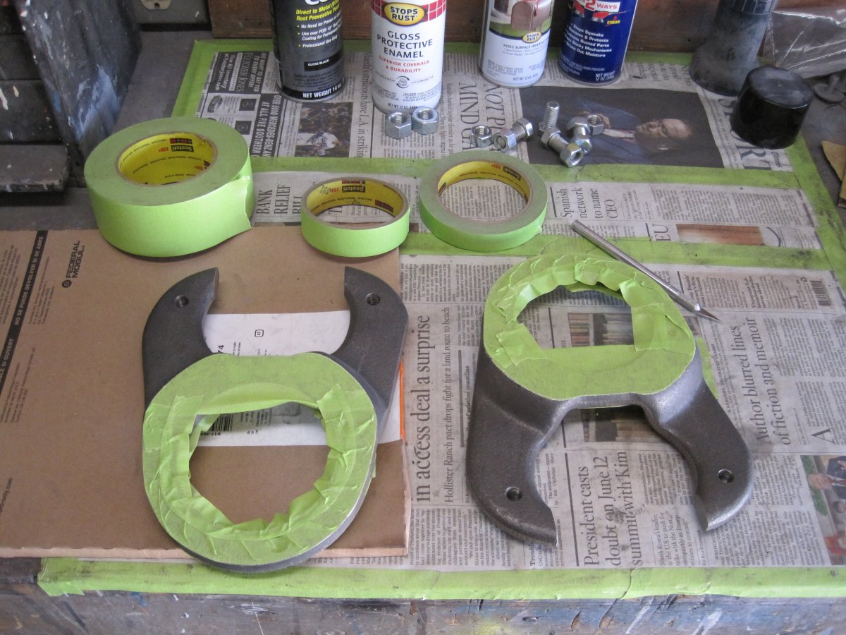

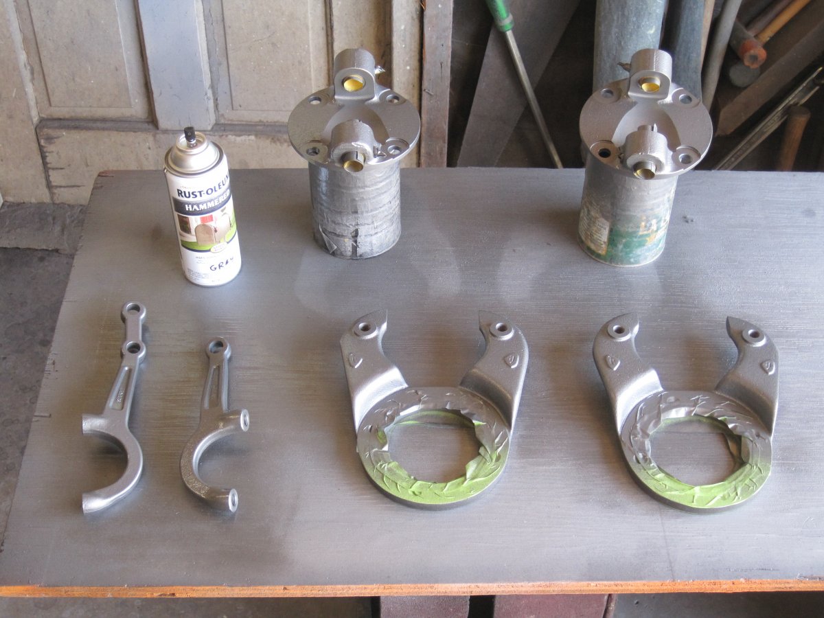

    I also got most of the front-end parts spray bombed. Somehow painting always seems to include some careful masking. I love painting, but I hate masking. no348.JPG
    I like SuperBell products fine, but I didn't care for their winged logo in the middle of the dropped axle, so I very carefully ground it out, front and back. Then hit it with "Hammered" silver. no344.JPG
    Now that I've got this done, it's time to get back out in the garage and hang that axle in the frame, along with front and rear brakes. Might even get it back on wheels. We'll see.

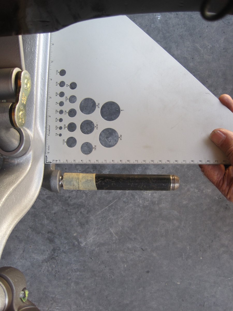

    And I'm making other progress, starting with the rear axles and brakes.
    Do you have any of these bent wrenches? Sometimes they're the only thing that will fit for certain jobs.
    With brake lines hooked up, rear suspension is now done. I won't tell you why I had to do this job twice (axle housing seals...yes, you need them even with sealed axle bearings).

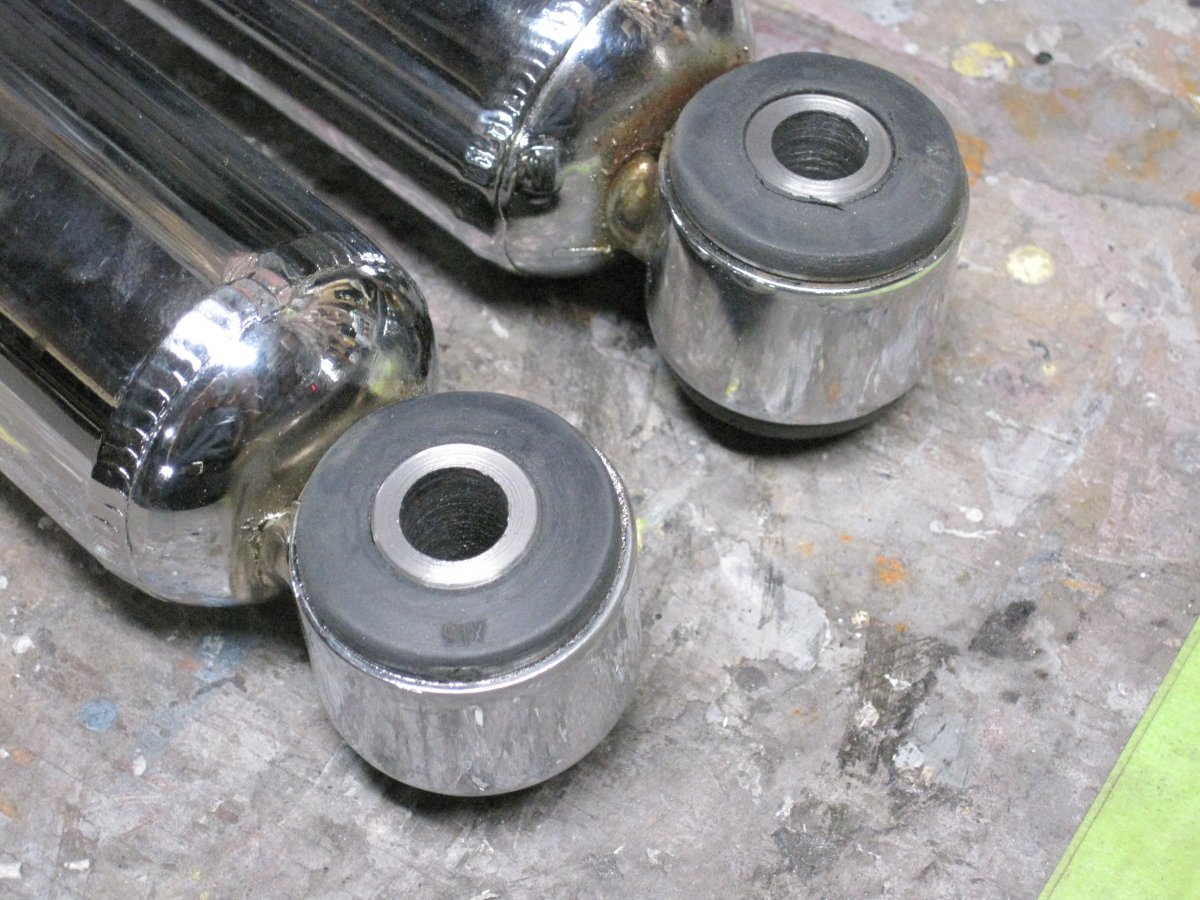

    Moving to the front: I really don't care for the bolt-on lower front shock mounts all street rods have today (I made my own for my '32; but this is a 1-800 street rod project, so this is what it gets). But my pet peeve is crooked ones. So I used a piece of tubing to align it and hold it in place while I super-tightened the 3/4" bolt with a breaker bar.
    I also prefer covered front shocks. Bill had just gotten a pair of shorties now made by SoCal, and sent them, but they required an odd-sized upper bushng to take the typical 7/16" upper mount bolt. We didn't have any, so I figure it'd be easier/quicker to make them on my trusty, old, well-worn lathe.
    Thing were going fine up the G****vine hill... Yes, I was wearing leather gloves and protective gl***es, but after a very weird encounter between the cutting bit and my right wrist, and an afternoon at Urgent Care getting Super-Glued back together (no lie), I did get the simple bushings made (on the second try, of course).
    Mounting the front shocks requires adding the front fender braces, which would be in the way, so they'll come later. Otherwise, with tightening the brake lines, the front end is now complete.
