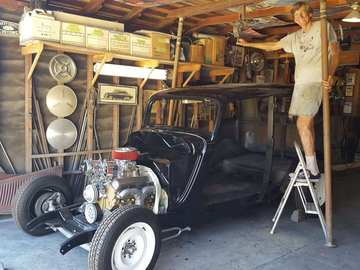

    The best part about being retired, for me, is no more deadlines. And that applies to car projects. Of course we had holidays and road trips, too. So it's been awhile. But people have been asking, so here's the latest on the '33 sedan.
    Oh, not only do I forget to check tire sizes, I almost forgot to mention: wheels are 6 and 7x15 with early Ford centers made by Wheel Smith, powder-coated white. Will have Ford caps, no rings. Rear tires are Michelin Defender P235-75-15 LTX; fronts are 155R15 Firestone F560 from Coker.
    OK, you asked for an update. The car is at North Hollywood Upholstery, which also did the tuck and roll in my gold '50 Ford custom. This one will be black and white. no458.JPG Cars in upholstery shops--especially busy ones--aren't much to look at. The only thing to see here (sort of) is new tack strips, chicken wire, and one layer of stretched padding over the stock top bows. I went over to solder the radio antenna wire to the chicken wire, which makes the best hidden antenna. The top insert will be white Mercedes convertible top material. no454.JPG no455.JPG Here's the new look for the old Subaru seats, which we hope will be supportive and comfortable for cross-country touring. no453.JPG And this is the Glide folding rear seat frame in its new clothes. Its main job will be holding suitcases. no456.JPG Shop owner/head upholsterer Pedro Lara shows me how one front door panel is looking, for my approval. Looks good to me. Headliner will be black vinyl, and carpets will be black cut pile with black binding. no457.JPG Still plenty of work to do, and of course it doesn't look pretty yet. But I think it will. This shop is plenty busy, but they're good at getting cars in and out. So I'll be patient. And we're looking forward to seeing Bill's two latest builds--two pretty amazing blown Willys G***ers--in his SCRC booth at GNRS in Pomona this weekend. That's next on the list. See you there?

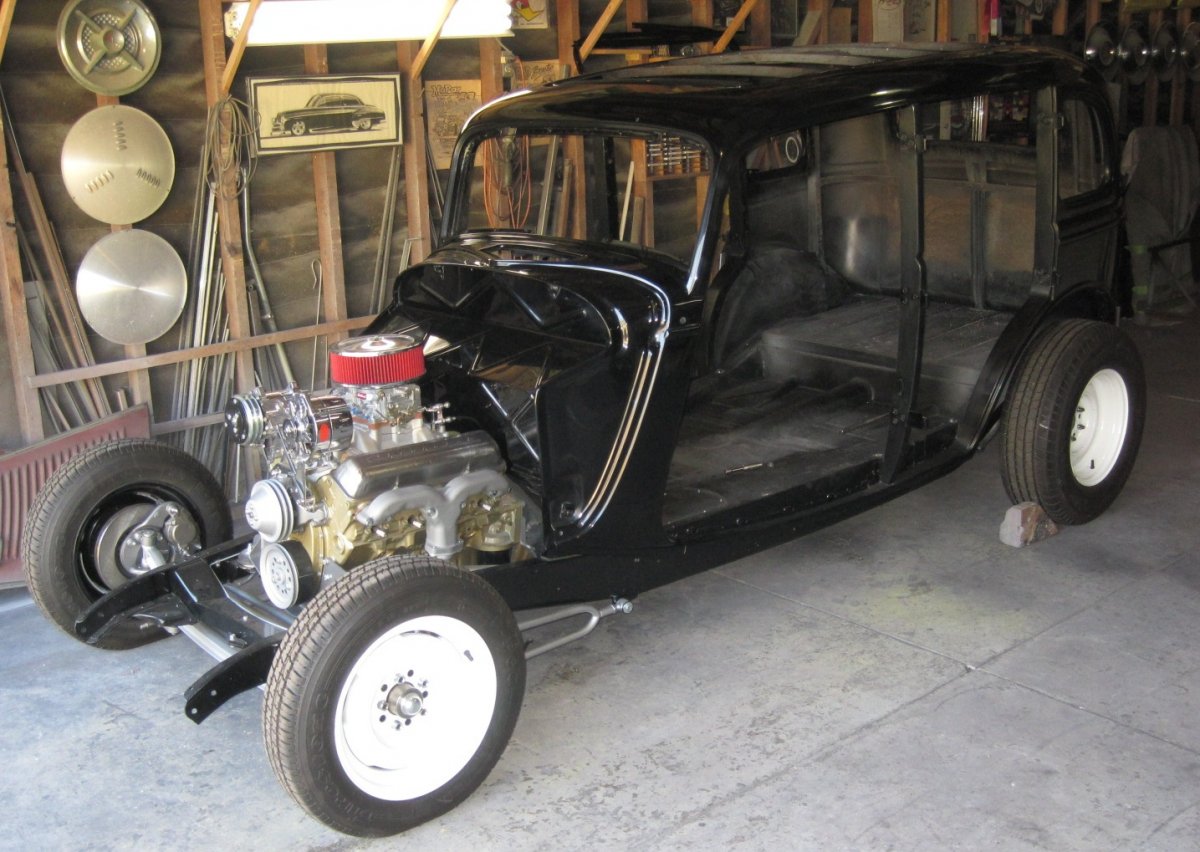

    Update time again. I got the '33 back from North Hollywood Upholstery 2-3 weeks ago, and I've gotta say it looks really good to me. But also usable. And hopefully comfortable for long cruises. I think it will be. So I've been busy doing lots of "finish its" like installing handles, fitting repro door sill plates (much work), and so on. Got the rear apron rubbed out and installed, and spent yesterday color sanding rear fenders. But figured I'd better finally stop and take a few photos...just in case anyone is still following this. The grille's been done (much work) quite a while, so I just hung it in place for pics. Finally getting close. no463.JPG
    Whew. That's enough for today. Running boards, fenders, bumpers, and lights and it will be roadworthy. Still have to paint the hood, but it's in nice shape. Til next time.

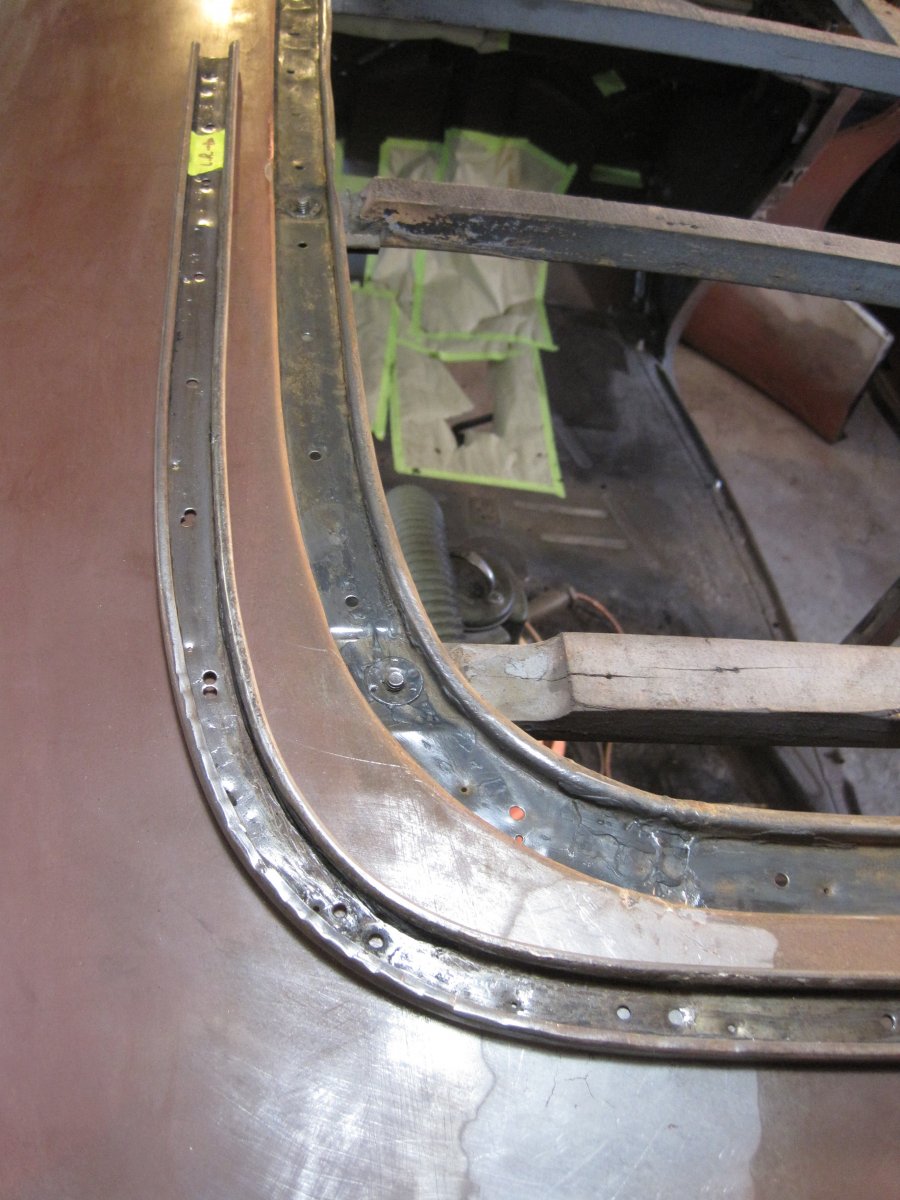

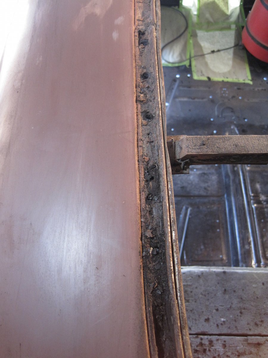

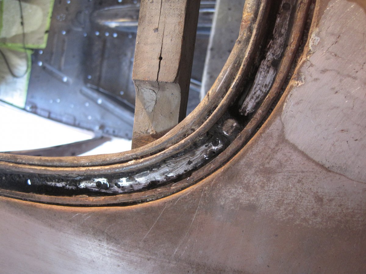

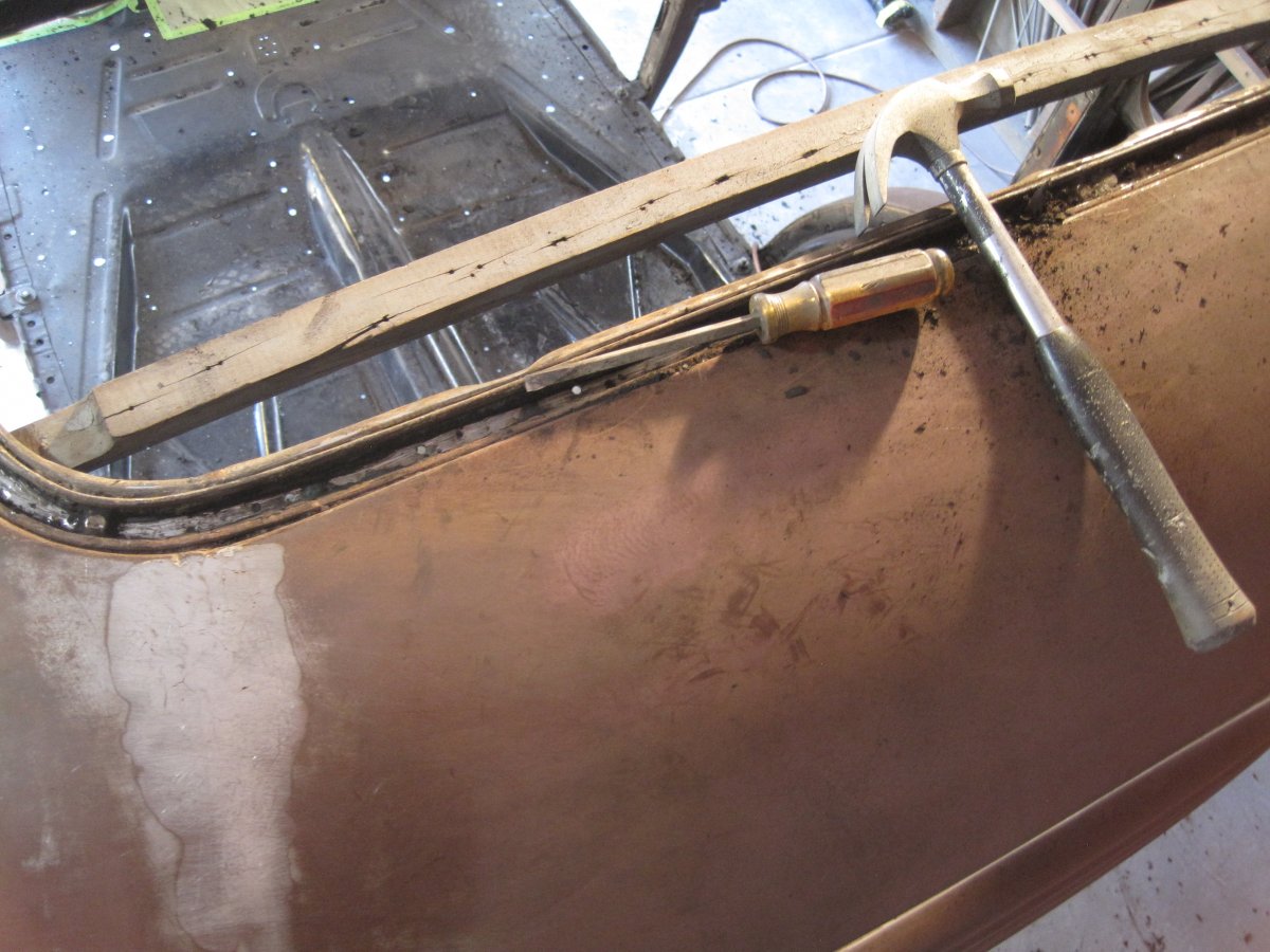

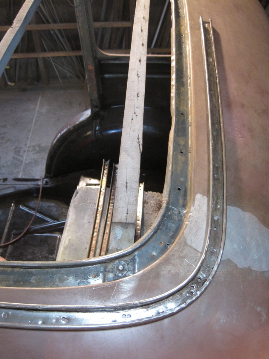

    Really enjoying this building! Did you happen to take pictures of how and what you used for the tax strip in the new channel set up? A lot of guys on the forum I’ve been wanting to know how to do these tops and I’ve been trying to help as much as I could when I took mine apart, but a lot of people are trying to come up with a way to put a new tack strip material in the existing channel if they have it which I have mine but that Asphalt material needs to be either stabilized or replaced.
    I hope you got pictures of how that was done? Thanks a lot
