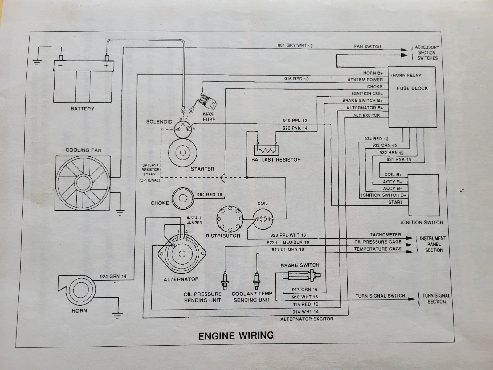

  9. Well, it looks like all who were going to reply did. Awful lots of hits; a bunch of nervous Painless users? :eek:
    Before I unpack this mess, I will comment on why I think they did it this way. The aftermarket harness suppliers are notorious for trying to NOT use any wire sizes larger than #10. They'll try various gyrations trying to make the smaller wire do the work of a larger wire. That's the case here IMO. It appears here that in connecting one side of the panel directly to the alternator, they figured that shunting part of the alternator output to the panel would reduce the current in the 960 wire, allowing the use of the smaller #8 wire and smaller fuse. In theory it works, and as long as there's no other issues it'll be fine. The problem is if you do have any issues, this design creates more problems than it solves.
    So, not necessarily in order...
    1. I gave a 'clue' to tell how many wires that 50A maxifuse was fully protecting. The correct answer is NONE. The fuse does offer overload protection to the #8 ONLY, and may blow in a short-circuit but ONLY if the short is on the panel/alternator side of the fuse. The #8 between the voltage source (battery) and the fuse is unfused and if shorted to ground will sizzle until A. the wire burns away whatever it's shorting to, or B. the wire melts in half. One can hope that A or B happens before the wire catches fire, but with 500+ short-circuit amps available from the battery, time is probably against you.
    2. Let's ***ume for a moment that the maxifuse blew under overload, just enough to trip it but not enough to melt any wire. If it trips while driving you may not even know it, and your first notice of it will be when you shut off the car and try to restart it. Or when driving, the alternator regulator fails and the car just quits. The fuse failing effectively disconnects the battery from the harness, and alternator regulators don't like not having the battery to reference to. This generally kills the regulator. I'll note that generators don't like this either, but being cruder non-electronic systems can tolerate it longer.
    3. Going back to the short-circuit scenario on the panel/alternator side of the maxifuse, this is where bad things can happen. If the fuse blows, that at least removes the big fault current from the battery. But you still have unfused power from the alternator on all three wires. Depending on the output size of the alternator, you may or may not have a disaster. If you have a smaller alternator (70A or less would be my guess) it may fail before any major damage occurs. If it's a big 100A+ unit, you may have the A & B deal from 1 on your hands. Worse yet, if the short burns open the wire, that doubles the load on at least one of the remaining wires, putting that one at hazard and presenting another possible fire. Again, if you're lucky the alternator will fail first.
    4. Last, the parallel panel feeders (wires 915, 916, and 960). This problem is the least likely, but not outside the realm of possibility. Wire has X amount of resistance per foot, with differences by AWG size. A shorter wire will have less resistance compared to a same-size longer one. Electricity will always take the path of least resistance. What this means as a practical matter is the shorter wire will be carrying more current. How much more is hard to say, that will depend on relative wire lengths, load and connection quality. If it's close, what will probably happen is the shorter wire will heat up slightly (increasing its resistance) until it reaches equilibrium with the longer wire. But sometime the rate of temperature rise is too fast so it shoots past the other wire, starting a circle that ends with one or both wires overheating, maybe to the point of damage/fire. Parallel feeders should always be the same gauge/length to prevent this.
    The fuse they furnished is a 'magic token' more than anything else (Look! It's got a fuse so it's safe!). Very limited in operation and causes more issues than it cures. It would be much better to properly size/connect all wires and simply eliminate it. If you just have to have short-circuit protection, to make it actually meaningful you'll need to install a fuse at each end of those four wires because they're fed from both ends. Do you really want to deal with eight fuses?
    Feel free to self-grade.... LOL

    Crazy Steve; Now that we know the faults, what's your recommended fix for the Painless wiring harness? Upsize the gauge on a couple of wires as well as reroute a couple of runs? Easy mod on an uninstalled harness on the bench, but maybe a couple of heavy gauge 'home runs' for a harness in service on a Rod would be a relatively straight forward fix?
    Can you "paint" in some fixes on your o/p schematic for a visual?
    How do the other wiring harness company's compare in design and wire gauge? Rebel, etc. Ron Francis has been around 50 years...

    What I would do is run the 960 wire all the way to the starter solenoid, increasing the gauge of the wire as needed depending on the amperage of the alternator and the length of the wire. Eliminate wire 915. And increase the gauge of 916 to handle to max load that would be applied to it.

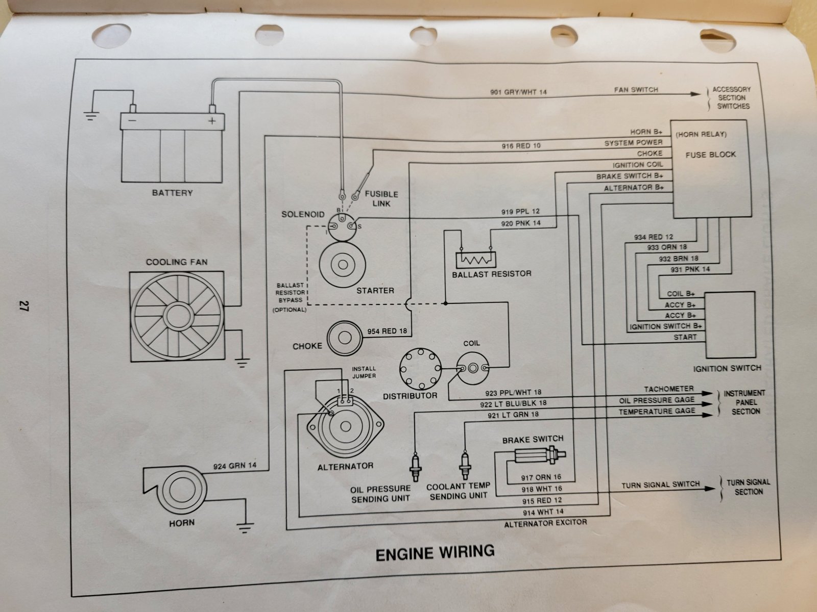

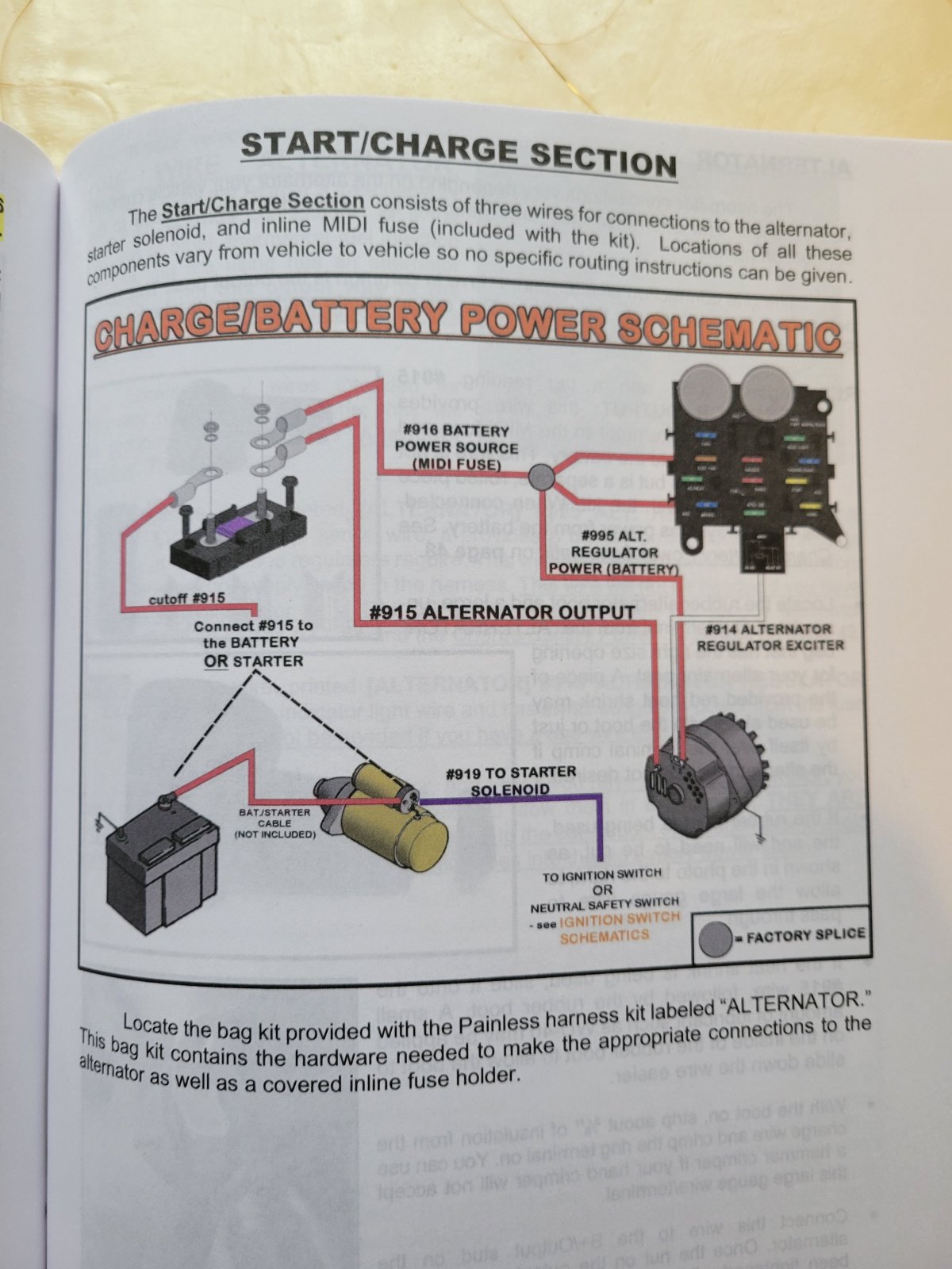

    Let's start by you throwing the Painless 10102 under the bus but you're using an outdated schematic of the 10102 harness to do so, which I just bought last week, this is the correct schematic and they don't use the "maxi fuse" any longer.
    With that being said my old instruction booklet of my previous equivalent Painless harness provided this as the only illustration.
    And previous to that one it used a fuse-able link as in this illustration
    Now back to my harness meltdown, I had the maxi fuse and it didn't trip, the wire from the alternator shorted and melted its way all the way back to the fuse panel.
    Here's a link to my thread and photos
    https://www.jalopyjournal.com/forum/threads/dont-do-as-i-did.1269925/
    I would of expected a fuse to blow somewhere before doing all the damage it did, but it didn't and I was lucky to get the battery disconnected rather quickly.
    Hopefully their new circuit breaker system works better.

    The problem with all of those is they run the alternator output to the fuse panel. That wire needs to go to the battery, though running it to the starter solenoid works too. Then the maxi-fuse will actually do something.
  20. That's what I thinking, but I still use the proper sized fusible link (because I like the way they look). I also like the idea of the Alt power on it's own dedicated circuit, but I would run the power for the internal reg (#995 in pic) off of the battery pole of the alt.
    BTW this still has a "Maxi fuse" in the same spot as the old kit, it's just a different style of fuse.

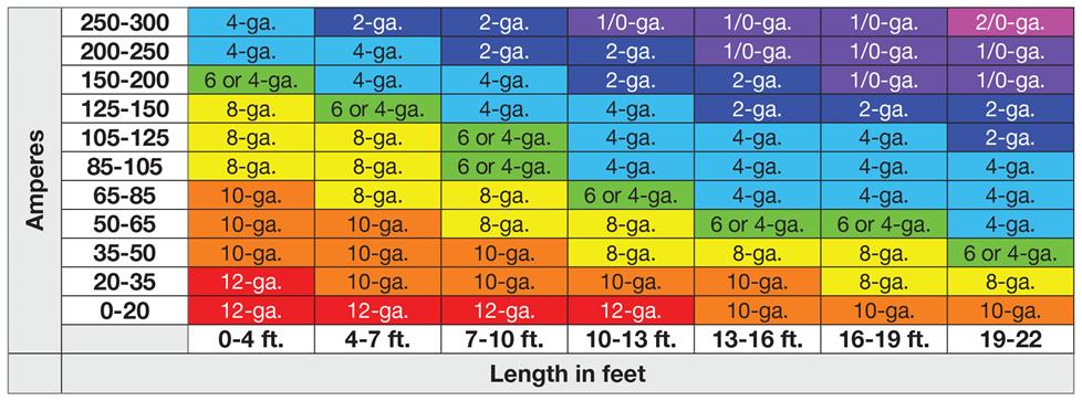

  21. And that's the answer right there. To determine the actual wire size, you should do a load calculation according to the loads you have.
    Jim, that's not just a '80s thing. Detroit started doing this as soon as the industry made the conversion from 6 to 12 volts, maybe even before. In those days the OEMs usually built a 'standard' harness designed to take care of all standard equipment (lighting, ignition, wipers if electric) along with popular options like a radio, heater, lighter and clock. When additional larger electrical loads were added such as power windows, seat, convertible top and AC, each one of those loads used a separate, add-on 'sub harness' laid 'over' the basic harness. Instead of having just three connections at the solenoid battery post (battery cable, output from the charging system, a supply power to the main harness), you could have up to six or seven connections depending on the options installed. Overcurrent protection was usually handled by circuit breakers but sometimes fuses (no fusible links yet) and if ignition key switching was wanted, they used relays to switch them. The only connection to the 'basic' harness was a small control circuit to operate the relay coils. This was standard practice for years, and what you'd almost always find on a HAMB-era car. On the higher-end cars like the Caddys and Lincolns that ended up with most of this stuff as standard equipment, sometimes effort was made to integrate these circuits into the 'basic' harness but not always.
    A brief history lesson here. Up though the early '60s, very few vehicles had unified fuse panels. Lighting fuses were generally found on the light switch, and fuses for things like the radio, heater, wiper motor and lighter were found at the point of connection to that device. In effect, most of the harness consisted of unfused wire. As long as everything was good, no problem. But then the harness would get hacked, the wire insulation would 'age out' and get brittle and fall off and the potential for a catastrophic wiring fire went up sharply. Detroit recognized this and switched to unified fuse panels starting in the early '60s. Fuses were now at the 'point of origin' of the circuit, much better protection. But you still had unfused wiring; ignitions, charging systems, and panel feeds were still unfused and they continued to use sub harnesses for some options. Again, as long as everything is good, this will be a reliable system and in terms of simplicity is my preferred method with a few improvements. Current new car harnesses are now much more integrated (and complicated!) because of the huge amount of electrical/electronics used on modern cars.
    The aftermarket harness industry is pretty much still selling the '60s unified panel design, with all of its limitations. Again, not a bad thing but one place the industry does a disservice is they don't clearly explain just what those limits are. Most guys look at the kits, add up how many circuits they need (of all types) and buy one with that amount or more. But virtually every harness kit I've seen uses the same two #10 wires for the power leads to the panel, immediately limiting you to a 60A max connected load. If you're aware of one who doesn't do this, I'd like to know. Worse yet, it appears most of them aren't externally splittable, i.e. the switched half of the panel is supplied internally at the panel, you can't upgrade the feed to it. Again, if you're aware of one who doesn't do this, I'd like to know. This is a real shame, as that capability could eliminate those add-on harnesses and give you a truly unified fuse panel. For a further discussion/explanation of this, go here... Wiring 101 | Page 6 | The H.A.M.B. (jalopyjournal.com) posts 165 to 168.

  23. And I absolutely hate this chart. This isn't really an amps chart, it's a voltage drop chart. You can end up with way too much drop by using this. And mis-reading it can burn your car down.
